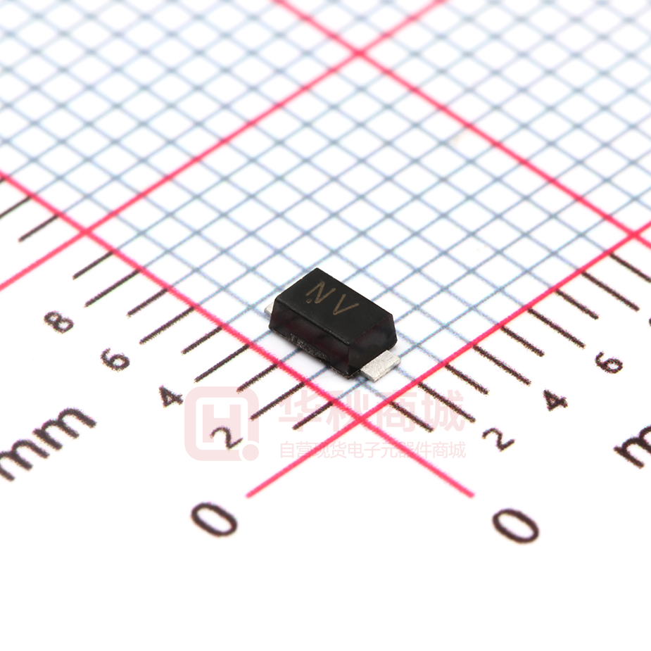

    TVS二极管 VRWM=9V VBR(Min)=10V VC=15.4V IPP=13A Ppp=200W SOD123FL
SMF9.0CA 数据手册
SMF5.0A(CA)-SMF58A(CA) SURFACE MOUNT TRANSIENT VOLTAGE SUPPESSOR DIODE Features ! For surface mounted applications ! Low profile package ! Low incremental surge resistance, excellent clamping capability ! 200W peak pulse power capability with a 10/1000 µ s wave from,repetition rate (duty cycle):0.01% ! High temperature soldering guaranteed: 260 ℃/10 seconds, at terminals B C E SOD-123FL Dim Min Max Typ A 3.58 3.72 3.65 3 B 2.72 2.78 2.75 C 1.77 1.83 1.80 D 1 1.02 1.08 1.05 E 0.097 1.03 1.00 H 0.13 0.17 0.15 L 0.53 0.57 0.55 All Dimensions in mm Mechanical Data ! Case: JEDEC SOD-123FL, molded plastic over passivated chip ! Polarity: Color band denotes positive end D H L ( cathode ) except for bidirectional ! Mounting position: Any ! E Weight: 0.006 ounces, 0.02 gram A Maximum Ratings TA = 25C unless otherwise specified Characteristic Symbol Value Unit Maximum P PK Dissipation (PW - 10/1000 μs) PPK 200 W Maximum P PK Dissipation @ Ta = 25 °C (PW - 8/10 μs) (Note 2) PPK 1000 W DC Power Dissipation @ Ta = 25 °C PD 385 mW 4.0 mW/ °C (Note 3) Derate above 25 °C Thermal Resistance, Junction to Ambient (Note 3) RӨJA 325 °C/W Thermal Resistance, Junction to Lead (Note 3) RӨJL 26 °C/W TJ, TSTG -55 to +150 °C Operating Junction and Storage Temperature Range Notes : (1) Non−repetitive current pulse at Ta = 25°C, per waveform of Fig. 2. (2) Non−repetitive current pulse at Ta = 25°C, per waveform of Fig. 5. (3) Mounted with recommended minimum pad size, DC board FR −4. www.slkormicro.com 1 SMF5.0A(CA)-SMF58A(CA) Marking TYPE (Bi) (Uni) (Bi) SMF5.0A SMF6.0A SMF6.5A SMF7.0A SMF7.5A SMF8.0A SMF8.5A SMF9.0A SMF10A SMF11A SMF12A SMF13A SMF14A SMF15A SMF16A SMF17A SMF18A SMF20A SMF22A SMF24A SMF26A SMF28A SMF30A SMF33A SMF36A SMF40A SMF43A SMF45A SMF5.0CA SMF6.0CA SMF6.5CA SMF7.0CA SMF7.5CA SMF8.0CA SMF8.5CA SMF9.0CA SMF10CA SMF11CA SMF12CA SMF13CA SMF14CA SMF15CA SMF16CA SMF17CA SMF18CA SMF20CA SMF22CA SMF24CA SMF26CA SMF28CA SMF30CA SMF33CA SMF36CA SMF40CA SMF43CA SMF45CA AE NE AG AK AM NG NK AP AR NP NR AT AV NT NV AX AZ BE NX NZ OE BG OG BK BM OK OM BP BR BT BV BX OP OR OT BZ CE OZ PE CG CK CM PG PK PM CP CR CT PP PR PT CV PV SMF48A SMF48CA SMF51CA SMF54CA SMF58CA CX PX CZ CA PZ PA CC PC (Uni) SMF51A SMF54A SMF58A www.slkormicro.com NM OV OX Reverse Stand-Off Voltage VRWM (V) 5.0 6.0 6.5 7.0 7.5 8.0 8.5 9.0 10 11 12 13 14 15 16 17 18 20 22 24 26 28 30 33 36 40 43 45 48 51 54 58 Breakdown Breakdown Test Voltage Current Voltage Max. @ IT Min. @IT VBR MIN(V) VBR MAX(V) IT (mA) 7.00 7.37 7.98 8.60 9.21 9.83 10.4 11.1 12.3 13.5 14.7 15.9 17.2 18.5 19.7 20.9 22.1 24.5 26.9 29.5 31.9 34.4 36.8 40.6 44.2 49.1 52.8 55.3 58.9 62.7 66.3 71.2 6.40 6.67 7.22 7.78 8.33 8.89 9.44 10.0 11.1 12.2 13.3 14.4 15.6 16.7 17.8 18.9 20.0 22.2 24.4 26.7 28.9 31.1 33.3 36.7 40.0 44.4 47.8 50.0 53.3 56.7 60.0 64.4 2 10 10 10 10 1.0 1.0 1.0 1.0 1.0 1.0 1.0 1.0 1.0 1.0 1.0 1.0 1.0 1.0 1.0 1.0 1.0 1.0 1.0 1.0 1.0 1.0 1.0 1.0 1.0 1.0 1.0 1.0 Reverse Leakage @VRWM Maximum Clamping Voltage @IPP IR(uA) VC(V) IPP(mA) 400 400 250 100 50 25 10 5.0 2.5 2.5 2.5 1.0 1.0 1.0 1.0 1.0 1.0 1.0 1.0 1.0 1.0 1.0 1.0 1.0 1.0 1.0 1.0 1.0 1.0 1.0 1.0 1.0 9.2 10.3 11.2 12.0 12.9 13.6 14.4 15.4 17.0 18.2 19.9 21.5 23.2 24.4 26.0 27.6 29.2 32.4 35.5 38.9 42.1 45.4 48.4 53.3 58.1 64.5 69.4 72.7 77.4 82.4 87.1 93.6 21.7 19.4 17.9 16.7 15.5 14.7 13.9 13.0 11.8 11.0 10.1 9.3 8.6 8.2 7.7 7.2 6.8 6.2 5.6 5.1 4..8 4.4 4.1 3.8 3.4 3.1 2.9 2.8 2.6 2.4 2.3 2.1 Peak Pulse Current SMF5.0A(CA)-SMF58A(CA) FIG.2 - 10 x 1000 μs PULSE WAVEFORM 120 Pulse Width (tp) is defined as that point where the peak current decays to 50% of IRSM tr 100 100 tr ≤ 10 μs 80 VALUE (%) PEAK PULSE DERATING IN % OF PEAK POWER OR CURRENT FIG.1 - PULSE DERATING CURVE 60 40 Peak Value - I RSM 50 Half Value - IRSM 2 Ta = 25 °C 20 tp 0 0 0 25 50 100 75 125 150 0 1 Ta, AMBIENT TEMPERATURE, ( °C) 3 4 t, TIME (ms) FIG.3 - STEADY STATE POWER DERATING FIG.4 - PULSE RATING CURVE 4.0 10000 Pp,PEAK POWER (W) PD, STEADY STATE POWER DISSIPATION (W) 2 3.0 2.0 1.0 1000 100 10 0.1μs 1.0μs 10μs 100μs 1.0ms 10ms 0 25 50 75 100 125 150 tp, PULSE WIDTH 175 TL, LEAD TEMPERATURE (°C) FIG. 6 - CAPACITANCE VS. WORKING PEAK REVERSE VOLTAGE 1000 Pulse Width (tp) is defined as that point where the peak current decays = 8 μs tr 100 Measured @ Zero Bias C, CAPACITANCE (pF) % OF PEAK PULSE CURRENT FIG.5 - 8 x 20 μs PULSE WAVEFORM Peak Value I RSM @ 8 μs Half Value I RSM/ 2 @ 20 μs 50 tp 0 0 20 40 60 80 t, TIME (μs) www.slkormicro.com 100 Measured @ 50 %VRWM 10 1 1 10 100 WORKING PEAK REVERSE VOLTAGE (V) 3 200
