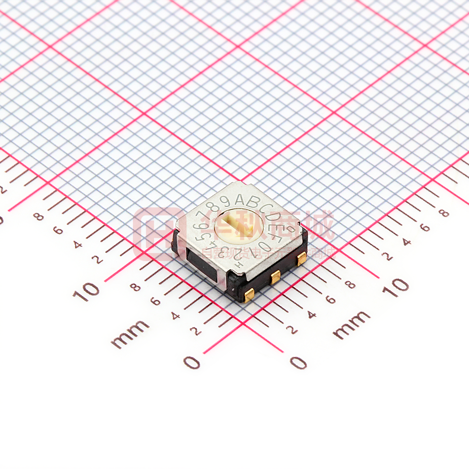

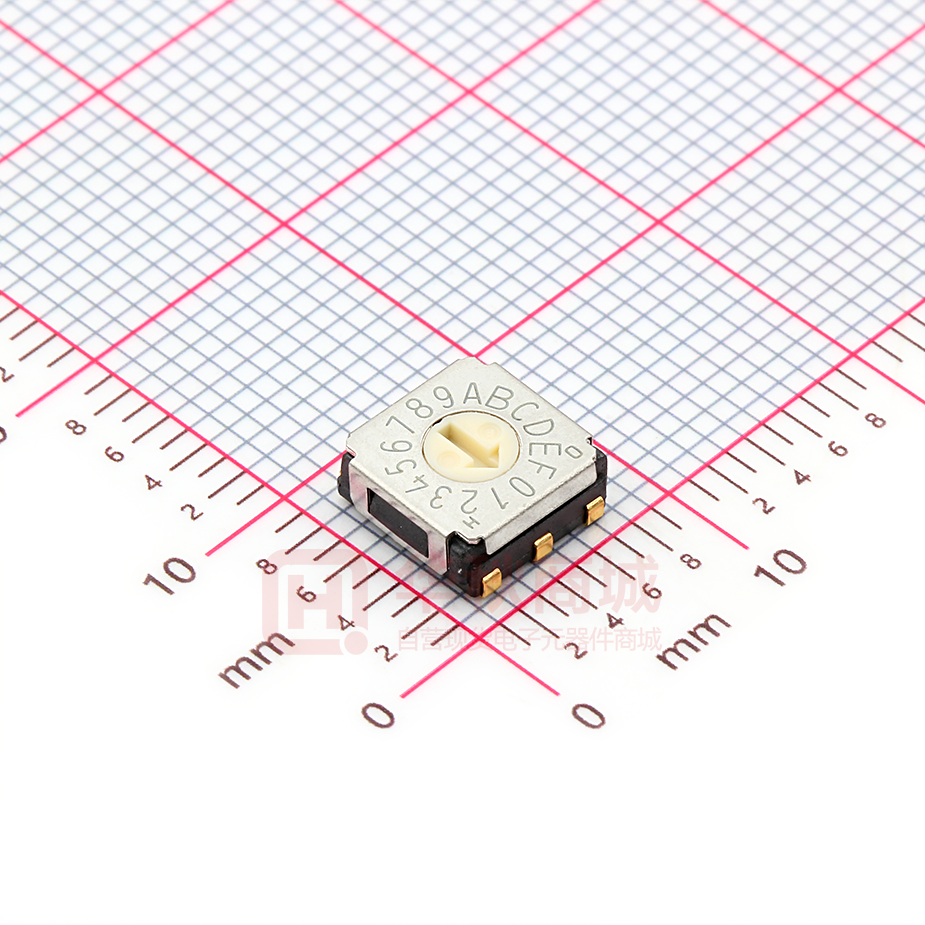

ROTARY CODED SWITCHES (SMD) RoHS compliant SA-7000 INTERNAL STRUCTURE ① ④ ② ⑧ ⑨ ⑥ ⑤ Part name ③ ⑦ Material Flammability Stainless steel (SUS 304) — Silicone rubber UL94HB UL94V-0 ① Marking cover ■ FEATURES ② Cover ● RoHS compliant ● Low profile of 3.0 mm ● Wide variety (top or side setting, 10 or 16 positions, J-hook, gull wing or through hole pins) to choose from ● Easy to recognize ● Low-profile side setting type with support terminals is available ③ “O” ring ④ Rotor Polyphenylenesulphide ⑤ Spacer Stainless steel (SUS 304) ⑥ Moving contact ⑦ 固定接点 ⑧ Housing ⑨ Terminal pin — Copper alloy, Gold-plated Fixed contact Polyphenylenesulphide UL94V-0 Copper alloy, Gold-plated — ■ PART NUMBER DESIGNATION S A - 7 0 1 0 T A Series name Shape of rotor 0:Without knob (Minus slot) 1:With knob 2:Without knob (Cross slot) Code format 1:10 positions, real code 3:10 positions, complementary code 5:16 positions, real code 7:16 positions, complementary code Shape of terminal A:J-hook B:Gull wing C:Through hole pins (Only gull wing availabe for Low-profile side setting type) Form of packaging T:Taping (Reel) Blank:Bulk in plastic bag (Only taping availabe for Low-profile side setting type) Setting position 0:Top setting 1:Side setting 2:Low-profile side setting & forward support terminal type 3:Low-profile side setting & sideling support terminal type ※ Please refer to the LIST OF PART NUMBERS when placing orders. SA-7000 ROTARY CODED SWITCHES (SMD) ■ LIST OF PART NUMBERS Setting position Shape of rotor Minus slot Top setting With knob Cross slot Minus slot Side setting With knob Cross slot Minus slot Low-profile side setting & forward With knob support terminal type Cross slot Minus slot Low-profile side setting & sideling With knob support terminal type Cross slot Shape of terminal Form of packaging A J-hook Taping B Gull wing Taping C Through hole pins Taping A J-hook Taping B Gull wing Taping C Through hole pins Taping A J-hook Taping B Gull wing Taping C Through hole pins Taping A J-hook Taping B Gull wing Taping C Through hole pins Taping A J-hook Taping B Gull wing Taping C Through hole pins Taping A J-hook Taping B Gull wing Taping C Through hole pins Taping Plastic bag Plastic bag Plastic bag Plastic bag Plastic bag Plastic bag Plastic bag Plastic bag Plastic bag Plastic bag Plastic bag Plastic bag Plastic bag Plastic bag Plastic bag Plastic bag Plastic bag Plastic bag Binary coded decimal Real code Complementary code Binary coded hexadecimal Real code Complementary code Pieces in package SA-7010TA SA-7030TA SA-7050TA SA-7070TA 500 pcs./reel SA-7010A SA-7030A SA-7050A SA-7070A 50 pcs./pack SA-7010TB SA-7030TB SA-7050TB SA-7070TB 500 pcs./reel SA-7010B SA-7030B SA-7050B SA-7070B 50 pcs./pack SA-7010C SA-7030C SA-7050C SA-7070C 50 pcs./pack SA-7110TA SA-7130TA SA-7150TA SA-7170TA 500 pcs./reel SA-7110A SA-7130A SA-7150A SA-7170A 50 pcs./pack SA-7110TB SA-7130TB SA-7150TB SA-7170TB 500 pcs./reel SA-7110B SA-7130B SA-7150B SA-7170B 50 pcs./pack SA-7110C SA-7130C SA-7150C SA-7170C 50 pcs./pack SA-7210TA SA-7230TA SA-7250TA SA-7270TA 500 pcs./reel SA-7210A SA-7230A SA-7250A SA-7270A 50 pcs./pack SA-7210TB SA-7230TB SA-7250TB SA-7270TB 500 pcs./reel SA-7210B SA-7230B SA-7250B SA-7270B 50 pcs./pack SA-7210C SA-7230C SA-7250C SA-7270C 50 pcs./pack SA-7011TA SA-7031TA SA-7051TA SA-7071TA 500 pcs./reel SA-7011A SA-7031A SA-7051A SA-7071A 50 pcs./pack SA-7011TB SA-7031TB SA-7051TB SA-7071TB 500 pcs./reel SA-7011B SA-7031B SA-7051B SA-7071B 50 pcs./pack SA-7011C SA-7031C SA-7051C SA-7071C 50 pcs./pack SA-7111TA SA-7131TA SA-7151TA SA-7171TA 500 pcs./reel SA-7111A SA-7131A SA-7151A SA-7171A 50 pcs./pack SA-7111TB SA-7131TB SA-7151TB SA-7171TB 500 pcs./reel SA-7111B SA-7131B SA-7151B SA-7171B 50 pcs./pack SA-7111C SA-7131C SA-7151C SA-7171C 50 pcs./pack SA-7211TA SA-7231TA SA-7251TA SA-7271TA 500 pcs./reel SA-7211A SA-7231A SA-7251A SA-7271A 50 pcs./pack SA-7211TB SA-7231TB SA-7251TB SA-7271TB 500 pcs./reel SA-7211B SA-7231B SA-7251B SA-7271B 50 pcs./pack SA-7211C SA-7231C SA-7251C SA-7271C 50 pcs./pack SA-7012TB SA-7032TB SA-7052TB SA-7072TB 500 pcs./reel SA-7112TB SA-7132TB SA-7152TB SA-7172TB 500 pcs./reel B Gull wing SA-7212TB SA-7232TB SA-7252TB SA-7272TB 500 pcs./reel Taping   : Not manufactured ※ Verify the above part numbers when placing orders. Taping version can be supplied only in reel unit. SA-7013TB SA-7033TB SA-7053TB SA-7073TB 500 pcs./reel SA-7113TB SA-7133TB SA-7153TB SA-7173TB 500 pcs./reel SA-7213TB SA-7233TB SA-7253TB SA-7273TB 500 pcs./reel SA-7000 ROTARY CODED SWITCHES (SMD) ■ STANDARD SPECIFICATIONS Circuit type ■ ELECTRICAL CHARACTERISTICS BCD (Real code, complementary code) BCH (Real code, complementary code) Contact rating Non-switching Switching Minimum Operating temperature range − 40 ~ 85 °C DC50 V 100 mA DC5 V 100 mA DC20 mV 1 μA Storage temperature range 100 mΩ maximum Contact resistance Sealing Net weight Non-Washable Approx. 0.32 g (Top setting type without knob) Approx. 0.34 g (Top setting type with knob) Approx. 0.69 g (Side setting type without knob) Approx. 0.71 g (Side setting type with knob) Approx. 0.42 g (Low-profile side setting type without knob) Approx. 0.44 g (Low-profile side setting type with knob) Adjustment torque AC250 V, 60 s Dielectric strength ■ ENVIRONMENTAL CHARACTERISTICS (Amplitude) 1.5 mm or (Acceleration) 98 m/s2, 10-500-10 Hz, 3 directions for 2 h each Vibration ■ MECHANICAL CHARACTERISTICS No. of positions 100 MΩ (DC100 V) minimum Insulation resistance 490 m/s2, 11 ms 6 directions for 3 times each Shock 10, 16 10000 steps minimum, DC5 V, 100 mA Load life 20 mN·m {204 gf·cm} maximum Stepping angle 36° (10 positions) 22.5° (16 positions) Humidity (Steady state) Solderability 245 ± 3 °C, 2 ~ 3 s High temperature exposure 85 °C, 96 h Low temperature exposure − 40 °C, 96 h Reflow:255 °C (Peak temperature) Please refer to the profile below) Flow: 260 ± 3 °C, 5~ 6 s, two Manual soldering: 350 ± 10 °C, 3 ~ 4 s Shear (adhesion) 5 N {0.51 kgf} 10 s Substrate bending Width 90 mm, bend 3 mm, 5 s, 1 time Pull-off strength 5 N {0.51 kgf} 10s Stop strength (With knob only) 5 N {0.51 kgf} 10s { } : Reference only Thermal shock − 40 (0.5 h) ~ 85 °C ( 0.5 h ), 5 cycles 〈Reflow profile for soldering heat evaluation〉 (℃) 250 Temperature Soldering heat 40 °C, Relative humidity 90 ~ 95 %, 240 h 200 150 100 50 Peak : 250 +5 0 ℃ Over 230 ℃ 180 ℃ 150 ℃ Pre Heating Zone 90 ± 30 s 30 ± 10 s Heating time Reflow : two times maximum Soldering Zone SA-7000 ROTARY CODED SWITCHES (SMD) ■ CODE FORMAT ● …Contact closed 16 positions No. of positions 10 positions Position 0 1 2 3 4 5 6 7 8 9 A B C D E F 8 4 2 1 8 4 2 1 Real code Code Complementary code ● ● ● ● ● ● ● ● ● ● ● ● ● ● ● ● ● ● ● ● ● ● ● ● ● ● ● ● ● ● ● ● ● ● ● ● ● ● ● ● ● ● ● ● ● ● ● ● ● ● ● ● ● ● ● ● ● ● ● ● ● ● ● ● ■ RECOMMENDED P.C.B. PAD OUTLINE DIMENSIONS ● B type ● A type (Unit: mm) ● B type 2.3 2.3 1.9 4.3 2.3 6 – 1.2 62.54 – 1.2 2.54 2.54 2.54 3 2.54 2.54 2.54 6 – 1.6 2.54 6 – 1.62.54 2.54 2.54 2.3 1.9 1.9 3 3.5 6 – 1.6 6 – 1.6 2.54 2.54 2.54 6 – 1.2 6 –2.54 1.2 2.54 1.27 N (N = 1~4) = 5.08 0.761.27 N (N = 1~4) = 5.08 Note) The zero point is the center 0.76 of mounting. 1.27 N (N = 1~4) = 5.08 0.761.27 N (N = 1~4) = 5.08 0.76 1.9 1.9 1.9 1.9 6.6 5 6.6 3.5 5 3.5 0 0 4.3 0 4.3 0 6 0 4.3 0 6 0 0 3.5 3 3 1.9 3.5 3 3.5 3 ● A type 1.6 1.6 1.6 1.6 6 2 2 6 2 10.6 10.6 2 ■ SIZE OF P.C.B. PROCESSING 6 – φ 0.8 Operating face ▼ ● C type 6 – φ 0.8 2.54 2.54 5.08 7.62 ● C type 2.54 2.54 SA-7000 ROTARY CODED SWITCHES (SMD) ■ OUTLINE DIMESIONS Unless otherwise specified, tolerance: ± 0.3 (Unit: mm) ● SA-7050A (Real code) ● SA-7070A (Complementary code) ● SA-7010A (Real code) ● SA-7030A (Complementary code) Production date code Production date code 6 – 0.8 t = 0.15 ② ① Ⓒ 456 ④ ⑧ Ⓒ 3 7.2 2.54 Marking appears only with complementary code 3 0.6 W × 2.6 L × 0. 8D 6 – 0.8 t = 0.15 ② ① Ⓒ 7.2 9.8 456 789 7.2 3 ④ ⑧ Ⓒ 0.6 min. ④ ⑧ Ⓒ 2.54 Marking appears only with complementary code 0.6 W × 2.6 L × 0.8 D ● SA-7010C (Real code) ● SA-7030C (Complementary code) 2.54 2.54 Marking appears only with complementary code ● SA-7050C (Real code) ● SA-7070C (Complementary code) Production date code Marking appears only with complementary code 6 – 0.5 t = 0.15 ② ① Ⓒ 3 7.2 2.54 Marking appears only with complementary code 6 – 0.5 t = 0.15 ② ① Ⓒ F01 7.62 7.2 7.62 23 45 23 6 901 CD AB E 456 789 ④ ⑧ Ⓒ A 0.5 4±1 2.54 2.54 7.2 2.9 1.2 2.9 A 0.5 0.6 W × 2.6 L × 0.8 D A Projection 4±1 2.54 1.2 78 45 23 6 23 CD AB E F01 901 78 6 – 0.8 t = 0.15 0.6 min. 0.6 min. ② ① Ⓒ ④ ⑧ Ⓒ Marking appears only with complementary code Production date code Production date code Production date code 2.54 ● SA-7050B (Real code) ● SA-7070B (Complementary code) ● SA-7010B (Real code) ● SA-7030B (Complementary code) 0.6 W × 2.6 L × 0.8 D 2.54 9.8 0.6 W × 2.6 L × 0.8 D 2.54 0.6 min. 7.2 7.2 7.5 789 ④ ⑧ Ⓒ 7.2 4.7 CD AB E 7.2 4.7 7.5 45 23 6 7.2 F01 23 78 901 7.2 6 – 0.8 t = 0.15 ② ① Ⓒ 0.6 W × 2.6 L × 0.8 D A Projection 2.54 SA-7000 ROTARY CODED SWITCHES (SMD) ■ OUTLINE DIMESIONS Unless otherwise specified, tolerance: ± 0.3 (Unit: mm) ● SA-7150A (Real code) ● SA-7170A (Complementary code) ● SA-7110A (Real code) ● SA-7130A (Complementary code) Production date code Production date code ② ① Ⓒ 6 – 0.8 t = 0.15 2.5 456 3 3 2.54 7.2 2.54 Marking appears only with complementary code 4.7 2.54 ● SA-7150B (Real code) ● SA-7170B (Complementary code) Production date code Production date code 0.6 min. 6 – 0.8 t = 0.15 2.5 ② ① Ⓒ 6 – 0.8 t = 0.15 2.5 9.8 φ3 7.2 9.8 φ3 45 23 6 23 CD AB E F01 901 456 ④ ⑧ Ⓒ 2.54 Marking appears only with complementary code 0.6 W × 1.2 D Production date code Production date code 6 – 0.5 t = 0.15 2.5 2.54 ● SA-7150C (Real code) ● SA-7170C (Complementary code) Marking appears only with complementary code ② ① Ⓒ 2.54 Marking appears only with complementary code 0.6 W × 1.2 D ● SA-7110C (Real code) ● SA-7130C (Complementary code) 3 3 7.2 2.54 0.6 min. 3 3 7.2 0.6 min. 789 ④ ⑧ Ⓒ Marking appears only with complementary code ② ① Ⓒ 901 6 – 0.5 t = 0.15 2.5 7.62 φ3 7.2 φ3 45 23 6 456 789 ④ ⑧ Ⓒ A ④ ⑧ Ⓒ 0.5 3 2.9 2.54 1.2 0.6 W × 1.2 D 4±1 A Projection 2.54 7.2 A 0.5 3 2.9 0.6 W × 1.2 D 4±1 2.54 1.2 23 7.62 F01 CD AB E 78 2.54 Marking appears only with complementary code 0.6 W × 1.2 D ● SA-7110B (Real code) ● SA-7130B (Complementary code) ② ① Ⓒ 3 3 0.6 min. 0.6 W × 1.2 D 78 φ3 789 7.2 7.2 7.5 CD AB E 7.2 4.7 φ3 7.5 78 7.2 45 23 6 23 ④ ⑧ Ⓒ ④ ⑧ Ⓒ 7.2 t = 0.15 2.5 F01 901 7.2 6 – 0.8 ② ① Ⓒ A Projection 2.54 SA-7000 ROTARY CODED SWITCHES (SMD) ■ OUTLINE DIMESIONS Unless otherwise specified, tolerance: ± 0.3 (Unit: mm) ● SA-7250A (Real code) ● SA-7270A (Complementary code) ● SA-7210A (Real code) ● SA-7230A (Complementary code) Production date code Production date code 6 – 0.8 t = 0.15 ② ① Ⓒ 456 ④ ⑧ Ⓒ 3 2.54 3 7.2 Marking appears only with complementary code 0.6 W × 2.8 L × 0.8 D 6 – 0.8 t = 0.15 0.6 min. ② ① Ⓒ ② ① Ⓒ CD AB E 9.8 7.2 9.8 456 789 ④ ⑧ Ⓒ 0.6 min. 3 7.2 2.54 0.6 W × 2.8 L × 0.8 D Marking appears only with complementary code ● SA-7210C (Real code) ● SA-7230C (Complementary code) Production date code 6 – 0.5 t = 0.15 2.54 Marking appears only with complementary code Marking appears only with complementary code 6 – 0.5 t = 0.15 ② ① Ⓒ 901 7.62 7.62 45 23 6 7.2 F01 23 456 789 A ④ ⑧ Ⓒ 0.5 2.9 4±1 2.54 2.54 7.2 A 0.5 2.9 A Projection 4±1 2.54 1.2 1.2 0.6 W × 2.8 L × 0.8 D 2.54 ● SA-7250C (Real code) ● SA-7270C (Complementary code) Marking appears only with complementary code ② ① Ⓒ 3 7.2 2.54 CD AB E 78 45 23 6 23 ④ ⑧ Ⓒ 7.2 6 – 0.8 t = 0.15 F01 901 ④ ⑧ Ⓒ Marking appears only with complementary code Production date code Production date code Production date code 2.54 ● SA-7250B (Real code) ● SA-7270B (Complementary code) ● SA-7210B (Real code) ● SA-7230B (Complementary code) 0.6 W × 2.8 L × 0.8 D 2.54 0.6 min. 0.6 W × 2.8 L × 0.8 D 2.54 0.6 min. 7.2 78 7.5 789 ④ ⑧ Ⓒ 7.2 4.7 CD AB E 7.2 4.7 7.5 45 23 6 78 F01 23 7.2 901 7.2 6 – 0.8 t = 0.15 ② ① Ⓒ 0.6 W × 2.8 L × 0.8 D A Projection 2.54 SA-7000 ROTARY CODED SWITCHES (SMD) ■ OUTLINE DIMESIONS Unless otherwise specified, tolerance: ± 0.3 (Unit: mm) ● SA-7011A (Real code) ● SA-7031A (Complementary code) ● SA-7051A (Real code) ● SA-7071A (Complementary code) Marking appears only with complementary code Marking appears only with complementary code 0.6 W × 2.6 L × 0.8 D 0.6 W × 2.6 L × 0.8 D 45 23 6 8.3 901 F01 Ⓒ ① ② 2.54 ● SA-7051B (Real code) ● SA-7071B (Complementary code) Marking appears only with complementary code Marking appears only with complementary code 0.6 W × 2.6 L × 0.8 D 0.6 W × 2.6 L × 0.8 D 7.2 7.9 45 23 6 8.3 901 F01 Ⓒ ① ② 2.54 ④ Ⓒ ⑧ ④ ● SA-7011C (Real code) ● SA-7031C (Complementary code) 2.54 ● SA-7051C (Real code) ● SA-7071C (Complementary code) Marking appears only with complementary code Marking appears only with complementary code 0.6 W × 2.6 L × 0.8 D 0.6 W × 2.6 L × 0.8 D 7.9 7.2 7.9 7.2 456 45 23 6 8.3 CD AB E 789 78 23 2.54 1.4 min. 1.4 min. Ⓒ ⑧ 6 – 0.8 t = 0.15 7.8 2.54 7.8 ① ② Production date code 6 – 0.8 t = 0.15 0.5 1.4 min. Production date code 1.4 min. 23 CD AB E 789 78 8.3 7.9 7.2 456 8.3 2.54 1 min. Ⓒ ⑧ ④ ● SA-7011B (Real code) ● SA-7031B (Complementary code) Ⓒ 2.54 0.9 1 min. ④ 6 – 0.8 t = 0.15 Production date code 7.1 1 min. Ⓒ ⑧ 2.54 0.9 ② 6 – 0.8 t = 0.15 7.1 Ⓒ ① 1 min. Production date code 0.5 23 78 CD AB E 789 456 8.3 7.9 7.2 7.9 7.2 901 3.5 3.5 F01 Production date code Ⓒ ① ② Ⓒ ⑧ ④ Production date code 6 – 0.5 t = 0.15 1.9 5.08 2.54 2.54 Ⓒ ① ② Ⓒ ⑧ ④ 6 – 0.5 t = 0.15 1.9 5.08 2.54 2.54 SA-7000 ROTARY CODED SWITCHES (SMD) ■ OUTLINE DIMESIONS Unless otherwise specified, tolerance: ± 0.3 (Unit: mm) ● SA-7111A (Real code) ● SA-7131A (Complementary code) ● SA-7151A (Real code) ● SA-7171A (Complementary code) Marking appears only with complementary code Marking appears only with complementary code 0.6 W × 1.2 D 0.6 W × 1.2 D 7.2 3 7.9 7.2 φ3 45 23 6 8.3 φ3 23 CD AB E 901 F01 2.5 2.5 Ⓒ ① ② 2.54 7.1 Marking appears only with complementary code 0.6 W × 1.2 D 0.6 W × 1.2 D 7.2 3 7.2 7.9 7.9 φ3 2.54 7.8 2.54 1.4 min. Ⓒ ⑧ ④ ● SA-7111C (Real code) ● SA-7131C (Complementary code) ● SA-7151C (Real code) ● SA-7171C (Complementary code) Marking appears only with complementary code Marking appears only with complementary code 0.6 W × 1.2 D 7.2 6 – 0.8 t = 0.15 0.5 0.5 1.4 min. Ⓒ ① ② 2.54 7.8 1.4 min. 2.54 2.5 Production date code 6 – 0.8 t = 0.15 1.4 min. 901 Ⓒ ⑧ ④ 45 23 6 8.3 φ3 F01 2.5 Production date code Ⓒ ① ② CD AB E 78 23 3 789 456 0.6 W × 1.2 D 3 7.9 7.2 456 3 7.9 φ3 45 23 6 8.3 φ3 CD AB E 789 78 23 2.54 ● SA-7151B (Real code) ● SA-7171B (Complementary code) Marking appears only with complementary code 8.3 2.54 1 min. Ⓒ ⑧ ④ ● SA-7111B (Real code) ● SA-7131B (Complementary code) 8.3 6 – 0.8 t = 0.15 0.9 1 min. 2.54 0.9 1 min. Ⓒ ⑧ ④ Production date code 6 – 0.8 t = 0.15 7.1 Ⓒ ① ② 1 min. Production date code 901 F01 Production date code Ⓒ ① ② ④ 2.5 3.5 3.5 2.5 Ⓒ ⑧ 7.9 789 78 8.3 456 3 1.9 5.08 6 – 0.5 t = 0.15 2.54 Production date code 2.54 Ⓒ ① ② Ⓒ ⑧ ④ 1.9 5.08 6 – 0.5 t = 0.15 2.54 2.54 SA-7000 ROTARY CODED SWITCHES (SMD) ■ OUTLINE DIMESIONS Unless otherwise specified, tolerance: ± 0.3 (Unit: mm) ● SA-7211A (Real code) ● SA-7231A (Complementary code) ● SA-7251A (Real code) ● SA-7271A (Complementary code) Marking appears only with complementary code Marking appears only with complementary code 0.6 W × 2.8 L × 0.8 D 7.2 0.6 W × 2.8 L × 0.8 D 7.9 7.2 45 23 6 8.3 901 F01 6 – 0.8 t = 0.15 Ⓒ ① ② ● SA-7251B (Real code) ● SA-7271B (Complementary code) Marking appears only with complementary code Marking appears only with complementary code 0.6 W × 2.8 L × 0.8 D 0.6 W × 2.8 L × 0.8 D 7.9 7.2 45 23 6 8.3 CD AB E 789 78 901 F01 2.54 Ⓒ ① ② 2.54 Ⓒ ⑧ ④ ● SA-7211C (Real code) ● SA-7231C (Complementary code) 2.54 ● SA-7251C (Real code) ● SA-7271C (Complementary code) Marking appears only with complementary code Marking appears only with complementary code 0.6 W × 2.8 L × 0.8 D 0.6 W × 2.8 L × 0.8 D 7.9 7.2 7.9 7.2 45 23 6 8.3 78 CD AB E 789 456 23 2.54 1.4 min. 1.4 min. Ⓒ ⑧ ④ 6 – 0.8 t = 0.15 7.8 7.8 Ⓒ ① ② Production date code 6 – 0.8 t = 0.15 0.5 1.4 min. Production date code 1.4 min. 23 7.9 7.2 456 8.3 2.54 1 min. Ⓒ ⑧ ④ ● SA-7211B (Real code) ● SA-7231B (Complementary code) 8.3 2.54 0.9 1 min. 2.54 6 – 0.8 t = 0.15 7.1 0.9 1 min. Ⓒ ⑧ ④ 2.54 Production date code 7.1 Ⓒ ① ② 1 min. Production date code 0.5 23 CD AB E 789 78 8.3 456 7.9 901 3.5 3.5 F01 Production date code Ⓒ ① ② Ⓒ ⑧ ④ Production date code 6 – 0.5 t = 0.15 1.9 5.08 2.54 2.54 Ⓒ ① ② Ⓒ ⑧ ④ 6 – 0.5 t = 0.15 1.9 5.08 2.54 2.54 SA-7000 ROTARY CODED SWITCHES (SMD) ■ OUTLINE DIMESIONS Unless otherwise specified, tolerance: ± 0.3 (Unit: mm) ● SA-7012B (Real code) ● SA-7032B (Complementary code) Production date code ● SA-7052B (Real code) ● SA-7072B (Complementary code) Production date code 0.6 W × 2.6 L × 0.8 D 7.4 0.15 0.18 0.18 CD AB E 7.6 4 0.15 78 456 5 – 0.5 789 Marking appears only with complementary code 45 23 6 23 7.6 3.6 F01 901 4 0.6 W × 2.6 L × 0.8 D 7.4 3.6 Marking appears only with complementary code 5 – 0.5 1.27 1.27 5.08 5.08 1 1 5.7 ④ ②⑧ ①Ⓒ ④ ②⑧ ①Ⓒ ● SA-7112B (Real code) ● SA-7132B (Complementary code) Production date code 0.6 W × 1.2 D 3 3.6 2.5 7.6 4 0.15 78 0.18 4 456 Marking appears only with complementary code 1.27 5.08 1 1 3.4 1.27 5.08 1.1 5.7 5.7 ④ ②⑧ ①Ⓒ ④ ②⑧ ①Ⓒ ● SA-7212B (Real code) ● SA-7232B (Complementary code) Production date code ● SA-7252B (Real code) ● SA-7272B (Complementary code) Production date code 0.6 W × 2.8 L × 0.8 D 7.4 3.6 CD AB E 0.15 0.18 7.6 4 0.15 456 0.18 5 – 0.5 789 Marking appears only with complementary code 45 23 6 78 3.6 F01 23 4 0.6 W × 2.8 L × 0.8 D 7.4 901 7.6 5 – 0.5 1 1.1 3.4 3.6 789 5 – 0.5 CD AB E F01 23 Marking appears only with complementary code 3 2.5 45 23 6 901 0.6 W × 1.2 D 7.4 0.15 7.4 1 ● SA-7152B (Real code) ● SA-7172B (Complementary code) 0.18 Production date code 7.6 3.4 1.1 1 5.7 3.4 1.1 1 Marking appears only with complementary code 1.27 1.27 5.08 5.08 1 1 5.7 3.4 ④ ②⑧ ①Ⓒ ④ ②⑧ ①Ⓒ 1.1 1 1.1 3.4 5.7 1 5 – 0.5 SA-7000 ROTARY CODED SWITCHES (SMD) ■ OUTLINE DIMESIONS Unless otherwise specified, tolerance: ± 0.3 (Unit: mm) ● SA-7013B (Real code) ● SA-7033B (Complementary code) Production date code ● SA-7053B (Real code) ● SA-7073B (Complementary code) Production date code 0.6 W × 2.6 L × 0.8 D 7.4 3.6 901 0.15 0.18 CD AB E 7.6 4 0.15 78 456 0.18 789 5 – 0.5 Marking appears only with complementary code 45 23 6 7.6 3.6 F01 23 4 0.6 W × 2.6 L × 0.8 D 7.4 5 – 0.5 Marking appears only with complementary code 1.27 1.27 5.08 5.08 9.6 0.3 ④ ②⑧ ①Ⓒ ④ ②⑧ ①Ⓒ ● SA-7113B (Real code) ● SA-7133B (Complementary code) 3 7.6 4 0.15 456 0.18 45 23 6 5 – 0.5 0.18 F01 Marking appears only with complementary code 3.6 2.5 0.15 2.5 23 78 0.6 W × 1.2 D 7.4 3.6 CD AB E 3 901 7.6 Production date code 0.6 W × 1.2 D 7.4 4 ● SA-7153B (Real code) ● SA-7173B (Complementary code) 789 Production date code 1.5 4.6 1.5 4.6 0.3 9.6 5 – 0.5 Marking appears only with complementary code 1.27 1.27 5.08 5.08 9.6 ④ ②⑧ ①Ⓒ ④ ②⑧ ①Ⓒ ● SA-7213B (Real code) ● SA-7233B (Complementary code) ● SA-7253B (Real code) ● SA-7273B (Complementary code) Production date code 0.6 W × 2.6 L × 0.8 D 7.4 5 – 0.5 Marking appears only with complementary code 1.27 456 1.27 5.08 5.08 9.6 1.5 4.6 1.5 4.6 0.3 0.3 9.6 ④ ②⑧ ①Ⓒ 0.15 CD AB E 7.6 4 78 0.15 0.18 789 5 – 0.5 Marking appears only with complementary code 45 23 6 23 7.6 3.6 F01 901 4 0.6 W × 2.6 L × 0.8 D 7.4 3.6 0.18 Production date code 1.5 4.6 1.5 4.6 0.3 0.3 9.6 ④ ②⑧ ①Ⓒ SA-7000 ROTARY CODED SWITCHES (SMD) ■ PACKAGING SPECIFICATIONS ● Taping version is packaged in 500 pcs. per reel. Orders will be accepted for units of 500 pcs., i.e., 500, 1000, 1500, pcs., etc. ● Taping version is boxed with one reel (500 pcs.). ● Embossed tape dimensions ● Reel dimensions Maximum number of consecutive missing pieces=2 Leader length and reel dimension are shown in the diagrams below: (Unit: mm) (Conforms to JIS C 0806-3) (In accordance with EIAJ ET-7200A) B Empty Empty Filled 2 ± 0.5 φ 13 ± 0.2 A Head 40 mm min. 20 pitches min. Leader 400 mm min. Direction of feed D End φ 21 ± 0.8 Part No. Label C Part number B C D SA-70□0 • SA-72□0TA/TB φ 254 ± 2 17.4 ± 1 21.4 ± 1 φ 50 min. φ 330 ± 2 17.4 ± 1 21.4 ± 1 SA-70□1 • SA-72□1TA/TB φ 330 ± 2 17.4 ± 1 21.4 ± 1 SA-71□1TA/TB φ 330 ± 2 17.4 ± 1 21.4 ± 1 SA-7□□2 • SA-7□□3 TB φ 330 ± 2 25.4 ± 1 29.4 ± 1 SA-71□0TA/TB A ● SA-71 □ 0T □ ● SA-70 □ 0T □ ● SA-72 □ 0T □ φ 80 ± 1 (Unit: mm) 0.3 ± 0.1 12 ± 0.1 4 ± 0.1 2 ± 0.1 CDE 7.5 ± 0.1 AB 16 789 Direction of feed 3.4 456 456 AB F 01 23 F 01 23 CDE (SA-7050B) Installation example φ 1.5 +0.1 0 1.75 ± 0.1 φ 1.5 +0.1 0 0.4 ± 0.1 (SA-7150B) Installation example 7.5 ± 0.1 2 ± 0.1 16 12 ± 0.1 4 ± 0.1 1.75 ± 0.1 (Conforms to JIS C 0806) Direction of feed 6.6 789 SA-7000 ROTARY CODED SWITCHES (SMD) ● SA-71 □ 1T □ ● SA-70 □ 1T □ ● SA-72 □ 1T □ (Unit: mm) 16 Direction of feed Direction of feed ● SA-7 □□ 2TB ● SA-7 □□ 3TB 11.5 ± 0.1 φ 1.5 8.5 0.5 ± 0.1 (SA-7012B) Installation example 24 2 ± 0.1 +0.1 0 1.75 ± 0.1 (Conforms to JIS C 0806-3) 12 ± 0.1 4 ± 0.1 0 φ 1.5 +0.1 1.75 ± 0.1 2 ± 0.1 (SA-7051B) Installation example 16 ± 0.1 4 ± 0.1 7.5 ± 0.1 9.3 0.5 ± 0.1 Direction of feed ● The smallest unit of bulk pack in a plastic bag is 10 pcs. per pack. Orders will be accepted for unit of minimum 10 pcs., i.e., 10, 20, 30 pcs., etc. ● Boxing of bulk pack in a plastic bag is performed with 50 pcs. (Top setting type is 200 pcs., side setting type is 100 pcs.) per box. 9.3 0.5 ± 0.1 (SA-7111B) Installation example 16 φ 1.5 +0.1 0 7.5 ± 0.1 2 ± 0.1 12 ± 0.1 4 ± 0.1 1.75 ± 0.1 (Conforms to JIS C 0806-3)
