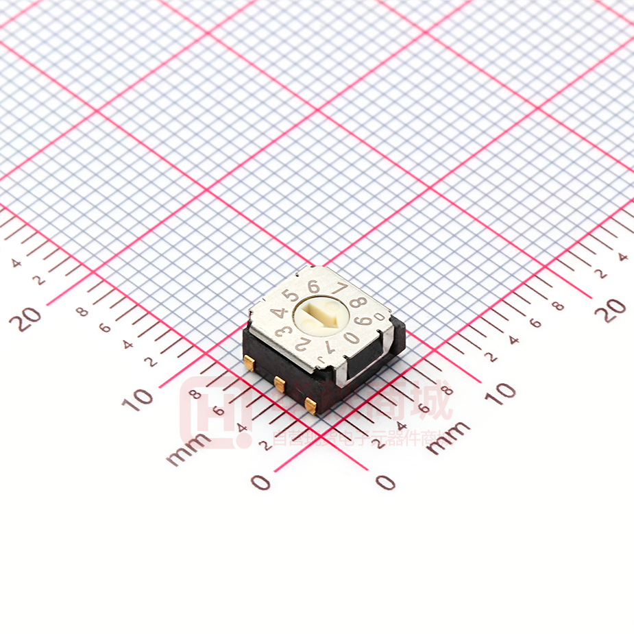

ROTARY CODED SWITCHES (SMD) RoHS compliant SH-7000 INTERNAL STRUCTURE ④ ① ② ③ ⑧ ⑨ ⑦ ⑤ Part name ⑥ Material ① Marking cover Stainless steel (SUS 304) ■ FEATURES ② Cover Stainless steel (SUS 301) ● RoHS compliant ● Center Common terminal pins location ● High digit visibility ● Gray code output available ● Washable ③ “O” ring ④ Flammability — Silicone rubber UL94HB Rotor Polyphenylenesulphide UL94V-0 ⑤ Spacer Stainless steel (SUS 304) ⑥ Moving contact ⑦ Fixed contact ⑧ Housing ⑨ Terminal pin — Copper alloy, Gold-plated Polyphenylenesulphide UL94V-0 Copper alloy, Gold-plated — ■ PART NUMBER DESIGNATION S H - 7 0 1 0 T A Series name Shape of terminal Shape of rotor A:J-hook B:Gull wing C:Through hole pins 0:Without knob (Minus slot) Form of packaging Code format 1:10 positions, real code 3:10 positions, complementary code 4:10 positions, gray code 5:16 positions, real code 7:16 positions, complementary code 8:16 positions, gray code ※ Please refer to the LIST OF PART NUMBERS when placing orders. T :Taping (Reel) M:Magazine Setting position 0:Top setting SH-7000 ROTARY CODED SWITCHES (SMD) ■ CODE FORMAT 16 positions No. of positions            10 positions Position 0 1 2 3 4 5 6 7 8 9 A B C D E F 8 Real code 4 2 1 Code Complementary code Gray code ● ● ● ● ● ● ● ● ● ● ● ● ● ● 8 ● ● ● ● 4 ● 2 ● ● ● ● ● ● ● ● ● ● ● ● 2 ● ● 1 ● A J-hook B Gull wing Taping C Through hole pins Taping Top setting Minus slot Magazine Magazine Magazine ● ● ● Taping ● ● ● ● Form of packaging ● ● ● ● Shape of terminal ● ● ● 4 Shape of rotor ● ● ● ● ● ● ● ● ● ● ● ● ● ● ● ● ● ● ● ● ● ● ● ● ● ● ● ● ● ● ● ● ● ● ● …Contact closed ■ LIST OF PART NUMBERS Setting position ● ● ● ● ● ● ● ● ● ● 1 ● 8 ● ● ● Binary coded decimal Binary coded hexadecimal Real code Complementary code Gray code Real code Complementary code Gray code Pieces in package SH-7010TA SH-7030TA SH-7050TA SH-7070TA 500 pcs./reel SH-7010MA SH-7030MA SH-7050MA SH-7070MA 50 pcs./stick SH-7010TB SH-7030TB SH-7040TB SH-7050TB SH-7070TB SH-7080TB 500 pcs./reel SH-7010MB SH-7030MB SH-7040MB SH-7050MB SH-7070MB SH-7080MB 50 pcs./stick SH-7010MC SH-7030MC SH-7050MC SH-7070MC 50 pcs./stick   : Not manufactured ※ Verify the above part numbers when placing orders.Taping and magazine version can be supplied only in reel or stick unit. ■ STANDARD SPECIFICATIONS Circuit type Operating temperature range Storage temperature range Sealing Net weight BCD (Real code, Complementary code, Gray code) BCH (Real code, Complementary code, Gray code) − 40 ~ 85 °C − 40 ~ 105 °C (Gray code) ■ ELECTRICAL CHARACTERISTICS Contact rating Non-switching Switching Minimum Contact resistance Insulation resistance Washable by “O” ring ※ Please refer to page 150,151 Approx. 0.38 g Dielectric strength DC50 V 100 mA DC5 V 100 mA DC20 mV 1 μ A 100 m Ω maximum 1000 M Ω (DC100 V) minimum AC250 V, 60 s SH-7000 ROTARY CODED SWITCHES (SMD) ■ MECHANICAL CHARACTERISTICS ■ ENVIRONMENTAL CHARACTERISTICS 10, 16 No. of positions 3 ~ 20 mN·m { 3~ 204 gf·cm} Adjustment torque Stepping angle 36° (10 positions) 22.5° (16 positions) Solderability 245 ± 3 °C, 2 ~ 3 s Amplitude 1.5 mmor Acceleration 98 m/s2, 10-500-10 Hz, 3 directions for 2 h each Vibration 490 m/s2, 11 ms 6 directions for 3 times each Shock Load life 10000 steps minimum, DC5 V, 100 mA Humidity 40 °C, Relative humidity 90 ~ 95 %, 240 h Reflow:255 °C (Peak temperature) Reflow : Peak temperature 255 °C (Please refer to the profile below.) Flow : 260 ± 3 °C as the temperature in a pot of molten solder, immer­sion from head of ter­minal to backside of board,5 ~ 6 s, two times maximum Low temperature exposure − 40 °C, 96 h − 40 (0.5 h) ~ 85 °C ( 0.5 h ), 5 cycles − 40 (0.5 h) ~ 105 °C ( 0.5 h ), 5 cycles (Gray code) 〈Reflow profile for soldering heat evaluation〉 Manual soldering: 350 ± 10 °C, 3 ~ 4 s (℃) 250 Shear (adhesion) 5 N {0.51 kgf} 10 s Substrate bending Width 90 mm, bend 3 mm, 5 s, 1 time 5 N {0.51 kgf} 10s Pull-off strength 85 °C, 96 h 105 °C, 96 h (Gray code) Thermal shock { } : Reference only Temperature Soldering heat High temperature exposure ℃ Over 230 ℃ Peak : 250 200 Pre Heating Zone 180 ℃ 150 ℃ 150 +5 0 90 ± 30 s 100 30 ± 10 s 50 Soldering Zone Heating time Reflow : two times maximum ■ OUTLINE DIMENSIONS Unless otherwise specified, tolerance: ± 0.3 (Unit: mm) ● SH-7010B (Real code) ● SH-7030B (Complementary code) Production date code 7.3 7.3 3.75 0.7 W × 2.8 L × 1 D Marking appears only with complementary code 2.54 2.54 10 7.1 5.1 7.5 7.1 ② Ⓒ ⑧ ④ Ⓒ ① 6 – 0.6 t = 0.15 ④ Ⓒ ① 6 – 0.6 t = 0.15 0.65 min. Production date code ② Ⓒ ⑧ 0.7 W × 2.8 L × 1D 3.75 Marking appears only with complementary code 0.65 min. ● SH-7010A (Real code) ● SH-7030A (Complementary code) 2.54 2.54 SH-7000 ROTARY CODED SWITCHES (SMD) ■ OUTLINE DIMENSIONS Unless otherwise specified, tolerance: ± 0.3 (Unit: mm) ● SH-7010C (Real code) ● SH-7030C (Complementary code) ● SH-7050A (Real code) ● SH-7070A (Complementary code) Production date code 7.3 Production date code ④ Ⓒ ① 3.5 ± 1 2.54 2.54 5.1 3.7 0.7 W × 2.8 L × 1 D 7.5 ② Ⓒ ⑧ 6 – 0.6 t = 0.15 ④ Ⓒ ① 7.1 7.1 7.62 ± 0.5 7.3 Marking appears only with complementary code ② Ⓒ ⑧ 3.75 2.54 2.54 0.7 W × 2.8 L × 1 D 6 – 0.6 t = 0.15 Marking appears only with complementary code ● SH-7050B (Real code) ● SH-7070B (Complementary code) ● SH-7050C (Real code) ● SH-7070C (Complementary code) Production date code 7.3 Production date code 0.65 min. ② Ⓒ ⑧ 10 7.1 7.1 ④ Ⓒ ① ④ Ⓒ ① 6 – 0.6 t = 0.15 7.62 ± 0.5 7.3 0.7 W × 2.8 L × 1 D 3.7 3.5 ± 1 2.54 2.54 ② Ⓒ ⑧ 0.7 W × 2.8 L × 1 D 3.75 0.65 min. Marking appears only with complementary code 2.54 2.54 6 – 0.6 t = 0.15 Marking appears only with complementary code ● SH-7040B (Gray code) ● SH-7080B (Gray code) Production date code 10 ⑧ 0.7 W × 2.8 L × 1 D 3.75 0.65 min. ② 7.3 2.54 ④ Ⓒ 0.65 min. ① 5 – 0.8 t = 0.15 ① ② 5.08 2.54 5 – 0.8 t = 0.15 10 Ⓒ 7.1 ④ 2.54 ⑧ 0.7 W × 2.8 L × 1 D 3.75 0.65 min. 7.3 7.1 0.65 min. Production date code 5.08 2.54 SH-7000 ROTARY CODED SWITCHES (SMD) ■ RECOMMENDED P.C.B. PAD OUTLINE DIMENSIONS ● A type ● B type ● Gray code (Unit: mm) 2.5 0 1 5.08 1 5.08 0 1 0 3 5.08 3 9 11 11 注)0点は搭載中心とする Note) The zero point is the center of mounting. ■ TERMINAL CONNECTION / P.C.B. THROUGH HOLE DIMENSIONS (Unit: mm) Top setting (Through Through holehole) Real code Complementary code Top setting (Through hole) P.C.B. dimensions (Bottom view) Real code 8 1 C C 4 2 8 1 C 2 2.54 ± 0.1 2.54 ± 0.1 Terminal pin layout (Bottom view) Complementary code 8 1 C C 4 2 8 1 C 2 C 4 C 4 2.54 ± 0.1 6 – φ 1 hole 2.54 ± 0.1 6 – φ 1 hole SH-7000 case SH-7000 case ■ PACKAGING SPECIFICATIONS ● Taping version is packaged in 500 pcs. per reel. Orders will be accepted for units of 500 pcs., i.e., 500, 1000, 1500, pcs., etc. ● Taping version is boxed with one reel (500 pcs.). Maximum number of consecutive missing pieces = 2 Leader length and reel dimension are shown in the diagrams below: SH-7000 ROTARY CODED SWITCHES (SMD) ● Embossed tape dimensions ● Reel dimensions (Unit: mm) (Conforms to JIS C 0806-3) (In accordance with EIAJ ET-7200A) 25.4 ± 1 Empty 2 ± 0.5 φ 13 ± 0.2 End Head 40 mm min. Direction of feed φ 21 ± 0.8 20 pitches min. Leader 400 mm min. φ 330 ± 2 Filled φ 100 ± 1 Empty Part No. label 29.4 ± 1 ● SH-70 □ 0TA ● SH-70 □ 0TB 12 ± 0.1 4 ± 0.1 2 ± 0.1 24 456 23 901 0.4 ± 0.1 11.5 ± 0.1 φ 1.5 +0.1 0 1.75 ± 0.1 (Unit: mm) 78 4.3 Direction of feed ■ PACKAGING SPECIFICATIONS ● Please order the multiple numbers of the specific packing quantities. Pieces in package : 50 pcs./stick ● Magazine dimensions (Unit : mm) 17.2 13.4 magazine length:390 ± 3mm long
