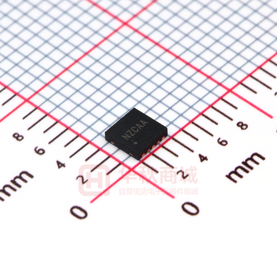

Pinout (top view)
(DFN3X3-10)
Top mark: NZxyz (Device code: NZ, x=year code, y=week code, z= lot number code)
