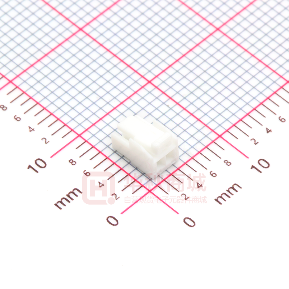

    胶壳 间距P=1.25mm 2Pin(1x2)
GHR-02V-S 数据手册
Specifications ––––––––––––––––––– Developed for PDP, LCD or small electronics equipment. This low insertion force type connector realizes easier mating operation. The basic concept of the contact part of this connector is equivalent to the performance proven SHL connector. • Secure locking structure • Contact lock structure • Prevention of contact deformation • Clear engagement click sounds • Current rating: 1.0 A AC, DC (AWG #26) • Voltage rating: 50 V AC, DC • Temperature range: -25˚C to +85˚C (including temperature rise in applying electrical current) • Contact resistance: Initial value/ 30 mΩ max. After environmental tests/ 50 mΩ max. • Insulation resistance: 100 MΩ min. • Withstanding voltage: 500 VAC/minute • Applicable wire: Conductor size/ AWG #30 to #26 Insulation O.D./ 0.76 to 1.0 mm * Refer to "General Instruction and Notice when using Terminals and Connectors" at the end of this catalog. * Contact JST for details. * Compliant with RoHS. Standards –––––––––––––––––––––– 0 Recognized E60389 PC board layout and Assembly layout Top entry type Side entry type 4.25 0.6 ±0.05 0.6 ±0.05 1.25 ±0.05 1.25±0.05 ±0.1 5.4 ±0.1 4.35 2.7 ±0.1 ±0.1 3.7 ±0.1 5.6 ±0.1 7.3 0.25 1.35 1 1.35 ±0.1 0.3 ±0.1 ±0.1 3.9 2.8 ±0.1 ±0.1 7.15 1 ±0.1 Note: 1. The above figure is the figure viewed from the connector mounting side. 2. Tolerances are non-cumulative: ±0.05 mm for all centers. 3. The dimensions above should serve as a guideline. Contact JST for details. Contact mm2 AWG# Insulation O.D. (mm) Q'ty/reel 0.05∼0.13 30∼26 0.76∼1.0 35,000 4.8 2.1 0.6 0.85 2.3 0.8 0.4 RoHS compliance Note: 1. Contact JST for gold-plated product. 2. This contact can be applied only for the GH connector. SSHL-003( )-P0.2 cannot be applied for the GH connector. Contact AP-K2N 1 Applicator Dies Crimp applicator with dies MKS-L-10-3 MK/SSHL-002-02 APLMK SSHL002-02 − − − Crimping machine Crimp applicator Housing Q'ty/ bag 5.7 4.15 Circuit No.1 1.25 2.65 A B RoHS compliance As the color identification, the following alphabet shall be put in the underlined part. For availability, delivery and minimum order quantity, contact JST. ex. GHR-04V-SS…natural (white) LE…light blue TR…tomato red K…black E…blue O…orange L…lemon yellow MG…moss green DPK…dark pink Shrouded header Top entry type Circuits 0.7 4.05 4.25 1.25 0.2 Circuit No.1 A B Side entry type 4.05 Model No. Dimensions (mm) A B 2 1.25 5.75 2,500 3 2.50 7.00 2,500 4 3.75 8.25 2,500 5 5.00 9.50 2,500 6 6.25 10.75 2,500 7 7.50 12.00 2,500 8 8.75 13.25 2,500 9 10.00 14.50 2,500 10 11.25 15.75 2,500 11 12.50 17.00 2,500 12 13.75 18.25 2,500 13 15.00 19.50 2,500 14 16.25 20.75 2,500 15 17.50 22.00 2,500 0.8 4.25 Material and Finish RoHS compliance This product displays (LF)(SN) on a label. Note: Contact JST for gold-plated product. Circuit No.1 1.25 0.2 A B 1.75 As the color identification, the following alphabet shall be put in the underlined part. For availability, delivery and minimum order quantity, contact JST. ex. BM04B-GHS-TBTS…natural (ivory) LE…light blue TR…tomato red K …black E…blue O…orange L…lemon yellow MG…moss green DPK…dark pink 2 Housing (Keying pattern A) 4.15 3.75 6.25 5.7 7.50 RoHS compliance 2.95 B As the color identification, the following alphabet shall be put in the underlined part. For availability, delivery and minimum order quantity, contact JST. ex. 1.25 GHR-04V-2PP…purple (for keying pattern A) HD…dark gray (for keying pattern B) Circuit No.1 A Shrouded header (Keying pattern A) Top entry type Circuits A 1.25 Circuit No.1 0.2 Model No. Dimensions (mm) A B 2 1.25 5.75 2,500 4 3.75 8.25 2,500 5 5.00 9.50 2,500 Material and Finish RoHS compliance This product displays (LF)(SN) on a label. 4.25 0.7 4.05 ex. B Side entry type 4.05 Circuit No.1 1.25 0.2 A B 3 1.75 As the color identification, the following alphabet shall be put in the underlined part. For availability, delivery and minimum order quantity, contact JST. 0.8 BM04B-GHP-A-TBTP…purple (for keying pattern A) HD…dark gray (for keying pattern B) Housing (Keying pattern B) Q'ty/ bag 5.7 4.15 RoHS compliance 2.95 B As the color identification, the following alphabet shall be put in the underlined part. For availability, delivery and minimum order quantity, contact JST. ex. GHR-02V-3HDP…purple (for keying pattern A) HD…dark gray (for keying pattern B) Circuit No.1 1.25 A Shrouded header (Keying pattern B) Circuits Top entry type A 1.25 0.2 Circuit No.1 Model No. Dimensions (mm) A B 2 1.25 5.75 2,500 4 3.75 8.25 2,500 5 5.00 9.50 2,500 Material and Finish RoHS compliance This product displays (LF)(SN) on a label. Note: Contact JST for gold-plated products. 4.25 0.7 As the color identification, the following alphabet shall be put in the underlined part. For availability, delivery and minimum order quantity, contact JST. 4.05 ex. BM04B-GHHD-B-TBTP…purple (for keying pattern A) HD…dark gray (for keying pattern B) B Side entry type 0.8 4.25 4.05 Circuit No.1 1.25 0.2 1.75 A B 4
