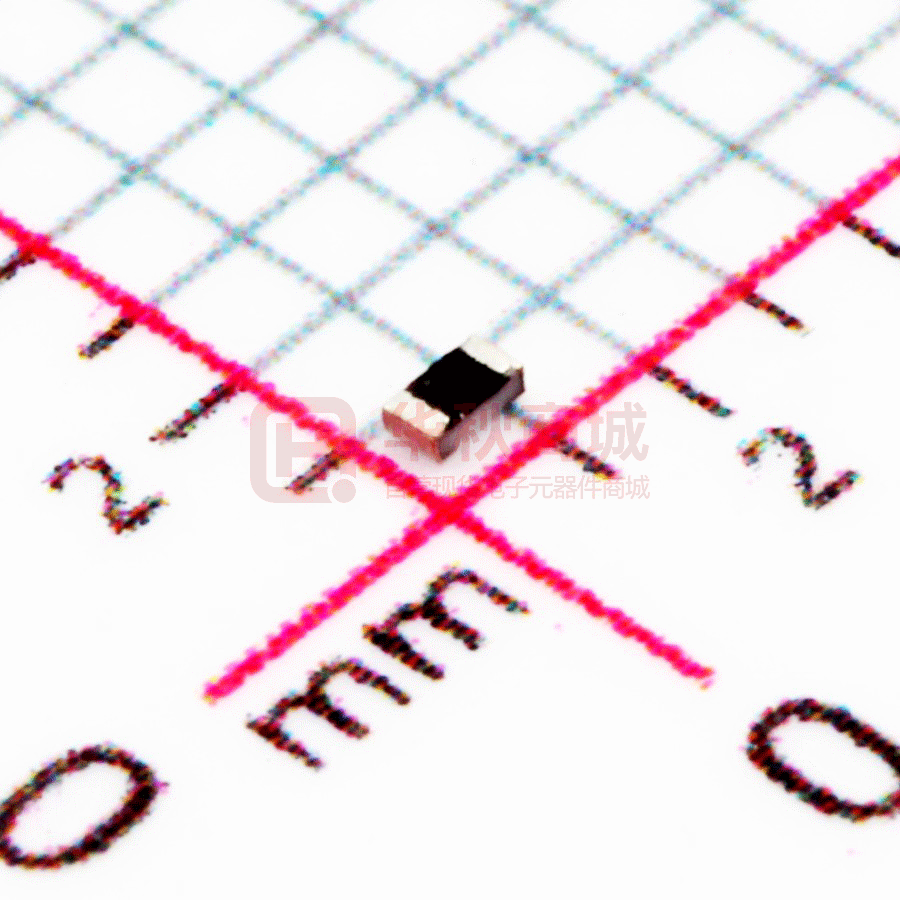

    贴片电阻 0402 107Ω ±1% 1/16W ±100ppm/℃
RC0402FR-07107RL 数据手册
DATA SHEET GENERAL PURPOSE CHIP RESISTORS RC_L series ±0.1%, ±0.5%, ±1%, ±5% Sizes 0075/0100/0201/0402/0603/0805/ 1206/1210/1218/2010/2512 Product specification – May 15, 2020 V.11 RoHS compliant & Halogen free Product specification Chip Resistor Surface Mount SCOPE This specification describes RC series chip resistors with lead free terminations made by thick film process. RC_L SERIES 2 10 0075 to 2512 ORDERING INFORMATION - GLOBAL PART NUMBER Global part numbers are identified by the series, size, tolerance, packing type, temperature coefficient, taping reel and resistance value. GLOBAL PART NUMBER RC XXXX X X X XX XXXX L APPLICATIONS  All general purpose application (1) (2) (3) (4) (5) (6) (7) (1) SIZE 0075/0100/0201/0402/0603/0805/1206/1210/1218/2010/2512 FEATURES  Halogen Free Epoxy  RoHS compliant  Products with lead free terminations meet RoHS requirements  Pb-glass contained in electrodes, resistors element and glass are exempted by RoHS  Reducing environmentally hazardous wastes  High component and equipment reliability  Saving of PCB space  None forbidden-materials used in products/production (2) TOLERANCE B = ± 0.1% D = ± 0.5% F = ± 1.0% J = ± 5.0% (for jumper ordering, use code of J) (3) PACKAGING TYPE R = Paper taping reel K = Embossed taping reel S = ESD safe reel (0075/0100 only) (4) TEMPERATURE COEFFICIENT OF RESISTANCE -= Based on spec. (5) TAPING REEL & POWER 07= 7 inch dia. Reel 10=10 inch dia. Reel 13=13 inch dia. Reel 7W = 7 inch dia. Reel & 2 x standard power 7N = 7 inch dia. Reel, ESD safe reel (0075/0100 only) 3W = 13 inch dia. Reel & 2 x standard power (6) RESISTANCE VALUE There are 2~4 digits indicated the resistance value. Letter R/K/M is decimal point Example: 97R6 = 97.6Ω 9K76 = 9760Ω 1M = 1,000,000Ω (7) DEFAULT CODE Letter L is the system default code for ordering only. (Note) ORDERING EXAMPLE The ordering code for a RC0402 0.0625W chip resistor value 100KΩwith ±5% tolerance, supplied in 7-inch tape reel of 10,000 units per reel is: RC0402JR-07100KL. NOTE 1. All our RSMD products meet RoHS compliant and Halogen Free. "LFP" of the internal 2D reel label mentions "Lead Free Process". 2. On customized label, "LFP" or specific symbol can be printed. www.yageo.com Jul. 7, 2020 V.11 Product specification Chip Resistor Surface Mount RC_L SERIES 3 10 0075 to 2512 MARKING RC0075 / RC0100 / RC0201 / RC0402 No Marking ynsc007 Fig. 1 RC0603 0 1%, 0.5%,E24 exception values 10/11/13/15/20/75 of E24 series YNSC037 Fig. 2 240 = 24 × 100 = 24 88 YNSC038 1%, 0.5%, E96 refer to EIA-96 marking method, including values 10/11/13/15/20/75 of E24 series Fig. 3 88A = 806 × 100 = 806 Ω 03 YNSC001 5%, E24 series : 3 digits First two digits for significant figure and 3rd digit for number of zeros Fig. 4 Value = 10 KΩ RC0805 / RC1206 / RC1210 / RC2010 / RC2512 00 YNSC004 1%, 0.5%, E24/E96 series : 4 digits First three digits for significant figure and 4th digit for number of zeros Fig. 5 Value = 10 KΩ 03 YNSC001 5%, E24 series : 3 digits First two digits for significant figure and 3rd digit for number of zeros Fig. 6 Value = 10 KΩ RC1218 E-24 series: 3 digits, ± 5% First two digits for significant figure and 3rd digit for number of zeros YNSC099 Fig. 7 Value = 10 KΩ 00 Both E-24 and E-96 series: 4 digits, ± 1% & ± 0.5% First three digits for significant figure and 4th digit for number of zeros YNSC103 Fig. 8 Value = 10 KΩ For further marking information, please see special data sheet "Chip resistors marking". www.yageo.com Jul. 7, 2020 V.11 Product specification Chip Resistor Surface Mount SERIES RC_L 4 10 0075 to 2512 Outlines CONSTRUCTION The resistor is constructed on top of a high-grade ceramic body. Internal metal electrodes are added on each end to make the contacts to the thick film resistive element. The composition of the resistive element is a noble metal imbedded into a glass and covered by a second glass to prevent environmental influences. The resistor is laser trimmed to the rated resistance value. The resistor is covered with a protective epoxy coat, finally the two external terminations (matte tin on Ni-barrier) are added, as shown in Fig.9. For dimensions, please refer to Table 1 marking layer overcoat primary glass layer resistive layer (Jumper chip is a conductor) inner electrode termination(Ni/matte tin) inner electrode H ceramic substrate I2 overcoat I1 W YNSC086 L 9 Fig. 9 Chip resistor outlines DIMENSION Table 1 TYPE RC0075 L (mm) W (mm) H (mm) I1 (mm) I2 (mm) 0.30±0.01 0.15±0.01 0.13±0.01 0.08±0.03 0.08±0.03 RC0100 0.40±0.02 0.20±0.02 0.13±0.02 0.10±0.03 0.10±0.03 RC0201 RC0402 0.60±0.03 0.30±0.03 0.23±0.03 0.10±0.05 0.15±0.05 1.00±0.05 0.50±0.05 0.35±0.05 0.20±0.10 0.25±0.10 RC0603 RC0805 RC1206 1.60±0.10 0.80±0.10 0.45±0.10 0.25±0.15 0.25±0.15 2.00±0.10 1.25±0.10 0.50±0.10 0.35±0.20 0.35±0.20 3.10±0.10 1.60±0.10 0.55±0.10 0.45±0.20 0.40±0.20 RC1210 RC1218 3.10±0.10 2.60±0.15 0.55±0.10 0.45±0.15 0.50±0.20 3.10±0.10 4.60±0.10 0.55±0.10 0.45±0.20 0.40±0.20 RC2010 5.00±0.10 2.50±0.15 0.55±0.10 0.60±0.20 0.50±0.20 RC2512 6.35±0.10 3.10±0.15 0.55±0.10 0.60±0.20 0.50±0.20 ELECTRICAL CHARACTERISTICS Table 2 CHARACTERISTICS POWER OPERATING TEMPERATURE RANGE RC0075 -55℃ to 125℃ 1/50 outlines W Fig. 4 Chip resistor RC0100 1/32 W -55℃ to 125℃ MAXIMUM WORKING VOLTAGE 10V 15V MAXIMUM DIELECTRIC OVERLOAD WITHSTANDING VOLTAGE VOLTAGE 25V 30V 25V 30V RESISTANCE RANGE TEMPERATURE COEFFICIENT JUMPER CRITERIA 5% (E24) 10Ω≦R
RC0402FR-07107RL
物料型号:YAGEO Phicomp RC_L系列普通用途芯片电阻器,包括多种尺寸如0075、0100、0201、0402、0603、0805、1206、1210、1218、2010、2512等。
器件简介:RC_L系列芯片电阻器采用无铅端子制造,通过厚膜工艺制作,符合RoHS标准,无卤素,减少环境有害物质的排放,提高组件和设备的可靠性,节省PCB空间。
引脚分配:文档中没有明确指出具体的引脚分配图,但通常这类表面贴装电阻器有两端子用于连接电路。
参数特性:电阻器的公差范围为±0.1%、±0.5%、±1%、±5%,具有不同的包装类型(如纸质胶带卷、压花胶带卷、防静电安全卷)和不同的温度系数。
功能详解:电阻器构建在高级陶瓷基板上,内部金属电极在两端与厚膜电阻元件接触,电阻元件由嵌入玻璃中的贵金属组成,并通过激光修整至额定电阻值,覆盖有保护性环氧涂层和外部端子。
应用信息:适用于所有一般用途的应用场景。
封装信息:提供了不同尺寸的详细尺寸信息,包括长度、宽度、高度、内径和外径。
电气特性:包括功率、工作温度范围、最大工作电压、最大电压、介电过载电压、电阻范围、温度系数和跳线标准等详细信息。
测试和要求:包括电阻温度系数、寿命/耐久性、高温暴露、耐湿性、湿热、热冲击、板弯曲/弯曲、焊接性和耐焊热测试等。
