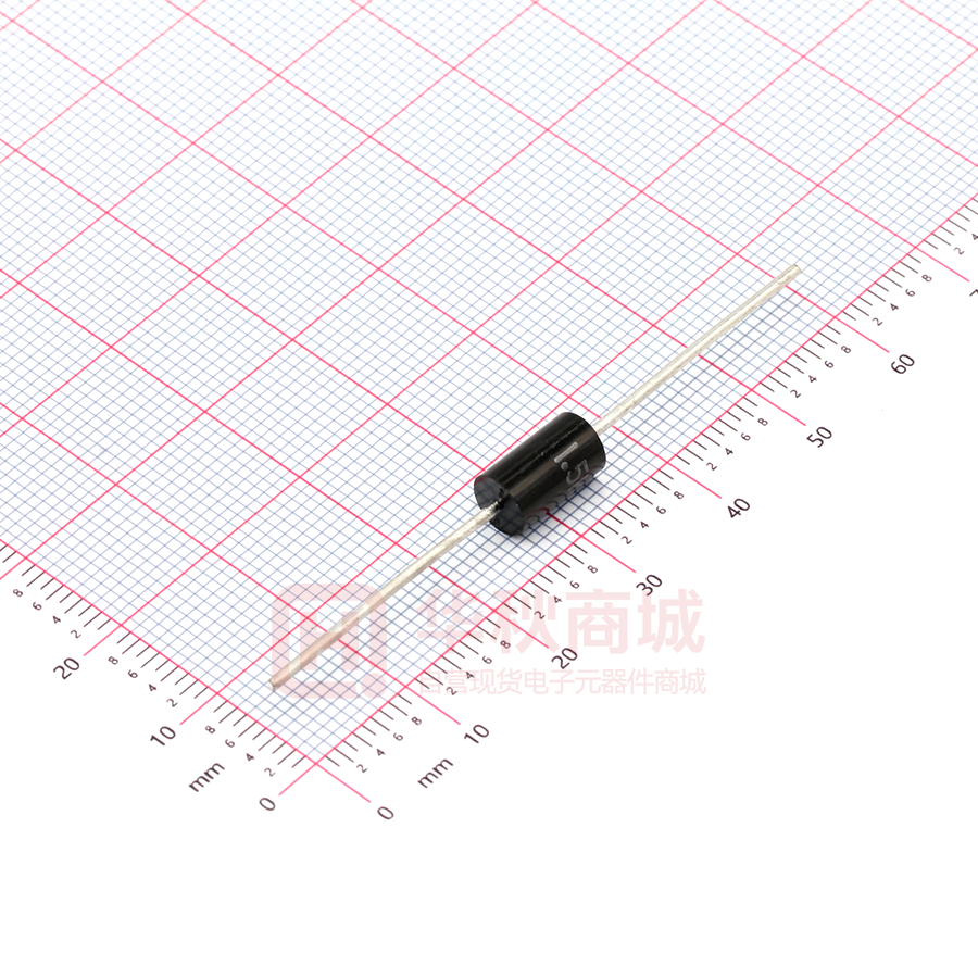

    DO201AD
    轴向引线瞬态电压抑制二极管
1.5KE39CA 数据手册
1.5KE6.8A(CA) - 1.5KE600A(CA) AXIAL LEADED TRANSIENT VOLTAGE SUPPRESSOR DIODE VOLTAGE RANGE: 6.8 - 600 V POWER: 1500Wa t t s Features ! Glass Passivated Die Construction 6.8V – 6 0 0 V Standoff Voltage ! Uni- and Bi-Directional Versions Available ! Excellent Clamping Capability B A A ! Fast Response Time ! Plastic Case Material has UL Flammability C D Mechanical Data ! Case: DO-201AD Molded Plastic DO-201AD ! Terminals: Axial Leads, Solderable per MIL-STD-202, Method 208 ! Polarity: Cathode Band or Cathode Notch Dim Min A 25.40 ¾ B 7.20 9.50 C 1.00 1.20 D 4.80 5.30 ! Unidirectional – Device Code and Cathode Band ! Bidirectional – Device Code Only ! Weight: 1.20 grams (approx.) Max All Dimensions in mm Maximum Ratings and Electrical Characteristics Characteristic @TA=25°C unless otherwise specified Symbol Value Unit Peak Pulse Power Dissipation at TA = 25°C (Note 1, 2, 5) Figure 3 PPPM 1500 Minimum W Peak Forward Surge Current (Note 3) IFSM 200 A Peak Pulse Current on 10/1000µS Waveform (Note 1) Figure 1 IPPM See Table 1 A Steady State Power Dissipation (Note 2, 4) PM(AV) 5.0 W Operating and Storage Temperature Range Tj, TSTG -65 to +175 °C Note: 1. Non-repetitive current pulse, per Figure 1 and derated above TA = 25°C per Figure 4. 2. Mounted on 40mm2 copper pad. 3. 8.3ms single half sine-wave duty cycle = 4 pulses per minutes maximum. 4. Lead temperature at 75°C = TL . 5. Peak pulse power waveform is 10/1000µS. 1 of 5 www.sunmate.tw Reverse Stand-Off Voltage TYPE (UNI) (BI) VRWM (V) Breakdown Voltage Min. @IT Breakdown Voltage Max. @ IT Current Maximum Clamping Voltage @IPP VBR MIN(V) VBR MAX(V) IT (mA) VC(V) Test Peak Pulse Current Reverse Leakage @VRWM IPP(A) IR(uA) 1.5KE6.8 1.5KE6.8C 5.50 6.12 7.48 10 10. 140.7 1000.0 1.5KE6.8A 1.5KE6.8CA 5.80 6.45 7.14 10 10. 144.8 1000.0 1.5KE7.5 1.5KE7.5C 6.05 6.75 8.25 10 11.7 129.9 500.0 1.5KE7.5A 1.5KE7.5CA 6.40 7.13 7.88 10 11.3 134.5 500.0 1.5KE8.2 1.5KE8.2C 6.63 7.38 9.02 10 12. 121.6 200.0 1.5KE8.2A 1.5KE8.2CA 7.02 7.79 8.61 10 12.1 125.6 200.0 1.5KE9.1 1.5KE9.1C 7.37 8.19 10.0 1.0 13. 110.1 50.0 1.5KE9.1A 1.5KE9.1CA 7.78 8.65 9.55 1.0 13. 113.4 50.0 1.5KE10 1.5KE10C 8.10 9.00 11.0 1.0 15.0 101.3 10.0 1.5KE10A 1.5KE10CA 8.55 9.50 10.5 1.0 14.5 104.8 10.0 1.5KE11 1.5KE11C 8.92 9.90 12.1 1.0 16.2 93.8 5.0 1.5KE11A 1.5KE11CA 9.40 10.5 11.6 1.0 15.6 97.4 5.0 5.0 1.5KE12 1.5KE12C 9.72 10.8 13.2 1.0 17.3 87.9 1.5KE12A 1.5KE12CA 10.2 11.4 12.6 1.0 16.7 91.0 5.0 1.5KE13 1.5KE13C 10.5 11.7 14.3 1.0 19.0 80.0 5.0 1.5KE13A 1.5KE13CA 11.1 12.4 13.7 1.0 18.2 83.5 5.0 1.5KE15 1.5KE15C 12.1 13.5 16.5 1.0 22.0 69.1 5.0 1.5KE15A 1.5KE15CA 12.8 14.3 15.8 1.0 21.2 71.7 5.0 1.5KE16 1.5KE16C 12.9 14.4 17.6 1.0 23.5 64.7 5.0 1.5KE16A 1.5KE16CA 13.6 15.2 16.8 1.0 22.5 67.6 5.0 1.5KE18 1.5KE18C 14.5 16.2 19.8 1.0 26.5 57.4 5.0 1.5KE18A 1.5KE18CA 15.3 17.1 18.9 1.0 25.2 60.3 5.0 1.5KE20 1.5KE20C 16.2 18.0 22.0 1.0 29.1 52.2 5.0 1.5KE20A 1.5KE20CA 17.1 19.0 21.0 1.0 27.7 54.9 5.0 1.5KE22 1.5KE22C 17.8 19.8 24.2 1.0 31.9 47.6 5.0 1.5KE22A 1.5KE22CA 18.8 20.9 23.1 1.0 30.6 49.7 5.0 1.5KE24 1.5KE24C 19.4 21.6 26.4 1.0 34.7 43.8 5.0 1.5KE24A 1.5KE24CA 20.5 22.8 25.2 1.0 33.2 45.8 5.0 1.5KE27 1.5KE27C 21.8 24.3 29.7 1.0 39.1 38.9 5.0 1.5KE27A 1.5KE27CA 23.1 25.7 28.4 1.0 37.5 40.5 24.3 27.0 33.0 1.0 43.5 34.9 5.0 5.0 31.5 1.0 41.4 36.7 5.0 1.5KE30 1.5KE30C 1.5KE30A 1.5KE30CA 25.6 28.5 1.5KE33 1.5KE33C 26.8 29.7 36.3 1.0 47.7 31.9 5.0 1.5KE33A 1.5KE33CA 28.2 31.4 34.7 1.0 45.7 33.3 5.0 1.5KE36 1.5KE36C 29.1 32.4 39.6 1.0 52.0 29.2 5.0 49.9 30.5 5.0 1.5KE36A 1.5KE36CA 30.8 34.2 37.8 1.0 For Bi-directional type having VRWM of 10 Volts and less, the IR limit is double 2 of 5 www.sunmate.tw (UNI) Breakdown Voltage Min. @IT Breakdown Voltage Max. @ IT Current Maximum Clamping Voltage @IPP VRWM (V) VBR MIN(V) VBR MAX(V) IT (mA) VC(V) IPP(A) IR(uA) Reverse Stand-Off Voltage TYPE (BI) Test Peak Pulse Current Reverse Leakage @VRWM 1.5KE39 1.5KE39C 31.6 35.1 42.9 1.0 56.4 27.0 5.0 1.5KE39A 1.5KE39CA 33.3 37.1 41.0 1.0 53.9 28.2 5.0 1.5KE43 1.5KE43C 34.8 38.7 47.3 1.0 61.9 24.6 5.0 1.5KE43A 1.5KE43CA 36.8 40.9 45.2 1.0 59.3 25.6 5.0 1.5KE47 1.5KE47C 38.1 42.3 51.7 1.0 67.8 22.4 5.0 1.5KE47A 1.5KE47CA 40.2 44.7 49.4 1.0 64.8 23.5 5.0 1.5KE51 1.5KE51C 41.3 45.9 56.1 1.0 73.5 20.7 5.0 1.5KE51A 1.5KE51CA 43.6 48.5 53.6 1.0 70.1 21.7 5.0 1.5KE56 1.5KE56C 45.4 50.4 61.6 1.0 80.5 18.9 5.0 1.5KE56A 1.5KE56CA 47.8 53.2 58.8 1.0 77.0 19.7 5.0 1.5KE62 1.5KE62C 50.2 55.8 68.2 1.0 89.0 17.1 5.0 1.5KE62A 1.5KE62CA 53.0 58.9 65.1 1.0 85.0 17.9 5.0 1.5KE68 1.5KE68C 55.1 61.2 74.8 1.0 98.0 13.5 5.0 1.5KE68A 1.5KE68CA 58.1 64.6 71.4 1.0 92.0 16.5 5.0 1.5KE75 1.5KE75C 60.7 67.5 82.5 1.0 108 14.1 5.0 1.5KE75A 1.5KE75CA 64.1 71.3 78.8 1.0 103 14.8 5.0 1.5KE82 1.5KE82C 66.4 73.8 90.2 1.0 118 12.9 5.0 1.5KE82A 1.5KE82CA 70.1 77.9 86.1 1.0 113 13.5 5.0 1.5KE91 1.5KE91C 73.7 81.9 100 1.0 131 11.6 5.0 1.5KE91A 1.5KE91CA 77.8 86.5 95.5 1.0 125 12.2 5.0 1.5KE100 1.5KE100C 81.0 90.0 110 1.0 144 10.6 5.0 1.5KE100A 1.5KE100CA 85.5 95.0 105 1.0 137 11.1 5.0 1.5KE110 1.5KE110C 89.2 99.0 121 1.0 158 9.6 5.0 1.5KE110A 1.5KE110CA 94.0 105 116 1.0 152 10.0 5.0 1.5KE120 1.5KE120C 97.2 108 132 1.0 173 8.7 5.0 1.5KE120A 1.5KE120CA 102 114 126 1.0 165 9.2 5.0 1.5KE130 1.5KE130C 105 117 143 1.0 187 8.1 5.0 1.5KE130A 1.5KE130CA 111 124 137 1.0 179 8.5 5.0 1.5KE150 1.5KE150C 121 135 165 1.0 215 7.1 5.0 1.5KE150A 1.5KE150CA 128 143 158 1.0 207 7.3 5.0 1.5KE160 1.5KE160C 130 144 176 1.0 230 6.6 5.0 1.5KE160A 1.5KE160CA 136 152 168 1.0 219 6.9 5.0 1.5KE170 1.5KE170C 138 153 187 1.0 244 6.2 5.0 1.5KE170A 1.5KE170CA 145 162 179 1.0 234 6.5 5.0 1.5KE180 1.5KE180C 146 162 198 1.0 258 5.9 5.0 1.5KE180A 1.5KE180CA 154 171 189 1.0 246 6.2 5.0 3 of 5 www.sunmate.tw (UNI) Breakdown Voltage Max. @ IT Current Maximum Clamping Voltage @IPP VBR MIN(V) VBR MAX(V) IT (mA) VC(V) IPP(A) IR(uA) Reverse Breakdown Stand-Off Voltage Voltage Min. @IT TYPE (BI) VRWM (V) Test Peak Pulse Current Reverse Leakage @VRWM 1.5KE200 1.5KE200C 162 180 220 1.0 287 5.3 5.0 1.5KE200A 1.5KE200CA 171 190 210 1.0 274 5.5 5.0 1.5KE220 1.5KE220C 175 198 242 1.0 344 4.4 5.0 1.5KE220A 1.5KE220CA 185 209 231 1.0 328 4.6 5.0 1.5KE250 1.5KE250C 202 225 275 1.0 360 4.2 5.0 1.5KE250A 1.5KE250CA 214 237 263 1.0 344 4.4 5.0 1.5KE300 1.5KE300C 243 270 330 1.0 430 3.5 5.0 1.5KE300A 1.5KE300CA 256 285 315 1.0 414 3.7 5.0 1.5KE350 1.5KE350C 284 315 385 1.0 504 3.0 5.0 1.5KE350A 1.5KE350CA 300 333 368 1.0 482 3.2 5.0 1.5KE400 1.5KE400C 324 360 440 1.0 574 2.6 5.0 1.5KE400A 1.5KE400CA 342 380 420 1.0 548 2.8 5.0 1.5KE440 1.5KE440C 356 396 484 1.0 631 2.4 5.0 1.5KE440A 1.5KE440CA 376 418 462 1.0 600 2.5 5.0 1.5KE500 1 5KE500C 406 450 550 1.0 720 2.08 5.0 1.5KE500A 1.5KE500CA 427.5 475 525 1.0 690 2.17 5.0 1.5KE520 1.5KE520C 422.2 468 572 1.0 748.8 2.00 5.0 1.5KE520A 1.5KE520CA 444.6 494 546 1.0 717.6 2.09 5.0 1.5KE550 1.5KE550C 446.6 495 605 1.0 792 1.89 5.0 1.5KE550A 1.5KE550CA 470.3 522..50 577.50 1.0 759 1.98 5.0 1.5KE600 1.5KE600C 487.2 540 660 1.0 864 1.74 5.0 1.5KE600A 1.5KE600CA 513 570 630 1.0 828 1.81 5.0 4 of 5 www.sunmate.tw Ratings and Characteristic Curves TA=25°C unless otherwise noted 5 of 5 www.sunmate.tw
1.5KE39CA
物料型号:1.5KE6.8A(CA) - 1.5KE600A(CA)
器件简介:这些二极管具有玻璃钝化芯片结构,提供6.8V至600V的电压范围,功率为1500W。
引脚分配:采用DO-201AD塑封外壳,轴向引线,可焊接。
参数特性:包括峰值脉冲功率耗散、峰值正向浪涌电流、峰值脉冲电流、稳态功率耗散等。
功能详解:二极管具有快速响应时间,并且符合RoHS标准。
应用信息:文档提供了详细的电气特性表,包括反向工作电压、最小击穿电压、最大击穿电压、测试电流、最大钳位电压、峰值脉冲电流和反向漏电流等参数。
封装信息:提供了机械数据,包括外壳尺寸和重量。
