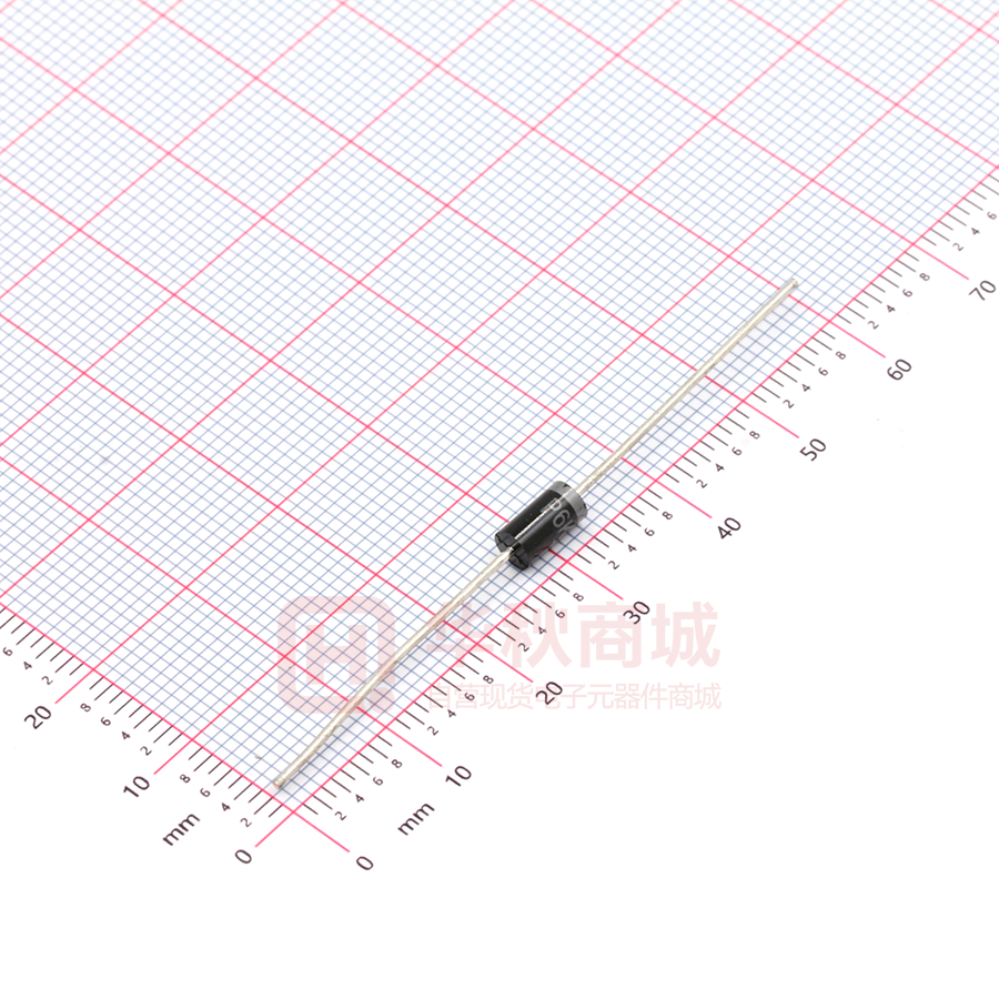

    TVS二极管 VRWM=33V VBR(Min)=37.1V VC=53.9V IPP=11.1A Ppp=600W DO15
P6KE39A 数据手册
P6KE6.8A(CA)-P6KE600A(CA) AXIAL LEADED TRANSIENT VOLTAGE SUPPRESSOR DIODE VOLTAGE RANGE: 6.8 - 600V POWER: 600Wa t t s Features ! Glass Passivated Die Construction ! Uni- and Bi-Directional Versions Available ! Excellent Clamping Capability ! Fast Response Time ! Plastic Case Material has UL Flammability Classification Rating 94V-O B A A C D Mechanical Data · Case : DO-15 Molded plastic · Epoxy : UL94V-O rate flame retardant · Lead : Axial lead solderable per MIL-STD-202, Method 208 guaranteed · Polarity : Color band denotes cathode end · Mounting position : Any · Weight : 0.465 gram DO-15 Dim Min A 25.40 — B 5.50 7.62 C 0.686 0.889 2.60 3.60 D Max All Dimensions in mm Maximum Ratings and Electrical Characteristics @TA=25°C unless otherwise specified Characteristic Symbol Value Unit Peak Pulse Power Dissipation at TA = 25°C (Note 1, 2, 5) Figure 3 PPPM 600 Minimum W Peak Forward Surge Current (Note 3) IFSM 100 A Peak Pulse Current on 10/1000µS Waveform (Note 1) Figure 1 IPPM See Table 1 A Steady State Power Dissipation (Note 2, 4) PM(AV) 5.0 W Operating and Storage Temperature Range Tj, TSTG -65 to +175 °C Note: 1. Non-repetitive current pulse, per Figure 1 and derated above TA = 25°C per Figure 4. 2. Mounted on 40mm2 copper pad. 3. 8.3ms single half sine-wave duty cycle = 4 pulses per minutes maximum. 4. Lead temperature at 75°C = TL . 5. Peak pulse power waveform is 10/1000µS. 1 of 5 www.sunmate.tw TYPE (UNI) (BI) Reverse Stand-Off Voltage Breakdown Voltage Min. @IT Breakdown Voltage Max. @ IT VRWM (V) VBR MIN(V) VBR MAX(V) Current Maximum Clamping Voltage @IPP Peak Pulse Current Reverse Leakage @VRWM IT (mA) VC(V) IPP(A) IR(uA) Test P6KE6.8 P6KE6.8C 5.50 6.12 7.48 10.0 10.8 55.6 1000.0 P6KE6.8A P6KE6.8CA 5.80 6.45 7.25 10.0 10.5 57.1 1000.0 P6KE7.5 P6KE7.5C 6.05 6.75 8.25 10.0 11.7 51.3 500.0 P6KE7.5A P6KE7.5CA 6.40 7.13 7.88 10.0 11.3 53.1 500.0 P6KE8.2 P6KE8.2C 6.63 7.38 9.02 10.0 12.5 48.0 200.0 P6KE8.2A P6KE8.2CA 7.02 7.79 8.61 10.0 12.1 49.6 200.0 P6KE9.1 P6KE9.1C 7.37 8.19 10.0 1.0 13.8 43.5 50.0 P6KE9.1A P6KE9.1CA 7.78 8.65 9.55 1.0 13.4 44.8 50.0 P6KE10 P6KE10C 8.10 9.00 11.0 1.0 15.0 40.0 10.0 P6KE10A P6KE10CA 8.55 9.50 10.5 1.0 14.5 41.4 10.0 P6KE11 P6KE11C 8.92 9.90 12.1 1.0 16.2 37.0 5.0 P6KE11A P6KE11CA 9.40 10.5 11.6 1.0 15.6 38.5 5.0 P6KE12 P6KE12C 9.72 10.8 13.2 1.0 17.3 34.7 5.0 P6KE12A P6KE12CA 10.2 11.4 12.6 1.0 16.7 35.9 5.0 P6KE13 P6KE13C 10.5 11.7 14.3 1.0 19.0 31.6 5.0 P6KE13A P6KE13CA 11.1 12.4 13.7 1.0 18.2 33.0 5.0 P6KE15 P6KE15C 12.1 13.5 16.5 1.0 22.0 27.3 5.0 P6KE15A P6KE15CA 12.8 14.3 15.8 1.0 21.2 28.3 5.0 P6KE16 P6KE16C 12.9 14.4 17.6 1.0 23.5 25.5 5.0 P6KE16A P6KE16CA 13.6 15.2 16.8 1.0 22.5 26.7 5.0 P6KE18 P6KE18C 14.5 16.2 19.8 1.0 26.5 22.6 5.0 P6KE18A P6KE18CA 15.3 17.1 18.9 1.0 25.2 23.8 5.0 P6KE20 P6KE20C 16.2 18.0 22.0 1.0 29.1 20.6 5.0 P6KE20A P6KE20CA 17.1 19.0 21.0 1.0 27.7 21.7 5.0 P6KE22 P6KE22C 17.8 19.8 24.2 1.0 31.9 18.8 5.0 P6KE22A P6KE22CA 18.8 20.9 23.1 1.0 30.6 19.6 5.0 P6KE24 P6KE24C 19.4 21.6 26.4 1.0 34.7 17.3 5.0 P6KE24A P6KE24CA 20.5 22.8 25.2 1.0 33.2 18.1 5.0 P6KE27 P6KE27C 21.8 24.3 29.7 1.0 39.1 15.3 5.0 P6KE27A P6KE27CA 23.1 25.7 28.4 1.0 37.5 16.0 5.0 P6KE30 P6KE30C 24.3 27.0 33.0 1.0 43.5 13.8 5.0 P6KE30A P6KE30CA 25.6 28.5 31.5 1.0 41.4 14.5 5.0 P6KE33 P6KE33C 26.8 29.7 36.3 1.0 47.7 12.6 5.0 P6KE33A P6KE33CA 28.2 31.4 34.7 1.0 45.7 13.1 5.0 P6KE36 P6KE36C 29.1 32.4 39.6 1.0 52.0 11.5 5.0 P6KE36A P6KE36CA 30.8 34.2 37.8 1.0 49.9 12.0 5.0 2 of 5 www.sunmate.tw TYPE (UNI) (BI) Reverse Stand-Off Voltage Breakdown Voltage Min. @IT Breakdown Voltage Max. @ IT VRWM (V) VBR MIN(V) VBR MAX(V) Current Maximum Clamping Voltage @IPP Peak Pulse Current Reverse Leakage @VRWM IT (mA) VC(V) IPP(A) IR(uA) Test P6KE39 P6KE39C 31.6 35.1 42.9 1.0 56.4 10.6 5.0 P6KE39A P6KE39CA 33.3 37.1 41.0 1.0 53.9 11.1 5.0 P6KE43 P6KE43C 34.8 38.7 47.3 1.0 61.9 9.7 5.0 P6KE43A P6KE43CA 36.8 40.9 45.2 1.0 59.3 10.1 5.0 P6KE47 P6KE47C 38.1 42.3 51.7 1.0 67.8 8.8 5.0 P6KE47A P6KE47CA 40.2 44.7 49.4 1.0 64.8 9.3 5.0 P6KE51 P6KE51C 41.3 45.9 56.1 1.0 73.5 8.2 5.0 P6KE51A P6KE51CA 43.6 48.5 53.6 1.0 70.1 8.6 5.0 P6KE56 P6KE56C 45.4 50.4 61.6 1.0 80.5 7.5 5.0 P6KE56A P6KE56CA 47.8 53.2 58.8 1.0 77.0 7.8 5.0 P6KE62 P6KE62C 50.2 55.8 68.2 1.0 89.0 6.7 5.0 P6KE62A P6KE62CA 53.0 58.9 65.1 1.0 85.0 7.1 5.0 P6KE68 P6KE68C 55.1 61.2 74.8 1.0 98.0 6.1 5.0 P6KE68A P6KE68CA 58.1 64.6 71.4 1.0 92.0 6.5 5.0 P6KE75 P6KE75C 60.7 67.5 82.5 1.0 108 5.6 5.0 P6KE75A P6KE75CA 64.1 71.3 78.8 1.0 103 5.8 5.0 P6KE82 P6KE82C 66.4 73.8 90.2 1.0 118 5.1 5.0 P6KE82A P6KE82CA 70.1 77.9 86.1 1.0 113 5.3 5.0 P6KE91 P6KE91C 73.7 81.9 100 1.0 131 4.6 5.0 P6KE91A P6KE91CA 77.8 86.5 95.5 1.0 125 4.8 5.0 P6KE100 P6KE100C 81.0 90.0 110 1.0 144 4.2 5.0 P6KE100A P6KE100CA 85.5 95.0 105 1.0 137 4.4 5.0 P6KE110 P6KE110C 89.2 99.0 121 1.0 158 3.8 5.0 P6KE110A P6KE110CA 94.0 105 116 1.0 152 3.9 5.0 P6KE120 P6KE120C 97.2 108 132 1.0 173 3.5 5.0 P6KE120A P6KE120CA 102 114 126 1.0 165 3.6 5.0 P6KE130 P6KE130C 105 117 143 1.0 187 3.2 5.0 P6KE130A P6KE130CA 111 124 137 1.0 179 3.4 5.0 P6KE150 P6KE150C 121 135 165 1.0 215 2.8 5.0 P6KE150A P6KE150CA 128 143 158 1.0 207 2.9 5.0 P6KE160 P6KE160C 130 144 176 1.0 230 2.6 5.0 P6KE160A P6KE160CA 136 152 168 1.0 219 2.7 5.0 P6KE170 P6KE170C 138 153 187 1.0 244 2.5 5.0 P6KE170A P6KE170CA 145 162 179 1.0 234 2.6 5.0 P6KE180 P6KE180C 146 162 198 1.0 258 2.3 5.0 P6KE180A P6KE180CA 154 171 189 1.0 246 2.4 5.0 3 of 5 www.sunmate.tw Current Maximum Clamping Voltage @IPP Peak Pulse Current Reverse Leakage @VRWM IT (mA) VC(V) IPP(A) IR(uA) 287 2.1 5.0 1.0 274 2.2 5.0 242 1.0 344 1.7 5.0 209 231 1.0 328 1.8 5.0 202 225 275 1.0 360 1.7 5.0 P6KE250CA 214 237 263 1.0 344 1.7 5.0 P6KE300 P6KE300C 243 270 330 1.0 430 1.4 5.0 P6KE300A P6KE300CA 256 285 315 1.0 414 1.4 5.0 P6KE350 P6KE350C 284 315 385 1.0 504 1.2 5.0 P6KE350A P6KE350CA 300 333 368 1.0 482 1.2 5.0 P6KE400 P6KE400C 324 360 440 1.0 574 1.0 5.0 P6KE400A P6KE400CA 342 380 420 1.0 548 1.1 5.0 P6KE440 P6KE440C 356 396 484 1.0 631 0.95 5.0 P6KE440A P6KE440CA 376 418 462 1.0 602 1.0 5.0 P6KE480 P6KE480C 389 432 528 1.0 686 0.88 5.0 P6KE480A P6KE480CA 408 456 504 1.0 658 0.9 5.0 P6KE510 P6KE510C 413 459 561 1.0 729 0.82 5.0 P6KE510A P6KE510CA 434 485 535 1.0 698 0.9 5.0 P6KE530 P6KE530C 457 477 583 1.0 798 0.76 5.0 P6KE530A P6KE540 P6KE530CA P6KE540C 451 437 503.5 486 556.5 594 1.0 1.0 725 772 0.8 0.78 5.0 P6KE540A P6KE540CA 460 513 567 1.0 740 0.8 5.0 P6KE550 P6KE550C 470 495 605 1.0 836 0.76 P6KE550A P6KE550CA 468 522.50 577.50 1.0 760 0.8 5.0 5.0 P6KE600 P6KE600C 490 540 660 1.0 911 0.71 5.0 P6KE600A P6KE600CA 512 570 630 1.0 828 0.75 5.0 Reverse Stand-Off Voltage Breakdown Voltage Min. @IT Breakdown Voltage Max. @ IT (BI) VRWM (V) VBR MIN(V) VBR MAX(V) P6KE200 P6KE200C 162 180 220 1.0 P6KE200A P6KE200CA 171 190 210 P6KE220 P6KE220C 175 198 P6KE220A P6KE220CA 185 P6KE250 P6KE250C P6KE250A TYPE (UNI) 4 of 5 Test 5.0 www.sunmate.tw Tj = 25°C f = 1.0 MHz Vsig = 50mV p-p tr = 10ms 100 Peak Value Ipp Cj, CAPACITANCE (pF) IP, PEAK PULSE CURRENT (%pp) 10,000 Half Value Ipp/2 50 tp Measured at Zero Bias 1000 10 X 1000 Waveform as defined by R.E.A. 0 0 1 2 Measured at Stand-off Voltage 100 10 1 3 10 100 1000 VRWM, REVERSE STANDOFF VOLTAGE (V) t, TIME (ms) Fig. 1 Pulse Waveform Fig. 2 Typical Junction Capacitance PP, PEAK PULSE POWER (kW) 100 IMPULSE 10 1.0 TC = 25°C 0.1 0.1 1.0 10 1000 100 10000 100 Pd , STEADY STATE POWER DISSIPATION (W) PK PULSE DERATING (% PK PWR OR CURRENT) Tp, PULSE WIDTH (µs) Fig. 3 Pulse Rating Curve 75 50 25 10 X 1000 Waveform as defined by REA 0 0 25 50 75 100 125 150 175 5.0 Single Phase Half-Wave 60Hz Resistive or Inductive Load 3.75 2.5 L = 9.5 mm 1.25 40 x 40 x 1 mm Cu 0 200 0 TA, AMBIENT TEMPERATURE (°C) Fig. 4 Pulse Derating Curve 25 50 75 100 125 150 175 200 TL , LEAD TEMPERATURE (°C) Fig. 5, Steady State Power Derating 5 of 5 www.sunmate.tw
P6KE39A
物料型号:P6KE6.8A(CA)-P6KE600A(CA),这些是轴向引线瞬态电压抑制二极管。
器件简介:这些二极管具有玻璃钝化芯片结构,提供单向和双向版本,具有出色的钳位能力、快速响应时间,并且94V-O塑料外壳材料具有UL阻燃等级。
引脚分配:轴向引线,色带表示阴极端,任何位置都可安装。
参数特性:包括峰值脉冲功率耗散、峰值正向浪涌电流、峰值脉冲电流、稳态功率耗散、工作和存储温度范围等。
功能详解:文档提供了详细的电气特性表,包括反向工作电压、最小击穿电压、最大击穿电压、测试电流、最大钳位电压、峰值脉冲电流和反向漏电流等参数。
应用信息:这些瞬态电压抑制二极管适用于多种应用,如电源保护、电机保护等。
封装信息:封装类型为DO-15,详细尺寸数据也提供在文档中。
