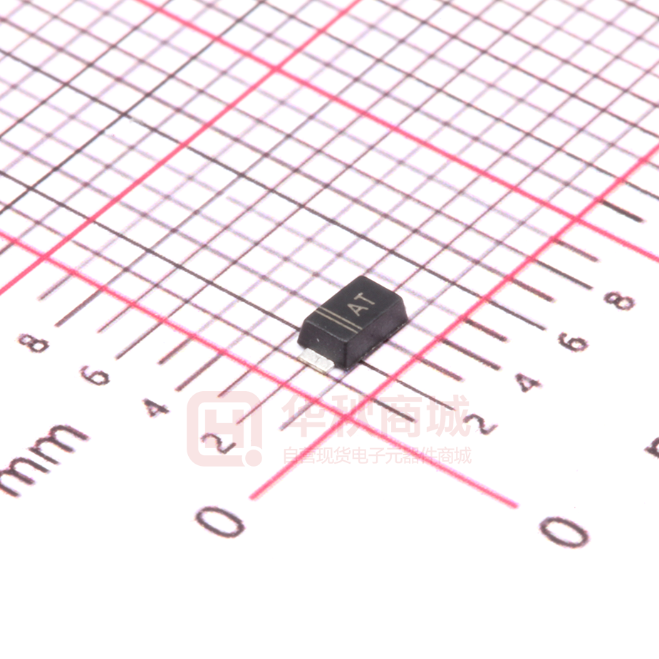

    SMF(SOD-123FL)
    TVS二极管 VRWM=8.5V VBR(Min)=9.44V VC=14.4V IPP=13.9A Ppp=200W SOD123FL
SMF8.5A 数据手册
SMF5.0A(CA) - SMF170A(CA) SURFACE MOUNT TRANSIENT VOLTAGE SUPPRESSOR DIODE VOLTAGE RANGE: 5.0 - 17 0V POWER: 200Wa t t s Features ! For surface mounted applications ! Low profile package ! Low incremental surge resistance, excellent clamping capability ! 200W peak pulse power capability with a 10/1000 µ s wave from,repetition rate (duty cycle):0.01% ! High temperature soldering guaranteed: 260 ℃/10 seconds, at terminals B C Mechanical Data ! Case: JEDEC SOD-123FL, molded plastic over passivated chip ! Polarity: Color band denotes positive end E SOD-123FL Dim Min Max Typ A 3.58 3.72 3.65 3 B 2.72 2.78 2.75 C 1.77 1.83 1.80 D 1 1.02 1.08 1.05 E 0.097 1.03 1.00 H 0.13 0.17 0.15 L 0.53 0.57 0.55 All Dimensions in mm D H ( cathode ) except for bidirectional L ! Mounting position: Any ! Weight: 0.006 ounces, 0.02 gram E A Maximum Ratings TA = 25C unless otherwise specified Characteristic Symbol Value Unit Maximum P PK Dissipation (PW - 10/1000 μs) PPK 200 W Maximum P PK Dissipation @ Ta = 25 °C (PW - 8/10 μs) (Note 2) PPK 1000 W DC Power Dissipation @ Ta = 25 °C PD 385 mW 4.0 mW/ °C (Note 3) Derate above 25 °C Thermal Resistance, Junction to Ambient (Note 3) RӨJA 325 °C/W Thermal Resistance, Junction to Lead (Note 3) RӨJL 26 °C/W TJ, TSTG -55 to +150 °C Operating Junction and Storage Temperature Range Notes : (1) Non−repetitive current pulse at Ta = 25°C, per waveform of Fig. 2. (2) Non−repetitive current pulse at Ta = 25°C, per waveform of Fig. 5. (3) Mounted with recommended minimum pad size, DC board FR −4. 1 of 3 www.sunmate.tw Reverse Stand-Off Voltage TYPE (Uni) (Bi) SMF5.0A SMF6.0A SMF6.5A SMF7.0A SMF7.5A SMF8.0A SMF8.5A SMF9.0A SMF10A SMF11A SMF12A SMF13A SMF14A SMF15A SMF16A SMF17A SMF18A SMF20A SMF22A SMF24A SMF26A SMF28A SMF30A SMF33A SMF36A SMF40A SMF43A SMF45A SMF5.0CA SMF6.0CA SMF6.5CA SMF7.0CA SMF7.5CA SMF8.0CA SMF8.5CA SMF9.0CA SMF10CA SMF11CA SMF12CA SMF13CA SMF14CA SMF15CA SMF16CA SMF17CA SMF18CA SMF20CA SMF22CA SMF24CA SMF26CA SMF28CA SMF30CA SMF33CA SMF36CA SMF40CA SMF43CA SMF45CA SMF48A SMF51A SMF54A SMF58A SMF60A SMF64A SMF48CA SMF51CA SMF54CA SMF58CA SMF60CA SMF64CA SMF70A SMF75A SMF78A SMF70CA SMF75CA SMF78CA SMF85A SMF90A SMF100A SMF110A SMF120A SMF130A SMF150A SMF160A SMF170A SMF85CA SMF90CA SMF100CA SMF110CA SMF120CA SMF130CA SMF150CA SMF160CA SMF170CA VRWM (V) 5.0 6.0 6.5 7.0 7.5 8.0 8.5 9.0 10 11 12 13 14 15 16 17 18 20 22 24 26 28 30 33 36 40 43 45 48 51 54 58 60 64 70 75 78 85 90 100 110 120 130 150 160 170 Breakdown Breakdown Test Voltage Current Voltage Max. @ IT Min. @IT VBR MIN(V) VBR MAX(V) IT (mA) 7.00 7.37 7.98 8.60 9.21 9.83 10.4 11.1 12.3 13.5 14.7 15.9 17.2 18.5 19.7 20.9 22.1 24.5 26.9 29.5 31.9 34.4 36.8 40.6 44.2 49.1 52.8 55.3 58.9 62.7 66.3 71.2 73.7 78.6 86.0 92.1 95.8 104 111 123 135 147 159 185 197 209 6.40 6.67 7.22 7.78 8.33 8.89 9.44 10.0 11.1 12.2 13.3 14.4 15.6 16.7 17.8 18.9 20.0 22.2 24.4 26.7 28.9 31.1 33.3 36.7 40.0 44.4 47.8 50.0 53.3 56.7 60.0 64.4 66.7 71.1 77.8 83.3 86.7 94.4 100 111 122 133 144 167 178 189 2 of 3 10 10 10 10 1.0 1.0 1.0 1.0 1.0 1.0 1.0 1.0 1.0 1.0 1.0 1.0 1.0 1.0 1.0 1.0 1.0 1.0 1.0 1.0 1.0 1.0 1.0 1.0 1.0 1.0 1.0 1.0 1.0 1.0 1.0 1.0 1.0 1.0 1.0 1.0 1.0 1.0 1.0 1.0 1.0 1.0 Reverse Leakage @VRWM Maximum Clamping Voltage @IPP Peak Pulse Current IR(uA) VC(V) IPP(A) 400 400 250 100 50 25 10 5.0 2.5 2.5 2.5 1.0 1.0 1.0 1.0 1.0 1.0 1.0 1.0 1.0 1.0 1.0 1.0 1.0 1.0 1.0 1.0 1.0 1.0 1.0 1.0 1.0 1.0 1.0 1.0 1.0 1.0 1.0 1.0 1.0 1.0 1.0 1.0 1.0 1.0 1.0 9.2 10.3 11.2 12.0 12.9 13.6 14.4 15.4 17.0 18.2 19.9 21.5 23.2 24.4 26.0 27.6 29.2 32.4 35.5 38.9 42.1 45.4 48.4 53.3 58.1 64.5 69.4 72.7 77.4 82.4 87.1 93.6 96.8 103 113 121 126 137 146 162 177 193 209 243 259 275 21.7 19.4 17.9 16.7 15.5 14.7 13.9 13.0 11.8 11.0 10.1 9.3 8.6 8.2 7.7 7.2 6.8 6.2 5.6 5.1 4..8 4.4 4.1 3.8 3.4 3.1 2.9 2.8 2.6 2.4 2.3 2.1 1.8 1.7 1.5 1.4 1.4 1.3 1.2 1.1 1.0 0.9 0.8 0.7 0.7 0.6 www.sunmate.tw FIG.2 - 10 x 1000 μs PULSE WAVEFORM 120 Pulse Width (tp) is defined as that point where the peak current decays to 50% of IRSM tr 100 100 tr ≤ 10 μs 80 VALUE (%) PEAK PULSE DERATING IN % OF PEAK POWER OR CURRENT FIG.1 - PULSE DERATING CURVE 60 40 Peak Value - I RSM 50 Half Value - IRSM 2 Ta = 25 °C 20 tp 0 0 0 25 50 100 75 125 150 0 1 Ta, AMBIENT TEMPERATURE, ( °C) FIG.3 - STEADY STATE POWER DERATING 3 4 FIG.4 - PULSE RATING CURVE 4.0 10000 Pp,PEAK POWER (W) PD, STEADY STATE POWER DISSIPATION (W) 2 t, TIME (ms) 3.0 2.0 1.0 1000 100 10 0.1μs 1.0μs 10μs 100μs 1.0ms 10ms 0 25 50 75 100 125 150 tp, PULSE WIDTH 175 TL, LEAD TEMPERATURE (°C) FIG. 6 - CAPACITANCE VS. WORKING PEAK REVERSE VOLTAGE 1000 Pulse Width (tp) is defined as that point where the peak current decays = 8 μs tr 100 Measured @ Zero Bias C, CAPACITANCE (pF) % OF PEAK PULSE CURRENT FIG.5 - 8 x 20 μs PULSE WAVEFORM Peak Value I RSM @ 8 μs Half Value I RSM/ 2 @ 20 μs 50 tp 0 0 20 40 60 80 t, TIME (μs) 100 Measured @ 50 %VRWM 10 1 1 10 100 200 WORKING PEAK REVERSE VOLTAGE (V) 3 of 3 www.sunmate.tw

物料型号:文档中列出了多种型号,包括SMF5.0A(CA)至SMF170A(CA),这些型号是瞬态电压抑制二极管,用于表面贴装。
器件简介:这些瞬态电压抑制二极管适用于表面贴装应用,具有低轮廓封装,200W的峰值脉冲功率能力,以及在10/1000微秒周期内的低增量浪涌电阻。
引脚分配:文档中指出极性由色带表示,正端(阴极)有色带,双向型号除外。安装位置可以是任意的。
参数特性:包括最大峰值耗散功率、直流功率耗散、热阻等,详细列出了在不同工作条件下的电气特性。
