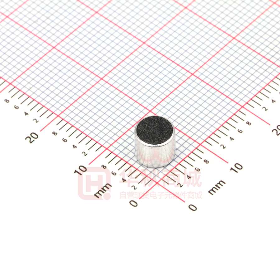

規 格 承 認 書 PECIFICATION FOR APPROVAL 客 戶 CUSTOMER 項 目 ITEM 型 號 : : 单指向驻极体电容咪头(ECM) TYPE : GMI6050U-2C30-66DB 描述 DESCRIPTION : φ6.0 x H5.0 mm 焊点 1033 -30~-66dB 2.0V 客戶料號 CUSTOMER NO. : 規 格 書 號 ≤2.2KΩ S/N: ≥58 dBA SPECIFICATION NO.: 版 本 EDITION NO. 日 期 DATE : : V1.0 20 客戶承認 CUSTOMER CONFIRM AND SIGN 檢查 TESTED BY 審核 CHECKED BY 承認 APPROVED BY 東莞市赢海電子有限公司 DONGUAN INGHAI ELECTRONICS CO.,LTD 製作 ISSUED BY 審查 CHECKED BY 周明 李林 確認 APPROVED BY 地址:廣東省東莞市長安鎮廈邊元灶頭工業區 16-6 號 電話 / TEL:0769-83060958 傳真 / FAX: 0769-81608993 網址:HTTP://WWW.INGHAI.COM 1/5 A. SCOPE This specification applies electret condenser microphone, GMI6050U-2C30-66DB B. SPECIFICATION ■Test condition: RL=0.68KΩ No. Item 1 Directivity 2 Sensitivity 3 VS=1.5V Symbol Unit TEMP=25℃±2℃ Specification Related humidity=65±5% Condition Uni-directional f=1KHz,1Pa S dB -30~-66±3 Standard operating voltage Vs V 1.5 4 Output impedance Zout KΩ ≤0.68 5 Frequency Hz 100-10,000 6 Max operating voltage V. 10 7 Sensitivity reduction △S-Vs dB -3 8 Max. current consumption IDSS mA ≤0.5 9 Signal to noise ration S/N dBA ≥58 10 Max input sound level SPL dB 110 11 Operation temp. ℃ -30 ~+70 12 Storage temp. ℃ -40 ~+85 13 Dimension mm φ6.0 x H5.0 See appearance drawing 14 Terminal Terminal See appearance drawing 15 Approvals RoHs FCC 0dB=1V/Pa f=1KHz, 1Pa f=1KHz, 1Pa Vs=3.0VDC to 1.5VDC f=1KHz, P in=1Pa We use “Pascal(Pa)”indication of sensitivity as per the recommendation of I.E.C.(International Electro technical Commission) TheSensitivity of “Pa” will increase 20dB comparing with “ubar” indication Example: -60dB(0dB=0.1V/ubar) =-40dB(0dB=1V/Pa) 2/5 C.TYPICAL FREQUENCY RESPONSE CURVE Unidirectional 5.0±0.1 D. APPEARANCE DRAWING Φ6.0±0.1 E. MEASUREMENT CIRCUIT Term 1 FET C1=10PF ECM UNIT C1 C output RL=2.2K C2=33PF +Vcc C2 Term 2 ground MIC CASE 3/5 F. Explode Drawing G. 可靠性试验 Reliability Test 经过以下所有试验在 20℃的条件下放置 3 小时后,麦克风的灵敏度与试验前比较变化在 3dB 以 内 After any following tests, the sensitivity of the microphone to be within ±3dB of initial sensitivity after 3hours of conditioning at 20℃ 5-1 振动试验 周波数 1/Frequency1:10Hz~55Hz Vibration 振幅/Amplitude:1.52mm 变化/Change of Frequency:1 octave/min 3 方向,各 2 小时/hours in each of 3 axes 5-2 高温试验 +80±5℃ for 96 hours Dry Heat 5-3 低温试验 -40±5℃ for 96 hours Dry Cold 5-4 高温高湿试验 90%~95%RH,+60±5℃ for 96 hours Damp Heat 5-5 温度循环试验 -20℃ 25℃ 70℃ Temperature cycles (2h) (1h) (2h) (1h) (2h)×10 cycles 5-6 跌落试验 Height:1m Packing drop test 顺序:三个面各跌 10 次 Procedure:10 times from each of 3 axises 5-7 温度冲击试验 -20℃ 70℃ Temperature impact test 30min 30s 30min ×10 cycles 5-8 静电冲击试验 4000V(contact), 8000V(air) ×10 axises Electrostatic shock test 备注 Note 6-1 工作温度范围 Operation Temperature -30℃~70℃ 4/5 6-2 储存温度范围 Storage Temperature -40℃~85℃ H. 焊接条件 Soldering Condition 7-1 焊接使用 90W 的烙铁。 The soldering copper of a type of 90W shall be applied 焊接条件 Soldering Condition. 7-2 电烙铁表面温度 320±10℃ The temperature of the working surface of the soldering copper shall be 320±10℃ 7-3 焊接时把麦克风嵌入散热能力强的金属块内。 ECM shall be soldered fixed on the metal block(heat sink)which has the higher radiation effects said heat sink Shall contact with of ECM. 7-4 焊接时间控制在 2~3 秒内。 time for each terminal shall be 2~3 sec. 7-5 焊接后不能出现针孔。 The pinhole after soldering shall be avoided. 7-6 静电容易破坏麦克风必须采取措施避免(电烙铁接地,戴静电环等。) ECM may easily destroyed by the static electricity and the countermeasure for eliminating the static electricity (the ground for soldering copper, for worktable and for human body) shall be executed. 7-7 散热板形状 Shape of heat sink 7-8 固定部孔形状 Shape of hole at fixed part ECM 10 2.0 4.1 2.0 unit:mm 5/5
GMI6050U-2C36DB
1. 物料型号:GMI6050U-2C30-66DB 2. 器件简介:单指向驻极体电容咪头,具有φ6.0 x H5.0 mm的尺寸,焊点1033,-30~-66dB的灵敏度,2.0V的工作电压,输出阻抗≤2.2KΩ,信噪比≥58 dBA。 3. 引脚分配:文档中提供了外观图和爆炸图,但没有详细说明每个引脚的功能。 4. 参数特性: - 指向性:单向 - 灵敏度:-30~-66±3 dB(1kHz, 1Pa) - 标准工作电压:1.5V - 输出阻抗:≤0.68 KΩ(1kHz, 1Pa) - 频率响应:100Hz至10kHz - 最大工作电压:10V - 信噪比:≥58 dBA(1kHz, Pin=1Pa) - 最大输入声压级:110dB - 工作温度:-30°C至+70°C - 存储温度:-40°C至+85°C 5. 功能详解:文档提供了频率响应曲线图和测量电路图,但没有提供详细的功能描述。 6. 应用信息:文档中没有提供应用信息。 7. 封装信息:尺寸为6.0xH5.0 mm,外观图和爆炸图提供了封装的详细视图。
