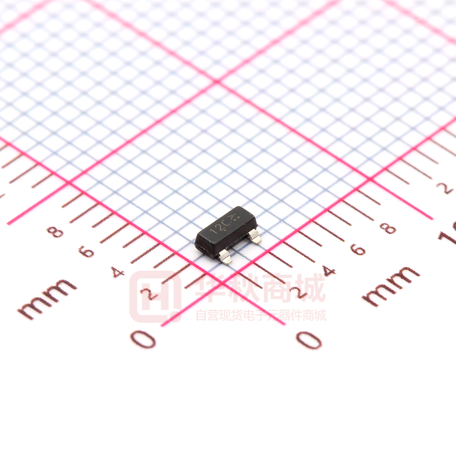

    SOT-23
    TVS二极管 VRWM=12V VC=25V SOT23-3
PSOT12C 数据手册
PSOT05C-PSOT24C GENERAL DESCRIPTION SOT23 The PSOT05C-PSOT24C are a dual voltage suppressor designed to protect components which are connected to data and transmission lines against Electro Static Discharge (ESD). It clamps the voltage just above the logic level supply for positive transients , and to a diode drop below ground for negative transients. It can work as bi-directional suppressor by connecting only pin 1 to 2. F G I DIM. SOT23 MIN. MAX. A B 0.89 0.30 0.51 C D 0.085 E 1.20 0.85 1.70 1.05 2.10 2.10 0.0 2.75 0.1 2.75 F FEATURES G H 2 Unidirectional ESD protection. Max. peak pulse power : Ppp = 300W at tp = 8/20 us Ultra low leakage current : IRM < 1uA @ VBR ESD protection > 25KV per MIL-STD-883C, Method 3015-6: Class 3. I L S 1.05 0.18 3.04 1.60 0.6 typ. 0.35 0.65 All Dimensions in millimeter IEC 61000-4-2, level 4 ( ESD ),>15KV(air) ;>8KV(contact ). Ultra small SMD plastic packages 3 PIN ASSIGNMENT 1 2 APPLICATION 1,2 Cathode 3 Ground Computers and peripherals Communication system Portable electronics Cellular handsets and accessories. MECHANICAL DATA Case Material: "Green" molding compound UL flammability classification 94V-0 (No Br.Sb, Cl) Terminals: Lead Free Plating (Matte Tin Finish), solderable per J-STD-002 and JESD22-B/02. Moisture Sensitivity: Leve 1 per J-STD-020C Component in accordance to RoHs 2002/95/EC MAXIMUM RATINGS (Tj= 25℃ unless otherwise noticed) Rating Symbol Value Unit Peak pulse Power ( 8/20us Waveform) PPPM 300 W Operating Junction Temperature Range TJ -55 to + 125 ℃ Tstg -55 to + 150 ℃ TL 260 ℃ Storage Temperature Range Soldering Temperature, t max = 10s 1 PSOT05C-PSOT24C ELECTRICAL CHARACTERISTICS (Tj= 25℃ unless otherwise noticed) PSOT05C Symbol Conditions MIn Typ Max Unit Reverse standoff voltage VDRM --- --- --- 5 V Reverse leakage current IRM VDRM = 5V --- --- 1 uA Peak pulse Current Ipp tp = 8/20us --- --- 17 A Breakdown voltage VBR IR = 1 mA 6.4 --- 7.2 V Diode capacitance CJ VR = 0 V , f = 1MHz --- 156 160 pF Clamping Voltage VCL Ipp= 1 A, tp = 8/20us --- ---- 9.8 V Clamping Voltage VCL Ipp= 15 A, tp = 8/20us --- ---- 20 V Symbol Conditions MIn Typ Max Unit Reverse standoff voltage VDRM --- --- --- 12 V Reverse standoff voltage IRM VDRM = 12 V --- --- 1 uA Peak pulse Current Ipp tp = 8/20us --- --- 12 A Breakdown voltage VBR IR = 1 mA 14.2 --- 15.8 V Diode capacitance CJ VR = 0 V , f = 1MHz --- 78 100 pF Clamping Voltage VCL Ipp= 1 A, tp = 8/20us --- --- 19 V Clamping Voltage VCL Ipp= 12 A, tp = 8/20us --- --- 25 V Symbol Conditions MIn Typ Max Unit Reverse standoff voltage VDRM --- --- --- 24 V Reverse leakage current IRM VDRM = 24V --- --- 1 uA Peak pulse Current Ipp tp = 8/20us --- --- 4 A Breakdown voltage VBR IR = 1 mA 26.7 --- 29.6 V Diode capacitance CJ VR = 0 V , f = 1MHz --- 30 60 pF Clamping Voltage VCL Ipp= 1 A, tp = 8/20us --- --- 36 V Clamping Voltage VCL Ipp= 4 A, tp =8/20us --- --- 43 V Parameter PSOT12C Parameter PSOT24C Parameter 2 PSOT05C-PSOT24C 120 100% 90% 80 Percent of Peak Pulse Current % Percent of Peak Pulse Current (%) 100% Ipp: 8us -1 e 50% Ipp: 20us 40 10% 0 10 20 30 40 60 ns Time (us) Figure 2. ESD pulse waveform according to IEC 61000-4-2 Figure 1. 8/20 us pulse waveform according to IEC 61000-4-5 TJ =25℃, tp (us) = 8/20 us exponentially decay waveform 1.2 1000 Ppp / Ppp (25℃) Peak pulse Power (W) 10000 Time (ns) tr = 0.7 ~1 ns 30 ns 0 100 0.8 0.4 0 10 1 10 100 1000 0 10000 25 Pulse Time (us) 50 75 100 Junction Temperature (℃) 125 Figure 4. Peak pulse power versus TJ Figure 3. Power Dissipation versus Pulse Time 180 10.0 TJ =25℃, f=1MHz, Vosc=100 mV 160 120 IR / IR (25℃) Capacitance (pF) 140 100 5V 80 60 40 1.0 12V 20 24V 0 0.1 0.0 1.0 2.0 3.0 4.0 0 5.0 30 60 90 120 Junction Temperature (℃) Reverse Voltage (V) Figure 6. Reverse Leakage Current versus TJ Figure 5. Typical Junction Capactiance 3 150 PSOTxxC I/O1 +/-8KV ESD Contact discharge V (i/o) Figure 7. ESD Test Configuration PSOT05C V (i/o) V (i/o) Figure 8. Clamped +8 kV ESD voltage waveform Figure 9. Clamped -8 kV ESD voltage waveform PSOT12C V (i/o) V (i/o) Figure 10. Clamped +8 kV ESD voltage waveform Figure 11. Clamped -8 kV ESD voltage waveform PSOT24C V (i/o) V (i/o) Figure 13. Clamped -8 kV ESD voltage waveform Figure 12. Clamped +8 kV ESD voltage waveform 4
