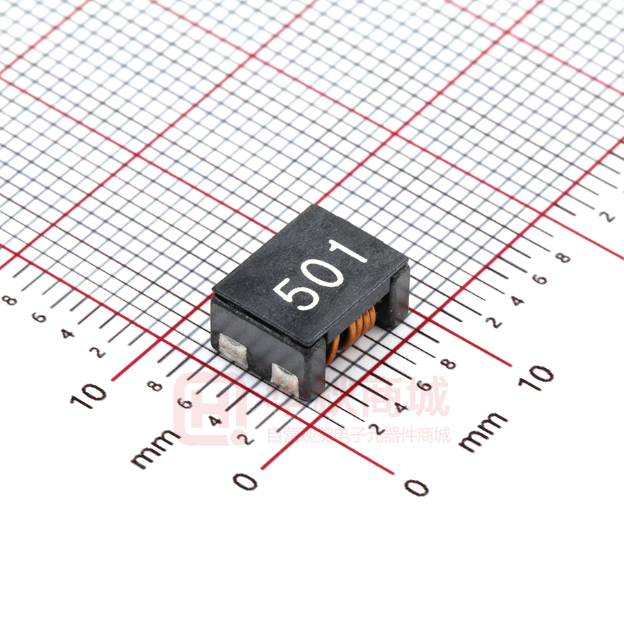

    共模电感 5.5A 8mΩ 600Ω IND_9X7MM_SM
YLM9070-501T 数据手册
Wire Wound Common Mode Choke -YLM9070 Series ■ Features ● SMD construction,and low profile. ● High Impedance and Excelletn Frequency Characteristic. ● Self Electromagnetic Shielding. ● Low Magnetic Flux Leakage. ■ Applications ● LED Light,TV game,Monitor,etc. ● EMI common-mode noise. ■ Product Identification ⑴ :Type ⑵ :Dimensions ⑶ :Inductance value ⑷ :Taping 深圳市益嘉源电子有限公司 http://www.yjycoin.com Tel:0755-27803896 Fax:0755-27803897 -1- Wire Wound Common Mode Choke -YLM9070 Series ■ Shapes and Dimensions (Unit:mm) TYPE A A1 B C Max D Typ E F G YLM9070 9.0±0.5 9.5±0.5 7.0±0.5 4.8 5.7 1.5±0.2 2.0±0.2 1.7±0.2 ■ Circuit Diagram ■ YLM9070 Series Z (Ω) DC @100MHz/0.1V Resistance Min Typ (mΩ) Max. YLM9070-301T 225 300 YLM9070-501T 450 YLM9070-701T Rated Current Rated Volt. IR(MΩ) (A) max. (V)max. min. 6 6.0 80 10 301 600 8 5.5 80 10 501 500 700 10 5.0 80 10 701 YLM9070-102T 750 1000 13 4.0 80 10 102 YLM9070-202T 1500 2000 20 2.5 80 10 202 YLM9070-222T 1700 2200 60 2.5 80 10 222 YLM9070-272T 2000 2700 86 2.0 80 10 272 YLM9070-302T 2500 3000 70 3.0 80 10 302 Part Number 深圳市益嘉源电子有限公司 http://www.yjycoin.com Tel:0755-27803896 Marking Fax:0755-27803897 -2- Wire Wound Common Mode Choke -YLM9070 Series ■ Materlal List NO. ITEM DESCRIPTION SUPPLIER 1 CORE FERRITE SINCORES OR EQ 2 WIRE 2UEW P180 PACIFIC OR EQ 3 BASE LCP LIANGCHENG OR EQ 4 SOLDER Sn Cu SHENYUAN OR EQ 5 EPOXY 661 QIFU OR EQ 6 INK WHITE BON MARK ■ Reliability Testing Operating Temperature - 30 to + 100 ℃ ( Contain Heating coil ) Appearance Inspection No external defects by visual inspection Terminal Strength After soldering , between copper plaet and terminals of coils , push in two directions of X , Y with standing 10N(1.02kg) for10+/-2 sec. Terminal should not peel off. ( Refer to figure at right ) Heat endurance of reflow Refer to figure soldering Insulating resistance Over 100 MΩ at 100V D.C . between wire and core . Dielectric Strength Apply at 0.5KV 3mA for 1 minute between wire and core . Temperature Inductance coefficient ( 0~2,000 ) × 10 / ℃( - 30 ~ + 100 ℃ ) characteristics Humidity characteristics Inductance deviation within ± 10% , after 96 hours in 90~95% relative humidity at 40 ± 2 ℃ and 1 hours drying under normal condition . A test is made under the above mentioned condition , and it is kept for 2 hours in the normal 深圳市益嘉源电子有限公司 http://www.yjycoin.com Tel:0755-27803896 Fax:0755-27803897 -3- Wire Wound Common Mode Choke -YLM9070 Series ■ Recommended soldering temp.Graph ■ Taping Dimensions(Unit:mm) TYPE W A B D P K T MPQ YLM9070 24.0±0.3 7.6±0.1 9.6±0.1 7.5±0.1 16.0±0.1 5.1±0.1 0.35±0.05 700 深圳市益嘉源电子有限公司 http://www.yjycoin.com Tel:0755-27803896 Fax:0755-27803897 -4- Wire Wound Common Mode Choke -YLM9070 Series ■ Reel Dimensions(Unit:mm) TYPE W W1 A B C D YLM9070 330±2.0 16.4±2.0 13.0±0.50 21.0±0.80 2.0±0.50 100Min ■ Direction of rolling 深圳市益嘉源电子有限公司 http://www.yjycoin.com Tel:0755-27803896 Fax:0755-27803897 -5- Wire Wound Common Mode Choke -YLM9070 Series ■ Cover tape peel off condition Cover tape peel force shall be 0.1N to 1.3N. Reference peel speed 300±10mm/min. 深圳市益嘉源电子有限公司 http://www.yjycoin.com Tel:0755-27803896 Fax:0755-27803897 -6-
