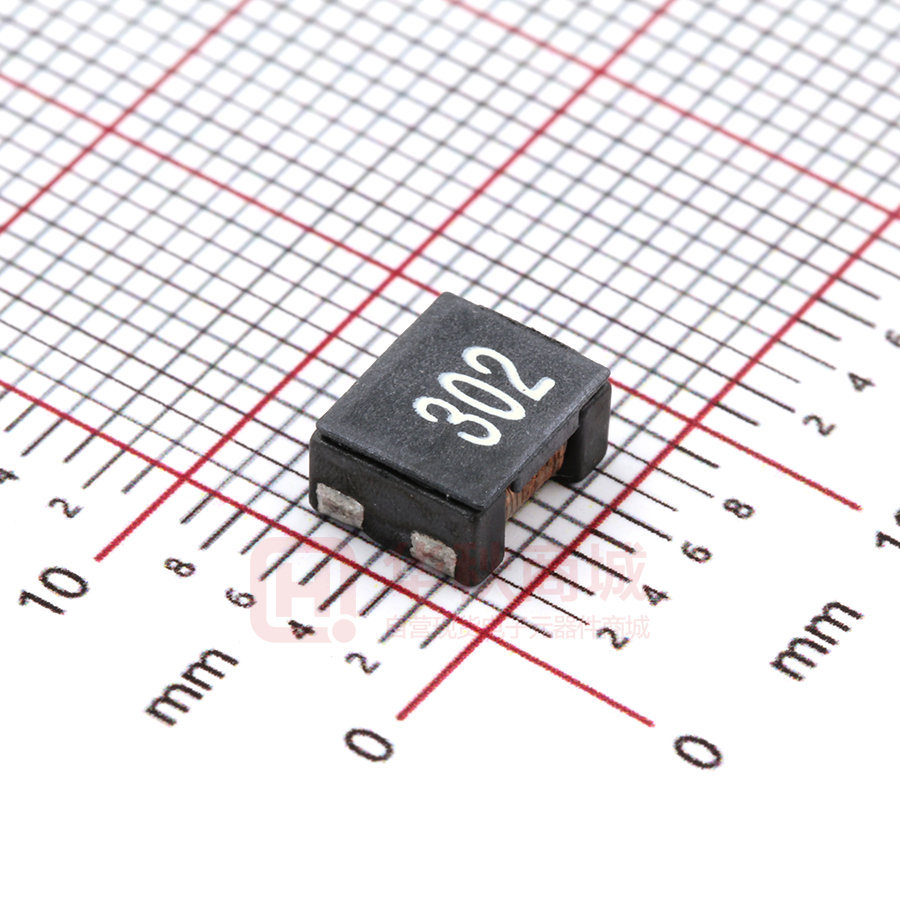

    SMD,7x6mm
    共模电感 900mA 75mΩ 3KΩ IND_7X6MM_SM
YLM7060-302T 数据手册
Wire Wound Common Mode Choke -YLM7060 Series ■ Features ● SMD construction,and low profile. ● High Impedance and Excelletn Frequency Characteristic. ● Self Electromagnetic Shielding. ● Low Magnetic Flux Leakage. ■ Applications ● LED Light,TV game,Monitor,etc. ● EMI common-mode noise. ■ Product Identification ⑴ :Type ⑵ :Dimensions ⑶ :Inductance value ⑷ :Taping 深圳市益嘉源电子有限公司 http://www.yjycoin.com Tel:0755-27803896 Fax:0755-27803897 -1- Wire Wound Common Mode Choke -YLM7060 Series ■ Shapes and Dimensions (Unit:mm) TYPE A B C Max D Typ E F G YLM7060 7.0±0.5 6.0±0.5 3.8 3.5 1.5±0.5 1.5±0.5 1.7±0.5 ■ Circuit Diagram ■ YLM7060 Series Z (Ω) DC @100MHz/0.1V Resistance Min Typ (mΩ) Max. YLM7060-400T 40 70 YLM7060-101T 100 YLM7060-301T Rated Current Rated Volt. IR(MΩ) (A) max. (V)max. min. 5 15.0 125 10 400 140 10 9.0 125 10 101 225 300 10 5.0 125 10 301 YLM7060-501T 275 350 10 5.0 125 10 501 YLM7060-601T 500 700 15 4.0 125 10 601 YLM7060-701T 500 700 15 4.0 125 10 701 YLM7060-102T 800 1020 17 3.0 125 10 102 YLM7060-132T 910 1300 21 2.5 125 10 132 YLM7060-272T 2000 2700 63 1.0 125 10 272 YLM7060-302T 2500 3000 75 0.9 125 10 302 Part Number 深圳市益嘉源电子有限公司 http://www.yjycoin.com Tel:0755-27803896 Marking Fax:0755-27803897 -2- Wire Wound Common Mode Choke -YLM7060 Series ■ Materlal List NO. ITEM DESCRIPTION SUPPLIER 1 CORE FERRITE SINCORES OR EQ 2 WIRE 2UEW P180 ELEKTRISOLA OR EQ 3 BASE LCP LIANGCHENG OR EQ 4 SOLDER Sn Cu SHENMAO OR EQ 5 EPOXY ME-5890 PENGNO OR EQ 6 INK WHITE BON MARK ■ Reliability Testing Operating Temperature - 30 to + 100 ℃ ( Contain Heating coil ) Appearance Inspection No external defects by visual inspection Terminal Strength After soldering , between copper plaet and terminals of coils , push in two directions of X , Y with standing 10N(1.02kg) for10+/-2 sec. Terminal should not peel off. ( Refer to figure at right ) Heat endurance of reflow Refer to figure soldering Insulating resistance Over 100 MΩ at 100V D.C . between wire and core . Dielectric Strength Apply at 0.5KV 3mA for 1 minute between wire and core . Temperature Inductance coefficient ( 0~2,000 ) × 10 / ℃( - 30 ~ + 100 ℃ ) characteristics Humidity characteristics Inductance deviation within ± 10% , after 96 hours in 90~95% relative humidity at 40 ± 2 ℃ and 1 hours drying under normal condition . A test is made under the above mentioned condition , and it is kept for 2 hours in the normal 深圳市益嘉源电子有限公司 http://www.yjycoin.com Tel:0755-27803896 Fax:0755-27803897 -3- Wire Wound Common Mode Choke -YLM7060 Series ■ Recommended soldering temp.Graph ■ Taping Dimensions(Unit:mm) TYPE W A B D P K T MPQ YLM7060 16.0±0.3 6.9±0.3 8.4±0.3 7.5±0.1 12±0.1 4.2±0.1 0.40±0.05 1500 深圳市益嘉源电子有限公司 http://www.yjycoin.com Tel:0755-27803896 Fax:0755-27803897 -4- Wire Wound Common Mode Choke -YLM7060 Series ■ Reel Dimensions(Unit:mm) TYPE W W1 A B C D YLM7060 330±2.0 16.4±2.0 13.0±0.50 21.0±0.80 2.0±0.50 100Min ■ Direction of rolling 深圳市益嘉源电子有限公司 http://www.yjycoin.com Tel:0755-27803896 Fax:0755-27803897 -5- Wire Wound Common Mode Choke -YLM7060 Series ■ Cover tape peel off condition Cover tape peel force shall be 0.1N to 1.3N. Reference peel speed 300±10mm/min. 深圳市益嘉源电子有限公司 http://www.yjycoin.com Tel:0755-27803896 Fax:0755-27803897 -6-
