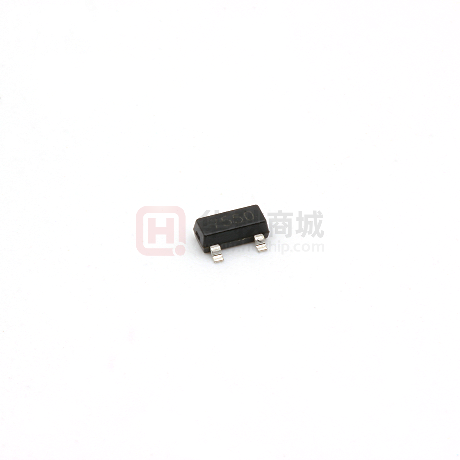

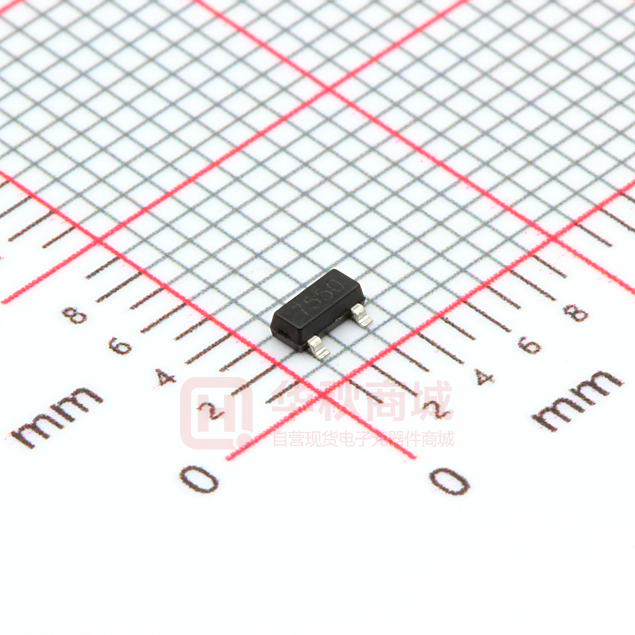

    输出类型:固定 输出极性:正 输出通道数:1 最大输入电压:36V 输出电压:5V 压差:55mV@(1mA) 输出电流:150mA
PJ75AL50SA 数据手册
PJ75ALXXSA Series Low Dropout Regulators Description SOT-23 The PJ75ALXXSA series is a set of three-terminal low power high voltage regulators implemented in CMOS technology. They allow input voltages as high as 36V. They are available with several fixed output voltages ranging from 2.8V to 5.0V. Because of the low power dissipation, PJ75ALXXSA are 1.GND 2.VOUT 3.VIN widely used in a variety of equipment such as audio device, video device, communication device Block Diagram and so on. Features VIN  Low power consumption  Low voltage drop  Low temperature coefficient  High input voltage (up to 36V)  Quiescent current : 2.5μA  Output voltage tolerance: ±2%  HAF(halogen and antimony free) is acquired Selection Tablet Designator XX www.pingjingsemi.com Revision:1.0 Sep-2019 VOUT Vref GND PJ75ALXXSA Symbol Description 28 2.8V(output) 30 3.0V 33 3.3V 36 3.6V 40 4.0V 44 4.4V 50 5.0V 1/8 PJ75ALXXSA Series Low Dropout Regulators Absolute Maximum Ratings Note1 Ratings at 25℃ ambient temperature unless otherwise specified. Parameter Limit Unit Supply voltage -0.3 ~ +36 V Storage temperature range -50 ~ +125 ℃ -40 ~ 85 ℃ Operating temperature range Note: 1.Stresses beyond those listed under absolute maximum ratings may cause permanent damage to the device. These are stress ratings only, and functional operation of the device at these or any other conditions beyond those conditions is not implied. Exposure to absolutemaximum-rated conditions for extended periods may affect device reliability. Parameter Symbol Value Unit RθJA 200 ℃/W PD 500 mW Junction-to-Ambient Thermal Resistance Power Consumption Electrical Characteristics PJ75AL28SA(TA=25℃) Parameter Symbol Test conditions Min. Typ. Max Unit 2.744 2.80 2.856 V Output voltage VOUT VIN=VOUT+2.0V, IOUT=10mA Output current IOUT VIN=VOUT+2.0V 70 100 -- mA Load regulation ΔVOUT VIN=VOUT+2.0V 1mA≤IOUT≤50mA -- 25 60 mV Voltage drop Note2 VDIF IOUT=1mA,ΔVOUT=2% -- 30 100 mV Quiescent Current IQ No Load -- 2.5 3.0 μA VOUT+2.0V≤VIN≤30V,IOUT=1mA -- -- 0.2 %/V -- -- -- 36 V -- 100 -- ppm/℃ Line regulation ΔVOUT / VOUT× ΔVIN Input voltage VIN Temperature coefficient ΔVOUT /VOUT× www.pingjingsemi.com Revision:1.0 Sep-2019 ΔTA VIN=VOUT+2.0V, IOUT=10mA, -40℃≤TA≤85℃ 2/8 PJ75ALXXSA Series Low Dropout Regulators PJ75AL30SA(TA=25℃) Parameter Symbol Test conditions Output voltage VOUT VIN=VOUT+2.0V, IOUT=10mA Output current IOUT VIN=VOUT+2.0V Load regulation ΔVOUT Min. Typ. Max Unit 2.940 3.00 3.060 V 70 100 -- mA -- 25 60 mV -- 30 100 mV Voltage drop Note2 VDIF VIN=VOUT+2.0V 1mA≤IOUT≤50mA IOUT=1mA,ΔVOUT=2% Quiescent Current IQ No Load -- 2.5 3.0 μA VOUT+2.0V≤VIN≤30V,IOUT=1mA -- -- 0.2 %/V -- -- -- 36 V -- 100 -- ppm/℃ Min. Typ. Max Unit 3.234 3.30 3.366 V 70 100 -- mA -- 25 60 mV -- 25 55 mV Line regulation ΔVOUT / VOUT ×ΔVIN Input voltage VIN Temperature coefficient ΔVOUT /VOUT ×ΔTA VIN=VOUT+2.0V, IOUT=10mA, -40℃≤TA≤85℃ PJ75AL33SA(TA=25℃) Parameter Symbol Test conditions Output voltage VOUT VIN=VOUT+2.0V, IOUT=10mA Output current IOUT VIN=VOUT+2.0V Load regulation ΔVOUT Voltage drop Note2 VDIF VIN=VOUT+2.0V 1mA≤IOUT≤50mA IOUT=1mA,ΔVOUT=2% Quiescent Current IQ No Load -- 2.5 3.0 μA VOUT+2.0V≤VIN≤30V,IOUT=1mA -- -- 0.2 %/V -- -- -- 36 V -- 100 -- ppm/℃ Line regulation ΔVOUT / VOUT ×ΔVIN Input voltage VIN Temperature coefficient ΔVOUT /VOUT ×ΔTA VIN=VOUT+2.0V, IOUT=10mA, -40℃≤TA≤85℃ PJ75AL36SA(TA=25℃) Parameter Symbol Test conditions Min. Typ. Max Unit Output voltage VOUT VIN=VOUT+2.0V ,IOUT=10mA 3.528 3.60 3.672 V Output current IOUT 70 100 -- mA Load regulation ΔVOUT -- 25 60 mV -- 25 55 mV -- 2.5 3.0 μA VOUT+2.0V≤VIN≤30V,IOUT=1mA -- -- 0.2 %/V -- -- 36 V -- 100 -- ppm/℃ Voltage drop Note2 VDIF VIN=VOUT+2.0V VIN=VOUT+2.0V 1mA≤IOUT≤50mA IOUT=1mA,ΔVOUT=2% Quiescent Current IQ No Load Line regulation ΔVOUT / VOUT ×ΔVIN Input voltage VIN -- Temperature coefficient ΔVOUT /VOUT VIN= VOUT+2.0V, IOUT=10mA, www.pingjingsemi.com Revision:1.0 Sep-2019 ×ΔTA -40℃≤TA≤85℃ 3/8 PJ75ALXXSA Series Low Dropout Regulators PJ75AL40SA(TA=25℃) Parameter Symbol Test conditions Min. Typ. Max Unit Output voltage VOUT VIN=VOUT+2.0V, IOUT=10mA 3.920 4.0 4.080 V Output current IOUT 70 100 -- mA Load regulation ΔVOUT -- 25 60 mV -- 25 55 mV Voltage drop Note2 VDIF VIN=VOUT+2.0V VIN=VOUT+2.0V 1mA≤IOUT≤50mA IOUT=1mA,ΔVOUT=2% Quiescent Current IQ No Load -- 2.5 3.0 μA VOUT+2.0V≤VIN≤30V,IOUT=1mA -- -- 0.2 %/V -- -- 36 V -- 100 -- ppm/℃ Line regulation ΔVOUT / VOUT×ΔVIN Input voltage VIN -- Temperature coefficient ΔVOUT /VOUT VIN= VOUT+2.0V, IOUT=10mA, ×ΔTA -40℃≤TA≤85℃ PJ75AL44SA(TA=25℃) Parameter Symbol Test conditions Min. Typ. Max Unit Output voltage VOUT VIN=VOUT+2.0V ,IOUT=10mA 4.312 4.4 4.488 V Output current IOUT 70 100 -- mA Load regulation ΔVOUT -- 25 60 mV -- 25 55 mV -- 2.5 3.0 μA VOUT+2.0V≤VIN≤30V,IOUT=1mA -- -- 0.2 %/V -- -- 36 V -- 100 -- ppm/℃ Voltage drop Note2 VDIF VIN=VOUT+2.0V VIN=VOUT+2.0V 1mA≤IOUT≤50mA IOUT=1mA,ΔVOUT=2% Quiescent Current IQ No Load Line regulation ΔVOUT / VOUT ×ΔVIN Input voltage VIN -- Temperature coefficient ΔVOUT /VOUT VIN= VOUT+2.0V, IOUT=10mA, ×ΔTA -40℃≤TA≤85℃ PJ75AL50SA(TA=25℃) Parameter Symbol Test conditions Min. Typ. Max Unit Output voltage VOUT VIN=VOUT+2.0V ,IOUT=10mA 4.900 5.0 5.100 V Output current IOUT VIN=VOUT+2.0V 100 150 -- mA Load regulation ΔVOUT VIN=VOUT+2.0V 1mA≤IOUT≤70mA -- 25 60 mV Voltage drop Note2 VDIF IOUT=1mA,ΔVOUT=2% -- 25 55 mV Quiescent Current IQ No Load -- 3.5 4.0 μA VOUT+2.0 V≤VIN≤30V,IOUT=1mA -- -- 0.2 %/V -- -- 36 V -- 100 -- ppm/℃ Line regulation ΔVOUT / VOUT ×ΔVIN Input voltage VIN -- Temperature coefficient ΔVOUT /VOUT VIN= VOUT+2.0V, IOUT=10mA, ×ΔTA -40℃≤TA≤85℃ NOTE: 2.The difference of input voltage and output voltage when input voltage falls down gradually till output voltage equals to 98% of rating VOUT . www.pingjingsemi.com Revision:1.0 Sep-2019 4/8 PJ75ALXXSA Series Low Dropout Regulators Application Circuit VIN VIN C 1 10μF C o m m o n www.pingjingsemi.com Revision:1.0 Sep-2019 PJ75ALXXSA Series VOUT VOUT C 2 G N D 10μF Single Point GND C o m m o n 5/8 PJ75ALXXSA Series Low Dropout Regulators Package Outline SOT-23 Dimensions in mm 0.8 Max. 1.150 A 0.900 1.025 A1 0.000 0.050 0.100 b c D 0.300 0.080 2.800 0.400 0.115 2.900 0.500 0.150 3.000 E 1.200 1.300 1.400 HE 2.250 2.400 2.550 e 1.800 1.900 2.000 0.550REF L1 L 0.300 θ 0° 0.500 8° 2.2 Typ. 0.8 1.0 Min. 1.0 Dimensions in millimeter Symbol 1.9 SOT-23 Recommended soldering pad Ordering Information Device PJ75ALXXSA Series www.pingjingsemi.com Revision:1.0 Sep-2019 Package SOT-23 Shipping 3000/Reel&Tape(7inch) 6/8 PJ75ALXXSA Series Low Dropout Regulators Conditions of Soldering Recommended condition of reflow soldering  Recommended peak temperature is over 245 OC. If peak temperature is below 245 OC, you may adjust the following parameters:  Time length of peak temperature (longer)  Time length of soldering (longer)  Thickness of solder paste (thicker)  Conditions of hand soldering  Temperature: 370 OC  Time: 3s max.  Times: one time   Storage conditions Temperature 5 to 40 OC  Humidity 30 to 80% RH  Recommended period One year after manufacturing www.pingjingsemi.com Revision:1.0 Sep-2019 7/8 PJ75ALXXSA Series Low Dropout Regulators Package Specifications  The method of packaging 3,000 pcs per reel SOT-23 Cover Tape Carrier Tape 24,000 pcs per box 8 reels per box 18 5 104 120,000 pcs per carton 5 boxes per carton 185 2. Tape and reel data(7inch Units:mm) D A 3000 T2 T1 2900 2000 1900 1000 600 B C E PS F Reel (7'') 4.0±0.1 1Pin N Tape (8mm) www.pingjingsemi.com Revision:1.0 Sep-2019 8.0±0.1 3.5±0.05 4.0±0.1 G Symbol A B C E F D T1 T2 N G Value (unit: mm) Ø 177.8±1 2.7±0.2 Ø 13.5±0.2 Ø 54.5±0.2 12.3±0.3 9.6+2/-0.3 1.0±0.2 1.2±0.2 3.15±0.1 1.22±0.1 8/8
