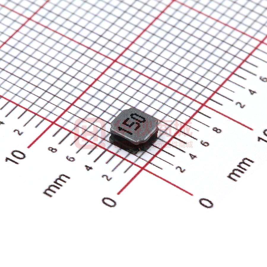

PRS4018-150MT
PRS4018-150MT
    FH(风华)
    SMD,4x4mm
    功率电感 15μH ±20% 940mA 250mΩ SMD,4x4mm
PRS4018-150MT 数据手册
PRS PRS SERIES SMD POWER INDUCTORS FEATURES Low profile. Magnetic shielde construction. SMT type. APPLICATION Mobile Phone,PDA ,LCD display etc. DC/DC converters etc. DC/DC ORDERING CODE 8040 PRS M 150 (L Product Code T W T) ( (mm) Dimensions PRS PRS H) Tolerance Packaging Style Inductance 3015 3.0 3.0 1.5 4018 4.0 4.0 1.8 6020 6.0 6.0 2.0 6045 6.0 6.0 4.5 8040 8.0 8.0 4.0 1R5 1.5 150 15 151 150 152 1500 J K L M N 5% 10% 15% 20% 30% T Tape & Reel SHAPE AND DIMENSIONS PRS30** ~80** Marking PRS2512 Land Pattern RECOMMENDED LAND PATTERNS (Unit) Part B A C E typ.) F typ.) G typ.) H typ.) I typ.) PRS2512 2.5 0.2 2.1 0.2 1.25MAX 2.1 0.85 0.8 2.1 0.85 0.80 PRS3015 3.0 0.2 3.0 0.2 1.5MAX 2.8 0.85 1.3 3.0 0.90 1.3 1.6 PRS4018 4.0 0.2 4.0 0.2 1.8MAX 3.4 1.2 1.6 3.6 1.4 PRS4026 4.0 0.2 4.0 0.2 2.6MAX 3.4 1.2 1.6 3.6 1.4 1.6 PRS5020 5.0 0.2 5.0 0.2 2.1MAX 4.0 1.2 2.6 4.4 1.6 2.4 PRS5045 5.0 0.2 5.0 0.2 4.5MAX 4.0 1.2 2.6 4.4 1.6 2.4 PRS6020 6.0 0.2 6.0 0.2 2.0MAX 5.0 1.5 3.0 5.7 1.9 2.6 0.2 6.0 0.2 2.8MAX 5.0 1.5 3.0 5.7 1.9 2.6 2.6 3.6 PRS6028 6.0 PRS6045 6.0 0.2 6.0 0.2 4.5MAX 5.0 1.5 3.0 5.7 1.9 PRS8040 8.0 0.2 8.0 0.2 4.3MAX 6.4 2.0 4.0 7.5 2.4 108 mm J typ.) SMD POWER INDUCTORS ELECTRICAL CHARACTERISTICS PRS2512 Series Part No. H Tolerance Test Freq. DCR( )Max Isat(A) Irms(A) PRS2512-R47NT 0.47 30% 1MHz 0.061 3.82 2.15 PRS2512-R68NT 0.68 30% 1MHz 0.074 3.28 1.96 PRS2512-1R0NT 1.0 30% 1MHz 0.090 2.59 1.93 PRS2512-1R5NT 1.5 30% 1MHz 0.147 2.24 1.40 PRS2512-2R2MT 2.2 20% 1MHz 0.216 1.85 1.15 PRS2512-3R3MT 3.3 20% 1MHz 0.264 1.61 1.04 PRS2512-4R7MT 4.7 20% 1MHz 0.377 1.12 0.84 PRS2512-5R6MT 5.6 20% 1MHz 0.538 1.12 0.73 PRS2512-6R8MT 6.8 20% 1MHz 0.581 0.98 0.69 PRS2512-8R2MT 8.2 20% 1MHz 0.658 0.98 0.65 PRS2512-100MT 10 20% 1MHz 0.690 0.79 0.62 PRS2512-150MT 15 20% 1MHz 1.591 0.68 0.42 PRS2512-220MT 22 20% 1MHz 1.976 0.53 0.38 DCR ) 20% Isat(A) PRS3015 Series Part No. Tolerance H Test Freq. ( Irms(A) PRS3015-1R0NT 1.0 30% 100kHz 0.030 2.32 2.35 PRS3015-1R5NT 1.5 30% 100kHz 0.040 2.30 1.70 PRS3015-2R2NT 2.2 30% 100kHz 0.060 1.60 1.60 PRS3015-3R3MT 3.3 20% 100kHz 0.080 1.32 1.36 PRS3015-4R7MT 4.7 20% 100kHz 0.120 1.10 1.09 PRS3015-5R6MT 5.6 20% 100kHz 0.140 0.95 0.86 PRS3015-6R8MT 6.8 20% 100kHz 0.160 0.87 0.85 PRS3015-8R2MT 8.2 20% 100kHz 0.220 0.80 0.80 PRS3015-100MT 10 20% 100kHz 0.230 0.72 0.77 PRS3015-150MT 15 20% 100kHz 0.360 0.66 0.65 PRS3015-220MT 22 20% 100kHz 0.520 0.52 0.57 PRS3015-330MT 33 20% 100kHz 0.840 0.44 0.43 PRS3015-470MT 47 20% 100kHz 1.340 0.35 0.35 Isat 30% Irms: 40 20 Isat The DC current is that which cause a 30% inductance reduction from the initial value. Irms: The DC current is inductor surface temperature to rise by 40 ( Reference ambient temperature 20 109 ). PRS4018 Series Part No. Tolerance H Test Freq. ( DCR ) 30% Isat(A) Irms(A) PRS4018-1R0NT 1.0 30% 100kHz 0.030 4.30 2.00 PRS4018-1R5NT 1.5 30% 100kHz 0.040 3.35 1.80 PRS4018-2R2NT 2.2 30% 100kHz 0.045 2.70 1.65 PRS4018-2R7MT 2.7 20% 100kHz 0.058 2.30 1.45 PRS4018-3R3MT 3.3 20% 100kHz 0.070 2.00 1.23 PRS4018-4R7MT 4.7 20% 100kHz 0.090 1.70 1.20 PRS4018-6R8MT 6.8 20% 100kHz 0.110 1.45 1.06 PRS4018-8R2MT 8.2 20% 100kHz 0.160 1.35 0.90 PRS4018-100MT 10 20% 100kHz 0.180 1.30 0.84 PRS4018-150MT 15 20% 100kHz 0.250 0.94 0.65 PRS4018-220MT 22 20% 100kHz 0.360 0.80 0.59 PRS4018-330MT 33 20% 100kHz 0.530 0.65 0.49 PRS4018-470MT 47 20% 100kHz 0.650 0.57 0.42 PRS4018-560MT 56 20% 100kHz 0.900 0.51 0.38 PRS4018-680MT 68 20% 100kHz 1.000 0.47 0.32 PRS4018-820MT 82 20% 100kHz 1.300 0.43 0.28 PRS4018-101MT 100 20% 100kHz 1.500 0.40 0.25 DCR ) 30% Isat(A) PRS4026 Series Part No. Tolerance H Test Freq. ( Irms(A) PRS4026-1R0NT 1.0 30% 100kHz 0.017 3.10 2.80 PRS4026-1R5NT 1.5 30% 100kHz 0.022 2.40 2.30 PRS4026-2R2NT 2.2 30% 100kHz 0.030 2.10 2.00 PRS4026-3R3MT 3.3 20% 100kHz 0.037 1.80 1.70 PRS4026-4R7MT 4.7 20% 100kHz 0.055 1.45 1.60 PRS4026-6R8MT 6.8 20% 100kHz 0.065 1.30 1.50 PRS4026-100MT 10 20% 100kHz 0.085 1.00 1.30 PRS4026-150MT 15 20% 100kHz 0.110 0.90 1.10 PRS4026-220MT 22 20% 100kHz 0.200 0.60 0.90 PRS4026-330MT 33 20% 100kHz 0.270 0.54 0.70 PRS4026-470MT 47 20% 100kHz 0.400 0.40 0.65 Isat 30% Irms: 40 20 Isat The DC current is that which cause a 30% inductance reduction from the initial value. Irms: The DC current is inductor surface temperature to rise by 40 ( Reference ambient temperature 20 110 ). SMD POWER INDUCTORS PRS5020 Series Part No. Tolerance H Test Freq. ( DCR ) 30% Isat(A) Irms(A) PRS5020-R47NT 0.47 30% 100kHz 0.016 6.15 5.00 PRS5020-R75NT 0.75 30% 100kHz 0.018 5.50 4.00 PRS5020-1R0NT 1.0 30% 100kHz 0.020 4.40 3.80 PRS5020-1R5NT 1.5 30% 100kHz 0.028 4.10 3.20 PRS5020-2R2NT 2.2 30% 100kHz 0.033 3.20 2.90 PRS5020-3R3MT 3.3 20% 100kHz 0.043 2.55 2.50 PRS5020-4R7MT 4.7 20% 100kHz 0.058 2.50 2.20 PRS5020-5R6MT 5.6 20% 100kHz 0.068 2.30 2.05 PRS5020-6R8MT 6.8 20% 100kHz 0.075 2.05 1.80 PRS5020-8R2MT 8.2 20% 100kHz 0.096 1.85 1.65 PRS5020-100MT 10 20% 100kHz 0.120 1.70 1.55 PRS5020-150MT 15 20% 100kHz 0.165 1.35 1.25 PRS5020-180MT 18 20% 100kHz 0.200 1.25 1.15 PRS5020-220MT 22 20% 100kHz 0.220 1.15 1.10 PRS5020-330MT 33 20% 100kHz 0.350 0.92 0.90 PRS5020-390MT 39 20% 100kHz 0.410 0.80 0.75 PRS5020-470MT 47 20% 100kHz 0.520 0.77 0.77 PRS5020-560MT 56 20% 100kHz 0.600 0.77 0.70 PRS5020-680MT 68 20% 100kHz 0.680 0.65 0.64 PRS5020-820MT 82 20% 100kHz 0.860 0.55 0.55 PRS5020-101MT 100 20% 100kHz 1.100 0.53 0.53 DCR ) 30% Isat(A) PRS5045 Series Part No. Tolerance H Test Freq. ( Irms(A) PRS5045-1R0NT 1.0 30% 100kHz 0.012 7.35 4.90 PRS5045-1R5NT 1.5 30% 100kHz 0.014 6.00 4.50 PRS5045-2R2NT 2.2 30% 100kHz 0.018 4.90 3.80 PRS5045-3R3NT 3.3 30% 100kHz 0.024 3.95 3.40 PRS5045-4R7NT 4.7 30% 100kHz 0.030 3.50 3.00 PRS5045-5R6MT 5.6 20% 100kHz 0.040 3.00 2.80 PRS5045-6R8MT 6.8 20% 100kHz 0.045 2.90 2.50 PRS5045-8R2MT 8.2 20% 100kHz 0.055 2.70 2.30 PRS5045-100MT 10 20% 100kHz 0.066 2.35 2.10 PRS5045-150MT 15 20% 100kHz 0.090 2.00 2.00 PRS5045-220MT 22 20% 100kHz 0.130 1.60 1.50 PRS5045-330MT 33 20% 100kHz 0.200 1.30 1.20 PRS5045-390MT 39 20% 100kHz 0.230 1.20 1.10 PRS5045-470MT 47 20% 100kHz 0.300 1.00 1.00 PRS5045-560MT 56 20% 100kHz 0.330 0.95 0.85 PRS5045-680MT 68 20% 100kHz 0.420 0.90 0.80 PRS5045-820MT 82 20% 100kHz 0.500 0.80 0.75 PRS5045-101MT 100 20% 1kHz 0.620 0.75 0.70 PRS5045-151MT 150 20% 1kHz 0.850 0.65 0.60 PRS5045-181MT 180 20% 1kHz 1.150 0.50 0.43 PRS5045-221MT 220 20% 1kHz 1.200 0.46 0.42 Isat 30% Irms: 40 20 Isat The DC current is that which cause a 30% inductance reduction from the initial value. Irms: The DC current is inductor surface temperature to rise by 40 ( Reference ambient temperature 20 111 ). PRS5045 Series Part No. Tolerance H 0.017 Test Freq. ( DCR ) 30% Isat(A) Irms(A) PRS5045-331MT 330 30% 1kHz 1.750 0.40 0.36 PRS5045-391MT 390 30% 1kHz 2.500 0.35 0.32 PRS5045-471MT 470 30% 1kHz 2.850 0.32 0.30 PRS5045-561MT 560 20% 1kHz 3.200 0.30 0.28 680 20% 1kHz 3.750 0.27 0.25 PRS5045-821MT 820 20% 1kHz 5.700 0.24 0.22 PRS5045-102MT 1000 20% 1kHz 6.500 0.21 0.19 DCR ) 30% Isat(A) PRS5045-681MT PRS6020 Series Part No. Tolerance H Test Freq. ( Irms(A) PRS6020-1R0NT 1.0 30% 100kHz 0.020 4.15 3.50 PRS6020-1R5NT 1.5 30% 100kHz 0.022 4.00 3.20 PRS6020-2R2NT 2.2 30% 100kHz 0.028 3.75 2.75 PRS6020-3R3MT 3.3 20% 100kHz 0.035 3.15 2.60 PRS6020-4R7MT 4.7 20% 100kHz 0.058 3.00 2.00 PRS6020-6R8MT 6.8 20% 100kHz 0.079 2.20 1.80 PRS6020-100MT 10 20% 100kHz 0.105 1.75 1.40 PRS6020-150MT 15 20% 100kHz 0.145 1.20 1.20 PRS6020-220MT 22 20% 100kHz 0.204 1.05 1.00 PRS6020-330MT 33 20% 100kHz 0.300 0.95 0.84 PRS6020-470MT 47 20% 100kHz 0.430 0.70 0.65 PRS6020-680MT 68 20% 100kHz 0.660 0.62 0.60 PRS6020-101MT 100 20% 100kHz 1.200 0.50 0.45 DCR ) 30% Isat(A) PRS6028 Series Part No. Tolerance H Test Freq. ( Irms(A) PRS6028-1R0NT 1.0 30% 100kHz 0.014 5.75 5.20 PRS6028-1R5NT 1.5 30% 100kHz 0.016 5.00 4.58 PRS6028-2R2NT 2.2 30% 100kHz 0.020 5.10 3.75 PRS6028-3R3NT 3.3 30% 100kHz 0.023 3.60 3.48 PRS6028-4R7NT 4.7 30% 100kHz 0.031 2.70 3.08 PRS6028-6R8MT 6.8 20% 100kHz 0.048 2.30 2.40 PRS6028-100MT 10 20% 100kHz 0.065 1. 90 1.95 PRS6028-150MT 15 20% 100kHz 0.095 1.60 1.45 PRS6028-220MT 22 20% 100kHz 0.135 1.30 1.40 PRS6028-330MT 33 20% 100kHz 0.220 1.10 1.22 PRS6028-470MT 47 20% 100kHz 0.300 0.95 1.06 PRS6028-680MT 68 20% 100kHz 0.420 0.76 0.86 PRS6028-820MT 82 20% 100kHz 0.520 0.64 0.70 PRS6028-101MT 100 20% 100kHz 0.570 0.62 0.70 PRS6028-151MT 150 20% 100kHz 0.760 0.50 0.50 PRS6028-221MT 220 20% 100kHz 1.200 0.38 0.38 PRS6028-331MT 330 20% 100kHz 1.800 0.32 0.32 PRS6028-471MT 470 20% 100kHz 2.300 0.28 0.28 PRS6028-681MT 680 20% 100kHz 4.600 0.23 0.23 Isat 30% Irms: 40 20 Isat The DC current is that which cause a 30% inductance reduction from the initial value. Irms: The DC current is inductor surface temperature to rise by 40 ( Reference ambient temperature 20 112 ). SMD POWER INDUCTORS PRS6045 Series Part No. Tolerance H Test Freq. ( DCR ) 30% Isat(A) Irms(A) PRS6045-R82NT 0.82 30% 100kHz 0.008 10.35 5.90 PRS6045-1R0NT 1.0 30% 100kHz 0.014 8.50 5.14 PRS6045-1R3NT 1.3 30% 100kHz 0.016 8.00 5.05 PRS6045-1R8NT 1.8 30% 100kHz 0.018 7.00 4.95 PRS6045-2R2NT 2.2 30% 100kHz 0.021 6.00 4.60 PRS6045-3R0MT 3.0 20% 100kHz 0.024 5.00 3.80 PRS6045-3R3MT 3.3 20% 100kHz 0.024 5.00 3.70 PRS6045-4R5MT 4.5 20% 100kHz 0.031 4.00 3.30 PRS6045-4R7MT 4.7 20% 100kHz 0.031 4.00 3.30 PRS6045-6R3MT 6.3 20% 100kHz 0.035 3.80 3.15 PRS6045-6R8MT 6.8 20% 100kHz 0.038 3.80 3.00 PRS6045-8R2MT 8.2 20% 100kHz 0.043 3.50 2.70 PRS6045-100MT 10 20% 100kHz 0.047 3.20 2.45 PRS6045-150MT 15 20% 100kHz 0.077 2.50 2.05 PRS6045-220MT 22 20% 100kHz 0.115 2.05 1.80 PRS6045-330MT 33 20% 100kHz 0.145 1.65 1.45 PRS6045-390MT 39 20% 100kHz 0.210 1.50 1.25 PRS6045-470MT 47 20% 100kHz 0.220 1.40 1.20 PRS6045-560MT 56 20% 100kHz 0.260 1.30 1.10 PRS6045-680MT 68 20% 100kHz 0.330 1.20 1.00 PRS6045-820MT 82 20% 100kHz 0.450 1.05 0.90 PRS6045-101MT 100 20% 100kHz 0.500 0.95 0.80 PRS6045-151MT 150 20% 100kHz 0.800 0.80 0.70 PRS6045-181MT 180 20% 100kHz 0.950 0.75 0.65 PRS6045-221MT 220 20% 100kHz 1.200 0.70 0.59 PRS6045-331MT 330 20% 100kHz 1.700 0.57 0.57 DCR ) 30% Isat(A) PRS8040 Series Part No. Tolerance H Test Freq. ( Irms(A) PRS8040-R90NT 0.90 30% 100kHz 0.006 11.00 7.80 PRS8040-1R4NT 1.4 30% 100kHz 0.007 9.00 7.00 PRS8040-2R0NT 2.0 30% 100kHz 0.009 7.40 6.30 PRS8040-2R2NT 2.2 30% 100kHz 0.009 7.40 6.30 PRS8040-2R8NT 2.8 30% 100kHz 0.014 5.80 5.10 PRS8040-3R6MT 3.6 20% 100kHz 0.015 5.30 4.90 PRS8040-4R7MT 4.7 20% 100kHz 0.018 4.70 4.10 PRS8040-6R8MT 6.8 20% 100kHz 0.025 4.00 3.70 PRS8040-100MT 10 20% 100kHz 0.034 3.40 3.10 PRS8040-150MT 15 20% 100kHz 0.050 2.70 2.40 PRS8040-220MT 22 20% 100kHz 0.066 2.20 2.20 PRS8040-330MT 33 20% 100kHz 0.100 1.90 1.70 PRS8040-470MT 47 20% 100kHz 0.150 1.50 1.40 PRS8040-680MT 68 20% 100kHz 0.230 1.20 1.10 PRS8040-101MT 100 20% 100kHz 0.290 1.00 1.00 PRS8040-151MT 150 20% 100kHz 0.480 0.95 0.85 PRS8040-221MT 220 20% 100kHz 0.660 0.85 0.80 PRS8040-331MT 330 20% 100kHz 1.020 0.68 0.64 Isat 30% Irms: 40 20 Isat The DC current is that which cause a 30% inductance reduction from the initial value. Irms: The DC current is inductor surface temperature to rise by 40 ( Reference ambient temperature 20 113 ).
PRS4018-150MT
1. 物料型号:文档列出了多个系列的贴片功率电感器,包括PRS2512、PRS3015、PRS4018、PRS4026、PRS5020、PRS5045、PRS6020、PRS6028和PRS6045系列。
2. 器件简介:这些电感器具有低剖面、磁屏蔽结构、适合表面贴装(SMT),并且是为移动电话、PDA、LCD显示屏等设备中的DC/DC转换器设计的。
3. 引脚分配:文档中没有提供具体的引脚分配图,但通常贴片电感器会有两个端点用于连接电路。
4. 参数特性:每个系列的电感器都有不同的尺寸、电感值、公差、测试频率、直流电阻(DCR)、饱和电流(Isat)和温升电流(Irms)。例如,PRS2512系列的电感值范围从0.47μH到22μH,而PRS8040系列的电感值则从0.90μH到330μH。
5. 功能详解:电感器在电路中起到滤波、能量存储和稳压等作用。文档中提到的电感器适用于DC/DC转换器等电源管理应用。
6. 应用信息:这些电感器适用于移动电话、PDA、LCD显示屏等便携式设备的电源管理。
7. 封装信息:电感器的封装风格为胶带和卷轴(Tape & Reel),适合自动化装配线。
