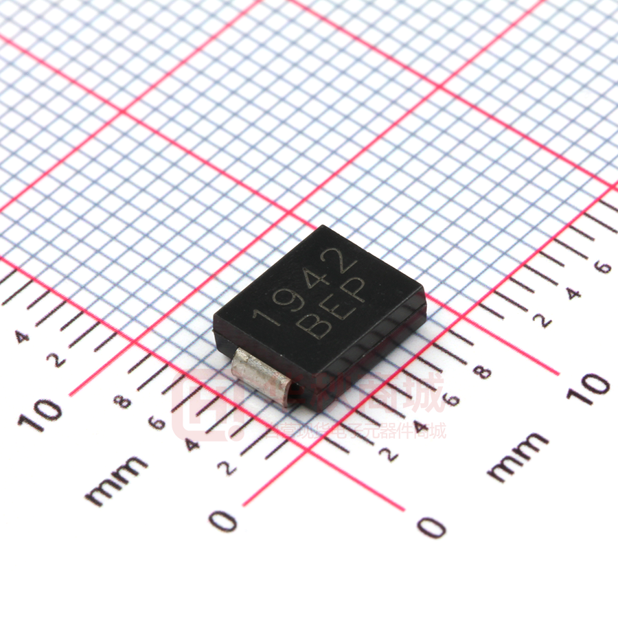

    TVS二极管 VRWM=16V VBR(Min)=17.8V VC=26V IPP=57.7A Ppp=1.5KW SMC
SMCJ16CA 数据手册
SMCJ5.0A(CA) - SMCJ440A(CA) SURFACE MOUNT TRANSIENT VOLTAGE SUPPRESSOR DIODE VOLTAGE RANGE: 5.0 - 440 V POWER: 1500Wa t t s Features ! Glass Passivated Die Construction ! Uni- and Bi-Directional Versions Available ! Excellent Clamping Capability ! Fast Response Time ! Plastic Case Material has UL Flammability Classification Rating 94V-O SMC/DO-214AB B Mechanical Data ! ! ! ! ! A Case: SMC/DO-214AB, Molded Plastic Terminals: Solder Plated, Solderable per MIL-STD-750, Method 2026 Polarity: Cathode Band or Cathode Notch Marking: Type Number Weight: 0.21 grams (approx.) C D J H G E Dim Min Max A 5.59 6.22 B 6.60 7.11 C 2.75 3.18 D 0.15 0.31 E 7.75 8.13 G 0.10 0.20 H 0.76 1.52 J 2.00 2.62 All Dimensions in mm Maximum Ratings @ TA = 25°C unless otherwise specified Characteristic Symbol Value Unit PPK 1500 W IFSM 200 A Steady State Power Dissipation @ TL = 75°C PM(AV) 5.0 W Instantaneous Forward Voltage @ IPP = 100A (Notes 1 & 3) VF See Note 5 V Tj -55 to +150 °C TSTG -55 to +175 °C Peak Pulse Power Dissipation (Non repetitive current pulse derated above TA = 25°C) (Note 1) Peak Forward Surge Current, 8.3ms Single Half Sine Wave Superimposed on Rated Load (JEDEC Method) (Notes 1, 2, & 3) Operating Temperature Range Storage Temperature Range NOTES:1. Non-repetitive current pulse ,per Fig. 3 and derated above TA=25℃ per Fig. 1. 2. Thermal Resistance junction to Lead. 3. 8.3ms single half-wave duty cycle=4 pulses per minutes maximum (uni-directional units only). 1 of 5 www.sunmate.tw Marking TYPE (Uni) (Bi) (Uni) (Bi) Reverse S tand-Off Voltage Breakdown Voltage Min. @IT Breakdown Voltage Max. @ IT VRWM(V) VBR MIN(V) VBR MAX(V) Maximum Peak Reverse Clamping Pulse Leakage Voltage Current @VRWM Current @IPP IT (mA) VC(V) IR(uA) IPP(A) Test SMCJ5.0 SMCJ5.0C GDD BDD 5.0 6.40 7.55 10.0 9.6 156.3 800.0 SMCJ5.0A SMCJ5.0CA GDE BDE 5.0 6.40 7.25 10.0 9.2 163.0 800.0 SMCJ6.0 SMCJ6.0C GDF BDF 6.0 6.67 8.45 10.0 11.4 131.6 800.0 SMCJ6.0A SMCJ6.0CA GDG BDG 6.0 6.67 7.67 10.0 10.3 145.6 800.0 SMCJ6.5 SMCJ6.5C GDH BDH 6.5 7.22 9.14 10.0 12.3 122.0 500.0 SMCJ6.5A SMCJ6.5CA GDK BDK 6.5 7.22 8.30 10.0 11.2 133.9 500.0 SMCJ7.0 SMCJ7.0C GDL BDL 7.0 7.78 9.86 10.0 13.3 112.8 200.0 10.0 12.0 125.0 200.0 1.0 14.3 104.9 100.0 SMCJ7.0A SMCJ7.0CA GDM BDM 7.0 7.78 8.95 SMCJ7.5 SMCJ7.5C GDN BDN 7.5 8.33 10.67 SMCJ7.5A SMCJ7.5CA GDP BDP 7.5 8.33 9.58 1.0 12.9 116.3 100.0 SMCJ8.0 SMCJ8.0C GDQ BDQ 8.0 8.89 11.3 1.0 15.0 100.0 50.0 SMCJ8.0A SMCJ8.0CA GDR BDR 8.0 8.89 10.23 1.0 13.6 110.3 50.0 SMCJ8.5 SMCJ8.5C GDS BDS 8.5 9.44 11.92 1.0 15.9 94.3 20.0 SMCJ8.5A SMCJ8.5CA GDT BDT 8.5 9.44 10.82 1.0 14.4 104.2 20.0 SMCJ9.0 SMCJ9.0C GDU BDU 9.0 10.0 12.6 1.0 16.9 88.8 10.0 10.0 SMCJ9.0A SMCJ9.0CA GDV BDV 9.0 10.0 11.5 1.0 15.4 97.4 SMCJ10 SMCJ10C GDW BDW 10 11.1 14.1 1.0 18.8 79.8 5.0 SMCJ10A SMCJ10CA GDX BDX 10 11.1 12.8 1.0 17.0 88.2 5.0 SMCJ11 SMCJ11C GDY BDY 11 12.2 15.4 1.0 20.1 74.6 5.0 SMCJ11A SMCJ11CA GDZ BDZ 11 12.2 14.0 1.0 18.2 82.4 5.0 SMCJ12 SMCJ12C GED BED 12 13.3 16.9 1.0 22.0 68.2 5.0 SMCJ12A SMCJ12CA GEE BEE 12 13.3 15.3 1.0 19.9 75.4 5.0 SMCJ13 SMCJ13C GEF BEF 13 14.4 18.2 1.0 23.8 63.0 5.0 SMCJ13A SMCJ13CA GEG BEG 13 14.4 16.5 1.0 21.5 69.8 5.0 SMCJ14 SMCJ14C GEH BEH 14 15.6 19.8 1.0 25.8 58.1 5.0 SMCJ14A SMCJ14CA GEK BEK 14 15.6 17.9 1.0 23.2 64.7 5.0 SMCJ15 SMCJ15C GEL BEL 15 16.7 21.1 1.0 26.9 55.8 5.0 SMCJ15A SMCJ15CA GEM BEM 15 16.7 19.2 1.0 24.4 61.5 5.0 SMCJ16 SMCJ16C GEN BEN 16 17.8 22.6 1.0 28.8 52.1 5.0 SMCJ16A SMCJ16CA GEP BEP 16 17.8 20.5 1.0 26.0 57.7 5.0 SMCJ17 SMCJ17C GEQ BEQ 17 18.9 23.9 1.0 30.5 49.2 5.0 SMCJ17A SMCJ17CA GER BER 17 18.9 21.7 1.0 27.6 54.3 5.0 SMCJ18 SMCJ18C GES BES 18 20.0 25.3 1.0 32.2 46.6 5.0 SMCJ18A SMCJ18CA GET BET 18 20.0 23.3 1.0 29.2 51.4 5.0 SMCJ20 SMCJ20C GEU BEU 20 22.2 28.1 1.0 35.8 41.9 5.0 SMCJ20A SMCJ20CA GEV BEV 20 22.2 25.5 1.0 32.4 46.3 5.0 SMCJ22 SMCJ22C GEW BEW 22 24.4 30.9 1.0 39.4 38.1 5.0 SMCJ22A SMCJ22CA GEX BEX 22 24.4 28.0 1.0 35.5 42.3 5.0 SMCJ24 SMCJ24C GEY BEY 24 26.7 33.8 1.0 43.0 34.9 5.0 SMCJ24A SMCJ24CA GEZ BEZ 24 26.7 30.7 1.0 38.9 38.6 5.0 2 of 5 www.sunmate.tw TYPE (Uni) SMCJ26 Marking (Bi) SMCJ26C Reverse Stand-Off Voltage Breakdown Breakdown Voltage Voltage Min. @IT Max. @ IT Maximum Peak Reverse Clamping Pulse Leakage Voltage Current @VRWM Current @IPP Test (Uni) (Bi) VRWM (V) VBR MIN(V) VBR MAX(V) IT (mA) VC(V) IPP(A) IR(uA) GFD BFD 26 28.9 36.6 1.0 46.6 32.2 5.0 SMCJ26A SMCJ26CA GFE BFE 26 28.9 33.2 1.0 42.1 35.6 5.0 SMCJ28 SMCJ28C GFF BFF 28 31.1 39.4 1.0 50.0 30.0 5.0 SMCJ28A SMCJ28CA GFG BFG 28 31.1 35.8 1.0 45.4 33.0 5.0 SMCJ30 SMCJ30C GFH BFH 30 33.3 42.2 1.0 53.5 28.0 5.0 SMCJ30A SMCJ30CA GFK BFK 30 33.3 38.3 1.0 48.4 31.0 5.0 SMCJ33 SMCJ33C GFL BFL 33 36.7 46.5 1.0 59.0 25.4 5.0 SMCJ33A SMCJ33CA GFM BFM 33 36.7 42.2 1.0 53.3 28.1 5.0 SMCJ36 SMCJ36C GFN BFN 36 40.0 50.7 1.0 64.3 23.3 5.0 SMCJ36A SMCJ36CA GFP BFP 36 40.0 46.0 1.0 58.1 25.8 5.0 SMCJ40 SMCJ40C GFQ BFQ 40 44.4 56.3 1.0 71.4 21.0 5.0 SMCJ40A SMCJ40CA GFR BFR 40 44.4 51.1 1.0 64.5 23.3 5.0 SMCJ43 SMCJ43C GFS BFS 43 47.8 60.5 1.0 76.7 19.6 5.0 5.0 SMCJ43A SMCJ43CA GFT BFT 43 47.8 54.9 1.0 69.4 21.6 SMCJ45 SMCJ45C GFU BFU 45 50.0 63.3 1.0 80.3 18.7 5.0 SMCJ45A SMCJ45CA GFV BFV 45 50.0 57.5 1.0 72.7 20.6 5.0 SMCJ48 SMCJ48C GJS BJS 48 53.3 67.5 1.0 85.5 17.5 5.0 SMCJ48A SMCJ48CA GJT BJT 48 53.3 61.3 1.0 77.4 19.4 5.0 SMCJ51 SMCJ51C GJU BJU 51 56.7 71.8 1.0 91.1 16.5 5.0 SMCJ51A SMCJ51CA GJV BJV 51 56.7 65.2 1.0 82.4 18.2 5.0 SMCJ54 SMCJ54C GFW BFW 54 60.0 76.0 1.0 96.3 15.6 5.0 SMCJ54A SMCJ54CA GFX BFX 54 60.0 69.0 1.0 87.1 17.2 5.0 SMCJ58 SMCJ58A SMCJ58C SMCJ58CA GFY GFZ BFY BFZ 58 58 64.4 64.4 81.6 74.1 1.0 1.0 103 93.6 14.6 16.0 5.0 5.0 5.0 SMCJ60 SMCJ60C GGD BGD 60 66.7 84.5 1.0 107 14.0 SMCJ60A SMCJ60CA GGE BGE 60 66.7 76.7 1.0 96.8 15.5 5.0 SMCJ64 SMCJ64C GGF BGF 64 71.1 90.1 1.0 114 13.2 5.0 SMCJ64A SMCJ64CA GGG BGG 64 71.1 81.8 1.0 103 14.6 5.0 SMCJ70 SMCJ70C GGH BGH 70 77.8 98.6 1.0 125 12.0 5.0 SMCJ70A SMCJ70CA GGK BGK 70 77.8 89.5 1.0 113 13.3 5.0 SMCJ75 SMCJ75C GGL BGL 75 83.0 105.7 1.0 134 11.2 5.0 SMCJ75A SMCJ75CA GGM BGM 75 83.0 95.8 1.0 121 12.4 5.0 5.0 SMCJ78 SMCJ78C GGN BGN 78 86.0 109.8 1.0 139 10.8 SMCJ78A SMCJ78CA GGP BGP 78 86.0 99.7 1.0 126 11.9 5.0 SMCJ85 SMCJ85C GGQ BGQ 85 94.0 119.2 1.0 151 9.9 5.0 SMCJ85A SMCJ85CA GGR BGR 85 94.0 108.2 1.0 137 10.9 5.0 SMCJ90 SMCJ90C GGS BGS 90 100 126.5 1.0 160 9.4 5.0 SMCJ90A SMCJ90CA GGT BGT 90 100 115.5 1.0 146 10.3 5.0 SMCJ100 SMCJ100C GGU BGU 100 111 141.0 1.0 179 8.4 5.0 SMCJ100A SMCJ100CA GGV BGV 100 111 128.0 1.0 162 9.3 5.0 SMCJ110 SMCJ110A SMCJ110C SMCJ110CA GGW GGX BGW BGX 10 110 122 122 154.5 140.5 1.0 1.0 196 177 7.7 8.5 5.0 5.0 3 of 5 www.sunmate.tw TYPE (Uni) Marking (Bi) (Uni) (Bi) Reverse Stand-Off Voltage VRWM (V) Breakdown Breakdown Voltage Voltage Min. @IT Max. @ IT VBR MIN(V) VBR MAX(V) Maximum Peak Reverse Clamping Pulse Leakage Voltage Current @VRWM Current @IPP Test IT (mA) VC(V) IPP(A) IR(uA) SMCJ120 SMCJ120C GGY BGY 120 133 169.0 1.0 214 7.0 5.0 SMCJ120A SMCJ120CA GGZ BGZ 120 133 153.0 1.0 193 7.8 5.0 SMCJ130 SMCJ130C GHD BHD 130 144 182.5 1.0 231 6.5 5.0 SMCJ130A SMCJ130CA GHE BHE 130 144 165.5 1.0 209 7.2 5.0 SMCJ150 SMCJ150C GHF BHF 150 167 211.5 1.0 268 5.6 5.0 SMCJ150A SMCJ150CA GHG BHG 150 167 192.5 1.0 243 6.2 5.0 SMCJ160 SMCJ160C GHH BHH 160 178 226.0 1.0 287 5.2 5.0 SMCJ160A SMCJ160CA GHK BHK 160 178 205.0 1.0 259 5.8 5.0 SMCJ170 SMCJ170C GHL BHL 170 189 239.5 1.0 304 4.9 5.0 SMCJ170A SMCJ170CA GHM BHM 170 189 217.5 1.0 275 5.5 5.0 SMCJ180 SMCJ180C GHN BHN 180 200 253.8 1.0 321 4.7 5.0 SMCJ180A SMCJ180CA GHP BHP 180 200 230.4 1.0 290 5.2 5.0 SMCJ190 SMCJ190C GHQ BHQ 190 211 267.9 1.0 339 4.4 5.0 SMCJ190A SMCJ190CA GHR BHR 190 211 243.2 1.0 306 4.9 5.0 SMCJ200 SMCJ200C GHW BHW 200 222 282.0 1.0 356 4.2 5.0 SMCJ200A SMCJ200CA GHX BHX 200 222 256.0 1.0 322 4.7 5.0 SMCJ210 SMCJ210C GHY BHY 210 233 296.1 1.0 375 4.0 5.0 SMCJ210A SMCJ210CA GHZ BHZ 210 233 268.8 1.0 339 4.4 5.0 SMCJ220 SMCJ220C GJD BJD 220 244 310.2 1.0 392 3.8 5.0 SMCJ220A SMCJ220CA GJE BJE 220 244 281.6 1.0 355 4.2 5.0 SMCJ250 SMCJ250C GJF BJF 250 278 342.5 1.0 447 3.4 5.0 SMCJ250A SMCJ250CA GJG BJG 250 278 309.0 1.0 403 3.7 5.0 SMCJ300 SMCJ300C GJH BJH 300 333 411.0 1.0 535 2.8 5.0 SMCJ300A SMCJ300CA GJK BJK 300 333 371.0 1.0 484 3.1 5.0 SMCJ350 SMCJ350C GJL BJL 350 389 479.5 1.0 624 2.4 5.0 SMCJ350A SMCJ350CA GJM BJM 350 389 432.0 1.0 565 2.7 5.0 SMCJ400 SMCJ400C GJN BJN 400 444 548.0 1.0 687 2.2 5.0 SMCJ400A SMCJ400CA GJP BJP 400 444 494.0 1.0 645 2.3 5.0 SMCJ440 SMCJ440C GJQ BJQ 440 489 602.8 1.0 786 1.9 5.0 SMCJ440A SMCJ440CA GJR BJR 440 489 543.0 1.0 710 2.1 5.0 4 of 5 www.sunmate.tw Ratings and Characteristic Curves TA=25°C unless otherwise noted 5 of 5 www.sunmate.tw
