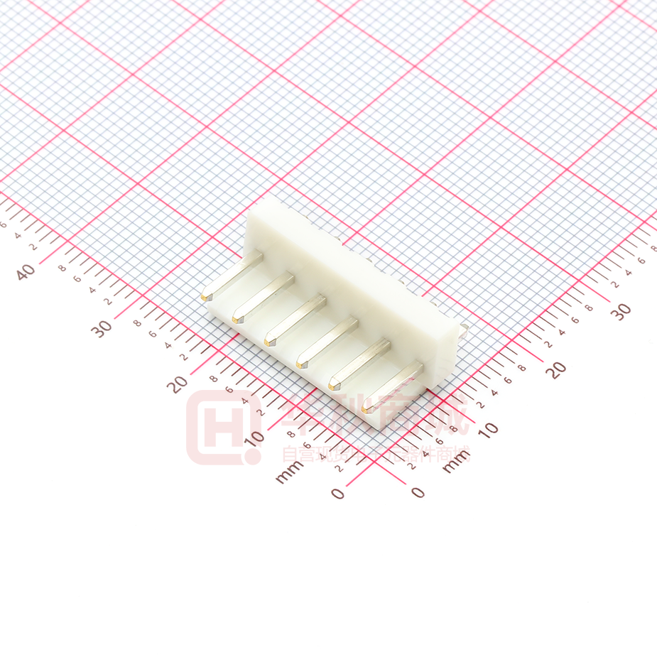

    线对板针座 1x6P 直插 间距:3.96mm
B6P-VH(LF)(SN) 数据手册
VH CONNECTOR 6 3.96mm pitch/Disconnectable Crimp style connectors 2 3 4 5 Specifications ––––––––––––––––––– T JS 6 1 • Current rating: 10 A AC, DC (AWG #16) • Voltage rating: 250 V AC, DC • Temperature range: -25˚C to +85˚C (including temperature rise in applying electrical current) • Contact resistance: Initial value/ 10 mΩ max. After environmental tests/ 20 mΩ max. • Insulation resistance: 1,000 MΩ min. • Withstanding voltage: 1,500 VAC/minute • Applicable wire: AWG #22 to #16 • Applicable PC board thickness: 1.6 mm Note: Do not branch in parallel current which exceeds the rated current. If branched in parallel, current imbalance or other problems may develop. If it is absolutely necessary to branch such a large current in parallel, be sure to use contacts made of phosphor bronze. Design the circuits without causing imbalance and provide an extra margin for each circuit. This small, field-proven connector for printed circuit boards is reliable and has a large current carrying capacity. It can be used with a wide variety of signal, power supply, and output circuits that appear in consumer electronic products. * Refer to "General Instruction and Notice when using Terminals and Connectors" at the end of this catalog. * Contact JST for details. * Compliant with RoHS. Standards––––––––––––––––––––––– 0 Recognized E60389 1 Certified LR20812 2 R75122 • Proven box contact • Compact connector with a large capacity • Secure contact and mounting PC board layout and Assembly layout Locking header Side entry type 3.96 ±0.05 (20.5) (16.5) 8 3.96 ±0.05 10.5 10.5 * 7.2 min Locking header Top entry type +0.1 φ1.65 0 φ1.65 +0.1  0 * 7.2 min *11.0 max. when used with the VR connector receptacle. Shrouded header Locking header Side entry type with PCB stabilizer 3.96 10.5 1.5 ±0.05 +0.1 φ1.4  0 10.5 Circuit No.1 (16.5) (21) 3.4±0.05 3.96 ±0.05 ±0.05 +0.1 φ1.65  0 +0.1 φ1.65  0 19 Note: 1. The above figure is the figure viewed from soldering side. 2. Tolerances are non-cumulative: ±0.05 mm for all centers. 3. Please consider the pattern layout design in case of applying the large current. 4. Hole dimensions differ according to the type of PC board and piercing method. The dimensions above should serve as a guideline. Contact JST for details. 1 VH CONNECTOR Contact Applicable wire mm2 AWG# Model No. SVH-21T-P1.1 SVH-41T-P1.1 10.6 3 4 Insulation O.D. (mm) Q'ty/reel 0.33∼0.83 22∼18 1.7∼3.0 4,500 0.5 ∼1.25 20∼16 1.7∼3.0 3,500 4.2 Material and Finish 3.8 Phosphor bronze, tin-plated (reflow treatment) RoHS compliance Note: When using retainer mountable type housing, applicable wire's insulation O. D. shall be 1.7 to 2.2 mm. Contact SVH-21T-P1.1 Applicator Dies Crimp applicator with dies MKS-L MK/SVH-21-11 APLMK SVH21-11 *MKS-SC SC/SVH-21-11 APLSC SVH21-11 Crimping machine Crimp applicator AP-K2N Contact SVH-41T-P1.1 Applicator Dies Crimp applicator with dies MKS-L MK/SVH-41-11 APLMK SVH41-11 − − − Crimping machine Crimp applicator AP-K2N Note: *Strip-crimp applicator Housing M type Retainer mountable type A 10.5 Dimensions (mm) Model No. Circuits 2 3 4 5 6 7 8 9 10 11 Circuit No.1 13.3 13.3 Circuit No.1 N type M type Retaine mountable type VHR-2N VHR-3N VHR-4N VHR-5N VHR-6N VHR-7N VHR-8N VHR-9N VHR-10N VHR-11N VHR-2M VHR-3M VHR-4M VHR-5M VHR-6M VHR-7M ― VHR-9M ― ― VHRR-2N VHRR-3N ― VHRR-5N ― VHRR-7N VHRR-8N VHRR-9N ― ― A B Q'ty/ bag 3.96 7.86 1,000 7.92 11.82 11.88 15.78 ( *) 1,000 15.84 19.74 ( *) 19.80 23.70 500 23.76 27.66 500 27.72 31.62 500 31.68 35.58 500 35.64 39.54 500 39.60 43.50 500 15 Circuit No.1 B 5.7 A 10.5 A 6.2 B 5.7 B 10.6 N type Note: 1. Models identified as VHR-( ) M incorporate measures to prevent electric shock and are thus safer in regard to high voltages. 2. The applicable housing for 2 circuits shrouded header is "VHR-2N" only. "VHRR-2N" is not applicable. 3. Contact JST for Glow Wire compliant connectors. (*) N / M type ; 1,000 Retainer mountable type ; 500 As the color identification, the following alphabet shall be put in the underlined part. For availability, delivery and minimum order quantity, contact JST. ex. Material VHR-2N-oo(blank)…natural (white) BK…black R…red BL…blue M…green D…orange Y…yellow PK…pink H…gray PA 6, UL94V-0, natural (white) RoHS compliance Retainer Circuits 2 circuits : 2.6 3 to 9 circuits : 4.2 2 3 5 7 8 A 9 Model No. VHS-2V VHS-3V VHS-5V VHS-7V VHS-8V VHS-9V A Q'ty/bag 3.70 1,000 7.52 1,000 15.44 1,000 23.36 1,000 27.32 1,000 31.28 1,000 Material Glass-filled PA 66, UL94V-0, natural (ivory) RoHS compliance 7.1 2 VH CONNECTOR Locking header Top entry type Circuits (9.4) 1 H JST 8 3 4 5 2 Circuit No.1 8.5 1.14 2 6 3.2 7.7 A 7 14.6 B 8 9 10 Model No. Top entry Side entry type type B2P-VH B3P-VH B4P-VH B5P-VH B6P-VH B7P-VH B8P-VH B9P-VH B10P-VH B2PS-VH B3PS-VH B4PS-VH B5PS-VH B6PS-VH B7PS-VH B8PS-VH B9PS-VH B10PS-VH Q'ty/box Dimensions (mm) A B Top entry Side entry type type 3.96 7.86 1,000 1,000 7.92 11.82 1,000 500 11.88 15.78 500 500 15.84 19.74 500 250 19.80 23.70 250 250 23.76 27.66 250 250 27.72 31.62 200 200 31.68 35.58 200 200 35.64 39.54 200 100 Material and Finish Side entry type Post: Brass, copper-undercoated, tin-plated (reflow treatment) Wafer: PA 66, UL94V-0, natural (white) (9.4) 1 H JST 8.5 2 Circuit No.1 8 1.14 RoHS compliance This product displays (LF)(SN) on a label. Note: 1. Headers with a reduced number of posts are also available. Contact JST for details. 2. Contact JST for Glow Wire compliant connectors. 7.7 3.96 A As the color identification, the following alphabet shall be put in the underlined part. For availability, delivery and minimum order quantity, contact JST. 3.2 14.9 ex. B Model No. Top entry type of PBT Circuits (9.4) 1.7 B 2 4 6 7.7 Circuit No.1 A 5 1.14 2 8.5 6.8 3 (1.95) B2P(S)-VH-oo(blank)…natural (white) BK…black R…red TR…tomato red BL…blue M…green O…orange Y…yellow PK…pink H…gray (1.95) 3.2 7 (14.6) 8 9 10 11 Q'ty/box Dimensions (mm) Top entry type of PBT Side entry type with PCB stabilizer B2P-VH-B B3P-VH-B B4P-VH-B B5P-VH-B B6P-VH-B B7P-VH-B B8P-VH-B B9P-VH-B B10P-VH-B B11P-VH-B S2P-VH S3P-VH S4P-VH S5P-VH S6P-VH S7P-VH ― ― ― ― B Top entry type Side entry type 3.96 7.86 1,000 1,000 7.92 11.82 1,000 500 11.88 15.78 500 500 15.84 19.74 500 250 19.80 23.70 250 250 23.76 27.66 250 250 27.72 31.62 200 31.68 35.58 200 35.64 39.54 200 39.60 43.50 200 ― ― ― ― A Material and Finish Post: Brass, copper-undercoated, tin-plated (reflow treatment) Wafer: Top entry type of PBT: Glass-filled PBT, UL94V-0, natural (white) Side entry type with PCB stabilizer: PA 66, UL94V-0, natural (white) Side entry type with PCB stabilizer RoHS compliance This product displays (LF)(SN) on a label. (9.4) 4.5 2 1.14 B 3.6 Circuit No.1 7.7 A 3 13.4 As the color identification, the following alphabet shall be put in the underlined part. For availability, delivery and minimum order quantity, contact JST. ex. B2P-VH-B-oo(blank)…natural (white) C…black R…red E…blue M…green Y…yellow ex. S2P-VH-oo(blank)…natural (white) BK…black R…red BL…blue M…green Y…yellow VH CONNECTOR Shrouded header Circuits B 9.7 B2P-VH-FB-B B3P-VH-FB-B B4P-VH-FB-B B5P-VH-FB-B B6P-VH-FB-B B7P-VH-FB-B B8P-VH-FB-B B9P-VH-FB-B B10P-VH-FB-B 2 3 4 11 5 1.5 6 7 3.7 8 9 A Circuit No.1 10 1.14 Dimensions (mm) A B Model No. Q’ty/ box 3.96 9.80 250 7.92 13.76 200 11.88 17.72 150 15.84 21.68 200 19.80 25.64 200 23.76 29.60 100 27.72 33.56 100 31.68 37.52 100 35.64 41.48 125 Material and Finish Post: Copper alloy, copper-undercoated, tin-plated (reflow treatment) Wafer: Glass-filled PBT, UL94V-0, natural (white) RoHS compliance This product displays (LF)(SN) on a label. Note: The applicable housing for 2 circuits shrouded header is "VHR-2N" only. "VHRR-2N" is not applicable. 9.7 11 B 3.7 1.5 As the color identification, the following alphabet shall be put in the underlined part. For availability, delivery and minimum order quantity, contact JST. 3.96 Circuit No.1 ex. B2P-VH-FB-B-oo(blank)…natural (white) C…black R…red E…blue M…green O…orange Y…yellow PK…pink H…gray 1.14 A Post-omitted Header 1) When giving the polarity to the product by removing the post (N-1)th circuit However, since the product that the 2nd post of 3-circuit connector is omitted doesn't have polarity, select 3). B *1 P *2 -VH e.g.) Circuit No. 1 2 3 4 5 6 7 Circuit (post) *1; No. of circuits (No. of posts) *2; Circuit No. of used original header Model No. B6P7-VH ; With circuit (post) ; Without circuit (post) 2) When giving the polarity to the product by removing the post in 2nd circuit However, since the product that the 2nd post of 3-circuit connector is omitted doesn't have polarity, select 3). B *1 P *2 -VH-L e.g.) Circuit No. 1 2 3 4 5 6 7 3 4 5 6 7 3 4 5 6 7 3 4 5 6 7 Circuit (post) Model No. B6P7-VH-L Circuit No. 1 3) When the pitch is set again 1. When setting two times of pitch with omitting every other one post However, posts shall be inserted in No.1-circuit and No. N-circuit. e.g.) B *1 P *2 -VH 2 Circuit (post) Model No. B4P7-VH 2. When setting three times of pitch with omitting every other two posts However, posts shall be inserted in No.1-circuit and No. N-circuit. B *1 P *2 -VH e.g.) Circuit No. 1 2 Circuit (post) Model No. B3P7-VH 3. When setting four times of pitch with omitting every other three posts However, posts shall be inserted in No.1-circuit and No. N-circuit. e.g.) B *1 P *2 -VH Circuit No. 1 2 8 9 Circuit (post) Model No. B3P9-VH 4
B6P-VH(LF)(SN)
物料型号: - VH CONNECTOR有多种型号,包括但不限于B2P-VH, B2PS-VH, B3P-VH, B3PS-VH等,具体型号取决于所需的电路数量。
器件简介: - VH CONNECTOR是一种小型、现场验证的连接器,适用于印刷电路板,具有可靠性和大电流承载能力。它可用于多种信号、电源和输出电路,这些电路出现在消费电子产品中。
引脚分配: - 引脚分配的细节在文档中有详细描述,包括不同类型连接器的尺寸和引脚布局。
参数特性: - 额定电流:10 A AC, DC (AWG #16) - 额定电压:250 V AC, DC - 温度范围:-25˚C到+85˚C - 接触电阻:初始值/10 mΩ最大,环境测试后/20 mΩ最大 - 绝缘电阻:1,000 MΩ最小 - 耐压:1,500 VAC/分钟 - 适用电线:AWG #22到#16 - 适用PC板厚度:1.6 mm
功能详解: - VH CONNECTOR设计用于高电流应用,具有防触电措施的型号,以及用于高电压应用的安全型号。它还符合RoHS标准。
应用信息: - VH CONNECTOR适用于多种电路,包括信号、电源和输出电路。文档中还提到了在大电流应用时的设计注意事项。
封装信息: - 封装材料包括磷青铜、镀锡(回流处理)、PA 6、UL94V-0等,具体材料取决于连接器的类型和应用。
