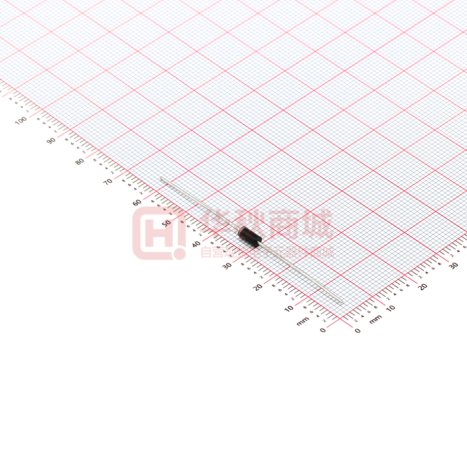

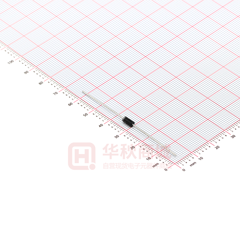

2EZ3.6D5 -2EZ200D5 AXIAL LEADED SILICON ZENER DIODES VOLTAGE RANGE: 3.6 - 200V POWER: 2.0Wa t t s Features ! Complete Voltage Range 3.6 to 200 Volts ! High peak reverse power dissipation ! High reliability B A A ! Low leakage current C Mechanical Data D ! Case : DO-41 Molded plastic ! Epoxy : UL94V-O rate flame retardant ! Lead : Axial lead solderable per MIL-STD-202, method 208 guaranteed ! Polarity : Color band denotes cathode end ! Mounting position : Any DO-41 ! Weight : 0.339 gram Dim Min Max A 25.40 ¾ B 4.06 5.21 C 0.71 0.864 D 2.00 2.72 All Dimensions in mm Maximum Ratings and Electrical Characteristics @ TA = 25°C unless otherwise specified Single phase, half wave, 60Hz, resistive or inductive load. Rating Symbol Value Unit DC Power Dissipation at TL = 75 °C (Note1) PD 2.0 Watts Maximum Forward Voltage at IF = 200 mA VF 1.2 Volts 60 K/W Maximum Thermal Resistance Junction to Ambient Air (Note2) RθJA Junction Temperature Range TJ - 55 to + 175 °C Storage Temperature Range Ts - 55 to + 175 °C Note : (1) TL = Lead temperature at 3/8 " (9.5mm) from body (2) Valid provided that leads are kept at ambient temperature at a distance of 10 mm from case. PD, MAXIMUM DISSIPATION (WATTS) Fig. 1 POWER TEMPERATURE DERATING CURVE 2.5 L = 3/8" (9.5mm) 2.0 1.5 1.0 0.5 0 0 25 50 75 100 125 150 175 TL, LEAD TEMPERATURE (° C) 1 of 2 www.sunmate.tw TYPE 2EZ3.6D5 2EZ3.9D5 2EZ4.3D5 2EZ4.7D5 2EZ5.1D5 2EZ5.6D5 2EZ6.2D5 2EZ6.8D5 2EZ7.5D5 2EZ8.2D5 2EZ9.1D5 2EZ10D5 2EZ11D5 2EZ12D5 2EZ13D5 2EZ14D5 2EZ15D5 2EZ16D5 2EZ17D5 2EZ18D5 2EZ19D5 2EZ20D5 2EZ22D5 2EZ24D5 2EZ27D5 2EZ30D5 2EZ33D5 2EZ36D5 2EZ39D5 2EZ43D5 2EZ47D5 2EZ51D5 2EZ56D5 2EZ62D5 2EZ68D5 2EZ75D5 2EZ82D5 2EZ91D5 2EZ100D5 2EZ110D5 2EZ120D5 2EZ130D5 2EZ140D5 2EZ150D5 2EZ160D5 2EZ170D5 2EZ180D5 2EZ190D5 2EZ200D5 Nominal Zener Voltage VZ @ IZT IZT (V) (mA) 3.6 139 3.9 128 4.3 116 4.7 106 5.1 98.0 5.6 89.5 6.2 80.5 6.8 73.5 7.5 66.5 8.2 61.0 9.1 55.0 10 50.0 11 45.5 12 41.5 13 38.5 14 35.7 15 33.4 16 31.2 17 29.4 18 27.8 19 26.3 20 25.0 22 22.8 24 20.8 27 18.5 30 16.6 33 15.1 36 13.9 39 12.8 43 11.6 47 10.6 51 9.8 56 9.0 62 8.1 68 7.4 75 6.7 82 6.1 91 5.5 100 5.0 110 4.5 120 4.2 130 3.8 140 3.6 150 3.3 160 3.1 170 2.9 180 2.8 190 2.6 200 2.5 ZZT @ IZT (Ω) 5.0 5.0 4.5 4.5 3.5 2.5 1.5 2.0 2.0 2.3 2.5 3.5 4.0 4.5 5.0 5.5 7.0 8.0 9.0 10 11 11 12 13 18 20 23 25 30 35 40 48 55 60 75 90 100 125 175 250 325 400 500 575 650 675 725 825 900 Maximum Zener Impedance ZZK @ IZK (Ω) 400 400 400 550 600 500 700 700 700 700 700 700 700 700 700 700 700 700 750 750 750 750 750 750 750 1000 1000 1000 1000 1500 1500 1500 2000 2000 2000 2000 3000 3000 3000 4000 4500 5000 5500 6000 6500 7000 7000 8000 8000 IZK (mA) 1.0 1.0 1.0 1.0 1.0 1.0 1.0 1.0 0.5 0.5 0.5 0.25 0.25 0.25 0.25 0.25 0.25 0.25 0.25 0.25 0.25 0.25 0.25 0.25 0.25 0.25 0.25 0.25 0.25 0.25 0.25 0.25 0.25 0.25 0.25 0.25 0.25 0.25 0.25 0.25 0.25 0.25 0.25 0.25 0.25 0.25 0.25 0.25 0.25 Maximum Reverse Leakage Current IR @ VR (V) (µ A) 80 1.0 30 1.0 20 1.0 5.0 1.0 5.0 1.0 5.0 2.0 5.0 3.0 5.0 4.0 50 5.0 50 6.0 50 7.0 50 7.6 50 8.4 1.0 9.1 0.5 9.9 0.5 10.6 0.5 11.4 0.5 12.2 0.5 13.0 0.5 13.7 0.5 14.4 0.5 15.2 0.5 16.7 0.5 18.2 0.5 20.6 0.5 22.5 0.5 25.1 0.5 27.4 0.5 29.7 0.5 32.7 0.5 35.8 0.5 38.8 0.5 42.6 0.5 47.1 0.5 51.7 0.5 56.0 0.5 62.2 0.5 69.2 0.5 76.0 0.5 83.6 0.5 91.2 0.5 98.8 0.5 106.4 0.5 114.0 0.5 121.6 0.5 130.4 0.5 136.8 0.5 144.8 0.5 152.0 Maximum DC Zener Current IZM (mA) 504 468 434 386 356 324 292 266 242 220 200 182 166 152 138 130 122 114 107 100 95 90 82 76 68 60 55 50 47 43 39 36 32 29 27 24 22 20 18 17 15 14 13 12 11 11 10 10 9.0 Note : ( 1 ) Suffix " 5 " indicates ± 5.0% tolerance, suffix " 10 " indicates ± 10.0% tolerance. 2 of 2 www.sunmate.tw
