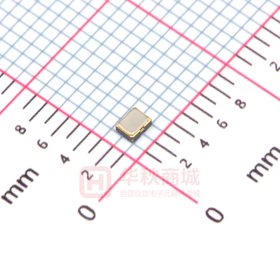

    有源晶振 19.200000MHz ±10ppm 1.8V~3.3V-40℃~+85℃ CMOS
OT201619.2MJBA4SL 数据手册
CRYSTAL OSCILLATOR YSO110TR Wide Voltage Applications Features ‧Consumer Electronics Industrial Control IOT ‧Frequency range:1MHz-54MHz . ‧Ultra Small SMD seam sealed ‧Package Size: 1.6*1.2 , 2.0*1.6 2.5*2.0 , 3.2*2.5 , 5.0*3.2 , 7.0*5.0mm crystal oscillator units. Specifications Frequency Range 1MHz to 54MHz,or specify Parameter 1.8V~3.3V Output Type CMOS Frequency Tolerance(at 25℃) ±10ppm,±20ppm,or specify Output Load 15pF Operating Temperature Range -40~+85℃,-40~+125℃,or specify Storage Temperature Range -55~+125℃ Frequency Versus Temperature Characteristics ± 20ppm, ± 30ppm, ± 50ppm, or specify Voltage Vol ( Max. ) / Vol ( Min. ) VOH = 90%Vdd/VOL = 10%Vdd Duty Cycle 45~55% Start-up Time 3ms Max. Rise Time/Fall Time 4nS Max Supply Current See Below Frequency Aging (at 25℃) ±3 ppm / year Max. Current Consumption Power Dissipation Vcc=1.8~3.3V 15pF only 1.000~40.000MHZ Supply Voltage (V) 7050/5032/3225 1.8V 4mA max 2.5V 3.3V 4.5mA max 5mA max 2520/2016/1612 4mA max Pin Dimension 41.000~54.000MHZ 7050/5032/3225/2520 9mA max 10mA max 12mA max 2016/1612 10mA max Pin Assignments Pin #1 #2 #3 #4 FUNCTION Tri-state GND OUTPUT VDD www.yxc.hk 第1页共4页 CRYSTAL OSCILLATOR YSO110TR Wide Voltage Dimensions and Patterns [unit:mm] Package Size – Dimensions (Unit: mm) Recommended Land Pattern (Unit: mm) #3 #2 #4 0.60max #1 Bottom View #2 1.25±0.1 MARKING #1 #3 0.57±0.1 0.7±0.1 0.775 0.5 0.775 0.6 0.2 0.6 1.65±0.1 #4 0.475±0.1 0.5±0.1 0.475±0.1 1.6*1.2mm #3 #4 #2 #3 0.775 0.5 0.775 2.5±0.1 0.9 0.95 0.9 #4 #3 0.95 0.8±0.1 0.8 0.65 0.8 0.65 MARKING #2 2.0±0.1 #1 0.68 2.5*2.0mm #2 0.1 0.57±0.1 0.7±0.1 0.85max #1 Bottom View 1.65±0.1 MARKING #1 0.675 0.3 0.675 2.05±0.1 #4 0.475±0.1 0.5±0.1 0.475±0.1 2.0*1.6mm 0.78 0.4 3.2*2.5mm 3.2±0.15 1.3 1.0 1.2 0.9 #3 0.9±0.1 #4 1.1 0.8 1.1 1.0 2.5±0.1 MARKING 1.3 #2 0.65 #1 www.yxc.hk 第2页共4页 CRYSTAL OSCILLATOR YSO110TR Wide Voltage 5.0*3.2mm 1.4 2.54±0.1 5.0±0.2 #2 2.2 1.0 MARKING 3.2±0.1 1.2 #1 #4 #3 1.2±0.1 1.2 2.54 7.0*5.0mm 7.00±0.15 #2 5.08±0.15 2.0 #3 3.28 1.4±0.1 #4 2.2 2.6±0.1 MARKING 1.4±0.15 0.6±0.15 5.0±0.1 #1 1.8 Notes: 1.A capacitor of value 0.01uf~0.1uf or higher between Vdd and GND is required. Reflow Soldering Profile Pre Heating Temperature Tp1 ~ Tp2 = + 170 °C Heating Temperature TMlt = + 220 °C Peek Temperature TMax. = + 260 °C Temperature +260℃ TMax. +220℃ Tmlt Point of measuring In case of Solder ability Terminal. In case of Resistance to soldering heat Surface. Tp2 Tp1 35s 100s t(time) www.yxc.hk 第3页共4页 CRYSTAL OSCILLATOR YSO110TR Wide Voltage Test Circuit Taping Specification(Unit: mm) Size(OSC) A B C D E F G H SMD-7050 180±2.0 16.0±0.3 7.50±0.1 5.50±0.1 8.0±0.1 2.00±0.1 61.0±1.0 16.0±1.0 SMD-5032 180±2.0 12.0±0.3 5.40±0.1 3.60±0.1 8.0±0.1 1.70±0.1 61.0±1.0 12.0±1.0 SMD-3225 180±2.0 8.0±0.3 3.40±0.1 2.70±0.1 4.0±0.1 1.50±0.1 61.0±1.0 8.0±1.0 SMD-2520 180±2.0 8.0±0.3 2.90±0.1 2.40±0.1 4.0±0.1 1.20±0.1 61.0±1.0 8.0±1.0 SMD-2016 180±2.0 8.0±0.3 2.30±0.1 1.90±0.1 4.0±0.1 0.95±0.1 61.0±1.0 8.0±1.0 SMD-1612 180±2.0 8.0±0.3 1.80±0.1 1.40±0.1 4.0±0.1 0.80±0.1 61.0±1.0 8.0±1.0 www.yxc.hk 第4页共4页
OT201619.2MJBA4SL
物料型号:YSO110TR WideVoltage
器件简介:YSO110TR WideVoltage是一款宽电压范围的晶体振荡器,适用于工业控制、物联网等应用。
引脚分配: - #1:三态(Tri-state) - #2:地(GND) - #3:输出(OUTPUT) - #4:电源(VDD)
参数特性: - 频率范围:1MHz至54MHz,或指定 - 输出类型:CMOS - 频率容差(25°C时):±10ppm、20ppm或指定 - 输出负载:15pF - 工作温度范围:-40°C至+85°C、-40°C至+125°C或指定 - 存储温度范围:-55°C至+125°C - 频率与温度特性:±20ppm、±30ppm、±50ppm或指定 - 电压变化(最大/最小):VOH=90%Vdd/VOL=10%Vdd - 占空比:45%至55% - 启动时间:最大3ms - 上升时间/下降时间:最大4ns - 供电电流:详见文档表格
功能详解:YSO110TR WideVoltage晶体振荡器提供了超小型SMD密封晶体振荡器单元,具有多种封装尺寸,适用于不同的应用需求。
应用信息:适用于工业控制、物联网等。
封装信息:提供了多种封装尺寸,包括1.61.2mm、2.01.6mm、2.52.0mm、3.22.5mm、5.03.2mm和7.05.0mm。
