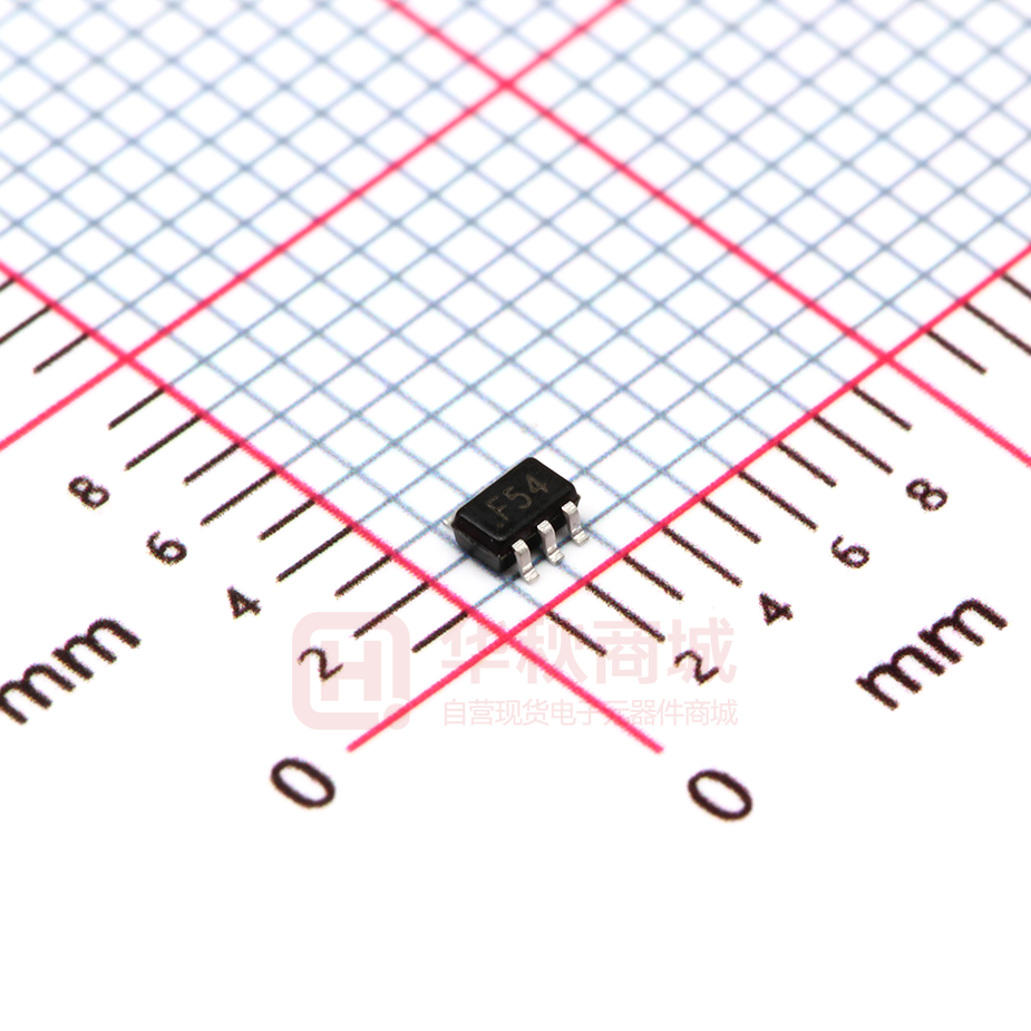

TPPRTR5V0U4Y 4-Line Uni-directional TVS Diode www.sot23.com.tw Features Mechanical Characteristics ⚫ Ultra low capacitance: 0.3pF typical (I/O-IO) ⚫ Package: SOT363 ⚫ Ultra low leakage: nA level ⚫ Lead Finish:Matte Tin ⚫ Low operating voltage: 5V ⚫ Case Material: “Green” Molding Compound. ⚫ Low clamping voltage ⚫ Moisture Sensitivity: Level 3 per J-STD-020 ⚫ Complies with following standards: ⚫ Terminal Connections: See Diagram Below IEC 61000-4-2 (ESD) immunity test Air discharge : ±20kV Contact discharge : ±15kV ⚫ Shipping Qty : 3000pcs/7Inch Tape & Reel Applications ⚫ Monitors and flat panel displays – IEC61000-4-5 (Lightning) 5A (8/20μs) ⚫ Set-top box and Digital TV ⚫ RoHS Compliant ⚫ Video graphics cards 子 ⚫ Digital Video Interface (DVI) 台 舟 电 Dimensions and Pin Configuration TPPRTR5V0U4Y 4-Line Uni-directional TVS Diode www.sot23.com.tw Absolute Maximum Ratings (Tamb=25°C unless otherwise specified) Parameter Symbol Value Unit Peak Pulse Power (8/20µs) Ppk 70 W Peak Pulse Current (8/20µs) Ipp 5 A ESD per IEC 61000−4−2 (Air) ±20 VESD ESD per IEC 61000−4−2 (Contact) Operating Temperature Range kV TJ −55 to +125 °C Tstg −55 to +150 °C 子 Storage Temperature Range ±15 Electrical Characteristics (TA=25°C unless otherwise specified) Symbol Reverse Working Voltage Reverse Leakage Current 5 V 9 V IR 0.08 uA VC 10 V Ipp=1A(8x 20us pulse) 14 V Ipp=5A(8x 20us pulse) 0.8 pF VR = 0V, f = 1MHz, IO to GND pF VR = 0V, f = 1MHz, IO to IO 台 Clamping Voltage Clamping Voltage Unit VBR Typ 6 7.5 舟 Breakdown Voltage Max VRWM Min 电 Parameter VC Junction Capacitance CJ 0.6 Junction Capacitance CJ 0.3 2 Test Condition IT = 1mA VRWM = 5V TPPRTR5V0U4Y 4-Line Uni-directional TVS Diode www.sot23.com.tw 舟 电 子 Typical Performance Characteristics (TA=25°C unless otherwise Specified) 台 % Of Rated Power FIGURE 3 TPPRTR5V0U4Y 4-Line Uni-directional TVS Diode www.sot23.com.tw SOT-363 Package Outline Drawing DIM D e1 A A1 A2 b c D E1 E e e1 L L1 N 01 aaa bbb ccc N E/2 E1 ccc C 2X N/2 TIPS 1 E 2 e D aaa C A1 C bxN bbb A 舟 A2 SEATING PLANE .043 .000 .004 .028 .035 .039 .012 .006 .003 .009 .071 .079 .087 .045 .049 .053 .083 BSC .026 BSC .051 .010 .014 .018 (.017) 6 8° 0° .004 .004 .012 1.10 0.00 0.10 0.70 0.90 1.00 0.15 0.30 0.08 0.22 1.80 2.00 2.20 1.15 1.25 1.35 2.10 BSC 0.65 BSC 1.30 BSC 0.26 0.36 0.46 (0.42) 6 0° 8° 0.10 0.10 0.30 电 B DIMENSIONS INCHES MILLIMETERS MIN NOM MAX MIN NOM MAX 子 A C A-B D H c GAGE PLANE 台 0.15 SIDE VIEW Suggested Land Pattern L (L1) DETAIL SEE DETAIL 4 A A 01
