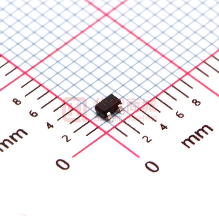

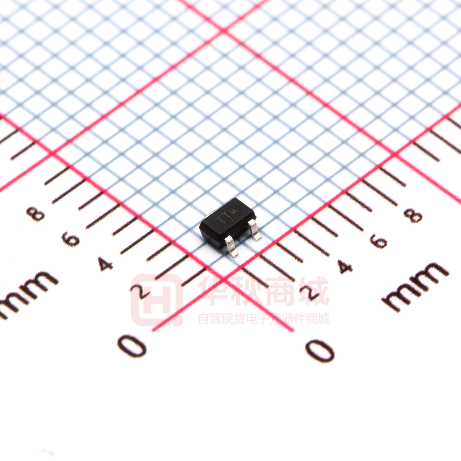

    类型:P沟道 漏源电压(Vdss):20V 连续漏极电流(Id):2.3A 功率(Pd):290mW 导通电阻(RDS(on)@Vgs,Id):100mΩ@4.5V,2.3A 阈值电压(Vgs(th)...
TPDMP2160UW 数据手册
TPDMP21 6 0UW P-Channel Enhancement-Mode MOS FETs www.sot23.com.tw Features Applications ƽ -20V, -2.3A, RDS(ON) =100mΩ (typ) @VGS =4.5V. ƽBattery protection ƽ ƽLoad switch RDS(ON) = 125mΩ (typ) @VGS = 2.5V. ƽPower management ƽ SOT-323 package. Ordering Information Part Number Reel Size  w S G SOT-323 TE C D H PU BL IC TPDMP2160UW Qty per Reel Absolute Maximum Ratings (TA=25°C unless otherwise specified) Parameter Symbol Value Unit Drain-Source Voltage VDS - 20 Gate-Source Voltage VGS ±10 Continuous Drain Current ID -2.3 Pulsed Drain Current (tp=10µs) IDM -5.0 Power Dissipation PD 0.29 W RθJA 431 ℃/W Junction Temperature TJ 125 Storage Temperature Tstg -50 ~+150 Thermal Resistance from Junction to Ambient V A ℃ TPDMP21 6 0UW P-Channel Enhancement-Mode MOS FETs www.sot23.com.tw Electrical Characteristics (T A=25°C unless otherwise specified) Parameter Symbol Test Condition Min Typ -20 -20 Max Unit OFF CHARACTERISSTICS VDSS VGS = 0V, ID =-250µA Gate-Source Leakage IGSS VDS =0V, VGS =±8V ±100 nA Zero Gate Voltage Drain Current IDSS VDS =-20V, VGS =0V -1.0 µA -1.0 V IC Drain-Source Breakdown Voltage Gate-Source Threshold Voltage VGS(th) Drain-Source On-State Resistance RDS(on) Ciss Output Capacitance Coss Rise Time Turn-Off Delay Time Fall Time 100 VGS =-2.5V, ID =-1A 125 VDS =-8.0V,VGS =0V,f =1MHz 120 82 6.2 td(on) tr td(off) tf mΩ 640 Crss SWITCHING CHARACTERISSTICS Turn-On Delay Time -0.7 TE Reverse Transfer Capacitance -0.45 VGS =-4.5V, ID =-2.3A C Input Capacitance VDS =VGS, ID =-250µA H CHARGES AND CAPACITANCES PU BL OFF CHARACTERISSTICS V VGS=-4.5V,VDD=-4.0V, 15 ID =-1.0A,RG=6.2Ω 26 18 pF ns TPDMP21 6 0UW P-Channel Enhancement-Mode MOS FETs www.sot23.com.tw PACKAGE DIMENSIONS SC−70 (SOT−323) CASE 419−04 ISSUE N NOTES: 1. DIMENSIONING AND TOLERANCING PER ANSI Y14.5M, 1982. 2. CONTROLLING DIMENSION: INCH. e1 IC D E HE 2 PU 1 b C A1 MIN 0.80 0.00 0.30 0.10 1.80 1.15 1.20 0.20 2.00 MILLIMETERS NOM MAX 0.90 1.00 0.05 0.10 0.70 REF 0.35 0.40 0.18 0.25 2.10 2.20 1.24 1.35 1.30 1.40 0.65 BSC 0.38 0.56 2.10 2.40 STYLE 8: PIN 1. GATE 2. SOURCE 3. DRAIN c A2 TE 0.05 (0.002) H e A DIM A A1 A2 b c D E e e1 L HE BL 3 L SOLDERING FOOTPRINT* 0.65 0.025 0.65 0.025 1.9 0.075 0.9 0.035 0.7 0.028 SCALE 10:1 mm Ǔ ǒinches MIN 0.032 0.000 0.012 0.004 0.071 0.045 0.047 0.008 0.079 INCHES NOM 0.035 0.002 0.028 REF 0.014 0.007 0.083 0.049 0.051 0.026 BSC 0.015 0.083 MAX 0.040 0.004 0.016 0.010 0.087 0.053 0.055 0.022 0.095
