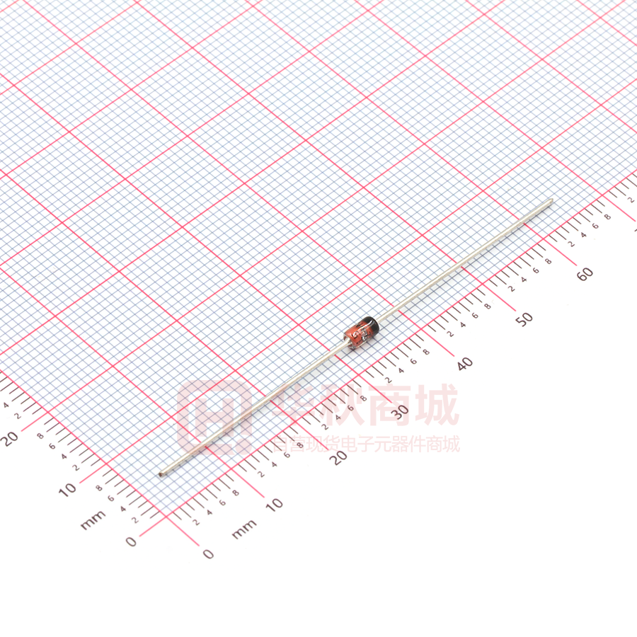

    二极管配置:独立式 稳压值(标称值):16V 精度:±5% 功率:1W 反向电流(Ir):5uA@12.2V 阻抗(Zzt):16Ω 16V 1W
1N4745A 数据手册
1N4727A...1N4764A SILICON PLANAR POWER ZENER DIODES for use in stabilizing and clipping circuits with high power rating. Max. 0.7 Min. 25.4 Max. 2.8 Black Cathode Band Black Part No. Black "ST" Brand XXX Max. 4.2 ST Min. 25.4 Glass Case DO-41 Dimensions in mm Absolute Maximum Ratings (Ta = 25 OC) Parameter Symbol Power Dissipation Ptot Value 1 1) Unit W Junction Temperature Tj 200 O Storage Temperature Range TS - 65 to + 200 O 1) C C Valid provided that leads at a distance of 8 mm from case are kept at ambient temperature. Characteristics at Ta = 25 OC Parameter Symbol Thermal Resistance Junction to Ambient Air Forward Voltage at IF = 200 mA 1) RthA VF Max. Unit 1) K/W 170 1.2 V Valid provided that leads at a distance of 8 mm from case are kept at ambient temperature. SEMTECH ELECTRONICS LTD. ® (Subsidiary of Sino-Tech International Holdings Limited, a company listed on the Hong Kong Stock Exchange, Stock Code: 724) Dated : 12/06/2007 1N4727A...1N4764A Maximum Zener Impedance 1) Zener Voltage Range 3), 5) Type VZnom VZ lZT rZJT rZJK at IZK Maximum Reverse Maximum Surge Maximum Leakage Current Current 4) Regulator Current 2) IR at VR at Ta = 25 OC V mA Ω Ω mA µA V IZSM (mA) IZM (mA) V 1N4727A 3 2.85…3.15 83 10 400 1 150 1 1375 275 1N4728A 3.3 3.13…3.47 76 10 400 1 150 1 1375 275 1N4729A 3.6 3.42…3.78 69 10 400 1 100 1 1260 252 1N4730A 3.9 3.7…4.1 64 9 400 1 100 1 1190 234 1N4731A 4.3 4.08…4.52 58 9 400 1 50 1 1070 217 1N4732A 4.7 4.46…4.94 53 8 500 1 10 1 970 193 1N4733A 5.1 4.84…5.36 49 7 550 1 10 1 890 178 1N4734A 5.6 5.32…5.88 45 5 600 1 10 2 810 162 1N4735A 6.2 5.89…6.51 41 2 700 1 10 3 730 146 1N4736A 6.8 6.46…7.14 37 3.5 700 1 10 4 660 133 1N4737A 7.5 7.12…7.88 34 4 700 0.5 10 5 605 121 1N4738A 8.2 7.79…8.61 31 4.5 700 0.5 10 6 550 110 1N4739A 9.1 8.64…9.56 28 5 700 0.5 10 7 500 100 1N4740A 10 9.5…10.5 25 7 700 0.25 10 7.6 454 91 1N4741A 11 10.45…11.55 23 8 700 0.25 5 8.4 414 83 1N4742A 12 11.4…12.6 21 9 700 0.25 5 9.1 380 76 1N4743A 13 12.35…13.65 19 10 700 0.25 5 9.9 344 69 1N4744A 15 14.25…15.75 17 14 700 0.25 5 11.4 304 61 1N4745A 16 15.2…16.8 15.5 16 700 0.25 5 12.2 285 57 1N4746A 18 17.1…18.9 14 20 750 0.25 5 13.7 250 50 1N4747A 20 19…21 12.5 22 750 0.25 5 15.2 225 45 1N4748A 22 20.9…23.1 11.5 23 750 0.25 5 16.7 205 41 1N4749A 24 22.8…25.2 10.5 25 750 0.25 5 18.2 190 38 1N4750A 27 25.65…28.35 9.5 35 750 0.25 5 20.6 170 34 1N4751A 30 28.5…31.5 8.5 40 1000 0.25 5 22.8 150 30 1N4752A 33 31.35…34.65 7.5 45 1000 0.25 5 25.1 135 27 1N4753A 36 34.2…37.8 7 50 1000 0.25 5 27.4 125 25 1N4754A 39 37.05…40.95 6.5 60 1000 0.25 5 29.7 115 23 1N4755A 43 40.85…45.15 6 70 1500 0.25 5 32.7 110 22 1N4756A 47 44.65…49.35 5.5 80 1500 0.25 5 35.8 95 19 1N4757A 51 48.45…53.55 5 95 1500 0.25 5 38.8 90 18 1N4758A 56 53.2…58.8 4.5 110 2000 0.25 5 42.6 80 16 1N4759A 62 58.9…65.1 4 125 2000 0.25 5 47.1 70 14 1N4760A 68 64.6…71.4 3.7 150 2000 0.25 5 51.7 65 13 1N4761A 75 71.25…78.75 3.3 175 2000 0.25 5 56 60 12 1N4762A 82 77.9…86.1 3 200 3000 0.25 5 62.2 55 11 1N4763A 91 86.45…95.55 2.8 250 3000 0.25 5 69.2 50 10 1N4764A 100 95…105 2.5 350 3000 0.25 5 76 45 9 1) The Zener Impedance is derived from the 60 Hz AC voltage which results when an AC current having an RMS value equal to 10% of the Zener Current (IZT or IZK) is superimposed on IZT or IZK. Zener Impedance is measured at two points to insure a sharp knee on the breakdown curve and to eliminate unstable units. 2) Valid provided that leads at a distance of 8 mm from case are kept at ambient temperature. 3) Measured under thermal equilibrium and DC test conditions. 4) The rating listed in the electrical characteristics table is maximum peak, non-repetitive, reverse surge current of 1/2 square wave or equivalent sine wave pulse of 1/120 second duration superimposed on the test current IZT. 5) Tested with pulses tp = 20 ms. SEMTECH ELECTRONICS LTD. ® (Subsidiary of Sino-Tech International Holdings Limited, a company listed on the Hong Kong Stock Exchange, Stock Code: 724) Dated : 12/06/2007 1N4727A...1N4764A Breakdowm characteristics Tj =constant(pulsed) mA 100 IN... 30 IN4741 IN4736 40 IN4740 IN4735 IN4734 50 IN4739 60 IN4737 Iz IN4738 70 IN4733 80 IN4731 IN4732 IN4727 IN4728 90 IN4730 IN47 29 Tj =25 oC 20 10 0 1 0 2 3 5 4 7 6 8 9 10 11 12 IN4764 10 IN4763 IN4762 IN4761 IN4760 IN4759 IN4758 IN4757 20 IN4755 30 Tj =25 oC IN4756 Iz IN... IN4753 IN4754 40 IN4745 IN4742 50 IN4750 IN4751 IN4752 mA IN4746 IN4747 IN4748 IN4749 IN4743 IN4744 Vz 0 10 0 20 30 40 50 60 70 80 90 100 110 120 Vz SEMTECH ELECTRONICS LTD. ® (Subsidiary of Sino-Tech International Holdings Limited, a company listed on the Hong Kong Stock Exchange, Stock Code: 724) Dated : 12/06/2007 1.0 250 0.8 200 Thermal Resistance Junction to Ambient (°C/W) Pd. Total Power Dissipation (W) 1N4727A...1N4764A 0.6 0.4 100 50 R JA 0.2 150 0 0 0 100 200 0 5 10 15 20 25 30 I, Lead Length (mm) Fig. 2 Typical Thermal Resistance vs. Lead Length Ω TA, Ambient Temperature Fig. 1 Power Dissipation vs Ambient Temperature 1000 Differential Zener Impedance ( ) 1000 Cj , Diode Capacitance (pF) f=1MHz TA=25°C 100 VR=0V VR=2V VR=5V VR=20V VR=30V 10 1 0 10 20 30 40 50 60 Vz, Zener Voltage (V) Fig. 3 Junction Capacitance vs Zener Voltage Iz=1mA 2mA 100 5mA 10mA 20mA 10 1 1 10 100 Vz, Zener Voltage (V) Fig. 4 Typical Zener Impedance vs. Zener Voltage SEMTECH ELECTRONICS LTD. ® (Subsidiary of Sino-Tech International Holdings Limited, a company listed on the Hong Kong Stock Exchange, Stock Code: 724) Dated : 12/06/2007
1N4745A
- 物料型号:1N4727A至1N4764A - 器件简介:硅平面功率齐纳二极管,用于高功率稳定和限幅电路。 - 引脚分配:文档中未明确提供引脚分配信息,但通常DO-41封装的二极管有一个带标记的阳极和一个阴极。 - 参数特性: - 最大功耗:11W - 结温:200°C - 存储温度范围:-65°C至+200°C - 热阻抗(结到环境空气):最大170°C/W - 正向电压:在200mA时为1.2V - 功能详解:文档提供了详细的电气特性表,包括齐纳电压范围、最大齐纳阻抗、最大反向漏电流、最大浪涌电流和最大调节电流。 - 应用信息:适用于高功率的稳定和限幅电路。 - 封装信息:玻璃封装,DO-41尺寸,具体尺寸为最大4.2mm x 最小25.4mm。
