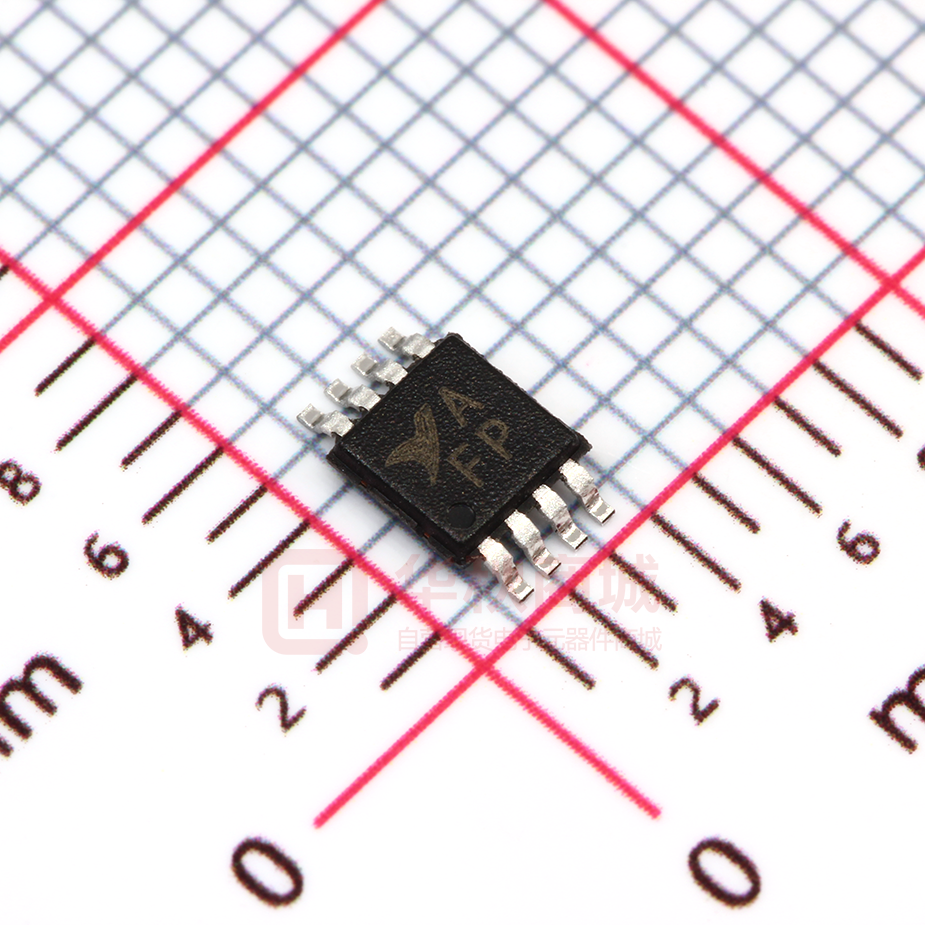

CBM8052AMS8
CBM8052AMS8
    COREBAI(芯佰微)
    MSOP8_3X3MM
    高速运算放大器 (>=50MHz) 2.5V~5.5V 250MHz
CBM8052AMS8 数据手册
CBM8051-CBM8052-CBM8054 OPERATION INSTRUCTION Features Description  Single-Supply Operation from 2.5V~+5.5V The CBM8051 / 1N (single), CBM8052  Rail-to-Rail Output /2N(dual), CBM8054 (quad) are rail-to-rail  -3dB Bandwidth(G=+1): 250MHz (Typ.) output voltage feedback amplifiers offering  Low Input Bias Current: 1pA (Typ.) ease of use and low cost. They have bandwidth  Quiescent Current: 2.8mA/Amplifier (Typ.) and slew rate typically found in current  Operating Temperature: -40°C ~ +125°C feedback amplifiers. All have a wide input  Small Package: common-mode voltage range and output • CBM8051 Available in SOT23-5 and SC70-5 Packages • CBM8052 Available in SOP-8 and MSOP-8 Packages • CBM8054 Available in SOP-14 and TSSOP-14 Packages • CBM8051N Available in SOT23-6 and SC70-6 Packages • CBM8052N Available in MSOP-10 Packages voltage swing, making them easy to use on single supplies as low as 2.5V. Despite being low cost, the CBM8051 series provide excellent overall performance. They offer wide bandwidth to 250MHz (G =+1) along with 0.1dB flatness out to 52MHz (G= +2) and offer a typical low power of 2.8mA/amplifier. The CBM8051 series is low distortion and fast settling make it ideal for buffering high speed A/D or D/A converters. The Application CBM8051/2N has a power-down disable  Imaging 50µA. These features make the CBM8051/2N  Photodiode Preamp ideal  DVD/CD applications where size and power are critical.  Filters All are specified over the extended -40 ℃ to  Professional Video and Cameras +125℃ temperature range. feature that reduces the supply current to for portable and battery-powered  Hand Sets  Base Stations  to-D Driver FOCUS ON DEVELOPMENT • SINCERELY SERVICE • INNOVATIVE FUTYRE www.corebai.com CBM8051-CBM8052-CBM8054 OPERATION INSTRUCTION CATALOG Features.............................................................................................................................................. Application ........................................................................................................................................ Description......................................................................................................................................... Pin Configurations ........................................................................................................................ ...1 Absolute Maximum Ratings ........................................................................................................... .2 Electrical Characteristics ................................................................................................................. 3 Electrical Performance Characteristics ............................................................................................ 5 Typical Characteristics.................................................................................................................... .7 Typical Performance Characteristics .............................................................................................. .8 Application Notes ....................................................................................................................... ...10 Typical Application Circuits .......................................................................................................... 12 Package Outline Dimensions....................................................................................................... ..14 MSOP-8 ................................................................................................................................. .14 TSSOP-14 .............................................................................................................................. .15 SOIC-8(SOP8)....................................................................................................................... .16 SOIC-14(SOP14)................................................................................................................... .17 SOT23-5 ................................................................................................................................ .18 SC70-5 ................................................................................................................................... .19 SOT23-6 ................................................................................................................................ .20 MSOP-10 ............................................................................................................................... .21 Package/Ordering Information .................................................................................................... ..22 FOCUS ON DEVELOPMENT • SINCERELY SERVICE • INNOVATIVE FUTYRE www.corebai.com CBM8051-CBM8052-CBM8054 OPERATION INSTRUCTION Pin Configurations OUT 1 VSS 2 IN+ 3 OUT 1 VDD IN- 6 VDD VSS 2 5 Disable IN+ 3 4 IN- SOT23-5/SC70-5 OUT A 1 IN A- 2 IN A+ 3 VSS Disable SOT23-6/SC70-6 10 VDD OUTA 1 8 VDD 9 OUT B 8 IN B- INA- 2 7 OUTB 4 7 IN B+ INA+ 3 6 INB- 5 6 Disable A B VSS 4 5 INB+ MSOP-10 SOP-8/MSOP-8 OUTA 1 14 OUTD INA- 2 13 IND- INA+ 3 12 IND+ VDD 4 11 VSS INB+ 5 10 INC+ INB- 6 9 INC- OUTB 7 8 OUTC SOP-14/TSSOP-14 Figure 1. Pin Assignment Diagram FOCUS ON DEVELOPMENT • SINCERELY SERVICE • INNOVATIVE FUTYRE - 1 - www.corebai.com CBM8051-CBM8052-CBM8054 OPERATION INSTRUCTION Absolute Maximum Ratings Condition Min Max Power Supply Voltage (VDD to VSS) -0.5V +7.5V Analog Input Voltage (IN+ or IN-) VSS-0.5V VDD+0.5V PDB Input Voltage VSS-0.5V +7V -45℃ +125℃ Operating Temperature Range Junction Temperature +160℃ Storage Temperature Range -55℃ Lead Temperature (soldering, 10sec) +150℃ +260℃ Package Thermal Resistance (TA=+25℃) SOP-8, θJA 125℃/W MSOP-8, θJA 216℃/W SOT23-5, θJA 190℃/W SOT23-6, θJA 190°C/W SC70-5, θJA 333°C/W ESD Susceptibility HBM 6KV MM 400V Note: Stress greater than those listed under Absolute Maximum Ratings may cause permanent damage to the device. This is a stress rating only and functional operation of the device at these or any other conditions outside those indicated in the operational sections of this specification are not implied. Exposure to absolute maximum rating conditions for extended periods may affect reliability. FOCUS ON DEVELOPMENT • SINCERELY SERVICE • INNOVATIVE FUTYRE - 2 - www.corebai.com CBM8051-CBM8052-CBM8054 OPERATION INSTRUCTION Electrical Characteristics (G= +2, RF=887Ω, RG=887Ω, and RL=150Ω connected to VS/2, unless otherwise noted. Typical values are at TA =+25°C.) CBM8051/CBM8052/CBM8054/CBM8051N/CBM8052N PARAMETER CONDITIONS TYP +25℃ MIN/MAX OVER TEMPERATURE +25℃ 0℃ to 70℃ -40℃ to 85℃ -40℃ to 125℃ UNITS MIN/MAX DYNAMIC PERFORMANCE G=+1,Vo=0.1Vp-,RF=24Ω,RL=150Ω 180 MHz TYP G=+1,Vo=0.1Vp-p,RF=24Ω,RL=1kΩ 250 MHz TYP G=+2,Vo=0.1Vp-p,RL=50Ω 55 MHz TYP G=+2,Vo=0.1Vp-p,RL=150Ω 93 MHz TYP G=+2,Vo=0.1Vp-p,RL=1kΩ 122 MHz TYP G=+2,Vo=0.1Vp-p,RL=10kΩ 130 MHz TYP G=+10,RL=150Ω 115 MHz TYP G=+10,RL=1kΩ 150 MHz TYP 52 MHz TYP G=+1,2VOutputStep 77/-151 V/μs TYP G=+2,2VOutputStep 88/-119 V/μs TYP G=+2,4VOutputStep 93/-131 V/μs TYP 3dB Small Signal Bandwidth Gain-Bandwidth Product Bandwidth for 0.1dB Flatness Slew Rate G=+2,Vo=0.1Vp-,RL=150Ω,RF=887Ω www.corebai.com FOCUS ON DEVELOPMENT • SINCERELY SERVICE • INNOVATIVE FUTYRE - 3 - CBM8051-CBM8052-CBM8054 OPERATION INSTRUCTION Rise-and-Fall Time G=+2,Vo=0.2Vp-p,10%to90% 4.5 ns TYP G=+2,Vo=2Vp-p,10%to90% 18 ns TYP Settling Time to 0.1% G=+2,2VOutputStep 50 ns TYP Overload Recovery Time VIN·G=+VS 18 ns TYP Input Voltage Noise f = 1MHz 4.9 nV/Hz TYP Differential Gain Error (NTSC) G = +2, RL = 150Ω 0.03 % TYP Differential Phase Error (NTSC) G = +2, RL = 1kΩ 0.08 degree TYP mV MAX NOISE/DISTORTION PERFORMANCE DC PERFORMANCE Input Offset Voltage (VOS) ±2 Input Offset Voltage Drift 2 μV/℃ TYP Input Bias Current (IB) 1 pA TYP Input offset Current (IOS) 2 pA TYP Open-Loop Gain (AOL) ±8 ±8.9 ±9.5 ±9.8 VO = 0.3V to 4.7V, RL = 150Ω 80 75 74 74 73 dB MIN VO = 0.2V to 4.8V, RL = 1kΩ 104 91 91 91 80 dB MIN V TYP dB MIN INPUT CHARACTERISTICS -0.2 to +3.8 Input Common-Mode Voltage Range (VCM) Common-Mode Rejection Ratio (CMRR) VCM = -0.1V to +3.5V 80 66 65 65 62 www.corebai.com FOCUS ON DEVELOPMENT • SINCERELY SERVICE • INNOVATIVE FUTYRE - 4 - CBM8051-CBM8052-CBM8054 OPERATION INSTRUCTION Electrical Performance Characteristics (G= +2, RF=887Ω, RG=887Ω, and RL=150Ω connected to VS/2, unless otherwise noted. Typical values are at TA =+25°C.) CBM8051/CBM8052/CBM8054/CBM8051N/CBM8052N PARAMETER CONDITIONS TYP +25℃ MIN/MAX OVER TEMPERATURE +25℃ 0℃ to 70℃ -40℃ to 85℃ -40℃ to 125℃ UNITS MIN/MAX OUTPUT CHARACTERISTICS Output Voltage Swing from Rail Output Current RL = 150Ω 0.12 V TYP RL = 1kΩ 0.03 V TYP f1kΩ), and 30mV of supply rail in moderate resistive loads (150Ω). Capacitive Load Tolerance The CBM805X family is optimized for bandwidth and speed, not for driving capacitive loads. Output capacitance will create a pole in the amplifier’s feedback path, leading to excessive peaking and potential oscillation. If dealing with load capacitance is a requirement of the application, the two strategies to consider are (1) using a small resistor in series with the amplifier’s output and the load capacitance and (2) reducing the bandwidth of the amplifier’s feedback loop by increasing the overall noise gain. Figure 2. shows a unity gain follower using the series resistor strategy. The resistor isolates the output from the capacitance and, more importantly, creates a zero in the feedback path that compensates for the pole created by the output capacitance. FOCUS ON DEVELOPMENT • SINCERELY SERVICE • INNOVATIVE FUTYRE - 10 - www.corebai.com CBM8051-CBM8052-CBM8054 OPERATION INSTRUCTION R I SO VI N V OUT cL Figure 2. Indirectly Driving a Capacitive Load Using Isolation Resistor The bigger the RISO resistor value, the more stable VOUT will be. However, if there is a resistive load RL in parallel with the capacitive load, a voltage divider (proportional to RISO/RL) is formed, this will result in a gain error. The circuit in Figure 3 is an improvement to the one in Figure 2. RF provides the DC accuracy by feed-forward the VIN to RL. CF and RISO serve to counteract the loss of phase margin by feeding the high frequency component of the output signal back to the amplifier’s inverting input, thereby preserving the phase margin in the overall feedback loop. Capacitive drive can be increased by increasing the value of CF. This in turn will slow down the pulse response. CF RF R ISO VI N CL VOUT RL Figure 3. Indirectly Driving a Capacitive Load with DC Accuracy FOCUS ON DEVELOPMENT • SINCERELY SERVICE • INNOVATIVE FUTYRE - 11 - www.corebai.com CBM8051-CBM8052-CBM8054 OPERATION INSTRUCTION Typical Application Circuits Differential amplifier The differential amplifier allows the subtraction of two input voltages or cancellation of a signal common the two inputs. It is useful as a computational amplifier in making a differential to single-end conversion or in rejecting a common mode signal. Figure 4. shown the differential amplifier using CBM805X. R2 R1 VOUT R3 R4 Figure 4. Differential Amplifier 𝑉𝑂𝑈𝑇 = ( 𝑅1 + 𝑅2 𝑅4 𝑅2 𝑅1 + 𝑅2 𝑅3 𝑉𝐼𝑡 + ( ) 𝑉𝐼𝑡 − ) 𝑉 𝑅3 + 𝑅4 𝑅1 𝑅1 𝑅3 + 𝑅4 𝑅1 𝑅𝑡ℎ If the resistor ratios are equal (i.e. R1=R3 and R2=R4), then 𝑉𝑂𝑈𝑇 = 𝑅2 (𝑉 − 𝑉𝐼𝑡 ) + 𝑉𝑅𝑡ℎ 𝑅1 𝐼𝑡 Low Pass Active Filter The low pass active filter is shown in Figure 5. The DC gain is defined by –R2/R1. The filter has a -20dB/decade roll-off after its corner frequency ƒC=1/(2πR3C1). C1 R2 R1 VOUT R3 Figure 5. Low Pass Active Filter FOCUS ON DEVELOPMENT • SINCERELY SERVICE • INNOVATIVE FUTYRE - 12 - www.corebai.com CBM8051-CBM8052-CBM8054 OPERATION INSTRUCTION Driving Video The CBM805x can be used in video applications like in Figure 6. RF RG 75ohm V IN 75ohm cable V OUT 75ohm Figure 6. Typical video driving FOCUS ON DEVELOPMENT • SINCERELY SERVICE • INNOVATIVE FUTYRE - 13 - www.corebai.com CBM8051-CBM8052-CBM8054 OPERATION INSTRUCTION Package Outline Dimensions MSOP-8 Symbol Dimensions In Millimeters Dimensions Inches Min Max Min Max A 0.820 1.100 0.032 0.043 A1 0.020 0.150 0.001 0.006 A2 0.750 0.950 0.030 0.037 b 0.250 0.380 0.010 0.015 c 0.090 0.230 0.004 0.009 D 2.900 3.100 0.114 0.122 E 2.900 3.100 0.114 0.122 E1 4.750 5.050 0.187 0.199 e 0.650 BSC 0.026 BSC L 0.400 0.800 0.016 0.031 θ 0° 6° 0° 6° FOCUS ON DEVELOPMENT • SINCERELY SERVICE • INNOVATIVE FUTYRE - 14 - www.corebai.com CBM8051-CBM8052-CBM8054 OPERATION INSTRUCTION TSSOP-14 Symbol Dimensions In Millimeters Min Max A Dimensions Inches Min Max 1.200 0.047 A1 0.050 0.150 0.002 0.006 A2 0.800 1.050 0.031 0.041 b 0.190 0.300 0.007 0.012 c 0.090 0.200 0.004 0.008 D 4.860 5.100 0.191 0.201 E 4.300 4.500 0.169 0.177 E1 6.250 6.550 0.246 0.258 e L 0.650 BSC 0.500 H θ 0.026 BSC 0.700 0.020 0.25 TYP 1° 0.028 0.01 TYP 7° 1° FOCUS ON DEVELOPMENT • SINCERELY SERVICE • INNOVATIVE FUTYRE - 15 - 7° www.corebai.com CBM8051-CBM8052-CBM8054 OPERATION INSTRUCTION SOIC-8(SOP8) Symbol Dimensions In Millimeters Dimensions Inches Min Max Min Max A 1.350 1.750 0.053 0.069 A1 0.100 0.250 0.004 0.010 A2 1.350 1.550 0.053 0.061 b 0.330 0.510 0.013 0.020 c 0.170 0.250 0.007 0.010 D 4.800 5.000 0.189 0.197 E 5.800 6.200 0.228 0.244 E1 3.800 4.000 0.150 0.157 e 1.270 BSC 0.050 BSC L 0.400 1.270 0.016 0.050 θ 0° 8° 0° 8° FOCUS ON DEVELOPMENT • SINCERELY SERVICE • INNOVATIVE FUTYRE - 16 - www.corebai.com CBM8051-CBM8052-CBM8054 OPERATION INSTRUCTION SOIC-14(SOP14) Symbol Dimensions In Millimeters Dimensions Inches Min Max Min Max A 1.350 1.750 0.053 0.069 A1 0.100 0.250 0.004 0.010 A2 1.350 1.550 0.053 0.061 b 0.310 0.510 0.012 0.020 c 0.100 0.250 0.004 0.010 D 8.450 8.850 0.333 0.348 E 5.800 6.200 0.228 0.244 E1 3.800 4.000 0.150 0.157 e 1.270 BSC 0.050 BSC L 0.400 1.270 0.016 0.050 R1 0° 8° 0° 8° FOCUS ON DEVELOPMENT • SINCERELY SERVICE • INNOVATIVE FUTYRE - 17 - www.corebai.com CBM8051-CBM8052-CBM8054 OPERATION INSTRUCTION SOT23-5 Symbol Dimensions In Millimeters Dimensions Inches Min Max Min Max A 1.050 1.250 0.041 0.049 A1 0.000 0.100 0.000 0.004 A2 1.050 1.150 0.041 0.045 b 0.300 0.500 0.012 0.020 c 0.100 0.200 0.004 0.008 D 2.820 3.020 0.111 0.119 E 1.500 1.700 0.059 0.067 E1 2.650 2.950 0.104 0.116 e 0.950 BSC 0.037 BSC e1 1.800 2.000 0.071 0.079 L 0.300 0.600 0.012 0.024 θ 0° 8° 0° 8° FOCUS ON DEVELOPMENT • SINCERELY SERVICE • INNOVATIVE FUTYRE - 18 - www.corebai.com CBM8051-CBM8052-CBM8054 OPERATION INSTRUCTION SC70-5 Symbol Dimensions In Millimeters Dimensions Inches Min Max Min Max A 0.900 1.100 0.035 0.043 A1 0.000 0.100 0.000 0.004 A2 0.900 1.000 0.035 0.039 b 0.150 0.350 0.006 0.014 C 0.080 0.150 0.003 0.006 D 2.000 2.200 0.079 0.087 E 1.150 1.350 0.045 0.053 E1 2.150 2.450 0.085 0.096 e e1 0.650 TYP 1.200 L 0.026TYP 1.400 0.047 0.525 REF 0.055 0.021 REF L1 0.260 0.460 0.010 θ 0° 8° 0° FOCUS ON DEVELOPMENT • SINCERELY SERVICE • INNOVATIVE FUTYRE - 19 - 0.018 8° www.corebai.com CBM8051-CBM8052-CBM8054 OPERATION INSTRUCTION SOT23-6 Symbol Dimensions In Millimeters Min Max Dimensions Inches Min Max A 1.050 1.250 0.041 0.049 A1 0.000 0.100 0.000 0.004 A2 1.050 1.150 0.041 0.045 b 0.300 0.500 0.012 0.020 C 0.100 0.200 0.004 0.008 D 2.820 3.020 0.111 0.119 E 1.500 1.700 0.059 0.067 E1 2.650 2.950 0.104 0.116 e e1 0.950 BSC 1.900 BSC L θ 0.037 BSC 0.075 BSC 0.300 0° 0.600 8° 0° FOCUS ON DEVELOPMENT • SINCERELY SERVICE • INNOVATIVE FUTYRE - 20 - 8° www.corebai.com CBM8051-CBM8052-CBM8054 OPERATION INSTRUCTION MSOP-10 Symbol Dimensions In Millimeters Dimensions Inches Min Max Min Max A 0.820 1.100 0.032 0.043 A1 0.020 0.150 0.001 0.006 A2 0.750 0.950 0.030 0.037 b 0.180 0.280 0.007 0.011 c 0.090 0.230 0.004 0.009 D 2.900 3.100 0.114 0.122 E 2.900 3.100 0.114 0.122 E1 4.750 5.050 0.187 0.199 e 0.50 BSC 0.020 BSC L 0.400 0.800 0.016 0.031 θ 0° 6° 0° 6° FOCUS ON DEVELOPMENT • SINCERELY SERVICE • INNOVATIVE FUTYRE - 21 - www.corebai.com CBM8051-CBM8052-CBM8054 OPERATION INSTRUCTION Package/Ordering Information MODEL CHANNEL CBM8051 Single CBM8052 Dual CBM8054 Quad CBM8051N Single With shutdown CBM8052N Dual With shutdown ORDER NUMBER PACKAGE DESCRIPTION PACKAGE OPTION MARKING INFORMATION CBM8051AC5 SC70-5 Tape and Reel,3000 H06 CBM8051AST5 SOT23-5 Tape and Reel,3000 H06 CBM8052AS8 SOP-8 Tape and Reel,4000 CBM8052 CBM8052AMS8 MSOP-8 Tape and Reel,3000 AFP CBM8054ATS14 TSSOP-14 Tape and Reel,3000 CBM8054 CBM8054AS14 SOP-14 Tape and Reel,2500 CBM8054 CBM8051NC6 SC70-6 Tape and Reel,3000 H06N CBM8051NST6 SOT23-6 Tape and Reel,3000 H06N CBM8052NMS10 MSOP-10 Tape and Reel,2500 CBM8052N FOCUS ON DEVELOPMENT • SINCERELY SERVICE • INNOVATIVE FUTYRE - 22 - www.corebai.com
