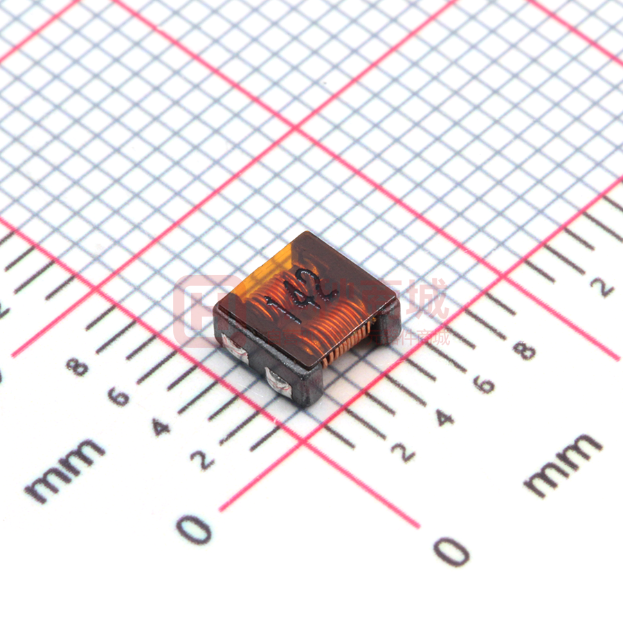

Wire Wound Common Mode Choke
-YLM4520 Series
■ Features
● SMD construction,and low profile.
● High Impedance and Excelletn Frequency Characteristic.
● Self Electromagnetic Shielding.
● Low Magnetic Flux Leakage.
