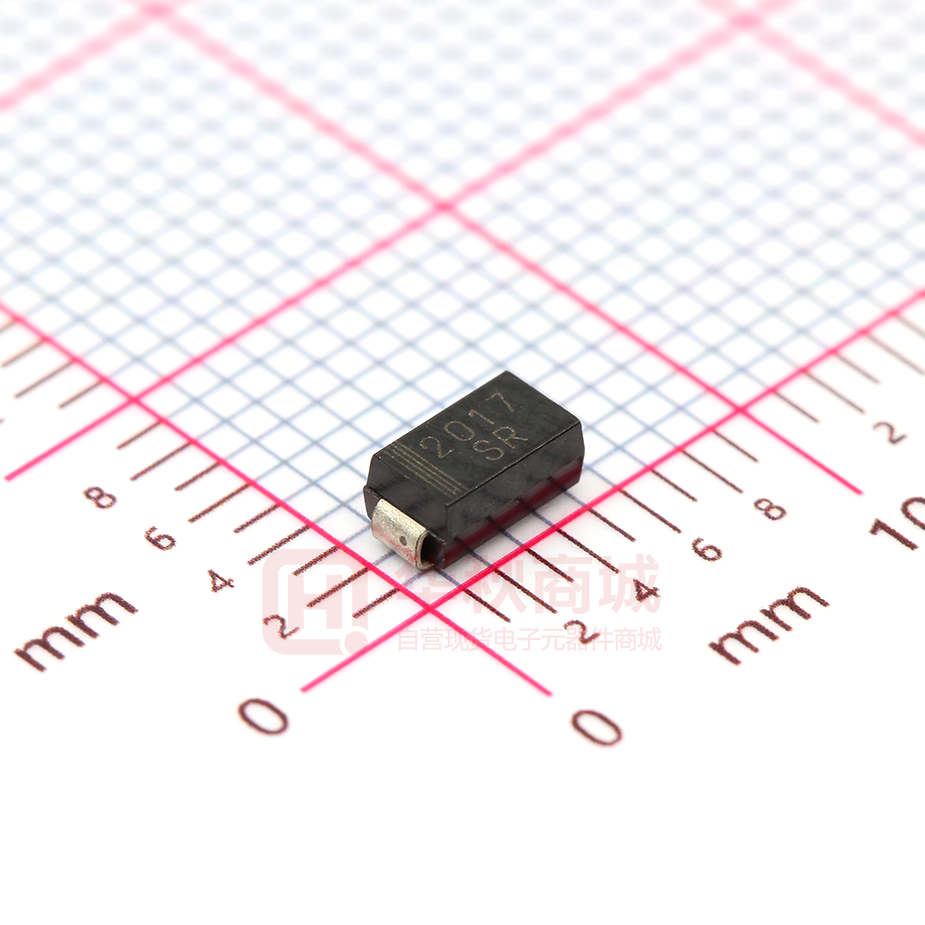

SMAJ5.0A-SMAJ170CA
SURFACE MOUNT TRANSIENT VOLTAGE SUPPRESSOR
FEATURES
SMA(DO-214AC)
Glass Passivated Die Construction
Uni- and Bi-Directional Versions Available
Excellent Clamping Capability
Fast Response Time
Plastic Case Material has UL Flammability
Classification Rating 94V-O
.062(1.60)
.055(1.40)
.114(2.90)
.098(2.50)
.181(4.60)
.157(4.00)
MECHANICAL DATA
.012(.305)
.006(.152)
Case : JEDEC SMA(DO-214AC), Transfer Molded Epoxy
Terminals : Solder Plated, Solderable
per MIL-STD-750, Method 2026
Polarity : Cathode Band Except Bi-Directional
.103(2.62)
.079(2.00)
.060(1.52)
.030(0.76)
.208(5.28)
.188(4.80)
.008(.203)
.002(.051)
Dimensions in inches and (millimeters)
