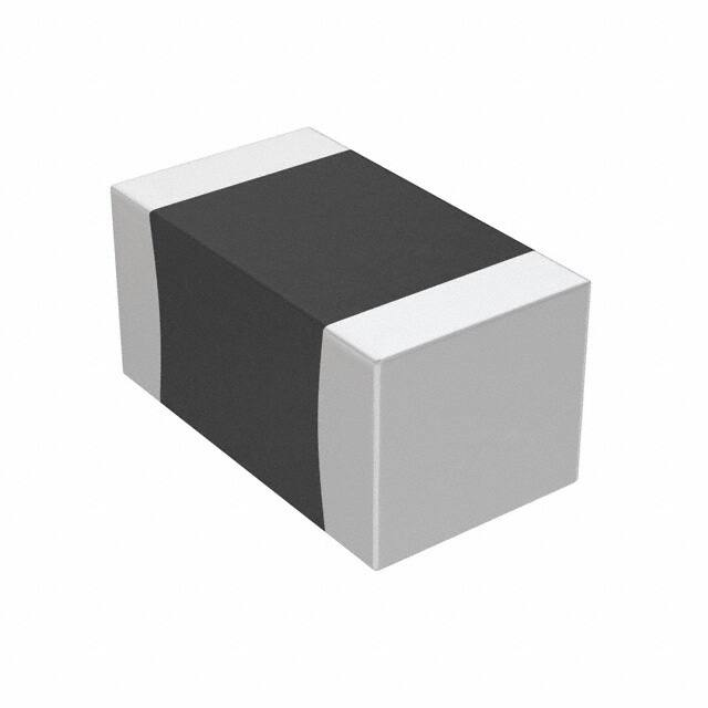

DATA SHEET SURFACE-MOUNT CERAMIC MULTILAYER CAPACITORS General Purpose & High Capacitance Class 2, X7R 6.3 V TO 50 V 100 pF to 22 µF Product Specification – June 16, 2017 V.18 RoHS compliant & Halogen Free Product specification Surface-Mount Ceramic Multilayer Capacitors General Purpose & High Cap. X7R 6.3 V to 50 V SCOPE ORDERING INFORMATION - GLOBAL PART NUMBER, PHYCOMP This specification describes X7R series chip capacitors with leadfree terminations. CTC & 12NC APPLICATIONS  PCs, Hard disk, Game PCs  DVDs, Video cameras  Mobile phones  Data processing FEATURES  Supplied in tape on reel  Nickel-barrier end termination  RoHS compliant  Halogen Free compliant 2 20 All part numbers are identified by the series, size, tolerance, TC material, packing style, voltage, process code, termination and capacitance value. YAGEO BRAND ordering code GLOBAL PART NUMBER (PREFERRED ) CC XXXX X X (1) X7R (2) (3) X BB XXX (4) (5) (1) SIZE – INCH BASED (METRIC) 0201 (0603) 0402 (1005) 0603 (1608) 0805 (2012) 1206 (3216) 1210 (3225) 1812 (4532) (2) TOLERANCE J = ± 5% (1) K = ± 10% M = ± 20% (3) PACKING STYLE R = Paper/PE taping reel; Reel 7 inch K = Blister taping reel; Reel 7 inch P = Paper/PE taping reel; Reel 13 inch F = Blister taping reel; Reel 13 inch (4) RATED VOLTAGE 5 = 6.3 V 6 = 10 V 7 = 16 V 8 = 25 V 9 = 50 V (5) CAPACITANCE VALUE 2 significant digits+number of zeros The 3rd digit signifies the multiplying factor, and letter R is decimal point Example: 103 = 10 x 103 = 10,000 pF = 10 nF NOTE 1. Tolerance ±5% is not available for full product range, please contact local sales force before ordering www.yageo.com June 16, 2017 V.18 Product specification Surface-Mount Ceramic Multilayer Capacitors General Purpose & High Cap. X7R 6.3 V to 50 V 3 20 CONSTRUCTION The capacitor consists of a rectangular block of ceramic dielectric in which a number of interleaved metal electrodes are contained. This structure gives rise to a high capacitance per unit volume. The inner electrodes are connected to the two end terminations and finally covered with a layer of plated tin (NiSn). The terminations are lead-free. A cross section of the structure is shown in Fig.1. Fig. 1 Surface mounted multilayer ceramic capacitor construction DIMENSION Table 1 For outlines see fig. 2 TYPE 0201 0402 0603 0805 1206 1210 1812 L1 (mm) W (mm) 0.6 ± 0.03 1.0 ± 0.05 1.6 ± 0.1 1.6 ± 0.15 1.6 ± 0.2 2.0 ± 0.1 2.0 ± 0.1 2.0 ± 0.2 3.2 ± 0.15 3.2 ± 0.2 3.2 ± 0.2 3.2 ± 0.3 3.2 ± 0.3 3.2 ± 0.2 3.2 ± 0.4 3.2 ± 0.4 3.2 ± 0.4 3.2 ± 0.4 3.2 ± 0.4 3.2 ± 0.4 3.2 ± 0.4 4.5 ± 0.2 4.5 ± 0.2 4.5 ± 0.4 0.3 ± 0.03 0.5 ± 0.05 0.8 ± 0.1 0.8 ± 0.15 0.8 ± 0.2 1.25 ± 0.1 1.25 ± 0.1 1.25 ± 0.2 1.6 ± 0.15 1.6 ± 0.2 1.6 ± 0.2 1.6 ± 0.2 1.6 ± 0.3 2.5 ± 0.2 2.5 ± 0.3 2.5 ± 0.3 2.5 ± 0.3 2.5 ± 0.3 2.5 ± 0.3 2.5 ± 0.3 2.5 ± 0.3 3.2 ± 0.2 3.2 ± 0.2 3.2 ± 0.4 T (MM) 0.3 ± 0.03 0.5 ± 0.05 0.8 ± 0.1 0.8 ± 0.15 0.8 ± 0.2 0.6 ± 0.1 0.85 ± 0.1 1.25 ± 0.2 0.85 ± 0.1 1.0 ± 0.1 1.15 ± 0.1 1.6 ± 0.2 1.6 ± 0.3 0.85 ± 0.1 1.15 ± 0.1 1.25 ± 0.2 1.6 ± 0.2 1.9 ± 0.2 2.0 ± 0.2 2.5 ± 0.2 2.5 ± 0.3 0.85 ± 0.1 1.15 ± 0.1 1.6 ± 0.2 L2 / L3 (mm) min. Max. L4 (mm) DIMENSION CODE min. 0.1 0.15 0.2 0.2 0.2 0.25 0.25 0.25 0.25 0.25 0.25 0.25 0.3 0.25 0.25 0.25 0.25 0.25 0.25 0.25 0.25 0.25 0.25 0.25 0.2 0.4 0.4 0.4 0.4 0.7 0.7 0.7 1.4 1.4 1.4 1.4 1.4 1.4 1.4 1.4 1.4 1.4 1.4 1.0 1.0 2.2 2.2 2.2 0.2 0.35 0.6 0.6 0.6 0.75 0.75 0.75 0.75 0.75 0.75 0.8 0.9 0.75 0.75 0.75 0.75 0.75 0.75 0.75 0.75 0.75 0.75 0.75 BA CA DA DB DC E0 EA EB F0 F1 FA FC FD OUTLINES For dimension see Table 1 Fig. 2 Surface mounted multilayer ceramic capacitor dimension G0 G1 GA G2 GB G3 GC GD JA JB JC www.yageo.com June 16, 2017 V.18 Product specification Surface-Mount Ceramic Multilayer Capacitors CAPACITANCE RANGE & THICKNESS FOR X7R Table 2 Sizes from 0201 to 0402 0201 CAP. General Purpose & High Cap. X7R 6.3 V to 50 V 4 20 0402 6.3 V 10 V 16 V 25 V 50 V 6.3 V 10 V 16 V 25 V 50 V 100 pF BA BA BA BA BA CA CA CA CA CA 150 pF BA BA BA BA BA CA CA CA CA CA 220 pF BA BA BA BA BA CA CA CA CA CA 330 pF BA BA BA BA BA CA CA CA CA CA 470 pF BA BA BA BA BA CA CA CA CA CA 680 pF BA BA BA BA BA CA CA CA CA CA 1.0 nF BA BA BA BA BA CA CA CA CA CA 1.5 nF BA BA BA BA CA CA CA CA CA 2.2 nF BA BA BA BA CA CA CA CA CA 3.3 nF BA BA BA BA CA CA CA CA CA 4.7 nF BA BA BA BA CA CA CA CA CA 6.8 nF BA BA BA BA CA CA CA CA CA 10 nF BA BA BA BA CA CA CA CA CA 15 nF CA CA CA CA CA 22 nF CA CA CA CA CA 33 nF CA CA CA CA CA 47 nF CA CA CA CA CA 68 nF CA CA CA CA CA CA CA CA CA CA CA CA CA 100 nF BA CA 150 nF 220 nF 330 nF 470 nF 680 nF 1.0 µF CA 2.2 µF 4.7 µF 10 µF 22 µF NOTE 1. Values in shaded cells indicate thickness class in mm 2. Capacitance value of non E-6 series is on request 3. For product with 5% tolerance, please contact local sales force before ordering www.yageo.com June 16, 2017 V.18 Product specification Surface-Mount Ceramic Multilayer Capacitors CAPACITANCE RANGE & THICKNESS FOR X7R Table 3 Sizes from 0603 to 0805 0603 CAP. General Purpose & High Cap. X7R 6.3 V to 50 V 5 20 0805 6.3 V 10 V 16 V 25 V 50 V 6.3 V 10 V 16 V 25 V 50 V 100 pF DA DA DA DA DA 150 pF DA DA DA DA DA 220 pF DA DA DA DA DA E0 E0 E0 E0 E0 330 pF DA DA DA DA DA E0 E0 E0 E0 E0 470 pF DA DA DA DA DA E0 E0 E0 E0 E0 680 pF DA DA DA DA DA E0 E0 E0 E0 E0 1.0 nF DA DA DA DA DA E0 E0 E0 E0 E0 1.5 nF DA DA DA DA DA E0 E0 E0 E0 E0 2.2 nF DA DA DA DA DA E0 E0 E0 E0 E0 3.3 nF DA DA DA DA DA E0 E0 E0 E0 E0 4.7 nF DA DA DA DA DA E0 E0 E0 E0 E0 6.8 nF DA DA DA DA DA E0 E0 E0 E0 E0 10 nF DA DA DA DA DA E0 E0 E0 E0 E0 15 nF DA DA DA DA DA E0 E0 E0 E0 E0 22 nF DA DA DA DA DA E0 E0 E0 E0 E0 33 nF DA DA DA DA DA EA EA EA EA EA 47 nF DA DA DA DA DA EA EA EA EA EA 68 nF DA DA DA DA DA EA EA EA EA EA 100 nF DA DA DA DA DA EA EA EA EA EA 150 nF DA DA DA DA DA EA EA EA EA EA 220 nF DA DA DA DA DA EA EA EA EA EB 330 nF DA DA DA DA EB EB EB EB EB 470 nF DA DA DA DA EB EB EB EB EB 680 nF DA DA DA DA EB EB EB EB EB 1.0 µF DA DA DA DA EB EB EB EB EB 2.2 µF DA DA DC EB EB EB EB EB 4.7 µF DC EB EB EB EB EB EB EB DA DB 10 µF 22 µF NOTE 1. Values in shaded cells indicate thickness class in mm 2. Capacitance value of non E-6 series is on request 3. For product with 5% tolerance, please contact local sales force before ordering www.yageo.com June 16, 2017 V.18 Product specification Surface-Mount Ceramic Multilayer Capacitors General Purpose & High Cap. X7R 6.3 V to 50 V 6 20 CAPACITANCE RANGE & THICKNESS FOR X7R Table 4 Size 1206 1206 CAP. 6.3 V 10 V 16 V 25 V 50 V 220 pF F0 F0 F0 F0 F0 330 pF F0 F0 F0 F0 F0 470 pF F0 F0 F0 F0 F0 680 pF F0 F0 F0 F0 F0 1.0 nF F0 F0 F0 F0 F0 1.5 nF F0 F0 F0 F0 F0 2.2 nF F0 F0 F0 F0 F0 3.3 nF F0 F0 F0 F0 F0 4.7 nF F0 F0 F0 F0 F0 6.8 nF F0 F0 F0 F0 F0 10 nF F0 F0 F0 F0 F0 15 nF F0 F0 F0 F0 F0 22 nF F0 F0 F0 F0 F0 33 nF F0 F0 F0 F0 F0 47 nF F0 F0 F0 F0 F0 68 nF F0 F0 F0 F0 F0 100 nF F0 F0 F0 F0 F0 150 nF F0 F0 F0 F0 FA 220 nF F0 F0 F0 F0 FA 330 nF F0 F0 F0 F0 F0 470 nF F0 F0 F0 F0 F1 680 nF FA FA FA FA FC 1.0 µF FA FA FA FA FC 2.2 µF FA FA FA FA FC 4.7 µF FC FC FC FC FC 10 µF FC FC FC FC 22 µF FC FC FD 100 pF 150 pF 47 µF NOTE 1. Values in shaded cells indicate thickness class in mm 2. Capacitance value of non E-6 series is on request 3. For product with 5% tolerance, please contact local sales force before ordering 4. Please contact local sales force for special ordering code before ordering www.yageo.com June 16, 2017 V.18 Product specification Surface-Mount Ceramic Multilayer Capacitors General Purpose & High Cap. X7R 6.3 V to 50 V 7 20 CAPACITANCE RANGE & THICKNESS FOR X7R Table 5 Sizes from 1210 to 1812 1210 CAP. 1812 6.3 V 10 V 16 V 25 V 50 V 50 V 2.2 nF G0 G0 G0 G0 G0 3.3 nF G0 G0 G0 G0 G0 4.7 nF G0 G0 G0 G0 G0 JA 6.8 nF G0 G0 G0 G0 G0 JA 10 nF G0 G0 G0 G0 G0 JA 15 nF G0 G0 G0 G0 G0 JA 22 nF G0 G0 G0 G0 G0 JA 33 nF G0 G0 G0 G0 G0 JA 47 nF G0 G0 G0 G0 G0 JA 68 nF G0 G0 G0 G0 G0 JA 100 nF G0 G0 G0 G0 G0 JB 150 nF G0 G0 G0 G0 G1 JB 220 nF G0 G0 G0 G0 G1 JB 330 nF G0 G0 G0 G0 G1 JB 470 nF G1 G1 G1 G1 GA JB 680 nF G1 G1 G1 G1 GA JC 1.0 µF GA GA GA GA GA JC 2.2 µF G3 G3 G3 G3 G3 4.7 µF GB GB GB GB GD 10 µF GB GB GB GB GD 22 µF GC GC GC GC 47 µF GC GC 100 pF 150 pF 220 pF 330 pF 470 pF 680 pF 1.0 nF 1.5 nF NOTE 1. Values in shaded cells indicate thickness class in mm 2. Capacitance value of non E-6 series is on request 3. For product with 5% tolerance, please contact local sales force before ordering 4. Please contact local sales force for special ordering code before ordering www.yageo.com June 16, 2017 V.18 Product specification Surface-Mount Ceramic Multilayer Capacitors General Purpose & High Cap. X7R 6.3 V to 50 V 8 20 THICKNESS CLASSES AND PACKING QUANTITY Table 6 SIZE CODE Ø 180 MM / 7 INCH Paper Blister Ø 330 MM / 13 INCH Paper Blister THICKNESS CLASSIFICATION TAPE WIDTH QUANTITY PER REEL 0201 0.3 ± 0.03 mm 8 mm 15,000 --- 50,000 --- --- 0402 0.5 ± 0.05 mm 8 mm 10,000 --- 50,000 --- 50,000 0603 0.8 ± 0.1 mm 8 mm 4,000 --- 15,000 --- 15,000 0.6 ± 0.1 mm 8 mm 4,000 --- 20,000 --- 10,000 0.85 ± 0.1 mm 8 mm 4,000 --- 15,000 --- 8,000 1.25 ± 0.2 mm 8 mm --- 3,000 --- 10,000 5,000 0.6 ± 0.1 mm 8 mm 4,000 --- 20,000 --- --- 0.85 ± 0.1 mm 8 mm 4,000 --- 15,000 --- --- 1.00 / 1.15 ± 0.1 mm 8 mm --- 3,000 --- 10,000 --- 1.25 ± 0.2 mm 8 mm --- 3,000 --- 10,000 --- 1.6 ± 0.15 mm 8 mm --- 2,500 --- 10,000 --- 1.6 ± 0.2 mm 8 mm --- 2,000 --- 8,000 --- 0.6 / 0.7 ± 0.1 mm 8 mm --- 4,000 --- 15,000 --- 0.85 ± 0.1 mm 8 mm --- 4,000 --- 10,000 --- 1.15 ± 0.1 mm 8 mm --- 3,000 --- 10,000 --- 1.15 ± 0.15 mm 8 mm --- 3,000 --- 10,000 --- 1.25 ± 0.2 mm 8 mm --- 3,000 --- --- --- 1.5 ± 0.1 mm 8 mm --- 2,000 --- --- --- 1.6 / 1.9 ± 0.2 mm 8 mm --- 2,000 --- --- --- --- --- --- 0805 1206 1210 QUANTITY PER BULK CASE 2.0 ± 0.2 mm 8 mm --- 2,000 1,000 2.5 ± 0.2 mm 8 mm --- 1,000 500 --- --- --- 1.15 ± 0.15 mm 12 mm --- 3,000 --- --- --- 1.25 ± 0.2 mm 12 mm --- 3,000 --- --- --- 1.35 ± 0.15 mm 12 mm --- 2,000 --- --- --- 1.5 ± 0.1 mm 12 mm --- 2,000 --- --- --- 1.6 ± 0.2 mm 12 mm --- 2,000 --- 8,000 --- 2.0 ± 0.2 mm 12 mm --- 2,000 --- --- --- 0.6 / 0.85 ± 0.1 mm 12 mm --- 2,000 --- --- --- 1.15 ± 0.1 mm 12 mm --- 1,000 --- --- --- 1.25 ± 0.2 mm 12 mm --- 1,000 --- --- --- 1.5 ± 0.1 mm 12 mm --- 1,000 --- --- --- 1.6 ± 0.2 mm 12 mm --- 1,000 --- --- --- 2.0 ± 0.2 mm 12 mm --- 1,000 --- --- --- 2.5 ± 0.2 mm 12 mm --- 500 --- --- --- 1808 1812 www.yageo.com June 16, 2017 V.18 Product specification Surface-Mount Ceramic Multilayer Capacitors General Purpose & High Cap. 9 20 6.3 V to 50 V X7R ELECTRICAL CHARACTERISTICS X7R DIELECTRIC CAPACITORS; NISN TERMINATIONS Unless otherwise specified, all test and measurements shall be made under standard atmospheric conditions for testing as given in 5.3 of IEC 60068-1: - Temperature: 15 °C to 35 °C Relative humidity: 25% to 75% Air pressure: 86 kPa to 106 kPa Before the measurements are made, the capacitor shall be stored at the measuring temperature for a time sufficient to allow the entire capacitor to reach this temperature. The period as prescribed for recovery at the end of a test is normally sufficient for this purpose. Table 7 VALUE DESCRIPTION Capacitance range 100 pF to 47 µF Capacitance tolerance ± 5%, ± 10%, ± 20% Dissipation factor (D.F.) X7R 0201 ≤10V 0402 100pF to 10nF 100pF to 100nF 100nF 220nF to 470nF 0603 1206 1210 100pF to 1µF 150pF to 2.2µF 220pF to 2.2µF 2.2nF to 2.2µF ≤5% 4.7µF to 47µF ≤10% 2.2µF to 4.7µF 0805 4.7µF to 10µF 4.7µF to 22µF 1µF 16V ≤12.5% 100pF to 1.2nF 100pF to 22nF 100pF to 220nF 150pF to 470nF 220pF to 1µF 2.2nF to 1µF ≤ 3.5% 1.5nF to 10nF 27nF to 100nF 470nF to 1.0µF 680 nF to 2.2µF 2.2µF 2.2µF ≤ 5% 220nF 25V 4.7µF to 22µF 4.7µF to 22µF ≤10% 100pF to 470pF 100pF to 10nF 100pF to 39nF 150pF to 180nF 220pF to 680nF 2.2µF 2.2nF to 1µF ≤ 2.5% 12 nF to 47nF 47nF to 220nF 220nF to 470nF 1µF 560pF to 10nF 56nF to 100nF 680nF to 1µF 2.2µF 2.2µF ≤ 5% 2.2µF to 4.7µF 4.7µF to 22µF 4.7µF to 22µF ≤10% 100pF to 10nF 100pF to 39nF 150pF to 180nF 220pF to 470nF 2.2nF to 1µF 12 nF to 47nF 47nF to 220nF 220nF to 470nF 270nF to 1µF 50V 100pF to 1nF 4.7µF to 10µF ≤ 3.5% 680nF to 1µF 680nF 100nF 470nF to 1µF ≤ 5% 2.2µF to 10µF ≤10% Rins ≥ 10 GΩ or Rins × Cr ≥ 500/100/50* seconds whichever is less Insulation resistance after 1 minute at Ur (DC) 1µF to 2.2µF ≤2.5% ≤ 3.5% 2.2µF to 4.7µF Maximum capacitance change as a function of temperature (temperature characteristic/coefficient): Operating temperature range: ± 15% –55 °C to +125 °C NOTE * Rins ≥ 10 GΩ or Rins × Cr ≥ 500Ω.F: * Rins × Cr ≥ 100Ω.F: * Rins × Cr ≥ 50Ω.F: 0201 : 100pF to 10nF 0201 : 100nF/6.3V 0402 : 1uF/6.3V 0402 : 100pF to 220nF 0402 : 470nF/6.3V to 10V 0603 : 4.7uF/6.3V 0603 : 100pF to 1uF 0603 : 2.2uF/6.3V to 16V 0805 : 220pF to 1uF, 2.2uF/6.3V to 16V 0805 : 2.2uF/25V to 50V, 4.7uF/6.3V to 25V 1206/1210 : 220pF to 1uF, 2.2uF/6.3V to 25V, 4.7uF/6.3V to 16V 1812 : 4.7nF to 1uF 10uF/6.3V to 16V 1206 : 2.2uF/50V, 4.7uF/25V to 50V, 10uF/6.3V to 25V, 22uF/6.3V to 16V 1210 : 2.2uF/50V, 4.7uF/25V to 50V, 10uF/6.3V to 50V, 22uF/6.3V to 16V, 47uF/6.3V to 10V www.yageo.com June 16, 2017 V.18 Product specification Surface-Mount Ceramic Multilayer Capacitors General Purpose & High Cap. X7R 6.3 V to 50 V 10 20  Fig. 3 Typical capacitance change as a function of temperature www.yageo.com June 16, 2017 V.18 Product specification Surface-Mount Ceramic Multilayer Capacitors General Purpose & High Cap. X7R 6.3 V to 50 V 11 20 Size 0201 10 nF / 16 V Solid lines: Impedance / Dotted lines: ESR Fig. 4 Impedance ESR vs. frequency characteristics for multilayer chip capacitors Size 0402 100 nF / 16 V Solid lines: Impedance / Dotted lines: ESR Fig. 5 Impedance ESR vs. frequency characteristics for multilayer chip capacitors www.yageo.com June 16, 2017 V.18 Product specification Surface-Mount Ceramic Multilayer Capacitors General Purpose & High Cap. X7R 6.3 V to 50 V 12 20 Size 0603 1 µF / 16 V Solid lines: Impedance / Dotted lines: ESR Fig. 6 Impedance ESR vs. frequency characteristics for multilayer chip capacitors Size 0805 1 µF / 16 V Solid lines: Impedance / Dotted lines: ESR Fig. 7 Impedance ESR vs. frequency characteristics for multilayer chip capacitors www.yageo.com June 16, 2017 V.18 Product specification Surface-Mount Ceramic Multilayer Capacitors General Purpose & High Cap. X7R 6.3 V to 50 V 13 20 Size 1206 1 µF / 25 V Solid lines: Impedance / Dotted lines: ESR Fig. 8 Impedance ESR vs. frequency characteristics for multilayer chip capacitors Size 1206 10 µF / 10 V Solid lines: Impedance / Dotted lines: ESR Fig. 9 Impedance ESR vs. frequency characteristics for multilayer chip capacitors www.yageo.com June 16, 2017 V.18 Product specification Surface-Mount Ceramic Multilayer Capacitors SOLDERING RECOMMENDATION Table 8 SIZE SOLDERING 0201 METHOD Reflow Reflow only General Purpose & High Cap. X7R 6.3 V to 50 V 14 20 0402 0603 0805 1206 ≥ 1210 > 100 nF > 1 µF > 2.2 µF > 4.7 µF Reflow only ≤ 100 nF ≤ 1 µF ≤ 2.2 µF ≤ 4.7 µF --- Reflow/Wave TESTS AND REQUIREMENTS Table 9 Test procedures and requirements TEST TEST METHOD PROCEDURE REQUIREMENTS Mounting IEC 6038421/22 4.3 The capacitors may be mounted on printed-circuit boards or ceramic substrates No visible damage Visual Inspection and Dimension Check 4.4 Any applicable method using × 10 magnification In accordance with specification Capacitance (1) 4.5.1 Class 2: Within specified tolerance Dissipation Factor (D.F.) (1) 4.5.2 At 20 °C, 24 hrs after annealing Cap ≤ 1 µF, f = 1 KHz, measuring at voltage 1 Vrms at 20 °C Cap > 1 µF, f = 1 KHz for C ≤ 10 µF, rated voltage > 6.3 V, measuring at voltage 1 Vrms at 20 °C f = 1 KHz, for C ≤ 10 µF, rated voltage ≤ 6.3 V, measuring at voltage 0.5 Vrms at 20 °C f = 120 Hz for C > 10 µF, measuring at voltage 0.5 Vrms at 20 °C Insulation Resistance 4.5.3 At Ur (DC) for 1 minute In accordance with specification NOTE: 1. For individual product specification, please contact local sales. www.yageo.com June 16, 2017 V.18 Product specification Surface-Mount Ceramic Multilayer Capacitors General Purpose & High Cap. X7R 6.3 V to 50 V TEST TEST METHOD PROCEDURE REQUIREMENTS Temperature Characteristic IEC 6038421/22 Capacitance shall be measured by the steps shown in the following table. Class1: ∆ C/C: ± 30ppm 4.6 The capacitance change should be measured after 5 min at each specified temperature stage. Step Temperature(℃) a 25± 2 b Lower temperature± 3℃ c 25± 2 d Upper Temperature± 2℃ e 25± 2 15 20 Class2: X7R: ∆ C/C: ±15% Y5V: ∆ C/C: 22~-82% Class2: X7R/X5R: ∆ C/C: ±15% Y5V: ∆ C/C: 22~-82% (1) Class I Temperature Coefficient shall be calculated from the formula as below C2 - C1 106 [ppm/℃] Temp, Coefficient = C1 xΔT C1: Capacitance at step c C2: Capacitance at 125℃ ∆T: 100℃(=125℃-25℃) (2) Class II Capacitance Change shall be calculated from the formula as below C2 - C1 ∆C = x 100% C1 C1: Capacitance at step c C2: Capacitance at step b or d Adhesion 4.7 A force applied for 10 seconds to the line joining the terminations and in a plane parallel to the substrate Force size ≥ 0603: 5N size = 0402: 2.5N size = 0201: 1N www.yageo.com June 16, 2017 V.18 Product specification Surface-Mount Ceramic Multilayer Capacitors TEST Bond Strength General Purpose & High Cap. TEST METHOD PROCEDURE 4.8 6.3 V to 50 V X7R 16 20 REQUIREMENTS Mounting in accordance with IEC 60384-22 paragraph 4.3 No visible damage Conditions: bending 1 mm at a rate of 1 mm/s, radius jig 5 mm ∆C/C Class2: X7R: ± 10% Test Substrate: b X7R: ± 12.5% 4.5 C YNSC147 40 a 100 unit:mm Resistance to Soldering Heat 4.9 Precondition: 150 +0/–10 °C for 1 hour, then keep for 24 ± 1 hours at room temperature Preheating: for size ≤ 1206: 120 °C to 150 °C for 1 minute Dimension(mm) Type a b c 0201 0.3 0.9 0.3 0402 0.4 1.5 0.5 0603 1.0 3.0 1.2 0805 1.2 4.0 1.65 1206 2.2 5.0 1.65 1210 2.2 5.0 2.0 1808 3.5 7.0 3.7 Dissolution of the end face plating shall not exceed 25% of the length of the edge concerned Preheating: for size >1206: 100 °C to 120 °C for 1 minute and 170 °C to 200 °C for 1 minute ∆C/C Solder bath temperature: 260 ± 5 °C Class2: X7R: ± 10% Dipping time: 10 ± 0.5 seconds Recovery time: 24 ± 2 hours D.F. within initial specified value Rins within initial specified value www.yageo.com June 16, 2017 V.18 Product specification Surface-Mount Ceramic Multilayer Capacitors TEST TEST METHOD PROCEDURE Solderability IEC 60384- 4.10 21/22 General Purpose & High Cap. X7R 6.3 V to 50 V 17 20 REQUIREMENTS Preheated to a temperature of 80 °C to 140 °C and The solder should cover over 95% of the critical area of each termination maintained for 30 seconds to 60 seconds. 1. Temperature: 235± 5°C / Dipping time: 2 ± 0.5 s 2. Temperature: 245± 5°C / Dipping time: 3 ± 0.5 s (lead free) Depth of immersion: 10mm Rapid Change of Temperature 4.11 Preconditioning; 150 +0/–10 °C for 1 hour, then keep for 24 ± 1 hours at room temperature No visual damage ∆C/C 5 cycles with following detail: 30 minutes at lower category temperature 30 minutes at upper category temperature Class2: X7R: ± 15% Recovery time 24 ± 2 hours D.F. meet initial specified value Rins meet initial specified value www.yageo.com June 16, 2017 V.18 Product specification Surface-Mount Ceramic Multilayer Capacitors TEST Damp Heat with Ur Load General Purpose & High Cap. X7R 6.3 V to 50 V TEST METHOD PROCEDURE REQUIREMENTS IEC 6038421/22 1. Preconditioning, class 2 only: 150 +0/-10 °C /1 hour, then keep for 24 ± 1 hour at room temp No visual damage after recovery 2. Initial measure: Spec: refer to initial spec C, D, IR ∆C/C 4.13 3. Damp heat test: 500 ± 12 hours at 40 ± 2 °C; 90 to 95% R.H. 1.0 Ur applied 20 Class2: X7R: ± 15% D.F. 4. Recovery: Class 2: 24 ± 2 hours Class2: X7R: ≤ 16V: ≤ 7% ≥ 25V: ≤ 5% 5. Final measure: C, D, IR Rins P.S. If the capacitance value is less than the minimum value permitted, then after the other measurements have been made the capacitor shall be preconditioned according to “IEC 60384 4.1” and then the requirement shall be met. 18 Class2: X7R: ≥ 500 MΩ or Rins x Cr ≥ 25s whichever is less ∆C/C Class2: X7R: ± 20% D.F. Class2: X7R: 2 x initial value max Rins Class2: X7R: 500 MΩ or Rins x Cr ≥ 5s whichever is less www.yageo.com June 16, 2017 V.18 Product specification Surface-Mount Ceramic Multilayer Capacitors TEST Endurance General Purpose & High Cap. TEST METHOD PROCEDURE REQUIREMENTS IEC 6038421/22 1. Preconditioning, class 2 only: 150 +0/-10 °C /1 hour, then keep for 24 ± 1 hour at room temp No visual damage 2. Initial measure: Spec: refer to initial spec C, D, IR ∆C/C 4.14 3. Endurance test: Temperature: X7R: 125 °C Specified stress voltage applied for 1,000 hours: Applied 2.0 x Ur for general products* Applied 1.5 x Ur for high cap. Products* 4. Recovery time: 24 ± 2 hours 5. Final measure: C, D, IR P.S. If the capacitance value is less than the minimum value permitted, then after the other measurements have been made the capacitor shall be preconditioned according to “IEC 60384 4.1” and then the requirement shall be met. * General product (Applied 2.0 x Ur): 0201 ≤ 10nF 0402 ≤ 100nF 0603 ≤ 470nF 0805, 1206, 1210 ≤ 1uF; Voltage Proof X7R IEC 603841 4.6 6.3 V to 50 V 19 20 Class2: X7R: ± 15% D.F. Class2: X7R: ≤ 16V: ≤ 7% ≥ 25V: ≤ 5% Rins Class2: X7R: ≥ 1,000 MΩ or Rins x Cr ≥ 50s whichever is less ∆C/C Class 2: X7R: ± 20% D.F. Class 2: X7R: 2 x initial value max Rins * High cap product (Applied 1.5 x Ur): 0201 > 10nF 0402 > 100nF 0603 > 470nF 0805, 1206, 1210 > 1uF; Class 2: X7R: 1,000 MΩ or Rins x Cr ≥ 10s whichever is less Specified stress voltage applied for 1~5 seconds No breakdown or flashover Ur ≤ 100 V: series applied 2.5 Ur Charge/Discharge current is less than 50 mA www.yageo.com June 16, 2017 V.18 Product specification Surface-Mount Ceramic Multilayer Capacitors General Purpose & High Cap. X7R 6.3 V to 50 V 20 20 REVISION HISTORY REVISION DATE CHANGE NOTIFICATION DESCRIPTION Version 18 May. 11th, 2017 - Add 1210/10uF/50V Version 17 Mar. 7th, 2017 - - 0805 L4 spec updated - Dimension updated Version 16 Dec. 7th, 2016 - - Dimension updated Version 15 Oct. 3rd, 2016 - - Dimension updated, Soldering recommendation updated Version 14 May 31st, 2016 - - Dimension updated Version 13 Dec. 30, 2015 - - Dimension on 0603 and 1206 case size updated Version 12 May 26, 2015 - - 1210, 25V dissipation factor updated Version 11 Jan. 06, 2015 - - 0402, 100nF, 50V Dissipation factor (D.F.) updated. Version 10 Jul. 08, 2014 - - Dimension updated Version 9 Aug. 19, 2013 - - Dimension updated Version 8 Oct. 13, 2011 - - Dimension updated Version 7 Jan. 13, 2011 - - Dimension updated Version 6 Oct. 13, 2010 - - Rated voltage of 0201 extend to 50 V - 50V Dissipation factor(D.F) updated - Capacitance range of 0201 X7R 6.3V to 16V extend to 100 pF - Capacitance range of 0805 X7R 10V extend to 10 µF - Capacitance range of 0805 X7R 50V extend to 1 µF - Capacitance range of 1210 X7R 10V extend to 22 µF - Figures of impedance ESR updated Version 5 Jul 27, 2010 - - Dimension on 0603 and 1206 case size updated - 16V to 25V Dissipation factor(D.F) updated Version 4 Apr 21, 2010 - - The statement of "Halogen Free" on the cover added - Dimension updated Version 3 Oct 26, 2009 - - Capacitance range of 0402 X7R 25 V extend to 100 nF - 16V Dissipation factor updated Version 2 May 11, 2009 - - Product range updated Version 1 Apr 24, 2009 - - Ordering code updated Version 0 Apr 15, 2009 - - New datasheet for general purpose and high capacitance X7R series with RoHS compliant - Replace the "6.3V to 50V" part of pdf files: X7R_10V_9, X7R_16V-to100V_9, X7R_16-to-500V_9, UP-X5R_X7R_HighCaps_6.3-to-25V_11, UY-X5R_X7R_HighCaps_6.3-to-25V_11 - Combine 0201 from pdf files: UP-NP0X5RX7RY5V_0201_6.3-to-50V_2 and UY-NPOX5RX7RY5V_0201_6.3-to-50V_2 - Define global part number - Description of "Halogen Free compliant" added - Test method and procedure updated www.yageo.com June 16, 2017 V.18
CC0603KPX7R9BB223
物料型号: - 该文档描述的是多层陶瓷电容器,属于YAGEO Phicomp的产品,具体型号包括0201、0402、0603、0805、1206、1210和1812等。
器件简介: - 这些电容器是用于一般用途和高电容的表面贴装陶瓷多层电容器,具有X7R的特性,电压等级从6.3V至50V,电容值从100pF至22uF。
引脚分配: - 文档中没有明确提到引脚分配,但电容器通常有两个端子,用于连接电路。
参数特性: - 电容值范围:100pF至22uF。 - 电压等级:6.3V、10V、16V、25V和50V。 - 容差:±5%、±10%和±20%。 - 封装类型:包括0603、1206、1210和1812等。 - 符合RoHS和无卤素标准。
功能详解: - 电容器由陶瓷介质材料制成,内部有多个交错的金属电极,提供高单位体积的电容。 - 内部电极连接到两端的端子,最终覆盖一层镀锡(NiSn),端子为无铅。
应用信息: - 应用领域包括个人电脑、硬盘、游戏电脑、DVD播放器、摄像机、移动电话和数据处理等。
封装信息: - 提供了不同尺寸的封装信息,包括长、宽、高以及相关的尺寸代码。
电气特性: - 包括电容范围、容差、DF(耗散因子)、绝缘电阻和温度特性等。
测试和要求: - 包括视觉检查、尺寸检查、电容和DF测量、绝缘电阻、温度特性、粘合力、耐焊接热、焊接性和快速温度变化等测试。
