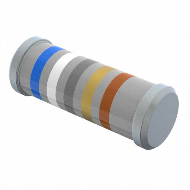

    贴片电阻 MELF_D2.2X5.9MM_SM 54.9Ω ±1% 1W ±50ppm/℃
MMP100FRE54R9 数据手册
Through-hole resistors Melf Metal Film Resistors High Power Type Ultra Miniature Style [ MMP Series ] FEATURES Power Rating 1W, 2W Resistance Tolerance ±1%, ±2%, ±5% T.C.R. ±50ppm/°C, ±100ppm/°C DERATING CURVE For resistors operated in ambient temperatures above 70°C, power rating must be derated in accordance with the curve below. INTRODUCTION The MMP Series Melf Metal Film High Power Resistors are manufactured using a vacuum sputtering system to deposit multiple layers of mixed metal alloys and passivative materials onto a carefully treated high grade ceramic substrate. SMD enabled structure and high power in small packages. Rated Load (%) 70 155 °C 100 80 60 40 20 20 40 60 80 100 120 140 160 DIMENSIONS Ambient Temperature (°C) Unit: mm D C L STYLE DIMENSION Ultra Miniature L D C Min. MMP100 5.9±0.2 2.2±0.1 0.5 MMP200 8.5±0.2 3.2±0.2 0.5 23 Note: ELECTRICAL CHARACTERISTICS STYLE MMP100 MMP200 Power Rating at 70°C 1W 2W Maximum Working Voltage 350V Maximum Overload Voltage 700V Voltage Proof on Insulation 500V Resistance Range 1Ω - 1MΩ & 0Ω for E24 & E96 series value Operating Temp. Range -55°C to +155°C Temperature Coefficient ±50ppm/°C, ±100ppm/°C Note: Special value is available on request ENVIRONMENTAL CHARACTERISTICS PERFORMANCE TEST TEST METHOD APPRAISE Short Time Overload IEC 60115-1 4.13 2.5 times RCWV for 5 sec. (Not more than maximum Overload Voltage) ±0.5%+0.05Ω Voltage Proof on Insulation IEC 60115-1 4.7 In V-Block for 60 sec., test voltage as above table No Breakdown Temperature Coefficient IEC 60115-1 4.8 Between -55°C to +155°C By type Insulation Resistance IEC 60115-1 4.6 in V-block for 60 Sec. >10,000MΩ Solderability IEC 60115-1 4.17 245±5°C for 3±0.5 Sec. 95% Min. coverage Solvent Resistance of Marking IEC 60115-1 4.30 IPA for 5±0.5 Min. with ultrasonic No deterioration of coatings and markings Periodic-pulse Overload IEC 60115-1 4.39 4 times RCWV 10,000 cycles (1 Sec. on, 25 Sec. off) ±1.0%+0.05Ω Damp Heat Steady State IEC 60115-1 4.24 40±2°C, 90-95% RH for 56 days, loaded with 0.1 times RCWV ±2.0%+0.1Ω Endurance at 70°C IEC 60115-1 4.25 70±2°C at RCWV (or Umax., Whichever less) for 1,000 Hr. (1.5Hr.on, 0.5Hr. Off) ±2.0%+0.1Ω Temperature Cycling IEC 60115-1 4.19 -55°C  Room Temp.  +155°C  Room Temp. (5 cycles) ±0.75%+0.05Ω Resistance to Soldering Heat IEC 60115-1 4.18 260±3°C for 10±1 Sec., immersed to a point 3±0.5mm from the body ±0.5%+0.05Ω Note: RCWV(Rated Continuous Working Voltage) = Power Rating x Resistance Value or Max. working voltage listed above, whichever less. Revision: 2020 Mouser Electronics Authorized Distributor Click to View Pricing, Inventory, Delivery & Lifecycle Information: Yageo: MMP100FRE1K2 MMP100FRE120R MMP100FRE100R MMP100FRE160R MMP100FRE11K MMP100FRE100K MMP100FRE180R MMP100FRE143R MMP100FRE12K MMP100FRE150R MMP100FRE124R MMP100FRE110R MMP100FRE154R MMP100FRE1R MMP100FRE270RSJ MMP100FRE3R3 MMP100FRE4R7 MMP100FRE2R2 MMP100FRE100KSJ MMP100FRE2R7 MMP100FRE150KSJ MMP100FRE1K5SJ MMP100FRE2R21 MMP100FRE3R9 MMP100FRE1R5 MMP100FRE51KSJ MMP100FRE6R8 MMP100FRE1R3 MMP100FRE220RSJ MMP100FRE5K6SJ MMP100FRE5R1 MMP100FRE5R6 MMP100FRE1K2SJ MMP100-R-0R MMP100FRE2R MMP100FRE3R MMP100FRE9R1 MMP100FRE1R6 MMP100FRE10KSJ MMP100FRE2R49 MMP100FRE0R MMP100FRE120RSJ MMP100FRE2R43 MMP100FRE36KSJ MMP100FRE86R6 MMP100FRE270K MMP100FRE56K MMP100FRE62R MMP100FRE750K MMP100FRF750K MMP100FRE221R MMP100FRE226R MMP100FRE5K1 MMP100FRE75R MMP100FRE7K5 MMP100FRE220R MMP100FRE3K09 MMP100FRE470K MMP100FRE95R3 MMP100FRE237R MMP100FRE75K MMP100FRE24K3 MMP100FRE36K MMP100FRE51K MMP100FRE73R2 MMP100FRF1K1 MMP100FRF1K5 MMP100FRE2K MMP100FRE47K MMP100FRF1M MMP100FRF2K2 MMP100FRF909K MMP100FRE270R MMP100FRE56R MMP100FRF47K MMP100FRE5K6 MMP100FRE22K MMP100FRE280R MMP100FRE510K MMP100FRE59R MMP100FRE820K MMP100FRE93R1 MMP100FRE20K MMP100FRE240R MMP100FRE243R MMP100FRE330R MMP100FRE3K6 MMP100FRE76R8 MMP100FRE80R6 MMP100FRF22K MMP100FRE200K MMP100FRE249R MMP100FRE4K02 MMP100FRE64R9 MMP100FRE82R
