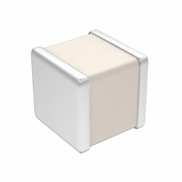

RF/Microwave Capacitors RF/Microwave Multilayer Capacitors (MLC) 100A Series Porcelain Superchip® Multilayer Capacitors FEATURES • • • • • • • • • GENERAL DESCRIPTION Case A Size (.055” x .055”) Lowest ESR/ESL High Q Low Noise Capacitance Range 0.1 pF to 100 pF Extended WVDC up to 250 VDC Ultra-Stable Performance High Self-Resonance Established Reliability (QPL) PACKAGING OPTIONS KYOCERA AVX, the industry leader, offers new improved ESR/ESL performance for the 100A Series RF/Microwave Capacitors. This is KYOCERA AVX most versatile high Q, high self resonant multilayer capacitor. High density porcelain construction provides a rugged, hermetic package. Tape & Reel Typical functional applications: Bypass, Coupling, Tuning, Feedback, Impedance Matching and DC Blocking. Vertical Orientation Tape & Reel Cap-Pak® (100 pcs) Typical circuit applications: Microwave/RF/IF Amplifiers, Mixers, Oscillators, Low Noise Amplifiers, Filter Networks, Timing Circuits and Delay Lines. ELECTRICAL SPECIFICATIONS ENVIRONMENTAL CHARACTERISTICS Temperature Coefficient (TCC) 90 ± 20 PPM/ºC Capacitance Range 0.1 pF to 100 pF Operating Temperature -55ºC to +125ºC* Quality Factor Greater than 10,000 @ 1 MHz. Insulation Resistance (IR) 0.1 pF to 100 pF 106 Megohms min. @ 25ºC at rated WVDC 105 Megohms min. @ 125ºC at rated WVDC Working Voltage (WVDC) See Capacitance Values table Dielectric Withstanding Voltage (DWV) 250% of rated WVDC for 5 seconds Aging Effects None Piezoelectric Effects None Capacitance Drift ± (0.02% or 0.02 pF), whichever is greater Themal Shock Mil-STD-202, Method 107, Condition A Moisture Resistance Mil-STD-202, Method 106 Low Voltage Humidity Mil-STD-202, Method 103, condition A, with 1.5 VDC applied while subjected to an environment of 85ºC with 85% relative humidity for 240 hours Life Test MIL-STD-202, Method 108, for 2000 hours, at 125°C. 200% WVDC applied. Termination Styles Available in various surface mount styles. See Mechanical Configurations, page 3 Terminal Strength Terminations for chips and pellets withstand a pull of 5 lbs. min., 10 lbs. typical, for 5 seconds in direction perpendicular to the termination surface of the capacitor. The Important Information/Disclaimer is incorporated in the catalog where these specifications came from or available online at www.avx.com/disclaimer/ by reference and should be reviewed in full before placing any order. 032321 – rf microwave products – 449 RF/Microwave Capacitors RF/Microwave Multilayer Capacitors (MLC) 100A Series Porcelain Superchip® Multilayer Capacitors CAPACITANCE VALUES B, C 150 250 B, C, D STD. EXT. B, C, D 150 B, C, J K, M 250 F, G, J K, M Cap. (pF) 160 180 200 220 240 270 300 330 360 390 430 470 510 560 620 680 750 820 910 101 16 18 20 22 24 27 30 33 36 39 43 47 51 56 62 68 75 82 91 100 Tol. Rated WVDC STD. EXT. VOLTAGE 2.2 2.4 2.7 3.0 3.3 3.6 3.9 4.3 4.7 5.1 5.6 6.2 6.8 7.5 8.2 9.1 10 11 12 13 15 Cap. Code F, G, J K, M 250 150 EXTENDED 2R2 2R4 2R7 3R0 3R3 3R6 3R9 4R3 4R7 5R1 5R6 6R2 6R8 7R5 8R2 9R1 100 110 120 130 150 Rated WVDC VOLT. B EXT. Tol. F, G, J K, M 200 EXT STD. Cap. (pF) EXTENDED VOLTAGE 0.1 0.2 0.3 0.4 0.5 0.6 0.7 0.8 0.9 1.0 1.1 1.2 1.3 1.4 1.5 1.6 1.7 1.8 1.9 2.0 2.1 Cap. Code EXTENDED VOLTAGE 0R1 0R2 0R3 0R4 0R5 0R6 0R7 0R8 0R9 1R0 1R1 1R2 1R3 1R4 1R5 1R6 1R7 1R8 1R9 2R0 2R1 Rated WVDC Tol. EXTENDED VOLTAGE Cap. (pF) EXTENDED VOLTAGE Cap. Code vrms = 0.707 x WVDC Special values, tolerances, different WVDC and matching available. Please consult factory. Note: Extended WVDC does not apply to CDR products HOW TO ORDER 100 A 100 J W 150 X T Series Packaging Case Size T = Tape and Reel, 500 pc qty TV = Vertical Tape and Reel, 500 pc qty See mechanical dimensions below Please see last column of mechanical configuration table for other options. Capacitance Laser Marking (Optional) EIA Capacitance Code in pF. First two digits = significant figures or “R” for decimal place. Third digit = number of zeros or after “R” significant figures Voltage Rating Capacitance Tolerance Code Code Tol. B C D F G J K M ±.1 pF ±.25 pF ±.5 pF ±1% ±2% ±5% ±10% ±20% Termination Style Code Please see 2nd Column Mechanical Configuration Table The above part number refers to a 100 A Series (case size A) 10 pF capacitor, J tolerance (±5%), 150 WVDC, with W termination (Tin / Lead, Solder Plated over Nickel Barrier), Laser Marking and Tape and Reel 1000 pc qty packaging. 450 The Important Information/Disclaimer is incorporated in the catalog where these specifications came from or available online at www.avx.com/disclaimer/ by reference and should be reviewed in full before placing any order. 062821 – rf microwave products – RF/Microwave Capacitors RF/Microwave Multilayer Capacitors (MLC) 100A Series Porcelain Superchip® Multilayer Capacitors MECHANICAL CONFIGURATION 100A 100A 100A 100A W P T CA CDR12BG CDR12BG N/A CDR11BG A Solder Plate A Pellet A Solderable Nickel Barrier A Gold Chip Body Dimensions inches (mm) Length Width Thickness (L) (W) (T) Outline W/T is a Termination Surface Series Term. Case Size & Case MIL-PRF-55681 Code & Type Size Y W T L Y W T L Y W T L Y W T L Pkg Type & Qty T&R, 1000 or 500 pcs Vertical T&R, 1000 or 500 pcs Cap Pac, 100 pcs T&R, 1000 or Heavy Tin/ Lead 500 pcs Coated, over Nickel Vertical T&R, Barrier Termination 1000 or 500 pcs Cap Pac, 100 pcs .010 + .010 - .005 (0.25 + 0.25 - 0.13) T&R, 1000 or RoHS Compliant 500 pcs Tin Plated over Vertical T&R, Nickel Barrier 1000 or 500 pcs Termination Cap Pac, 100 pcs T&R, 1000 or RoHS Compliant 500 pcs Gold Plated over Vertical T&R, Nickel Barrier 1000 or 500 pcs Termination Cap Pac, 100 pcs Tin/ Lead, Solder Plated over Nickel Barrier Termination .055+.015 -.010 .055 ±.015 (1.40+0.38-0.25) (1.40 ±0.38) .055+.025 -.010 .055 ±.015 (1.40+0.64-0.25) (1.40 ±0.38) Lead and Termination Dimensions and Material Overlap Materials (Y) .057 (1.45) max. .055+.015 -.010 .055 ±.015 (1.40+0.38-0.25) (1.40 ±0.38) .055+.015 -.010 .055 ±.015 (1.40+0.38-0.25) (1.40 ±0.38) Pkg Code T1K or T TV1K or TV C100 T1K or T TV1K or TV C100 T1K or T TV1K or TV C100 T1K or T TV1K or TV C100 NON-MECHANICAL CONFIGURATION Outline W/T is a Termination Surface Series Term. Case Size & Case MIL-PRF-55681 Code & Type Size 100A 100A 100A WN PN TN Meets Requirements A Solder Plate Meets Requirements A Pellet Meets Requirements A Solderable Nickel Barrier Y W T L Y W T L Y W L T Body Dimensions inches (mm) Length Width Thickness (L) (W) (T) Pkg Type & Qty Pkg Code T&R, 1000 or T1K or T 500 pcs TV1K or Vertical T&R, TV 1000 or 500 pcs C100 Cap Pac, 100 pcs T&R, 1000 or Heavy Tin/ Lead T1K or T 500 pcs Coated, over TV1K or .010 + .010 - .005 Vertical T&R, Non-Magnetic TV (0.25 + 0.25 - 0.13) 1000 or 500 pcs Barrier Termination C100 Cap Pac, 100 pcs T&R, 1000 or RoHS Compliant T1K or T 500 pcs Tin Plated over TV1K or Vertical T&R, Non-Magnetic TV 1000 or 500 pcs Barrier Termination C100 Cap Pac, 100 pcs Tin/ Lead, Solder Plated over Non-Magnetic Barrier Termination .055+.015 -.010 .055 ±.015 (1.40+0.38-0.25) (1.40 ±0.38) .055+.025 -.010 .055 ±.015 (1.40+0.64-0.25) (1.40 ±0.38) Lead and Termination Dimensions and Material Overlap Materials (Y) .057 (1.45) max. .055+.015 -.010 .055 ±.015 (1.40+0.38-0.25) (1.40 ±0.38) The Important Information/Disclaimer is incorporated in the catalog where these specifications came from or available online at www.avx.com/disclaimer/ by reference and should be reviewed in full before placing any order. 070621 – rf microwave products – 451 RF/Microwave Capacitors RF/Microwave Multilayer Capacitors (MLC) 100A Series Porcelain Superchip® Multilayer Capacitors SUGGESTED MOUNTING PAD DIMENSIONS Case A A Min. .070 .050 .080 .060 Mount Type Pad Size Normal Vertical Mount High Density Normal Horizontal Mount High Density B Min. .050 .030 .050 .030 C Min. .030 .030 .030 .030 D Min. .130 .090 .130 .090 Dimensions are in inches. PERFORMANCE DATA ESR VS. CAPACITANCE SERIES 100, CASE A 1 Q VS. CAPACITANCE SERIES 100, CASE A 1000 0 0.1 500 M Hz Q ESR (Ohms) 150 M Hz 100 0 1000 M Hz 500 M Hz (T ypical ) 0.01 11 1000 M Hz 10 0 150 M Hz 01 10 00 (Typical ) 11 SERIES RESONANCE VS. CAPACITANCE SERIES 100, CASE A 10 1 0.1 (T ypical ) 0.11 10 1000 M Hz 1 0.11 10 0 150 M Hz 550 00 Dotted = Power dissipation limited Solid = Voltage limited (Vrms) 0.1 10 CAPACITANCE (pF) CAPACITANCE (pF) 452 00 CURRENT RATING VS. CAPACITANCE SERIES 100, CASE A 10 RMS CURRENT (Amps) FREQUENCY (GHz) 10 0 01 CAPACITANCE (pF) CAPACITANCE (pF) The Important Information/Disclaimer is incorporated in the catalog where these specifications came from or available online at www.avx.com/disclaimer/ by reference and should be reviewed in full before placing any order. 113020 – rf microwave products – 10 0 RF/Microwave Capacitors RF/Microwave Multilayer Capacitors (MLC) 100A Series Porcelain Superchip® Multilayer Capacitors PERFORMANCE DATA CAPACITANCE CHANGE VS. TEMPERATURE SERIES 100, CASE A % CHANGE IN CAPACITANCE 1.2 1 TC= +90± 20 PPM/°C 0.8 0.6 0.4 0.2 0 -0.2 -0.4 -0.6 -0.8 -1 TEMPERATURE (Degrees) CURRENT RATING VS. CAPACITANCE SERIES 100, CASE A, EXTENDED VOLTAGE 10 o ° o 100 500 150 M Hz 1 (Typical) 0.1 150 MHz 500 MHz 1000 MHz RMS CURRENT (Amps.) RMS CURRENT (Amps.) 10 CURRENT RATING VS. CAPACITANCE SERIES 100, CASE A, EXTENDED VOLTAGE Dotted = Power dissipation limited Solid = Voltage limited (Vrms) 1 (Typical) 0.1 10 Dotted line = Power dissipation limited 100 CAPACITANCE (62 to 100 pF) CAPACITANCE (1 to 56 pF) The Important Information/Disclaimer is incorporated in the catalog where these specifications came from or available online at www.avx.com/disclaimer/ by reference and should be reviewed in full before placing any order. 113020 – rf microwave products – 453 RF/Microwave Capacitors RF/Microwave Multilayer Capacitors (MLC) 100A Series Porcelain Superchip® Multilayer Capacitors SAMPLE KITS Kit # RoHS Compliant Item Number Kit 1 - DK0001 Kit 1T Kit 2 DK0001T - Kit 2T Kit 3 Kit 3T 454 DK0002 DK0002T - DK0003 DK0003T Description 100A Porcelain Superchip® 16 different values, 15 pcs. min. per value Cap. Value Range (pF) Cap Value (pF) Tol. Price 0.1, 0.2, 0.3, 0.4, 0.5, 0.6, 0.7, 0.8, 0.9, 1.0, 1.1, 1.2, 1.5..................................................... ±0.1 0.1 to 2.0 $160.00 1.6, 1.8, 2.0............................................................ ±0.25 1.0, 1.2, 1.5, 1.8, 2.0, 2.2, 2.4, 2.7, 3.0, 3.3............... ±0.1 100A Porcelain Superchip® 16 different values, 15 pc. min. per value 1.0 to 10 100A Porcelain Superchip® 16 different values, 15 pc. min. per value 10 to 100 3.9, 4.7, 5.6, 6.8, 8.2.............................................. ±0.25 $160.00 10........................................................................... ±5% 10, 12, 15, 18, 20, 22, 24, 27, 30, 33, 39, 47, 56, 68, 82, 100.................................... ± 5% $160.00 The Important Information/Disclaimer is incorporated in the catalog where these specifications came from or available online at www.avx.com/disclaimer/ by reference and should be reviewed in full before placing any order. 113020 – rf microwave products –

物料型号:100A系列射频/微波多层瓷质超级芯片(MLC)电容器。
器件简介:Kyocera AVX提供的100A系列射频/微波电容器具有行业领先的最低等效串联电阻(ESR)/等效串联电感(ESL)性能,是高Q值、高自谐振频率的多用途多层陶瓷电容器。高密度的瓷质结构提供了坚固、密封的封装。
引脚分配:文档中没有提供具体的引脚分配信息,但提到了多种表面贴装风格,包括焊盘、颗粒和可焊性镍屏障等。
参数特性: - 电容值范围:0.1 pF至100 pF - 工作电压(WVDC):根据电容值表 - 品质因数(Quality Factor):在1 MHz时大于10,000 - 温度系数(TCC):90+20 PPM/°C - 绝缘电阻(IR):在25°C和额定WVDC下,0.1 pF至100 pF的电容值至少为10兆欧
功能详解:这些电容器适用于多种功能应用,包括旁路、耦合、调谐、反馈、阻抗匹配和直流阻断。电路应用包括微波/射频/中频放大器、混频器、振荡器、低噪声放大器、滤波器网络、计时电路和延迟线。
应用信息:适用于微波/射频/中频放大器、混频器、振荡器、低噪声放大器、滤波器网络、计时电路和延迟线等。
封装信息:提供多种封装选项,包括卷带式封装和垂直卷带式封装,符合RoHS标准。
