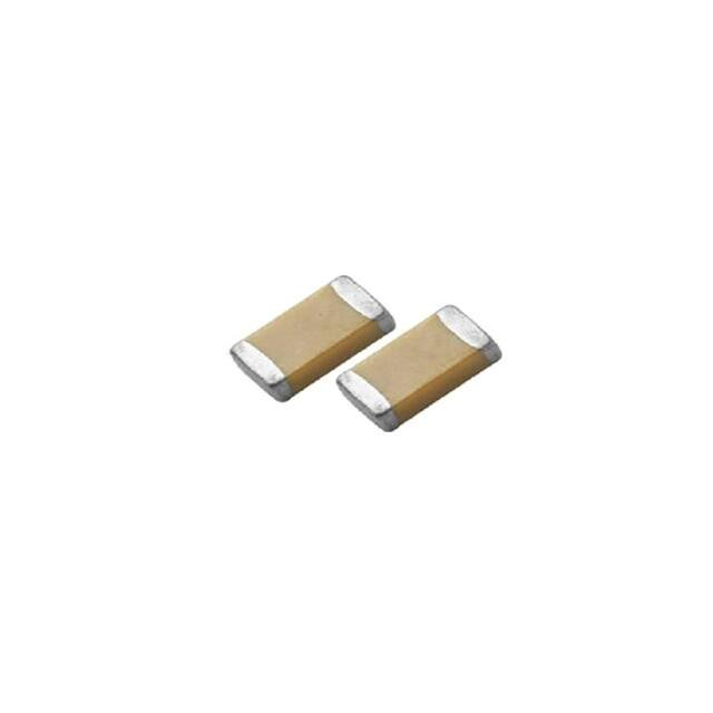

HC1206CG122J251 数据手册
Multilayer Ceramic Chip Capacitors Mid Voltage Type 100VDC – 630VDC HC Series FEATURE  High voltage rating in a given case size.  High reliability and thermal stability.  Application: DC to DC converter, High Voltage Coupling/DC blocking, Back-lighting inverters, LAN/WLAN interface, Power supplies, Snubbers in HF power convertors. PART NUMBERING SYSTEM HC 0805 XR 104 K 251 (1) (2) (3) (4) (5) (6) No Item (1) Meritek Series (2) Size (3) Dielectric Digit HC 0805 XR (4) Capacitance (5) Tolerance (6) Rated Voltage 104 K 251 RoHS Description Reference High-Voltage Ceramic Chip Capacitor High voltage application with 100VDC – 630VDC 0805 inch (2012 mm) 1206,1210,1808,1812,1825,2211,2220,2225 X7R CG: C0G(NP0), XR: X7R, XF: X5R, YV: Y5V 104: 10x10 pF = 100nF 103: 10x103pF, 4R7: 4.7pF (K): ±10% F: ±1%,G: ±2%,J: ±5%,K: ±10%,M: ±20% Working Voltage: 250VDC 101: 100VDC, 501: 500VDC, 631: 630VDC 4 DIMENSIONS Thickness Size Inch (mm) L (mm) W (mm) 0402 (1005) 1.00+0.15/-1.0 0.50+0.15/-1.0 0.25+0.05/-0.10 0603 (1608) 1.60±0.20 0.80±0.15 0.40±0.15 0805 (2012) 2.10±0.20 1.25±0.20 1206 (3216) 3.30±0.30 1.60+0.30/-0.10 1210 (3225) 3.30±0.40 2.50±0.30 1808 (4520) 4.60±0.50 2.00±0.20 1812 (4532) 4.60±0.50 3.20±0.30 1825 (4563) 4.60±0.50 6.30±0.40 0.75±0.35 2220 (5750) 5.70±0.50 5.00±0.40 0.85±0.35 2225 (5763) 5.70±0.50 6.30±0.40 0.85±0.35 T (mm) code MB min (mm) 0.50±0.20 See Thickness Specification Reference Table below 0.60±0.20 0.75±0.35 0.75±0.35 0.75±0.35 THICKNESS SPECIFICATION REFERENCE Code A B C D E F G H Thickness (mm) 0.60 ± 0.10 0.8 + 0.15/-0.10 1.25 ± 0.10 1.40 ± 0.15 1.60 ± 0.20 2.00 ± 0.20 2.50 ± 0.30 2.80 ± 0.30 Code I J K L M N O P Thickness (mm) 1.25 ± 0.20 1.15 ± 0.15 0.50 ± 0.20 0.30 ± 0.03 0.95 ± 0.10 0.50 ± 0.05 3.50 ± 0.20 1.60 +0.3/-0.10 Code Q R S T U V X Z Thickness (mm) 0.50 + 0.02/-0.05 3.10 ± 0.30 0.80 ± 0.07 0.85 ± 0.10 0.50 ± 0.10 0.20 ± 0.02 0.80 ± 0.10 0.25 ± 0.03 Rev. 7d Multilayer Ceramic Chip Capacitors HC Series Mid Voltage Type 100VDC – 630VDC ELECTRICAL CHARACTERISTICS Properties Characteristics Dielectric C0G(NP0) X7R Y5V Chip Size 0402, 0603, 0805, 1206, 1210, 1808, 1812, 1825, 2220, 2225 0603, 0805, 1206, 1210,1808, 1812, 1825, 2220, 2225 0805, 1206, 1210, 1812 Rated Voltage 100V, 200V, 250V, 500V, 630V 100V, 200V,250V,500V, 630V 100V, 200V, 250V 0.5pF ~ 180nF 100pF ~ 820nF 10nF to 820nF Capacitance Range Capacitance Tolerance Dissipation Factor See Capacitance Tolerance Reference Table Below Cap. Range Cap < 30pF Cap ≥ 30pF Q Spec. Q ≥ 400+20C Q ≥ 1000 ≤2.5% ≤5% Measured at the condition of 30~70% related humidity.  Preconditioning : Preform a heat treatment at 150±10⁰C for an hour, then leave in ambient condition for 24±2 hours before measurement For 25⁰C at ambient temperature Cap. & D.F. Test Condition (30~70% related humidity) Cap. Range Cap≤1000pF Cap>1000pF Insulation Resistance Operation Temperature Temperature Coefficient Test Condition 1.0±0.2Vrms, 1.0MHz±10% 1.0±0.2Vrms, 1.0KHz±10% 1.0±0.2Vrms, 1.0KHz±10%, at 25⁰C ambient temperature ≥100GΩ or RC≥5000Ω-F Whichever is smaller 1.0±0.2Vrms,1.0kHz±10%, at 20°C ambient Temperature. ≥10GΩ or RC≥100Ω-F Whichever is smaller -55°C ~ +125°C -25 to +85°C ±15% ±30ppm/⁰C Termination +30/-80% Cu (or Ag)/Ni/Sn (lead-free) CAPACITANCE TOLERANCE REFERENCE Code Description Code Description Code Description Code Description A B ±0.05 pF F ±1 % J ±5 % N -5%~10% ±0.10 pF G ±2 % K ±10 % P ±0.02 pF C ±0.25 pF H ±3 % L 0%~10% Q ±0.03 pF D ±0.50 pF I -10%~0% M ±20 % Z -20%~80% Rev. 7d Multilayer Ceramic Chip Capacitors Mid Voltage Type 100VDC – 630VDC HC Series RELIABILITY TEST CONDITIONS AND REQUIREMENTS Item Visual and Dimensions Test Condition Requirements  No remarkable defect.  Dimensions to confirm to individual specification sheet. -  Shall not exceed the limits given in the detailed spec. Capacitance Dielectric Q/ D.F. (Dissipation Factor) Class I: C0G(NP0) Cap≤1000pF, 1.0±0.2Vrms, 1MHz±10% Cap>1000pF, 1.0±0.2Vrms, 1KHz±10% Class II: (X7R, Y5V) 1.0±0.2Vrms, 1kHz±10% Temperature Coefficient With no electrical load. T.C. C0G(NP0) X7R Y5V Insulation Resistance Rated Vol. (V) = 100 < 100 > 500 Solderability Dielectric Strength Operation Temp. -55~125°C at 25°C -55~125°C at 25°C -25~85°C at 20°C Apply Voltage 1 times of UR 1 times of UR 500VDC Test Condition Max. 120 sec 60 sec 60 sec  Solder temperature: 235±5°C for (1206~1210)  Solder temperature: 245±5°C for (1808~2225)  Dipping time: 2±0.5 sec. Rated Voltage Condition ≤ 250 2 times of UR 250
HC1206CG122J251
物料型号:HC系列中压型多层陶瓷片式电容器,电压范围100VDC至630VDC。
器件简介:该系列电容器具有在给定尺寸下高电压等级、高可靠性和热稳定性的特点。
引脚分配:文档中未明确提供引脚分配信息,但通常这类电容器为两端引脚。
参数特性: - 尺寸:0402、0603、0805、1206、1210、1808、1812、1825、2211、2220、2225等。 - 介质:包括COG(NPO)、X7R、Y5V等类型。 - 电容范围:从0.5pF到820nF。 - 公差:包括±10%、±5%、±2%等。 - 额定电压:100V、200V、250V、500V、630V。
功能详解: - 应用领域:DC-DC转换器、高压耦合/DC阻断、背光逆变器、LAN/WLAN接口、电源、高频功率转换器中的消火花装置等。
应用信息:适用于多种高压环境,如电源、DC-DC转换器等。
封装信息:提供了详细的尺寸信息,包括英寸和毫米两种单位,以及厚度规格参考表。
