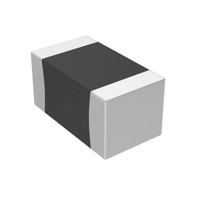

DATA SHEET SURFACE-MOUNT CERAMIC MULTILAYER CAPACITORS General purpose Class 1, NP0 16 V TO 50 V 0.22 pF to 100 nF Product Specification – November 26, 2019 V.18 RoHS compliant & Halogen Free Product specification Surface-Mount Ceramic Multilayer Capacitors General Purpose NP0 16 V to 50 V SCOPE ORDERING INFORMATION - GLOBAL PART NUMBER, PHYCOMP This specification describes NP0 series chip capacitors with leadfree terminations. CTC & 12NC APPLICATIONS  Consumer electronics for example - Tuners - Television receivers - All types of cameras  Telecommunications  Data processing 2 14 All part numbers are identified by the series, size, tolerance, TC material, packing style, voltage, process code, termination and capacitance value. YAGEO BRAND ordering code GLOBAL PART NUMBER (PREFERRED ) CC XXXX X X (1) NPO (2) (3) X BN XXX (4) (5) (1) SIZE – INCH BASED (METRIC) 0201 (0603) 0402 (1005) 0603 (1608) 0805 (2012) FEATURES  Supplied in tape on reel  Nickel-barrier end termination  RoHS compliant  Halogen Free compliant 1206 (3216) 1210 (3225) 1812 (4532) (2) TOLERANCE B = ± 0.1 pF C = ± 0.25 pF D = ± 0.5 pF F = ± 1% G = ± 2% J = ± 5% K = ± 10% (3) PACKING STYLE R = Paper/PE taping reel; Reel 7 inch K = Blister taping reel; Reel 7 inch P = Paper/PE taping reel; Reel 13 inch F = Blister taping reel; Reel 13 inch C = Bulk case (4) RATED VOLTAGE 7 = 16 V 8 = 25 V 9 = 50 V (5) CAPACITANCE VALUE 2 significant digits+number of zeros The 3rd digit signifies the multiplying factor, and letter R is decimal point Example: 121 = 12 x 101 = 120 pF www.yageo.com Nov. 26, 2019 V.18 Product specification Surface-Mount Ceramic Multilayer Capacitors General Purpose 3 14 16 V to 50 V NP0 CONSTRUCTION The capacitor consists of a rectangular block of ceramic dielectric in which a number of interleaved metal electrodes are contained. This structure gives rise to a high capacitance per unit volume. terminations electrodes The inner electrodes are connected to the two end terminations and finally covered with a layer of plated tin (NiSn). The terminations are lead-free. A cross section of the structure is shown in Fig.1. MLB457 ceramic material Fig. 1 Surface mounted multilayer ceramic capacitor construction DIMENSION OUTLINES Table 1 For outlines see fig. 2 L4 (mm) min. L1 (mm) W (mm) 0201 0402 0.6 ± 0.03 1.0 ± 0.05 0.3 ± 0.03 0.5 ± 0.05 0.10 0.15 0.20 0.35 0.20 0.40 0603 1.6 ± 0.10 0.8 ± 0.10 0.20 0.60 0.40 2.0 ± 0.10 (1) 1.25 ± 0.10 (1) (2) (2) 0.25 0.75 0.70 0.25 0.75 1.40 0805 2.0 ± 0.20 1.25 ± 0.20 T (MM) L2 / L3 (mm) min. max. TYPE Refer to table 2 to 5 3.2 ± 0.15 (1) 1.6 ± 0.15 (1) 3.2 ± 0.30 (2) 1.6 ± 0.20 (2) 1210 3.2 ± 0.20 2.5 ± 0.20 0.25 0.75 1.40 1812 4.5 ± 0.20 3.2 ± 0.20 0.25 0.75 2.20 1206 For dimension see Table 1 W T L2 L4 L1 L3 MBB211 Fig. 2 Surface mounted multilayer ceramic c apacitor dimension NOTE 1. Dimension for size 0805 and 1206, C ≤ 1 nF 2. Dimension for size 0805 and 1206, C > 1 nF www.yageo.com Nov. 26, 2019 V.18 Product specification Surface-Mount Ceramic Multilayer Capacitors General Purpose CAPACITANCE RANGE & THICKNESS FOR NP0 Table 2 Sizes from 0201 to 0603 0201 0402 CAP. 25 V 50 V 0.22 pF 0.3± 0.03 0.3± 0.03 0.47 pF 0.3± 0.03 0.82 pF NP0 16 V to 50 V 4 14 0603 16 V 25 V 50 V 16 V 25 V 50 V 0.3± 0.03 0.5± 0.05 0.5± 0.05 0.5± 0.05 0.8± 0.1 0.8± 0.1 0.8± 0.1 0.3± 0.03 0.3± 0.03 0.5± 0.05 0.5± 0.05 0.5± 0.05 0.8± 0.1 0.8± 0.1 0.8± 0.1 1.0 pF 0.3± 0.03 0.3± 0.03 0.5± 0.05 0.5± 0.05 0.5± 0.05 0.8± 0.1 0.8± 0.1 0.8± 0.1 1.2 pF 0.3± 0.03 0.3± 0.03 0.5± 0.05 0.5± 0.05 0.5± 0.05 0.8± 0.1 0.8± 0.1 0.8± 0.1 1.5 pF 0.3± 0.03 0.3± 0.03 0.5± 0.05 0.5± 0.05 0.5± 0.05 0.8± 0.1 0.8± 0.1 0.8± 0.1 1.8 pF 0.3± 0.03 0.3± 0.03 0.5± 0.05 0.5± 0.05 0.5± 0.05 0.8± 0.1 0.8± 0.1 0.8± 0.1 2.2 pF 0.3± 0.03 0.3± 0.03 0.5± 0.05 0.5± 0.05 0.5± 0.05 0.8± 0.1 0.8± 0.1 0.8± 0.1 2.7 pF 0.3± 0.03 0.3± 0.03 0.5± 0.05 0.5± 0.05 0.5± 0.05 0.8± 0.1 0.8± 0.1 0.8± 0.1 3.3 pF 0.3± 0.03 0.3± 0.03 0.5± 0.05 0.5± 0.05 0.5± 0.05 0.8± 0.1 0.8± 0.1 0.8± 0.1 3.9 pF 0.3± 0.03 0.3± 0.03 0.5± 0.05 0.5± 0.05 0.5± 0.05 0.8± 0.1 0.8± 0.1 0.8± 0.1 4.7 pF 0.3± 0.03 0.3± 0.03 0.5± 0.05 0.5± 0.05 0.5± 0.05 0.8± 0.1 0.8± 0.1 0.8± 0.1 5.6 pF 0.3± 0.03 0.3± 0.03 0.5± 0.05 0.5± 0.05 0.5± 0.05 0.8± 0.1 0.8± 0.1 0.8± 0.1 6.8 pF 0.3± 0.03 0.3± 0.03 0.5± 0.05 0.5± 0.05 0.5± 0.05 0.8± 0.1 0.8± 0.1 0.8± 0.1 8.2 pF 0.3± 0.03 0.3± 0.03 0.5± 0.05 0.5± 0.05 0.5± 0.05 0.8± 0.1 0.8± 0.1 0.8± 0.1 10 pF 0.3± 0.03 0.3± 0.03 0.5± 0.05 0.5± 0.05 0.5± 0.05 0.8± 0.1 0.8± 0.1 0.8± 0.1 12 pF 0.3± 0.03 0.3± 0.03 0.5± 0.05 0.5± 0.05 0.5± 0.05 0.8± 0.1 0.8± 0.1 0.8± 0.1 15 pF 0.3± 0.03 0.3± 0.03 0.5± 0.05 0.5± 0.05 0.5± 0.05 0.8± 0.1 0.8± 0.1 0.8± 0.1 18 pF 0.3± 0.03 0.3± 0.03 0.5± 0.05 0.5± 0.05 0.5± 0.05 0.8± 0.1 0.8± 0.1 0.8± 0.1 22 pF 0.3± 0.03 0.3± 0.03 0.5± 0.05 0.5± 0.05 0.5± 0.05 0.8± 0.1 0.8± 0.1 0.8± 0.1 27 pF 0.3± 0.03 0.3± 0.03 0.5± 0.05 0.5± 0.05 0.5± 0.05 0.8± 0.1 0.8± 0.1 0.8± 0.1 33 pF 0.3± 0.03 0.3± 0.03 0.5± 0.05 0.5± 0.05 0.5± 0.05 0.8± 0.1 0.8± 0.1 0.8± 0.1 39 pF 0.3± 0.03 0.3± 0.03 0.5± 0.05 0.5± 0.05 0.5± 0.05 0.8± 0.1 0.8± 0.1 0.8± 0.1 47 pF 0.3± 0.03 0.3± 0.03 0.5± 0.05 0.5± 0.05 0.5± 0.05 0.8± 0.1 0.8± 0.1 0.8± 0.1 56 pF 0.3± 0.03 0.3± 0.03 0.5± 0.05 0.5± 0.05 0.5± 0.05 0.8± 0.1 0.8± 0.1 0.8± 0.1 68 pF 0.3± 0.03 0.3± 0.03 0.5± 0.05 0.5± 0.05 0.5± 0.05 0.8± 0.1 0.8± 0.1 0.8± 0.1 82 pF 0.3± 0.03 0.3± 0.03 0.5± 0.05 0.5± 0.05 0.5± 0.05 0.8± 0.1 0.8± 0.1 0.8± 0.1 100 pF 0.3± 0.03 0.3± 0.03 0.5± 0.05 0.5± 0.05 0.5± 0.05 0.8± 0.1 0.8± 0.1 0.8± 0.1 NOTE 1. Values in shaded cells indicate thickness class in mm 2. Capacitance value of non E-12 series is on request www.yageo.com Nov. 26, 2019 V.18 Product specification Surface-Mount Ceramic Multilayer Capacitors General Purpose NP0 16 V to 50 V 5 14 CAPACITANCE RANGE & THICKNESS FOR NP0 Table 3 Sizes from 0201 to 0603 (continued) 0201 CAP. 25 V 0402 50 V 0603 16 V 25 V 50 V 16 V 25 V 50 V 120 pF 0.5± 0.05 0.5± 0.05 0.5± 0.05 0.8± 0.1 0.8± 0.1 0.8± 0.1 150 pF 0.5± 0.05 0.5± 0.05 0.5± 0.05 0.8± 0.1 0.8± 0.1 0.8± 0.1 180 pF 0.5± 0.05 0.5± 0.05 0.5± 0.05 0.8± 0.1 0.8± 0.1 0.8± 0.1 220 pF 0.5± 0.05 0.5± 0.05 0.5± 0.05 0.8± 0.1 0.8± 0.1 0.8± 0.1 270 pF 0.5± 0.05 0.5± 0.05 0.5± 0.05 0.8± 0.1 0.8± 0.1 0.8± 0.1 330 pF 0.5± 0.05 0.5± 0.05 0.5± 0.05 0.8± 0.1 0.8± 0.1 0.8± 0.1 390 pF 0.5± 0.05 0.5± 0.05 0.5± 0.05 0.8± 0.1 0.8± 0.1 0.8± 0.1 470 pF 0.5± 0.05 0.5± 0.05 0.5± 0.05 0.8± 0.1 0.8± 0.1 0.8± 0.1 560 pF 0.5± 0.05 0.5± 0.05 0.5± 0.05 0.8± 0.1 0.8± 0.1 0.8± 0.1 680 pF 0.5± 0.05 0.5± 0.05 0.5± 0.05 0.8± 0.1 0.8± 0.1 0.8± 0.1 0.8± 0.1 0.8± 0.1 0.8± 0.1 0.8± 0.1 0.8± 0.1 0.8± 0.1 1.2 nF 0.8± 0.1 0.8± 0.1 0.8± 0.1 1.5 nF 0.8± 0.1 0.8± 0.1 0.8± 0.1 1.8 nF 0.8± 0.1 0.8± 0.1 0.8± 0.1 2.2 nF 0.8± 0.1 0.8± 0.1 0.8± 0.1 2.7 nF 0.8± 0.1 0.8± 0.1 0.8± 0.1 3.3 nF 0.8± 0.1 0.8± 0.1 0.8± 0.1 3.9 nF 0.8± 0.1 0.8± 0.1 0.8± 0.1 0.8± 0.1 0.8± 0.1 0.8± 0.1 820 pF 1.0 nF 0.5± 0.05 0.5± 0.05 0.5± 0.05 4.7 nF 5.6 nF 6.8 nF 8.2 nF 10 nF 12 nF 15 nF 18 nF 22 nF 33 nF NOTE 1. Values in shaded cells indicate thickness class in mm 2. Capacitance value of non E-12 series is on request www.yageo.com Nov. 26, 2019 V.18 Product specification Surface-Mount Ceramic Multilayer Capacitors General Purpose CAPACITANCE RANGE & THICKNESS FOR NP0 Table 4 Sizes from 0805 to 1812 0805 1206 CAP. NP0 16 V to 50 V 1210 16 V 25 V 50 V 16 V 25 V 50 V 0.47 pF 0.6± 0.1 0.6± 0.1 0.6± 0.1 0.6± 0.1 0.6± 0.1 0.6± 0.1 0.82 pF 0.6± 0.1 0.6± 0.1 0.6± 0.1 0.6± 0.1 0.6± 0.1 0.6± 0.1 1.0 pF 0.6± 0.1 0.6± 0.1 0.6± 0.1 0.6± 0.1 0.6± 0.1 0.6± 0.1 1.2 pF 0.6± 0.1 0.6± 0.1 0.6± 0.1 0.6± 0.1 0.6± 0.1 0.6± 0.1 1.5 pF 0.6± 0.1 0.6± 0.1 0.6± 0.1 0.6± 0.1 0.6± 0.1 0.6± 0.1 1.8 pF 0.6± 0.1 0.6± 0.1 0.6± 0.1 0.6± 0.1 0.6± 0.1 0.6± 0.1 2.2 pF 0.6± 0.1 0.6± 0.1 0.6± 0.1 0.6± 0.1 0.6± 0.1 0.6± 0.1 2.7 pF 0.6± 0.1 0.6± 0.1 0.6± 0.1 0.6± 0.1 0.6± 0.1 0.6± 0.1 3.3 pF 0.6± 0.1 0.6± 0.1 0.6± 0.1 0.6± 0.1 0.6± 0.1 0.6± 0.1 3.9 pF 0.6± 0.1 0.6± 0.1 0.6± 0.1 0.6± 0.1 0.6± 0.1 0.6± 0.1 4.7 pF 0.6± 0.1 0.6± 0.1 0.6± 0.1 0.6± 0.1 0.6± 0.1 0.6± 0.1 5.6 pF 0.6± 0.1 0.6± 0.1 0.6± 0.1 0.6± 0.1 0.6± 0.1 0.6± 0.1 6.8 pF 0.6± 0.1 0.6± 0.1 0.6± 0.1 0.6± 0.1 0.6± 0.1 0.6± 0.1 8.2 pF 0.6± 0.1 0.6± 0.1 0.6± 0.1 0.6± 0.1 0.6± 0.1 0.6± 0.1 10 pF 0.6± 0.1 0.6± 0.1 0.6± 0.1 0.6± 0.1 0.6± 0.1 0.6± 0.1 12 pF 0.6± 0.1 0.6± 0.1 0.6± 0.1 0.6± 0.1 0.6± 0.1 0.6± 0.1 15 pF 0.6± 0.1 0.6± 0.1 0.6± 0.1 0.6± 0.1 0.6± 0.1 0.6± 0.1 18 pF 0.6± 0.1 0.6± 0.1 0.6± 0.1 0.6± 0.1 0.6± 0.1 0.6± 0.1 22 pF 0.6± 0.1 0.6± 0.1 0.6± 0.1 0.6± 0.1 0.6± 0.1 0.6± 0.1 27 pF 0.6± 0.1 0.6± 0.1 0.6± 0.1 0.6± 0.1 0.6± 0.1 0.6± 0.1 33 pF 0.6± 0.1 0.6± 0.1 0.6± 0.1 0.6± 0.1 0.6± 0.1 0.6± 0.1 39 pF 0.6± 0.1 0.6± 0.1 0.6± 0.1 0.6± 0.1 0.6± 0.1 0.6± 0.1 47 pF 0.6± 0.1 0.6± 0.1 0.6± 0.1 0.6± 0.1 0.6± 0.1 56 pF 0.6± 0.1 0.6± 0.1 0.6± 0.1 0.6± 0.1 68 pF 0.6± 0.1 0.6± 0.1 0.6± 0.1 82 pF 0.6± 0.1 0.6± 0.1 100 pF 0.6± 0.1 0.6± 0.1 6 14 1812 25 V 50 V 50 V 0.6± 0.1 1.25± 0.2 1.25± 0.2 0.6± 0.1 0.6± 0.1 1.25± 0.2 1.25± 0.2 1.25± 0.2 0.6± 0.1 0.6± 0.1 0.6± 0.1 1.25± 0.2 1.25± 0.2 1.25± 0.2 0.6± 0.1 0.6± 0.1 0.6± 0.1 0.6± 0.1 1.25± 0.2 1.25± 0.2 1.25± 0.2 0.6± 0.1 0.6± 0.1 0.6± 0.1 0.6± 0.1 1.25± 0.2 1.25± 0.2 1.25± 0.2 0.22 pF NOTE 1. Values in shaded cells indicate thickness class in mm 2. Capacitance value of non E-12 series is on request www.yageo.com Nov. 26, 2019 V.18 Product specification Surface-Mount Ceramic Multilayer Capacitors General Purpose NP0 16 V to 50 V 7 14 CAPACITANCE RANGE & THICKNESS FOR NP0 Table 5 Sizes from 0805 to 1812 (continued) 0805 CAP. 1206 1210 1812 16 V 25 V 50 V 16 V 25 V 50 V 25 V 50 V 50 V 120 pF 0.6± 0.1 0.6± 0.1 0.6± 0.1 0.6± 0.1 0.6± 0.1 0.6± 0.1 1.25± 0.2 1.25± 0.2 1.25± 0.2 150 pF 0.6± 0.1 0.6± 0.1 0.6± 0.1 0.6± 0.1 0.6± 0.1 0.6± 0.1 1.25± 0.2 1.25± 0.2 1.25± 0.2 180 pF 0.6± 0.1 0.6± 0.1 0.6± 0.1 0.6± 0.1 0.6± 0.1 0.6± 0.1 1.25± 0.2 1.25± 0.2 1.25± 0.2 220 pF 0.6± 0.1 0.6± 0.1 0.6± 0.1 0.6± 0.1 0.6± 0.1 0.6± 0.1 1.25± 0.2 1.25± 0.2 1.25± 0.2 270 pF 0.6± 0.1 0.6± 0.1 0.6± 0.1 0.6± 0.1 0.6± 0.1 0.6± 0.1 1.25± 0.2 1.25± 0.2 1.25± 0.2 330 pF 0.6± 0.1 0.6± 0.1 0.6± 0.1 0.6± 0.1 0.6± 0.1 0.6± 0.1 1.25± 0.2 1.25± 0.2 1.25± 0.2 390 pF 0.6± 0.1 0.6± 0.1 0.6± 0.1 0.6± 0.1 0.6± 0.1 0.6± 0.1 1.25± 0.2 1.25± 0.2 1.25± 0.2 470 pF 0.6± 0.1 0.6± 0.1 0.6± 0.1 0.6± 0.1 0.6± 0.1 0.6± 0.1 1.25± 0.2 1.25± 0.2 1.25± 0.2 560 pF 0.6± 0.1 0.6± 0.1 0.6± 0.1 0.6± 0.1 0.6± 0.1 0.6± 0.1 1.25± 0.2 1.25± 0.2 1.25± 0.2 680 pF 0.6± 0.1 0.6± 0.1 0.6± 0.1 0.6± 0.1 0.6± 0.1 0.6± 0.1 1.25± 0.2 1.25± 0.2 1.25± 0.2 820 pF 0.6± 0.1 0.6± 0.1 0.6± 0.1 0.6± 0.1 0.6± 0.1 0.6± 0.1 1.25± 0.2 1.25± 0.2 1.25± 0.2 1.0 nF 0.6± 0.1 0.6± 0.1 0.6± 0.1 0.6± 0.1 0.6± 0.1 0.6± 0.1 1.25± 0.2 1.25± 0.2 1.25± 0.2 1.2 nF 0.85± 0.1 0.85± 0.1 0.85± 0.1 0.6± 0.1 0.6± 0.1 0.6± 0.1 1.25± 0.2 1.25± 0.2 1.25± 0.2 1.5 nF 0.85± 0.1 0.85± 0.1 0.85± 0.1 0.6± 0.1 0.6± 0.1 0.6± 0.1 1.25± 0.2 1.25± 0.2 1.25± 0.2 1.8 nF 0.85± 0.1 0.85± 0.1 0.85± 0.1 0.6± 0.1 0.6± 0.1 0.6± 0.1 1.25± 0.2 1.25± 0.2 1.25± 0.2 2.2 nF 1.25± 0.2 1.25± 0.2 1.25± 0.2 0.6± 0.1 0.6± 0.1 0.6± 0.1 1.25± 0.2 1.25± 0.2 1.25± 0.2 2.7 nF 1.25± 0.2 1.25± 0.2 1.25± 0.2 0.6± 0.1 0.6± 0.1 0.6± 0.1 1.25± 0.2 1.25± 0.2 1.25± 0.2 3.3 nF 1.25± 0.2 1.25± 0.2 1.25± 0.2 0.85± 0.1 0.85± 0.1 0.85± 0.1 1.25± 0.2 1.25± 0.2 1.25± 0.2 3.9 nF 1.25± 0.2 1.25± 0.2 1.25± 0.2 0.85± 0.1 0.85± 0.1 0.85± 0.1 1.25± 0.2 1.25± 0.2 1.25± 0.2 4.7 nF 1.25± 0.2 1.25± 0.2 1.25± 0.2 0.85± 0.1 0.85± 0.1 0.85± 0.1 1.25± 0.2 1.25± 0.2 1.25± 0.2 5.6 nF 1.25± 0.2 1.25± 0.2 1.25± 0.2 0.85± 0.1 0.85± 0.1 0.85± 0.1 1.25± 0.2 1.25± 0.2 1.25± 0.2 6.8 nF 1.25± 0.2 1.25± 0.2 1.25± 0.2 0.85± 0.1 0.85± 0.1 0.85± 0.1 1.25± 0.2 1.25± 0.2 1.25± 0.2 8.2 nF 1.25± 0.2 1.25± 0.2 1.25± 0.2 1.25± 0.2 1.25± 0.2 1.25± 0.2 1.25± 0.2 1.25± 0.2 1.25± 0.2 10 nF 1.25± 0.2 1.25± 0.2 1.25± 0.2 1.25± 0.2 1.25± 0.2 1.25± 0.2 1.25± 0.2 1.25± 0.2 1.25± 0.2 12 nF 0.85± 0.1 0.85± 0.1 0.85± 0.1 1.25± 0.2 15 nF 0.85± 0.1 0.85± 0.1 0.85± 0.1 1.25± 0.2 18 nF 0.85± 0.1 0.85± 0.1 0.85± 0.1 1.25± 0.2 22 nF 0.85± 0.1 0.85± 0.1 0.85± 0.1 33 nF 0.85± 0.1 0.85± 0.1 0.85± 0.1 47 nF 1.25± 0.2 1.25± 0.2 1.25± 0.2 1.60± 0.2 1.60± 0.2 1.60± 0.2 1.60± 0.2 1.60± 0.2 1.60± 0.2 2.0± 0.2 2.0± 0.2 1.60± 0.2 1.60± 0.2 1.25± 0.2 56 nF 68 nF 82 nF 100 nF NOTE 1. Values in shaded cells indicate thickness class in mm 2. Capacitance value of non E-12 series is on request www.yageo.com Nov. 26, 2019 V.18 Product specification Surface-Mount Ceramic Multilayer Capacitors General Purpose NP0 16 V to 50 V 8 14 THICKNESS CLASSES AND PACKING QUANTITY Table 6 SIZE CODE Ø 180 MM / 7 INCH Paper Blister Ø 330 MM / 13 INCH Paper Blister THICKNESS CLASSIFICATION TAPE WIDTH QUANTITY PER REEL 0201 0.3 ± 0.03 mm 8 mm 15,000 --- 50,000 --- --- 0402 0.5 ± 0.05 mm 8 mm 10,000 --- 50,000 --- 50,000 0603 0.8 ± 0.1 mm 8 mm 4,000 --- 15,000 --- 15,000 0.6 ± 0.1 mm 8 mm 4,000 --- 20,000 --- 10,000 0.85 ± 0.1 mm 8 mm 4,000 --- 15,000 --- 8,000 1.25 ± 0.2 mm 8 mm --- 3,000 --- 10,000 5,000 0.6 ± 0.1 mm 8 mm 4,000 --- 20,000 --- --- 0.85 ± 0.1 mm 8 mm 4,000 --- 15,000 --- --- 1.00 / 1.15 ± 0.1 mm 8 mm --- 3,000 --- 10,000 --- 1.25 ± 0.2 mm 8 mm --- 3,000 --- 10,000 --- 1.6 ± 0.15 mm 8 mm --- 2,500 --- 10,000 --- 1.6 ± 0.2 mm 8 mm --- 2,000 --- 10,000 --- 0.6 / 0.7 ± 0.1 mm 8 mm --- 4,000 --- 15,000 --- 0.85 ± 0.1 mm 8 mm --- 4,000 --- 10,000 --- 1.0 ± 0.1 mm 8 mm --- 3,000 --- 10,000 --- 1.15 ± 0.1 mm 8 mm --- 3,000 --- 10,000 --- 1.15 ± 0.15 mm 8 mm --- 3,000 --- 10,000 --- 1.25 ± 0.2 mm 8 mm --- 3,000 --- --- --- 0805 1206 1210 1808 1812 QUANTITY PER BULK CASE 1.5 ± 0.1 mm 8 mm --- 2,000 --- --- --- 1.6 / 1.9 ± 0.2 mm 8 mm --- 2,000 --- --- --- 2.0 ± 0.2 mm 8 mm --- 2,000 1,000 --- --- --- 2.5 ± 0.2 mm 8 mm --- 1,000 500 --- --- --- 1.15 ± 0.15 mm 12 mm --- 3,000 --- --- --- 1.25 ± 0.2 mm 12 mm --- 3,000 --- --- --- 1.35 ± 0.15 mm 12 mm --- 2,000 --- --- --- 1.5 ± 0.1 mm 12 mm --- 2,000 --- --- --- 1.6 ± 0.2 mm 12 mm --- 2,000 --- --- --- 2.0 ± 0.2 mm 12 mm --- 2,000 --- --- --- 0.6 / 0.85 ± 0.1 mm 12 mm --- 2,000 --- --- --- 1.15 ± 0.1 mm 12 mm --- 1,000 --- --- --- 1.15 ± 0.15 mm 12 mm --- 1,000 --- --- --- 1.35 ± 0.15 mm 12 mm --- 1,000 --- --- --- 1.5 ± 0.1 mm 12 mm --- 1,000 --- --- --- 1.6 ± 0.2 mm 12 mm --- 1,000 --- --- --- 2.0 ± 0.2 mm 12 mm --- 1,000 --- --- --- 2.5 ± 0.2 mm 12 mm --- 500 --- --- --- www.yageo.com Nov. 26, 2019 V.18 Product specification Surface-Mount Ceramic Multilayer Capacitors General Purpose 9 14 16 V to 50 V NP0 ELECTRICAL CHARACTERISTICS NP0 DIELECTRIC CAPACITORS; NISN TERMINATIONS Unless otherwise stated all electrical values apply at an ambient temperature of 20± 1 °C, an atmospheric pressure of 86 to 106 kPa, and a relative humidity of 63 to 67%. Table 7 VALUE DESCRIPTION Capacitance range 0.22 pF to 100 nF Capacitance tolerance C < 10 pF ± 0.1 pF, ± 0.25 pF, ± 0.5 pF C ≥ 10 pF ± 1%, ± 2%, ± 5%, ± 10% C < 30 pF ≤ 1 / ( 400 + 20C ) C ≥ 30 pF ≤ 0.1 % Dissipation factor (D.F.) Insulation resistance after 1 minute at Ur (DC) Rins ≥ 10 GΩ or Rins × Cr ≥ 500 seconds whichever is less Maximum capacitance change as a function of temperature (temperature characteristic/coefficient): ± 30 ppm/°C Operating temperature range: –55 °C to +125 °C Sample limits (broken lines). Requirement levels (dotted lines) MEA607 CCB107 10 C C (%) 40 TC (x10 6/K) 5 20 0 0 20 5 40 40 Fig. 3 0 40 80 120 T ( oC) Typical temperature coefficient as a function of temperature 10 0 Fig. 4 10 20 30 40 50 VDC (V) Typical capacitance change with respect to the capacitance at 1 V as a function of DC voltage www.yageo.com Nov. 26, 2019 V.18 Product specification Surface-Mount Ceramic Multilayer Capacitors General Purpose NP0 16 V to 50 V 10 14 CCA044 10 tan ( 10 4) 7.5 5 2.5 0 40 0 40 80 120 T ( oC) Fig. 5 Typical tan δ as a function of temperature SOLDERING RECOMMENDATION Table 8 SIZE SOLDERING 0201 METHOD Reflow Reflow/Wave 0402 0603 0805 1206 ≥ 1210 Reflow only ≥ 0.1 µF ≥ 1.0 µF ≥ 2.2 µF ≥ 4.7 µF Reflow only --- < 0.1 µF < 1.0 µF < 2.2 µF < 4.7 µF --- www.yageo.com Nov. 26, 2019 V.18 Product specification Surface-Mount Ceramic Multilayer Capacitors General Purpose NP0 16 V to 50 V 11 14 TESTS AND REQUIREMENTS Table 9 Test procedures and requirements TEST TEST METHOD PROCEDURE REQUIREMENTS Mounting IEC 6038421/22 4.3 The capacitors may be mounted on printed-circuit boards or ceramic substrates No visible damage Visual inspection and dimensio n check 4.4 Any applicable method using × 10 magnification In accordance with specification Capacitance 4.5.1 Class 1: f = 1 MHz for C ≤ 1 nF, measuring at voltage 1 V rms at 20 °C Within specified tolerance f = 1 KHz for C > 1 nF, measuring at voltage 1 V rms at 20 °C Dissipation factor (D.F.) 4.5.2 Class 1: f = 1 MHz for C ≤ 1 nF , measuring at voltage 1 V rms at 20 °C In accordance with specification f = 1 KHz for C > 1 nF, measuring at voltage 1 V rms at 20 °C Insulation resistance 4.5.3 At Ur (DC) for 1 minute In accordance with specification Temperature coefficient 4.6 Capacitance shall be measured by the steps shown in the following table. Class1: ∆ C/C: ± 30ppm The capacitance change should be measured after 5 min at each specified temperature stage. Step Temperature(℃) a 25± 2 b Lower temperature± 3℃ c 25± 2 d Upper Temperature± 2℃ e 25± 2 Class2: X7R: ∆ C/C: ± 15% Y5V: ∆ C/C: 22~-82% Class2: X7R/X5R: ∆ C/C: ±15% Y5V: ∆ C/C: 22~-82% (1) Class I Temperature Coefficient shall be calculated from the formula as below C2 - C1 Temp, Coefficient = 106 [ppm/℃] C1 xΔT C1: Capacitance at step c C2: Capacitance at 125℃ ∆T: 100℃(=125℃-25℃) (2) Class II Capacitance Change shall be calculated from the formula as below C2 - C1 ∆C = x 100% C1 C1: Capacitance at step c C2: Capacitance at step b or d www.yageo.com Nov. 26, 2019 V.18 Product specification Surface-Mount Ceramic Multilayer Capacitors TEST Adhesion Bond strength of plating on end face TEST METHOD General Purpose NP0 16 V to 50 V PROCEDURE REQUIREMENTS 4.7 A force applied for 10 seconds to the line joining the terminations and in a plane parallel to the substrate Force size ≥ 0603: 5N size = 0402: 2.5N size = 0201: 1N 4.8 Mounting in accordance with IEC 60384-22 paragraph 4.3 No visible damage Conditions: bending 1 mm at a rate of 1 mm/s, radius jig 5 mm 12 14 ∆C/C Class 1: NP0: within ± 1% or 0.5 pF whichever is greater Resistance to soldering heat IEC 60384- 4.9 21/22 Precondition: 150 +0/–10 °C for 1 hour, then keep for 24 ± 1 hours at room temperature Preheating: for size ≤ 1206: 120 °C to 150 °C for 1 minute Dissolution of the end face plating shall not exceed 25% of the length of the edge concerned Preheating: for size >1206: 100 °C to 120 °C for 1 minute and 170 °C to 200 °C for 1 minute Solder bath temperature: 260 ± 5 °C ∆C/C Dipping time: 10 ± 0.5 seconds Class 1: NP0: within ± 0.5% or 0.5 pF whichever is greater Recovery time: 24 ± 2 hours D.F. within initial specified value Rins within initial specified value Solderability 4.10 Preheated the temperature of 80 °C to 140 °C and maintained for 30 seconds to 60 seconds. The solder should cover over 95% of the critical area of each termination 1. Temperature: 235± 5°C / Dipping time: 2 ± 0.5 s 2. Temperature: 245± 5°C / Dipping time: 3 ± 0.5 s (lead free)Depth of immersion: 10mm Rapid change of temperature 4.11 Preconditioning; 150 +0/–10 °C for 1 hour, then keep for 24 ± 1 hours at room temperature 5 cycles with following detail: 30 minutes at lower category temperature 30 minutes at upper category temperature No visual damage ∆C/C Class 1: NP0: within ± 1% or 1 pF whichever is greater Recovery time 24 ± 2 hours D.F. meet initial specified value Rins meet initial specified value www.yageo.com Nov. 26, 2019 V.18 Product specification Surface-Mount Ceramic Multilayer Capacitors TEST Damp heat with Ur load General Purpose 16 V to 50 V TEST METHOD PROCEDURE REQUIREMENTS IEC 6038421/22 1. Preconditioning, class 2 only: No visual damage after recovery 4.13 150 +0/-10 °C /1 hour, then keep for 24 ± 1 hour at room temp 2. Initial measure: Spec: refer to initial spec C, D, IR 3. Damp heat test: 500 ± 12 hours at 40 ± 2 °C; 90 to 95% R.H. 1.0 Ur applied 4. Recovery: Class 1: 6 to 24 hours 5. Final measure: C, D, IR P.S. If the capacitance value is less than the minimum value permitted, then after the other measurements have been made the capacitor shall be preconditioned according to “IEC 60384 4.1” and then the requirement shall be met. Endurance 4.14 1. Preconditioning, class 2 only: 150 +0/-10 °C /1 hour, then keep for 24 ± 1 hour at room temp 2. Initial measure: Spec: refer to initial spec C, D, IR 3. Endurance test: Temperature: NP0: 125 °C Specified stress voltage applied for 1,000 hours: Applied 2.0 x Ur for general product. IEC 60384-1 4.6 14 Class 1: NP0: within ± 2% or 1 pF whichever is greater D.F. Class 1: NP0: ≤ 2 x specified value Rins Class 1: NP0: ≥ 2,500 MΩ or Rins x Cr ≥ 25s whichever is less No visual damage ∆C/C Class1: NP0: within ± 2% or 1 pF whichever is greater D.F. Class1: NP0: ≤ 2 x specified value 5. Final measure: C, D, IR Rins Specified stress voltage applied for 1 minute Ur ≤ 100 V: series applied 2.5 Ur 100 V < Ur ≤ 200 V series applied (1.5 Ur + 100) 200 V < Ur ≤ 500 V series applied (1.3 Ur + 100) Ur > 500 V: 1.3 Ur I: 7.5 mA 13 ∆C/C 4. Recovery time: 24 ± 2 hours P.S. If the capacitance value is less than the minimum value permitted, then after the other measurements have been made the capacitor shall be preconditioned according to “IEC 60384 4.1” and then the requirement shall be met. Voltage proof NP0 Class1: NP0: ≥ 4,000 MΩ or Rins x Cr ≥ 40s whichever is less No breakdown or flashover www.yageo.com Nov. 26, 2019 V.18 Product specification Surface-Mount Ceramic Multilayer Capacitors General Purpose NP0 16 V to 50 V 14 14 REVISION HISTORY REVISION DATE CHANGE NOTIFICATION DESCRIPTION Version 18 Nov. 26, 2019 - - Update 1206/12nF to 47nF dimension Version 17 Jul. 29, 2019 - - Update 0805/10nF dimension Version 16 Mar. 7, 2017 - - 0805 L4 spec updated Version 15 Nov. 21, 2016 - - Product range updated Version 14 Jul. 22, 2016 - - Add 0805/8.2nF and 10nF/ 16V to 50V, T=1.25mm Version 13 May. 16, 2016 - - Product range updated Version 12 Feb. 16, 2016 - - Product range updated Version 11 Sep. 11, 2014 - - Product range updated Version 10 Feb. 18, 2014 - - Product range updated Version 9 Jun. 17, 2013 - - Product range updated Version 8 Aug 05, 2011 - - Dimension updated Version 7 Jun 14, 2011 - Version 6 Jan 06, 2011 - - Dimension updated Version 5 Dec 29, 2010 - - Dimension updated Version 4 Nov 23, 2010 - - Dimension updated Version 3 Apr 20, 2010 - - The statement of "Halogen Free" on the cover added - Size1210 T=1.0mm SPQ added - Dimension updated - Dimension updated Version 2 Oct 26, 2009 - - Typo updated Version 1 Jun 02, 2009 - - 12NC code updated Version 0 Apr 15, 2009 - - New datasheet for general purpose NP0 series with RoHS compliant - Replace the "16V to 50V" part of pdf files: NP0_16V_7, NP0_16V-to100V_6, NP0_25V_7, NP0_50-to-500V_11 - Combine 0201 from pdf files: UP-NP0X5RX7RY5V_0201_6.3-to-50V_2 and UY-NPOX5RX7RY5V_0201_6.3-to-50V_2 - Define global part number - Description of "Halogen Free compliant" added - Test method and procedure updated www.yageo.com Nov. 26, 2019 V.18

参数特性: - 容量范围:0.22pF至100nF - 电压等级:16V、25V、50V - 容差:C<10pF时为±0.1pF、±0.25pF、±0.5pF;C≥10pF时为±1%、+2%、+5%、±10% - 损耗因子(D.F.):当C<30pF时,≤1/(400+20C);当C≥30pF时,≤0.1% - 绝缘电阻:在Ur(DC)下1分钟后,Rns≥10 GΩ或Rins x C≥500秒,取较小值 - 温度系数:±30ppm/°C - 工作温度范围:-55°C至+125°C
功能详解:这些电容器设计用于多种应用,包括消费电子(如调谐器、电视接收器、各种相机)、通信、数据处理等。
它们具有高电容体积比、低损耗因子和稳定的电容值。
应用信息:适用于需要高电容和稳定性能的应用,如调谐器、电视接收器、通信设备和数据处理系统。
封装信息:提供多种尺寸,包括0201、0402、0603、0805、1206、1210和1812等,每种尺寸都有特定的厚度和卷带包装数量。
