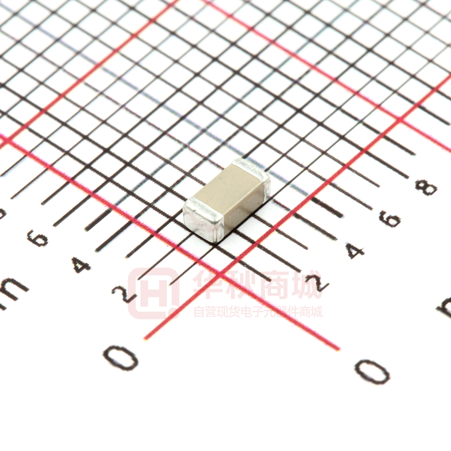

    贴片电容(MLCC) 1808 1nF ±20% 2KV X7R
CC1808MKX7RDBB102 数据手册
DATA SHEET SURFACE-MOUNT CERAMIC MULTILAYER CAPACITORS High-Voltage NP0/X7R 1 KV TO 3 KV 10 pF to 33 nF Product Specification – July 13, 2018 V.11 RoHS compliant & Halogen Free Product specification Surface-Mount Ceramic Multilayer Capacitors High-Voltage NP0/X7R SCOPE ORDERING INFORMATION - GLOBAL PART NUMBER, PHYCOMP This specification describes HighVoltage NP0/X7R series chip capacitors with lead-free terminations. CTC & 12NC APPLICATIONS PCs, Hard disk, Game PCs Power supplies LCD panel ADSL, Modem FEATURES Supplied in tape on reel Nickel-barrier end termination RoHS compliant Halogen Free compliant 2 13 1 KV to 3 KV All part numbers are identified by the series, size, tolerance, TC material, packing style, voltage, process code, termination and capacitance value. YAGEO BRAND ordering code GLOBAL PART NUMBER (PREFERRED ) CC XXXX X X XXX X (1) (2) (3) (4) (5) B X XXX (6) (7) (1) SIZE – INCH BASED (METRIC) 0805 (2012) / 1206 (3216) / 1210 (3225) / 1808 (4520) / 1812 (4532) (2) TOLERANCE C = ± 0.25 pF D = ± 0.5 pF G = ± 2% J = ± 5% K = ± 10% M = ± 20% (3) PACKING STYLE R = Paper/PE taping reel; Reel 7 inch K = Blister taping reel; Reel 7 inch P = Paper/PE taping reel; Reel 13 inch F = Blister taping reel; Reel 13 inch C = Bulk case (4) TC MATERIAL NPO X7R (5) RATED VOLTAGE C = 1 KV D = 2 KV S = 2.5KV E = 3 KV (6) PROCESS N = NP0 B = Class 2 MLCC (7) CAPACITANCE VALUE 2 significant digits+number of zeros The 3rd digit signifies the multiplying factor, and letter R is decimal point Example: 121 = 12 x 101 = 120 pF www.yageo.com Jul. 13, 2018 V.11 Product specification Surface-Mount Ceramic Multilayer Capacitors High-Voltage NP0/X7R 3 13 1 KV to 3 KV CONSTRUCTION The capacitor consists of a rectangular block of ceramic dielectric in which a number of interleaved metal electrodes are contained. This structure gives rise to a high capacitance per unit volume. The inner electrodes are connected to the two end terminations and finally covered with a layer of plated tin (NiSn). The terminations are lead-free. A cross section of the structure is shown in Fig.1. Fig. 1 Surface mounted multilayer ceramic capacitor construction DIMENSION OUTLINES Table 1 For outlines see fig. 2 T (MM) L2 / L3 (mm) min. max. L4 (mm) min. TYPE L1 (mm) W (mm) 0805 2.0 ± 0.20 1.25 ± 0.20 0.25 0.75 0.70 1206 3.2 ± 0.30 1.6 ± 0.20 0.25 0.75 1.40 1210 3.2 ± 0.30 2.5 ± 0.20 0.25 0.75 1.40 1808 4.5 ± 0.40 2.0 ± 0.30 0.25 0.75 2.20 1812 4.5 ± 0.40 3.2 ± 0.20 0.25 0.75 2.20 Refer to table 2 to 4 For dimension see Table 1 Fig. 2 Surface mounted multilayer ceramic capacitor dimension www.yageo.com Jul. 13, 2018 V.11 Product specification Surface-Mount Ceramic Multilayer Capacitors CAPACITANCE RANGE & THICKNESS FOR NP0 Table 2 Sizes from 0805 to 1812 0805 1206 1210 CAP. 1 KV 1 KV 2 KV 3 KV 1 KV High-Voltage NP0/X7R 1808 2 KV 1 KV 4 13 1 KV to 3 KV 1812 2 KV 3 KV 1 KV 2 KV 3 KV 10 pF 0.85± 0.1 1.25± 0.2 1.25± 0.2 1.25± 0.2 1.6± 0.2 1.25± 0.2 1.25± 0.2 1.25± 0.2 12 pF 0.85± 0.1 1.25± 0.2 1.25± 0.2 1.25± 0.2 1.6± 0.2 1.25± 0.2 1.25± 0.2 1.25± 0.2 15 pF 0.85± 0.1 1.25± 0.2 1.25± 0.2 1.25± 0.2 1.6± 0.2 1.25± 0.2 1.25± 0.2 1.25± 0.2 18 pF 0.85± 0.1 1.25± 0.2 1.25± 0.2 1.25± 0.2 1.6± 0.2 1.25± 0.2 1.25± 0.2 1.25± 0.2 22 pF 0.85± 0.1 1.25± 0.2 1.25± 0.2 1.25± 0.2 1.6± 0.2 1.25± 0.2 1.25± 0.2 1.25± 0.2 27 pF 0.85± 0.1 1.25± 0.2 1.25± 0.2 1.25± 0.2 1.6± 0.2 1.25± 0.2 1.25± 0.2 1.25± 0.2 33 pF 0.85± 0.1 1.25± 0.2 1.25± 0.2 1.25± 0.2 1.25± 0.2 1.25± 0.2 1.25± 0.2 1.25± 0.2 1.6± 0.2 1.25± 0.2 1.25± 0.2 1.25± 0.2 39 pF 0.85± 0.1 1.25± 0.2 1.25± 0.2 1.25± 0.2 1.25± 0.2 1.25± 0.2 1.25± 0.2 1.25± 0.2 1.6± 0.2 1.25± 0.2 1.25± 0.2 1.25± 0.2 47 pF 0.85± 0.1 1.25± 0.2 1.25± 0.2 1.25± 0.2 1.25± 0.2 1.25± 0.2 1.25± 0.2 1.25± 0.2 1.6± 0.2 1.25± 0.2 1.25± 0.2 1.25± 0.2 56 pF 1.25± 0.2 1.25± 0.2 1.25± 0.2 1.25± 0.2 1.25± 0.2 1.25± 0.2 1.6± 0.2 1.25± 0.2 1.25± 0.2 1.25± 0.2 68 pF 1.25± 0.2 1.25± 0.2 1.25± 0.2 1.25± 0.2 1.25± 0.2 1.25± 0.2 1.6± 0.2 1.25± 0.2 1.25± 0.2 1.25± 0.2 82 pF 1.25± 0.2 1.25± 0.2 1.25± 0.2 1.25± 0.2 1.25± 0.2 1.25± 0.2 1.6± 0.2 1.25± 0.2 1.25± 0.2 1.25± 0.2 100 pF 1.25± 0.2 1.25± 0.2 1.25± 0.2 1.25± 0.2 1.25± 0.2 1.25± 0.2 1.6± 0.2 1.25± 0.2 1.25± 0.2 1.25± 0.2 120 pF 1.25± 0.2 1.25± 0.2 1.25± 0.2 1.25± 0.2 1.25± 0.2 1.25± 0.2 1.25± 0.2 1.25± 0.2 1.25± 0.2 150 pF 1.25± 0.2 1.25± 0.2 1.25± 0.2 1.25± 0.2 1.25± 0.2 1.25± 0.2 1.25± 0.2 1.25± 0.2 1.25± 0.2 180 pF 1.25± 0.2 1.25± 0.2 1.25± 0.2 1.25± 0.2 1.25± 0.2 1.25± 0.2 1.25± 0.2 1.25± 0.2 1.25± 0.2 220 pF 1.25± 0.2 1.25± 0.2 1.25± 0.2 1.25± 0.2 1.25± 0.2 1.25± 0.2 1.25± 0.2 1.25± 0.2 1.25± 0.2 270 pF 1.25± 0.2 1.25± 0.2 1.25± 0.2 1.25± 0.2 1.25± 0.2 1.25± 0.2 330 pF 1.25± 0.2 1.25± 0.2 1.25± 0.2 1.25± 0.2 1.25± 0.2 1.25± 0.2 390 pF 1.25± 0.2 1.25± 0.2 1.25± 0.2 1.25± 0.2 1.25± 0.2 1.25± 0.2 470 pF 1.25± 0.2 1.25± 0.2 1.25± 0.2 1.25± 0.2 1.25± 0.2 1.25± 0.2 560 pF 1.25± 0.2 1.25± 0.2 1.25± 0.2 1.25± 0.2 1.25± 0.2 1.25± 0.2 680 pF 1.25± 0.2 1.25± 0.2 1.25± 0.2 1.25± 0.2 1.25± 0.2 820 pF 1.25± 0.2 1.25± 0.2 1.25± 0.2 1.25± 0.2 1.0 nF 1.25± 0.2 1.25± 0.2 1.25± 0.2 1.25± 0.2 1.2 nF 1.25± 0.2 1.5 nF 1.25± 0.2 1.8 nF 2.2 nF 2.7 nF 3.3 nF NOTE 1. Values in shaded cells indicate thickness class in mm 2. Capacitance value of non E-12 series is on request www.yageo.com Jul. 13, 2018 V.11 Product specification Surface-Mount Ceramic Multilayer Capacitors High-Voltage NP0/X7R 5 13 1 KV to 3 KV CAPACITANCE RANGE & THICKNESS FOR X7R Table 3 Sizes from 0805 to 1812 CAP. 0805 1206 1 KV 1 KV 1808 1210 2 KV 2.5KV 1 KV 2 KV 1 KV 1812 2 KV 3 KV 1 KV 2 KV 3 KV 100 pF 150 pF 0.85± 0.1 1.6± 0.2 220 pF 0.85± 0.1 1.25± 0.2 1.25± 0.2 1.25± 0.2 1.25± 0.2 1.6± 0.2 330 pF 0.85± 0.1 1.25± 0.2 1.25± 0.2 1.25± 0.2 1.25± 0.2 1.35± 0.15 1.6± 0.2 470 pF 0.85± 0.1 1.25± 0.2 1.25± 0.2 1.25± 0.2 1.25± 0.2 1.35± 0.15 1.35± 0.15 1.6± 0.2 680 pF 0.85± 0.1 1.25± 0.2 1.25± 0.2 1.25± 0.2 1.25± 0.2 1.35± 0.15 1.35± 0.15 1.6± 0.2 1.0 nF 0.85± 0.1 1.25± 0.2 1.25± 0.2 1.6± 0.2 1.25± 0.2 1.25± 0.2 1.35± 0.15 1.35± 0.15 2.0± 0.2 1.35± 0.15 1.35± 0.15 1.6± 0.2 1.5 nF 1.25± 0.2 1.25± 0.2 1.25± 0.2 1.25± 0.2 1.35± 0.15 1.35± 0.15 2.0± 0.2 1.35± 0.15 1.35± 0.15 2.2 nF 1.25± 0.2 1.25± 0.2 1.60± 0.2 1.35± 0.15 3.3 nF 1.25± 0.2 1.25± 0.2 1.35± 0.15 1.35± 0.15 1.35± 0.15 4.7 nF 1.25± 0.2 1.25± 0.2 1.35± 0.15 1.35± 0.15 1.35± 0.15 6.8 nF 1.25± 0.2 1.25± 0.2 1.6± 0.2 1.35± 0.15 10 nF 1.25± 0.2 1.25± 0.2 1.6± 0.2 1.35± 0.15 1.6± 0.2 1.35± 0.15 1.35± 0.15 15 nF 1.25± 0.2 1.35± 0.15 22 nF 1.6± 0.2 1.35± 0.15 33 nF 1.6± 0.2 47 nF 68 nF 100 nF NOTE 1. Values in shaded cells indicate thickness class in mm 2. Capacitance value of non E-6 series is on request 3. For products with 5% tolerance, please contact local sales force before ordering www.yageo.com Jul. 13, 2018 V.11 Product specification Surface-Mount Ceramic Multilayer Capacitors High-Voltage NP0/X7R 1 KV to 3 KV 6 13 THICKNESS CLASSES AND PACKING QUANTITY Table 5 SIZE CODE Ø 180 MM / 7 INCH Paper Blister Ø 330 MM / 13 INCH Paper Blister THICKNESS CLASSIFICATION TAPE WIDTH QUANTITY PER REEL 0201 0.3 ± 0.03 mm 8 mm 15,000 --- 50,000 --- --- 0402 0.5 ± 0.05 mm 8 mm 10,000 --- 50,000 --- 50,000 0603 0.8 ± 0.1 mm 8 mm 4,000 --- 15,000 --- 15,000 0.6 ± 0.1 mm 8 mm 4,000 --- 20,000 --- 10,000 0.8 / 0.85 ± 0.1 mm 8 mm 4,000 --- 15,000 --- 8,000 1.00 ± 0.1 mm 8 mm --- 3,000 --- 10,000 --- 1.25 ± 0.2 mm 8 mm --- 3,000 --- 10,000 5,000 0.6 ± 0.1 mm 8 mm 4,000 --- 20,000 --- --- 0.8 / 0.85 ± 0.1 mm 8 mm 4,000 --- 15,000 --- --- 1.00 / 1.15 ± 0.1 mm 8 mm --- 3,000 --- 10,000 --- 1.25 ± 0.2 mm 8 mm --- 3,000 --- 10,000 --- 1.6 ± 0.15 mm 8 mm --- 2,500 --- 10,000 --- 1.6 ± 0.2 mm 8 mm --- 2,000 --- 8,000 --- 0.6 / 0.7 ± 0.1 mm 8 mm --- 4,000 --- 15,000 --- 0.85 ± 0.1 mm 8 mm --- 4,000 --- 10,000 --- 1.15 ± 0.1 mm 8 mm --- 3,000 --- 10,000 --- 1.15 ± 0.15 mm 8 mm --- 3,000 --- 10,000 --- 1.25 ± 0.2 mm 8 mm --- 3,000 --- --- --- 1.5 ± 0.1 mm 8 mm --- 2,000 --- --- --- 1.6 / 1.9 ± 0.2 mm 8 mm --- 2,000 --- --- --- --- --- --- 0805 1206 1210 QUANTITY PER BULK CASE 2.0 ± 0.2 mm 8 mm --- 2,000 1,000 2.5 ± 0.2 mm 8 mm --- 1,000 500 --- --- --- 1.15 ± 0.15 mm 12 mm --- 3,000 --- --- --- 1.25 ± 0.2 mm 12 mm --- 3,000 --- --- --- 1.35 ± 0.15 mm 12 mm --- 2,000 --- --- --- 1.5 ± 0.1 mm 12 mm --- 2,000 --- --- --- 1.6 ± 0.2 mm 12 mm --- 2,000 --- --- --- 2.0 ± 0.2 mm 12 mm --- 2,000 --- --- --- 0.6 / 0.85 ± 0.1 mm 12 mm --- 2,000 --- --- --- 1.15 ± 0.1 mm 12 mm --- 1,000 --- --- --- 1.15 ± 0.15 mm 12 mm --- 1,000 --- --- --- 1808 1812 1.25 ± 0.2 mm 12 mm --- 1,000 --- --- --- 1.35 ± 0.15 mm 12 mm --- 1,000 --- --- --- 1.5 ± 0.1 mm 12 mm --- 1,000 --- --- --- 1.6 ± 0.2 mm 12 mm --- 1,000 --- --- --- 2.0 ± 0.2 mm 12 mm --- 1,000 --- --- --- 2.5 ± 0.2 mm 12 mm --- 500 --- --- --- www.yageo.com Jul. 13, 2018 V.11 Product specification Surface-Mount Ceramic Multilayer Capacitors High-Voltage NP0/X7R 7 13 1 KV to 3 KV ELECTRICAL CHARACTERISTICS NP0/X7R DIELECTRIC CAPACITORS; NISN TERMINATIONS Unless otherwise stated all electrical values apply at an ambient temperature of 20± 1 °C, an atmospheric pressure of 86 to 106 kPa, and a relative humidity of 63 to 67%. Table 6 VALUE DESCRIPTION Capacitance range 10 pF to 33 nF Capacitance tolerance NP0 C < 10 pF ± 0.25 pF, ± 0.5 pF C ≥ 10 pF ± 2%, ± 5% X7R ± 5% (1), ± 10% Dissipation factor (D.F.) NP0 C < 30 pF ≤ 1 / ( 400 + 20C ) C ≥ 30 pF ≤ 0.1 % X7R Insulation resistance after 1 minute at Ur (DC) ≤ 2.5 % Rins ≥ 10 GΩ or Rins × C ≥ 500 seconds whichever is less Maximum capacitance change as a function of temperature (temperature characteristic/coefficient): NP0 ± 30 ppm/°C X7R ± 15% Operating temperature range: NP0/X7R –55 °C to +125 °C NOTE 1. ±5% tolerance of capacitance value isn't available for X7R full product range, please contact local sales force before ordering www.yageo.com Jul. 13, 2018 V.11 Product specification Surface-Mount Ceramic Multilayer Capacitors High-Voltage NP0/X7R 8 13 1 KV to 3 KV H IGH -VOLTAGE NP0 Sample limits (broken lines). Requirement levels (dotted lines) Fig. 3 Typical temperature coefficient as a function of temperature Fig. 4 Typical tan δ as a function of temperature H IGH -VOLTAGE X7R  X Fig. 5 Typical capacitance change as a function of temperature Fig. 6 Typical tan δ as a function of temperature www.yageo.com Jul. 13, 2018 V.11 Product specification Surface-Mount Ceramic Multilayer Capacitors High-Voltage NP0/X7R 9 13 1 KV to 3 KV SOLDERING RECOMMENDATION Table 7 SOLDERING METHOD Reflow SIZE 0402 0603 0805 1206 ≥ 1210 Reflow only ≥ 1.0 µF ≥ 2.2 µF ≥ 4.7 µF Reflow only --- < 1.0 µF < 2.2 µF < 4.7 µF --- Reflow/Wave TESTS AND REQUIREMENTS Table 8 Test procedures and requirements TEST TEST METHOD PROCEDURE REQUIREMENTS Mounting IEC 6038421/22 4.3 The capacitors may be mounted on printed-circuit boards or ceramic substrates No visible damage Visual Inspection and Dimension Check 4.4 Any applicable method using × 10 magnification In accordance with specification Capacitance 4.5.1 Class 1: f = 1 MHz for C ≤ 1 nF, measuring at voltage 1 Vrms at 20 °C Within specified tolerance f = 1 KHz for C > 1 nF, measuring at voltage 1 Vrms at 20 °C Class 2: f = 1 KHz for C ≤ 10 µF, measuring at voltage 1 Vrms at 20 °C Dissipation Factor (D.F.) 4.5.2 Class 1: f = 1 MHz for C ≤ 1 nF , measuring at voltage 1 Vrms at 20 °C In accordance with specification f = 1 KHz for C > 1 nF, measuring at voltage 1 Vrms at 20 °C Class 2: f = 1 KHz for C ≤ 10 µF, measuring at voltage 1 Vrms at 20 °C Insulation Resistance 4.5.3 Ur ≤ 500 V: At Ur for 1 minute In accordance with specification Ur > 500 V: At 500 V for 1 minute www.yageo.com Jul. 13, 2018 V.11 Product specification Surface-Mount Ceramic Multilayer Capacitors TEST TEST METHOD Temperature Coefficient 4.6 High-Voltage NP0/X7R 1 KV to 3 KV PROCEDURE REQUIREMENTS Capacitance shall be measured by the steps shown in the following table. Class1: ∆ C/C: ± 30ppm The capacitance change should be measured after 5 min at each specified temperature stage. Step Temperature(℃) a 25± 2 b Lower temperature± 3℃ c 25± 2 d Upper Temperature± 2℃ e 25± 2 10 13 Class2: X7R: ∆ C/C: ±15% Y5V: ∆ C/C: 22~-82% Class2: X7R/X5R: ∆ C/C: ±15% Y5V: ∆ C/C: 22~-82% (1) Class I Temperature Coefficient shall be calculated from the formula as below C2 - C1 106 [ppm/℃] Temp, Coefficient = C1 xΔT C1: Capacitance at step c C2: Capacitance at 125℃ ∆T: 100℃(=125℃-25℃) (2) Class II Capacitance Change shall be calculated from the formula as below C2 - C1 ∆C = x 100% C1 C1: Capacitance at step c C2: Capacitance at step b or d Adhesion Bending Strength IEC 6038421/22 4.7 A force applied for 10 seconds to the line joining the terminations and in a plane parallel to the substrate Force size ≥ 0603: 5N 4.8 Mounting in accordance with IEC 60384-22 paragraph 4.3 No visible damage Conditions: bending 1 mm at a rate of 1 mm/s, radius jig 5 mm ∆C/C Class 1: NP0: within ± 1% or 0.5 pF, whichever is greater Class2: X7R: ± 10% www.yageo.com Jul. 13, 2018 V.11 Product specification Surface-Mount Ceramic Multilayer Capacitors TEST Resistance to Soldering Heat TEST METHOD 4.9 High-Voltage NP0/X7R PROCEDURE REQUIREMENTS Precondition: 150 +0/–10 °C for 1 hour, then keep for 24 ± 1 hours at room temperature Dissolution of the end face plating shall not exceed 25% of the length of the edge concerned Preheating: for size ≤ 1206: 120 °C to 150 °C for 1 minute Preheating: for size >1206: 100 °C to 120 °C for 1 minute and 170 °C to 200 °C for 1 minute Solder bath temperature: 260 ± 5 °C Dipping time: 10 ± 0.5 seconds Recovery time: 24 ± 2 hours 11 13 1 KV to 3 KV ∆C/C Class 1: NP0: within ± 0.5% or 0.5 pF, whichever is greater Class2: X7R: ± 10% D.F. within initial specified value Rins within initial specified value Solderability 4.10 Preheated to a temperature of 80 °C to 140 °C and maintained for 30 seconds to 60 seconds. The solder should cover over 95% of the critical area of each termination 1. Temperature: 235± 5°C / Dipping time: 2 ± 0.5 s 2. Temperature: 245± 5°C / Dipping time: 3 ± 0.5 s (lead free)Depth of immersion: 10mm Rapid Change of Temperature IEC 6038421/22 4.11 Preconditioning; 150 +0/–10 °C for 1 hour, then keep for 24 ± 1 hours at room temperature 5 cycles with following detail: 30 minutes at lower category temperature 30 minutes at upper category temperature Recovery time 24 ± 2 hours No visual damage ∆C/C Class 1: NP0: within ± 1% or 1 pF, whichever is greater Class2: X7R: ± 15% D.F. meet initial specified value Rins meet initial specified value Damp Heat 4.13 1. Preconditioning, class 2 only: 150 +0/-10 °C /1 hour, then keep for 24 ± 1 hour at room temp 2. Initial measure: Spec: refer to initial spec C, D, IR 3. Damp heat test: 500 ± 12 hours at 40 ± 2 °C; 90 to 95% R.H. 4. Recovery: Class 1: 6 to 24 hours Class 2: 24 ± 2 hours 5. Final measure: C, D, IR P.S. If the capacitance value is less than the minimum value permitted, then after the other measurements have been made the capacitor shall be preconditioned according to “IEC 60384 4.1” and then the requirement shall be met. No visual damage after recovery ∆C/C Class 1: NP0: within ± 2% or 1 pF, whichever is greater Class2: X7R: ± 15% D.F. Class 1: NP0: ≤ 2 x specified value Class2: X7R: ≥ 25 V: ≤ 5% Rins Class 1: NP0: ≥ 2,500 MΩ or Rins x Cr ≥ 25s whichever is less Class2: X7R: ≥ 500 MΩ or Rins x Cr ≥ 25s whichever is less www.yageo.com Jul. 13, 2018 V.11 Product specification Surface-Mount Ceramic Multilayer Capacitors High-Voltage NP0/X7R TEST TEST METHOD PROCEDURE REQUIREMENTS Endurance IEC 6038421/22 1. Preconditioning, class 2 only: No visual damage 4.14 150 +0/-10 °C /1 hour, then keep for 24 ± 1 hour at room temp 2. Initial measure: Spec: refer to initial spec C, D, IR ∆C/C Class1: NP0: within ± 2% or 1 pF, whichever is greater Endurance test: Temperature: NP0/X7R: 125 °C Specified stress voltage applied for 1,000 hours. High-Voltage series follows the stress conditions below: Class2: X7R: ± 15% Voltage NPO X7R ≤ 100V 2.0 x Ur 2.0 x Ur Class2: X7R: ≥ 25 V: ≤ 5% 200/250V 1.5 x Ur 1.5 x Ur Rins 500/630V 1.3 x Ur 1.2 x Ur ≥ 1KV 1.2 x Ur 1.1 x Ur Class1: NP0: ≥ 4,000 MΩ or Rins x Cr ≥ 40s whichever is less 3. Recovery time: 24 ± 2 hours 4. Final measure: C, D, IR 12 13 1 KV to 3 KV D.F. Class1: NP0: ≤ 2 x specified value Class2: X7R: ≥ 1,000 MΩ or Rins x Cr ≥ 50s whichever is less P.S. If the capacitance value is less than the minimum value permitted, then after the other measurements have been made the capacitor shall be preconditioned according to “IEC 60384 4.1” and then the requirement shall be met. Voltage Proof Specified stress voltage applied for 1~5 seconds No breakdown or flashover Ur ≤ 100 V: series applied 2.5 Ur 100 V < Ur ≤ 200 V series applied (1.5 Ur + 100) 200 V < Ur ≤ 500 V series applied (1.3 Ur + 100) Ur > 500 V: 1.3 Ur Ur ≥ 1KV: 1.2 Ur Charge/Discharge current less than 50mA www.yageo.com Jul. 13, 2018 V.11 Product specification Surface-Mount Ceramic Multilayer Capacitors High-Voltage NP0/X7R 13 13 1 KV to 3 KV REVISION HISTORY REVISION DATE CHANGE NOTIFICATION DESCRIPTION Version 11 Jul. 13, 2018 - - Add NPO/1206/10pF to 47pF/3KV Version 10 Mar. 7, 2017 - - 0805 L4 spec updated Version 9 Jan. 16, 2017 - - Product range updated Version 8 Oct. 12, 2015 - - Product range updated Version 7 May 21, 2014 - - Product range updated Version 6 Jun. 17, 2012 - - Product range updated Version 5 Sep 25, 2012 - - Product range updated Version 4 Aug 08, 2011 - - Product range updated Version 3 Jan 19, 2011 - - Dimension updated - Add NP0 0805 1KV Version 2 Feb 02, 2010 - - Change to dual brand datasheet that describe High-Voltage NP0/X7R series with RoHS compliant - Replace the high voltage part of pdf files: UP-NP0X7R_HV_1K-to-4KV_1 and UY-NP0X7R_HV_1K-to-4KV_1 - Description of "Halogen Free compliant" added - Product range updated - Define global part number - Test method and procedure updated Version 1 Sep 30, 2005 - - Thickness revised Version 0 Sep 12, 2005 - - New www.yageo.com Jul. 13, 2018 V.11
