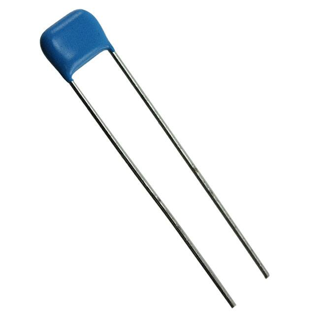

    贴片电容(MLCC) Radial 15µF ±20% 16V Y5U
KHD160E156M43A0B00 数据手册
DIPPED RADIAL LEAD MULTILAYER CERAMIC CAPACITORS RoHS Compliant ?FEATURES 1. Small size and large capacitance, high ripple current. 2. Temperature characteristic is Y5U in EIA code. 3. Superior humidity characteristic and long life. 4. Excellent noise absorption. 5. Resin(UL94 V-0) used for coating. ?APPLICATIONS 1. Automotive equipments. 2. Smoothing circuit of switching mode AC-DC or DC-DC converter. 3. Noise suppressor for various kinds of equipments. 4. By-pass or decoupling circuits. ?CONSTRUCTION Coating Resin Ceramic Dielectric Termination Solder (Pb-free) Internal Electrode Lead Wire ?RATINGS 1. 2. 3. 4. 5. 6. Category Temperature Range Rated Voltage Range Rated Capacitance Range Rated Capacitance Tolerance Temperature Characteristics Rated Ripple Current -55 to +125C 16, 25, 50, 100, 250 Vdc 0.1 to 680MF 80 M(P20%), Z(P20 %) E(JIS) Y5U(EIA) See No.5 on the following table ?SPECIFICATIONS No. 1 Items Withstand Voltage Between Terminals Specification Test Condition No abnormality. 250% of rated voltage shall be applied for 5 seconds. Terminals to Coating Resin 2 Insulation Resistance 1000/CR(MO) or 10000(MO) whichever is less. Rated voltage shall be applied for 60P5 seconds at temperature 20P2C. 3 Rated Capacitance Within specified tolerance. Temperature Frequency Voltage : 20P2C : 1P0.1kHz(]100MF,120Hz) : 1P0.2Vrms 4 Dissipation Factor 5.0% maximum. Temperature Frequency Voltage : 20P2C : 1P0.1kHz(]100MF,120Hz) : 1P0.2Vrms (1/3) CAT. No. E1002O DIPPED RADIAL LEAD MULTILAYER CERAMIC CAPACITORS ?SPECIFICATIONS No. Items Specification 5 Rated Ripple Current 6 Robustness Tension of Terminations Size code 32 43 55 76 80 90 99 Arms 0.3 0.8 1.0 1.5 2.0 3.0 4.0 No visible damage. Test Condition 10kHz to 1MHz (sine curve) Ripple voltage Vp shall be less than the rated voltage. The force applied shall be : Bending Lead F (mm) 0.5 max. 0.6 to 0.8 max. Tensile(N) 5 10 (sec.) 10P1 10P1 Lead F (mm) 0.5 max. 0.6 to 0.8 max. Time : 2times. Bending(N) 2.5 5 (kg) 0.25 0.51 7 Vibration Appearance : No abnormality. Capacitance : To meet the initial specification. D.F. : To meet the initial specifications. 8 Solderability Min. 75% of surface of the termination shall be covered with new solder. 9 Resistance to Soldering Heat Appearance : No abnormality. DC/C : P15% D.F. : Satisfy the initial spec. 10 Temperature Cycle Appearance : No abnormality. DC/C : P15% D.F. : To meet the initial specification I.R. : To meet the initial specification 11 Humidity Load Life Appearance : No abnormality. DC/C : P20% D.F. : 7% maximum I.R. : 50/CR(MO) or 1000(MO) whichever is less. Temperature : 40P2C Humidity : 90 to 95%RH Voltage : Rated voltage Time : 500P24 hours 0 12 Endurance Appearance : No abnormality. DC/C : P20% D.F. : 7% maximum I.R. : 100/CR(MO) or 1000(MO) whichever is less. Temperature : 85P2C Voltage : 200% of rated voltage. Time : 1000P48 0 hours Amplitude : 1.5mm Frequency range : 10-55-10Hz (1 min) Direction and time : 2 hours each to X, Y, Z axis. Total 6 hours. Solder Solder Temperature Dipping Time Pb Free Eutectic 245P5C 235P5C 2P0.5sec. Solder Temperature : 350P10C Dipping Time : 3P0.5 sec. Depth : 1.5 to 2mm Temperature (C) Step Min. Category temperature P3 1 Room temperature 2 3 Max. Category temperature P3 4 Room temperature For 5 cycles for above temperature cycle. (min.) 30P3 3 max. 30P3 3 max. Temperature : 125P3C Voltage : Rated voltage Time : 1000P48 0 hours *CR : Rated Capacitance(MF) ?PART NUMBERING SYSTEM 3 4 5 6 7 8 9 10 11 12 13 14 15 ?DIMENSIONS 16 17 18 Crimped lead 32K76 size (2/3) L T W L F 15min. Supplement code Taping code Terminal code Size code Capacitance tolerance code Nominal Capacitance code Temperature characteristics code Rated voltage code Series code Category Straight lead For all size T W 2 F d 15min. 1 K HD 5 0 0 E 1 0 6 M 5 5 A 0 T 0 0 d CAT. No. E1002O DIPPED RADIAL LEAD MULTILAYER CERAMIC CAPACITORS ?THD SERIES STANDARD RATINGS Rated voltage Rated Capacitance (Vdc) (mF) 16 25 50 100 250 6.8 10 15 22 33 47 68 100 150 220 330 470 680 3.3 4.7 6.8 10 15 22 33 47 68 100 150 220 330 470 1.0 1.5 2.2 3.3 4.7 6.8 10 15 22 33 47 68 100 150 220 0.33 0.47 0.68 1.0 1.5 2.2 3.3 4.7 6.8 10 15 22 33 47 68 100 0.1 0.15 0.22 0.33 0.47 0.68 1.0 1.5 2.2 3.3 4.7 6.8 10 15 Dimensions (mm) Maximum ripple current (Arms) Lmax. Wmax. Tmax. FP0.8 FdP0.05 5.0 6.5 3.5 5.0 0.5 0.3 6.5 7.5 4.0 5.0 0.5 0.8 8.0 9.0 4.5 5.0 0.5 1.0 10.0 11.5 4.5 5.0 0.5 1.5 13.5 15.0 5.0 5.5 10.0 0.6 2.0 22.5 20.0 6 20.0 0.8 3.0 28.5 20.0 25.0 0.8 4.0 5.0 6.5 7.5 3.0 3.5 5.0 0.5 0.3 6.5 7.0 5.0 0.5 0.8 5.0 0.5 1.0 5.0 0.5 1.5 10.0 0.6 2.0 3.5 4.0 4.0 4.5 4.5 5.0 5.5 7.5 9.0 10.0 11.5 13.5 15.0 22.5 20.0 6.0 20.0 0.8 3.0 28.5 20.0 7.5 25.0 0.8 4.0 5.0 6.5 5.0 0.5 0.3 5.0 0.5 0.8 6.5 7.0 7.5 9.0 3.0 3.5 3.5 4.0 4.0 5.0 0.5 1.0 5.0 10.0 0.5 0.6 1.5 2.0 10.0 13.5 11.5 15.0 4.5 4.5 5.0 22.5 20.0 6.0 20.0 0.8 3.0 28.5 20.0 7.5 25.0 0.8 4.0 5.0 6.5 5.0 0.5 0.3 3.0 3.5 6.5 7.0 3.5 5.0 0.5 0.8 5.0 0.5 1.0 5.0 0.5 1.5 7.5 9.0 10.0 11.5 4.0 4.0 4.5 4.5 13.5 15.0 5.0 10.0 0.6 2.0 22.5 20.0 6.0 20.0 0.8 3.0 28.5 20.0 7.5 25.0 0.8 4.0 6.5 7.0 5.0 0.5 0.8 5.0 0.5 1.0 3.5 4.0 4.0 4.5 7.5 9.0 10.0 11.5 4.5 5.0 0.5 1.5 13.5 15.0 5.0 10.0 0.6 2.0 22.5 20.0 6.0 20.0 0.8 3.0 28.5 20.0 7.5 25.0 0.8 4.0 (3/3) Part Number Previous Part Number KHD160E685M32A0T00 KHD160E106M32A0T00 KHD160E156M43A0T00 KHD160E226M43A0T00 KHD160E336M55A0T00 KHD160E476M55A0T00 KHD160E686M76A0T00 KHD160E107M76A0T00 KHD160E157M80A0B00 KHD160E227M80A0B00 KHD160E337M90C0B00 KHD160E477M90C0B00 KHD160E687M99C0B00 KHD250E335M32A0T00 KHD250E475M32A0T00 KHD250E685M43A0T00 KHD250E106M43A0T00 KHD250E156M43A0T00 KHD250E226M55A0T00 KHD250E336M55A0T00 KHD250E476M76A0T00 KHD250E686M80A0B00 KHD250E107M80A0B00 KHD250E157M90C0B00 KHD250E227M90C0B00 KHD250E337M99C0B00 KHD250E477M99C0B00 KHD500E105M32A0T00 KHD500E155M32A0T00 KHD500E225M32A0T00 KHD500E335M43A0T00 KHD500E475M43A0T00 KHD500E685M55A0T00 KHD500E106M55A0T00 KHD500E156M55A0T00 KHD500E226M76A0T00 KHD500E336M80A0B00 KHD500E476M90C0B00 KHD500E686M90C0B00 KHD500E107M90C0B00 KHD500E157M99C0B00 KHD500E227M99C0B00 KHD101E334M32A0T00 KHD101E474M32A0T00 KHD101E684M32A0T00 KHD101E105M43A0T00 KHD101E155M43A0T00 KHD101E225M43A0T00 KHD101E335M55A0T00 KHD101E475M55A0T00 KHD101E685M76A0T00 KHD101E106M80A0B00 KHD101E156M80A0B00 KHD101E226M90C0B00 KHD101E336M90C0B00 KHD101E476M99C0B00 KHD101E686M99C0B00 KHD101E107M99C0B00 KHD251E104M43A0T00 KHD251E154M43A0T00 KHD251E224M43A0T00 KHD251E334M43A0T00 KHD251E474M55A0T00 KHD251E684M55A0T00 KHD251E105M76A0T00 KHD251E155M76A0T00 KHD251E225M80A0B00 KHD251E335M90C0B00 KHD251E475M90C0B00 KHD251E685M99C0B00 KHD251E106M99C0B00 KHD251E156M99C0B00 THD21E1C685MT THD21E1C106MT THD30E1C156MT THD30E1C226MT THD31E1C336MT THD31E1C476MT THD41E1C686MT THD41E1C107MT THD51E1C157M THD51E1C227M THD60E1C337M THD60E1C477M THD61E1C687M THD21E1E335MT THD21E1E475MT THD30E1E685MT THD30E1E106MT THD30E1E156MT THD31E1E226MT THD31E1E336MT THD41E1E476MT THD51E1E686M THD51E1E107M THD60E1E157M THD60E1E227M THD61E1E337M THD61E1E477M THD21E1H105MT THD21E1H155MT THD21E1H225MT THD30E1H335MT THD30E1H475MT THD31E1H685MT THD31E1H106MT THD31E1H156MT THD41E1H226MT THD51E1H336M THD60E1H476M THD60E1H686M THD60E1H107M THD61E1H157M THD61E1H227M THD21E2A334MT THD21E2A474MT THD21E2A684MT THD30E2A105MT THD30E2A155MT THD30E2A225MT THD31E2A335MT THD31E2A475MT THD41E2A685MT THD51E2A106M THD51E2A156M THD60E2A226M THD60E2A336M THD61E2A476M THD61E2A686M THD61E2A107M THD30E2E104MT THD30E2E154MT THD30E2E224MT THD30E2E334MT THD31E2E474MT THD31E2E684MT THD41E2E105MT THD41E2E155MT THD51E2E225M THD60E2E335M THD60E2E475M THD61E2E685M THD61E2E106M THD61E2E156M (Just for your reference) CAT. No. E1002O
