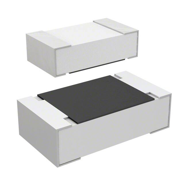

    电阻器 62Ω ±5% 1/10W ±200ppm/℃ 0603
RPC0603JT62R0 数据手册
RPC Series Stackpole Electronics, Inc. Pulse Withstanding Thick Film Chip Resistor Resistive Product Solutions Features: • • • • • • • • Excellent pulse withstanding performance Broad resistance range Higher anti-surge performance compared with RMCF Series Standard power RPC, 5% and wider tolerances, are untrimmed 1% and wider tolerances are qualified to AEC-Q200 RoHS compliant and halogen free REACH compliant Lower values may be available – contact Stackpole Electrical Specifications Power Rating (W) @ 70ºC Type/Code RPC0402 0.2 Maximum Working Voltage (V) Maximum Overload Voltage (V) 50 100 0.5% - 1% ±300 ±100 100 - 1M 20.5 - 1M ±200 ±100 ±200 RPC0805 0.25 150 300 ±100 ±200 RPC1206 0.33 200 400 ±100 ±200 RPC1210 0.5 200 400 ±100 ±200 RPC2010 0.75 400 800 ±100 ±200 RPC2512 1.5 500 1000 ±100 Working Voltage = √ P*R or Max. Working Voltage listed above, whichever is lower. Overload Voltage = 2.5* √ P*R or Max. Overload Voltage listed above, whichever is lower. RPC0603 0.1 50 Ohmic Range (Ω) and Tolerance TCR (ppm/ºC) 100 10 - 294 5%, 10%, 20% 1 - 20 22 - 1M 1 - 294 300 - 1M 1 - 294 300 - 20M 10 - 294 10 - 20 10 - 270 1 - 270 1 - 20 20.5 - 20M 22 - 20M 10 - 20 1 - 20 20.5 - 20M 22 - 20M 10 - 20 1 - 20 20.5 - 20M 22 - 20M 10 - 20 1 - 20 20.5 - 20M 22 - 20M Electrical Specifications – High Power (HP) Power Rating (W) @ 70ºC Type/Code Maximum Working Voltage (V) Maximum Overload Voltage (V) RPC0603_-HP 0.25 75 150 RPC0805_-HP 0.4 150 300 RPC1206_-HP 0.5 200 400 RPC1210_-HP 0.75 RPC2010_-HP RPC2512_-HP (*) 1 2 200 400 500 Ohmic Range (Ω) and Tolerance TCR (ppm/ºC) ±200 ±100 ±200 ±100 ±200 ±100 ±200 ±100 ±200 ±100 ±350 ±100 400 800 1000 0.5% 10 - 294 10 - 294 1% 1 - 294 300 - 1M 1 - 294 300 - 1M 10 - 20 5% 10 - 270 1 - 270 1 - 20 20.5 - 1M 22 - 1M 1 - 20 10 - 20 20.5 - 1M 22 - 1M 1 - 20 10 - 20 20.5 - 1M 22 - 1M 1 - 10 10 10.5 - 200K (*) Double-sided printed resistor element. Working Voltage = √ P*R or Max. Working Voltage listed above, whichever is lower. Overload Voltage = 2.5* √ P*R or Max. Overload Voltage listed above, whichever is lower. Rev Date: 9/29/2021 This specification may be changed at any time without prior notice. Please confirm technical specifications before you order and/or use. 1 www.seielect.com marketing@seielect.com RPC Series Stackpole Electronics, Inc. Pulse Withstanding Thick Film Chip Resistor Resistive Product Solutions Electrical Specifications – Ultra High Power (UP) Type/Code Power Rating (W) @ 70ºC Maximum Working Voltage (V) Maximum Overload Voltage (V) RPC0805_-UP 0.5 400 600 RPC1206_-UP 0.75 500 1000 Ohmic Range (Ω) and Tolerance TCR (ppm/ºC) ±200 ±100 ±200 ±100 0.5% 10 - 294 1% 1 - 294 300 - 1M 10 - 20 5% 1 - 270 1 - 20 20.5 - 1M 22 - 1M Ultra High Power: double side printed resistor element. Working Voltage = √ P*R or Max. Working Voltage listed above, whichever is lower. Overload Voltage = 2.5* √ P*R or Max. Overload Voltage listed above, whichever is lower. Electrical Specifications – Ultra High Power Jumper Maximum Maximum Working Overload Voltage (V) Voltage (V) RPC0805_-UP 6 400 600 RPC1206_-UP 10 500 1000 RPC0603-UP zero ohm jumper with 5A current rating also available. Ultra High Power: double side printed resistor element. Working Voltage = √ P*R or Max. Working Voltage listed above, whichever is lower. Overload Voltage = 2.5* √ P*R or Max. Overload Voltage listed above, whichever is lower. Jumper Rated Current (A) Type/Code Ohmic Range (Ω) and Tolerance 0.5%, 1%, 5% 0.005 max. Mechanical Specifications Type/Code Weight (g) (1000 pcs) RPC0402 0.64 RPC0603 (HP) 2.042 RPC0805 (HP) 4.368 RPC0805_-UP 5.049 RPC1206 (HP) 8.947 RPC1206_-UP 9.541 RPC1210 (HP) 15.959 RPC2010 (HP) 24.241 RPC2512 39.448 RPC2512 (HP) 42 L Body Length 0.039 ± 0.002 1.00 ± 0.05 0.063 ± 0.004 1.60 ± 0.10 0.079 ± 0.004 2.00 ± 0.10 0.079 ± 0.004 2.00 ± 0.10 0.122 ± 0.004 3.10 ± 0.10 0.122 ± 0.004 3.10 ± 0.10 0.122 ± 0.004 3.10 ± 0.10 0.197 ± 0.004 5.00 ± 0.10 0.250 ± 0.004 6.35 ± 0.10 0.250 ± 0.008 6.35 ± 0.20 W Body Width 0.020 ± 0.002 0.50 ± 0.05 0.031 ± 0.004 0.80 ± 0.10 0.049 ± 0.004 1.25 ± 0.10 0.049 ± 0.004 1.25 ± 0.10 0.061 ± 0.004 1.55 ± 0.10 0.061 ± 0.004 1.55 ± 0.10 0.102 ± 0.006 2.60 ± 0.15 0.098 ± 0.006 2.50 ± 0.15 0.122 ± 0.006 3.10 ± 0.15 0.124 ± 0.006 3.15 ± 0.15 Rev Date: 9/29/2021 This specification may be changed at any time without prior notice. Please confirm technical specifications before you order and/or use. 2 H Body Height 0.014 ± 0.002 0.35 ± 0.05 0.018 ± 0.004 0.45 ± 0.10 0.020 ± 0.004 0.50 ± 0.10 0.020 ± 0.004 0.50 ± 0.10 0.022 ± 0.004 0.55 ± 0.10 0.022 ± 0.004 0.55 ± 0.10 0.022 ± 0.004 0.55 ± 0.10 0.022 ± 0.004 0.55 ± 0.10 0.022 ± 0.004 0.55 ± 0.10 0.024 ± 0.004 0.60 ± 0.10 D1 Top Termination 0.008 ± 0.004 0.20 ± 0.10 0.012 ± 0.008 0.30 ± 0.20 0.014 ± 0.008 0.35 ± 0.20 0.014 ± 0.008 0.35 ± 0.20 0.020 ± 0.010 0.50 ± 0.25 0.020 ± 0.010 0.50 ± 0.25 0.020 ± 0.010 0.50 ± 0.25 0.024 ± 0.010 0.60 ± 0.25 0.024 ± 0.010 0.60 ± 0.25 0.024 ± 0.010 0.60 ± 0.25 D2 Bottom Termination 0.008 ± 0.004 0.20 ± 0.10 0.012 ± 0.008 0.30 ± 0.20 0.016 ± 0.008 0.40 ± 0.20 0.016 ± 0.008 0.40 ± 0.20 0.020 ± 0.008 0.50 ± 0.20 0.020 ± 0.008 0.50 ± 0.20 0.020 ± 0.008 0.50 ± 0.20 0.020 ± 0.008 0.50 ± 0.20 0.020 ± 0.008 0.50 ± 0.20 0.020 ± 0.008 0.50 ± 0.20 Unit inches mm inches mm inches mm inches mm inches mm inches mm inches mm inches mm inches mm inches mm www.seielect.com marketing@seielect.com RPC Series Stackpole Electronics, Inc. Pulse Withstanding Thick Film Chip Resistor Resistive Product Solutions Performance Characteristics Item Test Method Test Specification Test Condition Temperature Coefficient of Resistance (T.C.R.) JIS-C-5201-1 4.8 At 25°C / -55°C and 25°C / + 125°C, 25°C Within the specified tolerance IEC-60115-1 4.8 is the reference temperature JIS-C-5201-1 4.13 RCWV * 2.5 or max. overload voltage Short Time Overload ± (1% + 0.05Ω) IEC-60115-1 4.13 whichever is lower for 5 seconds JIS-C-5201-1 4.6 Insulation Resistance ≥ 10G Max. overload voltage for 1 minute IEC-60115-1 4.6 Endurance JIS-C-5201-1 4.25 70ºC ± 2°C, RCWV for 1000 hours ± (1% + 0.05Ω) Tolerances of 0.5%, 1% IEC-60115-1 4.25.1 with 1.5 hours "ON" and 0.5 hour "OFF" Endurance JIS-C-5201-1 4.25 70ºC ± 2°C, RCWV for 1000 hours ± (3% + 0.05Ω) Tolerances of 5%, 10%, 20% IEC-60115-1 4.25.1 with 1.5 hours "ON" and 0.5 hour "OFF" Damp Heat with Load JIS-C-5201-1 4.24 40ºC ± 2°C, 90~95% R.H, RCWV for 1000 hour ± (0.5% + 0.05Ω) Tolerances of 0.5%, 1% IEC-60115-1 4.24 with 1.5 hours "ON" and 0.5 hour "OFF" Damp Heat with Load JIS-C-5201-1 4.24 ± (3% + 0.05Ω) 40ºC ± 2°C, 90~95% R.H, RCWV for 1000 hours Tolerances of 5%, 10%, 20% IEC-60115-1 4.24 with 1.5 hours "ON" and 0.5 hour "OFF" Damp Heat with Load JIS-C-5201-1 4.24 ± (1% + 0.05Ω) Ultra High Power IEC-60115-1 4.24 Dry Heat JIS-C-5201-1 4.23 ± (0.5% + 0.05Ω) At +155°C for 1000 hours Tolerances of 0.5%, 1% IEC-60115-1 2.23.2 Dry Heat JIS-C-5201-1 4.23 ± (3% + 0.05Ω) At +155°C for 1000 hours Tolerances of 5%, 10%, 20% IEC-60115-1 2.23.2 JIS-C-5201-1 4.33 Bending once for 5 seconds Bending Strength ± (1% + 0.05Ω) IEC-60115-1 4.33 2010, 2512 sizes: 2mm; other sizes: 3mm JIS-C-5201-1 4.17 Solderability 95% min. coverage 245ºC ± 5°C for 3 seconds IEC-60115-1 4.17 Resistance to Soldering Heat JIS-C-5201-1 4.18 ± (0.5% + 0.05Ω) 260ºC ± 5°C for 10 seconds tolerances of 0.5%, 1% IEC-60115-1 4.18 Resistance to Soldering Heat JIS-C-5201-1 4.18 ± (1% + 0.05Ω) 260ºC ± 5°C for 10 seconds tolerances of 5%, 10%, 20% IEC-60115-1 4.18 JIS-C-5201-1 4.7 Voltage Proof No Breakdown or flashover 1.42 times max. operating voltage for 1 minute IEC-60115-1 4.7 JIS-C-5201-1 4.18 Individual leaching area ≤ 5% Leaching 260ºC ± 5°C for 30 seconds IEC-60068-2-58-8.2.1 Total leaching area ≤ 10% Rapid Change of Temperature JIS-C-5201-1 4.18 ± (0.5% + 0.05Ω) -55°C to + 150°C , 5 cycles tolerances of 0.5%, 1% IEC-60115-1 4.18 Rapid Change of Temperature JIS-C-5201-1 4.18 ± (1% + 0.05Ω) -55°C to + 150°C , 5 cycles tolerances of 5%, 10%, 20% IEC-60115-1 4.18 RCWV (Rated Continuous Working Voltage)= √ P*R or Max. Working Voltage whichever is lower. Storage Temperature: 15 ~ 28ºC; humidity < 80% R.H. Operating temperature range is - 55°C + 155°C Rev Date: 9/29/2021 This specification may be changed at any time without prior notice. Please confirm technical specifications before you order and/or use. 3 www.seielect.com marketing@seielect.com RPC Series Stackpole Electronics, Inc. Pulse Withstanding Thick Film Chip Resistor Power Derating Curve: Percent Rated Power (%) 100 Resistive Product Solutions -55ºC 70ºC 80 60 40 20 0 -60 155ºC 0 20 40 60 80 100 120 140 160 180 Ambient Temperature (ºC) Soldering Condition: Rev Date: 9/29/2021 This specification may be changed at any time without prior notice. Please confirm technical specifications before you order and/or use. 4 www.seielect.com marketing@seielect.com RPC Series Stackpole Electronics, Inc. Pulse Withstanding Thick Film Chip Resistor Resistive Product Solutions Reel Specifications Type/Code Packaging Tape Width Reel Diameter RPC0402 RPC0603 RPC0805 Paper 8 mm RPC1206 7 inches RPC1210 RPC2010 Embossed 12 mm RPC2512 A 7.028 178.50 7.028 178.50 7.028 178.50 7.028 178.50 7.028 178.50 7.028 178.50 7.028 178.50 ± ± ± ± ± ± ± ± ± ± ± ± ± ± B 0.059 1.50 0.059 1.50 0.059 1.50 0.059 1.50 0.059 1.50 0.059 1.50 0.059 1.50 2.362 60 2.362 60 2.362 60 2.362 60 2.362 60 2.362 60 2.362 60 C +0.039 / -0 +1 / -0 +0.039 / -0 +1 / -0 +0.039 / -0 +1 / -0 +0.039 / -0 +1 / -0 +0.039 / -0 +1 / -0 +0.039 / -0 +1 / -0 +0.039 / -0 +1 / -0 0.512 13.00 0.512 13.00 0.512 13.00 0.512 13.00 0.512 13.00 0.512 13.00 0.512 13.00 ± ± ± ± ± ± ± ± ± ± ± ± ± ± W 0.008 0.20 0.008 0.20 0.008 0.20 0.008 0.20 0.008 0.20 0.020 0.50 0.020 0.50 0.354 9.00 0.354 9.00 0.354 9.00 0.354 9.00 0.354 9.00 0.512 13.00 0.512 13.00 ± ± ± ± ± ± ± ± ± ± ± ± ± ± T 0.020 0.50 0.020 0.50 0.020 0.50 0.020 0.50 0.020 0.50 0.020 0.50 0.020 0.50 0.492 12.50 0.492 12.50 0.492 12.50 0.492 12.50 0.492 12.50 0.610 15.50 0.610 15.50 ± ± ± ± ± ± ± ± ± ± ± ± ± ± Unit 0.020 0.50 0.020 0.50 0.020 0.50 0.020 0.50 0.020 0.50 0.020 0.50 0.020 0.50 inches mm inches mm inches mm inches mm inches mm inches mm inches mm Packaging Specifications - Paper Tape Type/Code RPC0402 RPC0603 RPC0805 RPC1206 RPC1210 A 0.026 0.65 0.043 1.10 0.063 1.60 0.075 1.90 0.114 2.90 ± ± ± ± ± ± ± ± ± ± B 0.004 0.10 0.004 0.10 0.004 0.10 0.004 0.10 0.004 0.10 0.045 1.15 0.075 1.90 0.094 2.40 0.138 3.50 0.138 3.50 ± ± ± ± ± ± ± ± ± ± W 0.004 0.10 0.004 0.10 0.008 0.20 0.008 0.20 0.008 0.20 Rev Date: 9/29/2021 This specification may be changed at any time without prior notice. Please confirm technical specifications before you order and/or use. 0.315 8.00 0.315 8.00 0.315 8.00 0.315 8.00 0.315 8.00 5 ± ± ± ± ± ± ± ± ± ± E 0.008 0.20 0.008 0.20 0.008 0.20 0.008 0.20 0.008 0.20 0.069 1.75 0.069 1.75 0.069 1.75 0.069 1.75 0.069 1.75 ± ± ± ± ± ± ± ± ± ± F 0.004 0.10 0.004 0.10 0.004 0.10 0.004 0.10 0.004 0.10 0.138 3.50 0.138 3.50 0.138 3.50 0.138 3.50 0.138 3.50 ± ± ± ± ± ± ± ± ± ± Unit 0.002 0.05 0.002 0.05 0.002 0.05 0.002 0.05 0.002 0.05 inches mm inches mm inches mm inches mm inches mm www.seielect.com marketing@seielect.com RPC Series Stackpole Electronics, Inc. Pulse Withstanding Thick Film Chip Resistor Resistive Product Solutions Packaging Specifications - Paper Tape (cont.) Type/Code P0 0.157 4.00 0.157 4.00 0.157 4.00 0.157 4.00 0.157 4.00 RPC0402 RPC0603 RPC0805 RPC1206 RPC1210 ± ± ± ± ± ± ± ± ± ± P1 0.004 0.10 0.004 0.10 0.004 0.10 0.004 0.10 0.004 0.10 0.079 2.00 0.157 4.00 0.157 4.00 0.157 4.00 0.157 4.00 ± ± ± ± ± ± ± ± ± ± P2 0.002 0.05 0.002 0.05 0.002 0.05 0.002 0.05 0.002 0.05 0.079 2.00 0.079 2.00 0.079 2.00 0.079 2.00 0.079 2.00 ± ± ± ± ± ± ± ± ± ± ØD0 0.002 0.05 0.002 0.05 0.002 0.05 0.002 0.05 0.002 0.05 0.059 1.50 0.059 1.50 0.059 1.50 0.059 1.50 0.059 1.50 ± ± ± ± ± ± ± ± ± ± 0.004 0.10 0.004 0.10 0.004 0.10 0.004 0.10 0.004 0.10 T 0.018 0.45 0.028 0.70 0.033 0.85 0.033 0.85 0.033 0.85 ± ± ± ± ± ± ± ± ± ± Unit 0.004 0.10 0.004 0.10 0.004 0.10 0.004 0.10 0.004 0.10 inches mm inches mm inches mm inches mm inches mm 0.002 0.05 0.002 0.05 inches mm inches mm Packaging Specifications – Embossed Plastic Tape Type/Code A 0.110 2.80 0.138 3.50 RPC2010 RPC2512 ± ± ± ± B 0.004 0.10 0.004 0.10 0.217 5.50 0.264 6.70 ± ± ± ± W 0.004 0.10 0.004 0.10 0.472 12.00 0.472 12.00 ± ± ± ± E 0.012 0.30 0.012 0.30 0.069 1.75 0.069 1.75 ± ± ± ± F 0.004 0.10 0.004 0.10 0.217 5.50 0.217 5.50 ± ± ± ± Unit Type/Code P0 P1 P2 ØD0 T Unit RPC2010 0.157 ± 0.004 4.00 ± 0.10 0.157 ± 0.004 4.00 ± 0.10 0.079 ± 0.002 2.00 ± 0.05 0.059 ± 0.004 1.50 ± 0.10 0.047 - 0.000 1.20 - 0.00 inches mm RPC2512 0.157 ± 0.004 4.00 ± 0.10 0.157 ± 0.004 4.00 ± 0.10 0.079 ± 0.002 2.00 ± 0.05 0.059 ± 0.004 1.50 ± 0.10 0.047 - 0.000 1.20 - 0.00 inches mm Marking 1. 2. No marking for 0402 3-digit marking for 0603 in E24 3-digit marking for 0603 in E24 Example: 101 = 100 Ω 102 = 1K Ω 101 1st and 2nd digits are E24 code 3rd digit is the multiplier E24 Code 10 11 12 13 15 16 18 20 22 24 27 30 33 36 39 43 47 51 56 62 68 75 82 91 3. 4-digit marking for 0805-2512 Resistance Marking 4-digit marking for 0805-2512 100 Ω 2.2K Ω 10K Ω 100K Ω 1000 2201 1002 1003 Rev Date: 9/29/2021 This specification may be changed at any time without prior notice. Please confirm technical specifications before you order and/or use. 6 1M Ω 1004 www.seielect.com marketing@seielect.com RPC Series Stackpole Electronics, Inc. Pulse Withstanding Thick Film Chip Resistor Resistive Product Solutions Recommended Pad Layout Type/Code RPC0402 RPC0603 RPC0805 RPC1206 RPC1210 RPC2010 RPC2512 a 0.020 0.50 0.035 0.90 0.047 1.20 0.079 2.00 0.079 2.00 0.150 3.80 0.193 4.90 b 0.018 0.45 0.024 0.60 0.028 0.70 0.035 0.90 0.035 0.90 0.035 0.90 0.039 1.00 c 0.024 0.60 0.035 0.90 0.051 1.30 0.063 1.60 0.110 2.80 0.110 2.80 0.134 3.40 Unit inches mm inches mm inches mm inches mm inches mm inches mm inches mm Lightning Surge Resistors are tested in accordance with IEC 60115-1 using both 1.2 / 50 us and 10 / 700 pulse shapes. The limit of acceptance is a shift in resistance of less than 1% from the initial value. 1.2/50us Lightning Surge (*) RPC (Standard Power) tolerances of 0.5% and 1% RPC-HP (High Power) all tolerances RPC-UP (Ultra High Power) all tolerances (*) Note: Data provided shows typical performance and is for reference only. Rev Date: 9/29/2021 This specification may be changed at any time without prior notice. Please confirm technical specifications before you order and/or use. 7 www.seielect.com marketing@seielect.com RPC Series Stackpole Electronics, Inc. Pulse Withstanding Thick Film Chip Resistor Resistive Product Solutions 1.2/50us Lightning Surge (*) RPC (Standard Power) Tolerances of 5%, 10% and 20% 10/700us Lightning Surge (*) RPC (Standard Power) tolerances of 0.5% and 1% RPC-HP (High Power) all tolerances RPC-UP (Ultra High Power) all tolerances (*) Note: Data provided shows typical performance and is for reference only. Rev Date: 9/29/2021 This specification may be changed at any time without prior notice. Please confirm technical specifications before you order and/or use. 8 www.seielect.com marketing@seielect.com RPC Series Stackpole Electronics, Inc. Pulse Withstanding Thick Film Chip Resistor Resistive Product Solutions 10/700us Lightning Surge (*) RPC (Standard Power) Tolerances of 5%, 10% and 20% (*) Note: Data provided shows typical performance and is for reference only. Pulse Withstand Capacity The single impulse graph is the result of 50 impulses of rectangular shape applied at one-minute intervals. The limit of acceptance was a shift in resistance of less than 1% from the initial value. The power applied was subject to the restrictions of the maximum permissible impulse voltage graph shown. Single Pulse Power (100 Ohm) RPC (Standard Power) tolerances of 0.5% and 1% RPC-HP (High Power) all tolerances RPC-UP (Ultra High Power) all tolerances Rev Date: 9/29/2021 This specification may be changed at any time without prior notice. Please confirm technical specifications before you order and/or use. 9 www.seielect.com marketing@seielect.com RPC Series Stackpole Electronics, Inc. Pulse Withstanding Thick Film Chip Resistor Resistive Product Solutions Single Pulse Power (100 Ohm) RPC (Standard Power) Tolerances of 5%, 10% and 20% This data is for the 100 Ω resistance value for each size. Pulse power handling is dependent on the resistance value. For resistance values higher or lower than 100 Ω, contact Stackpole for advice on pulse handling characteristics of your particular resistance value of interest. Continuous Pulse The continuous load graph was obtained by applying repetitive rectangular pulses where the pulse period was adjusted so that the average power dissipated in the resistor was equal to its rated power at 70 ºC. Again, the limit of acceptance was a shift in resistance of less than 1% from the initial value. Continuous Pulse Power (100 Ohm) RPC (Standard Power) tolerances of 0.5% and 1% RPC-HP (High Power) all tolerances RPC-UP (Ultra High Power) all tolerances Rev Date: 9/29/2021 This specification may be changed at any time without prior notice. Please confirm technical specifications before you order and/or use. 10 www.seielect.com marketing@seielect.com RPC Series Stackpole Electronics, Inc. Pulse Withstanding Thick Film Chip Resistor Resistive Product Solutions Continuous Pulse Power (100 Ohm) RPC (Standard Power) Tolerances of 5%, 10% and 20% Pulse Voltage (100 Ohm) RPC (Standard Power) tolerances of 0.5% and 1% RPC-HP (High Power) all tolerances RPC-UP (Ultra High Power) all tolerances Rev Date: 9/29/2021 This specification may be changed at any time without prior notice. Please confirm technical specifications before you order and/or use. 11 www.seielect.com marketing@seielect.com RPC Series Stackpole Electronics, Inc. Pulse Withstanding Thick Film Chip Resistor Resistive Product Solutions Pulse Voltage (100 Ohm) RPC (Standard Power) Tolerances of 5%, 10% and 20% RoHS Compliance Stackpole Electronics has joined the worldwide effort to reduce the amount of lead in electronic components and to meet the various regulatory requirements now prevalent, such as the European Union’s directive regarding “Restrictions on Hazardous Substances” (RoHS 3). As part of this ongoing program, we periodically update this document with the status regarding the availability of our compliant components. All our standard part numbers are compliant to EU Directive 2011/65/EU of the European Parliament as amended by Directive (EU) 2015/863/EU as regards the list of restricted substances. RoHS Compliance Status Standard Product Series Description Package / Standard Termination Series RoHS Type Compliant Pulse Withstanding Thick Film SMD Surface Mount Chip Resistor Note (1): RoHS Compliant by means of exemption 7c-I. RPC YES(1) Lead-Free Termination Composition Lead-Free Mfg. Effective Date (Std Product Series) Lead-Free Effective Date Code (YY/WW) 100% Matte Sn over Ni Jan-03 03/01 “Conflict Metals” Commitment We at Stackpole Electronics, Inc. are joined with our industry in opposing the use of metals mined in the “conflict region” of the eastern Democratic Republic of the Congo (DRC) in our products. Recognizing that the supply chain for metals used in the electronics industry is very complex, we work closely with our own suppliers to verify to the extent possible that the materials and products we supply do not contain metals sourced from this conflict region. As such, we are in compliance with the requirements of Dodd-Frank Act regarding Conflict Minerals. Compliance to “REACH” We certify that all passive components supplied by Stackpole Electronics, Inc. are SVHC (Substances of Very High Concern) free and compliant with the requirements of EU Directive 1907/2006/EC, “The Registration, Evaluation, Authorization and Restriction of Chemicals”, otherwise referred to as REACH. Contact us for complete list of REACH Substance Candidate List. Rev Date: 9/29/2021 This specification may be changed at any time without prior notice. Please confirm technical specifications before you order and/or use. 12 www.seielect.com marketing@seielect.com RPC Series Stackpole Electronics, Inc. Pulse Withstanding Thick Film Chip Resistor Resistive Product Solutions Environmental Policy It is the policy of Stackpole Electronics, Inc. (SEI) to protect the environment in all localities in which we operate. We continually strive to improve our effect on the environment. We observe all applicable laws and regulations regarding the protection of our environment and all requests related to the environment to which we have agreed. We are committed to the prevention of all forms of pollution. How to Order 1 2 3 4 5 6 7 8 9 10 11 12 13 14 15 16 R P C 1 2 0 6 F T 1 R 2 0 - H P Product Series Code Description Pulse RPC Withstanding Power Rating Size W 0402 0.2 0603 0.1 0603(HP) 0.25 0805 0.25 0805(HP) 0.4 0805(UP) 0.5 1206 0.33 1206(HP) 0.5 1206(UP) 0.75 1210 0.5 1210(HP) 0.75 2010 0.75 2010(HP) 1 2512 1.5 2512(HP) 2 Tolerance Code Tol Value Code D 0.5% E96 F 1% E24 J 5% T K 10% E24 M 20% Z Jumper Rev Date: 9/29/2021 This specification may be changed at any time without prior notice. Please confirm technical specifications before you order and/or use. Packaging Description Size Quantity 0402 10000 0603 7" Reel 0805 Paper Tape 5000 1206 1210 7" Reel 2010 4000 Plastic Tape 2512 13 Resistance Value Four characters with the multiplier used as the decimal holder. 300 ohm = 300R 10.2 Kohm = 10K2 1 Mohm = 1M00 Zero ohm jumper = 0R00 Special Code Description -HP High Power -UP Ultra High Power www.seielect.com marketing@seielect.com
RPC0603JT62R0
物料型号:RPC Series
器件简介:RPC系列是脉冲耐受厚膜芯片电阻器,具有出色的脉冲耐受性能,广泛的电阻范围,以及与RMCF系列相比更高的抗浪涌性能。
引脚分配:文档中提供了不同型号的电阻器的尺寸和引脚分配,例如RPC0402、RPC0603、RPC0805等,每个型号都有其特定的尺寸和重量。
参数特性: - 电阻器的功率额定值、最大工作电压、最大过载电压、温度系数(TCR)、欧姆范围和公差。 - 例如,RPC0402型号的功率额定值为0.2W,最大工作电压为50V,TCR为+300ppm/°C。 - 还提供了高功率(HP)和超高功率(UP)版本的电阻器的电气规格。
功能详解:电阻器符合AEC-Q200标准,RoHS合规,无卤素,符合REACH标准。
应用信息:RPC系列适用于需要高脉冲耐受性能的应用场合。
封装信息:提供了详细的机械规格,包括电阻器的尺寸、重量和封装类型,如SMD。
