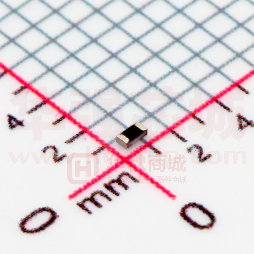

    贴片电阻 0402 50Ω ±0.1% 1/16W ±50ppm/℃
RT0402BRE0750RL 数据手册
DATA SHEET THIN FILM CHIP RESISTORS High precision - high stability RT series 0.01% TO 1%, TCR 5 TO 50 sizes 0201/0402/0603/0805/1206/ 1210/2010/2512 Product specification – April 21, 2020 V.12 RoHS compliant Product specification Chip Resistor Surface Mount RT SCOPE ORDERING INFORMATION - GLOBAL PART NUMBER & 12NC This specification describes RT series high precision - high stability chip resistors with lead-free terminations made by thin film process. Both part numbers are identified by the series, size, tolerance, packing type, temperature coefficient, taping reel and resistance value. YAGEO BRAND ordering code GLOBAL PART NUMBER (PREFERRED ) APPLICATIONS  Converters  Printing equipment  Server board  Telecom  Consumer FEATURES  Halogen Free Epoxy      RoHS compliant Reducing environmentally hazardous wastes High component and equipment reliability 2 9 0201 to 2512 (RoHS Compliant) SERIES RT XXXX F X X XX XXXX L (1) (2) (3) (4) (5) (6) (7) (1) SIZE 0201/ 0402 / 0603 / 0805 / 1206 / 1210 / 2010 / 2512 (2) TOLERANCE L = ± 0.01% P = ± 0.02% W = ± 0.05% B = ± 0.1% C = ± 0.25% D = ± 0.5% F = ± 1% (3) PACKAGING TYPE R = Paper/PE taping reel K = Embossed taping reel (4) TEMPERATURE COEFFICIENT OF RESISTANCE Saving of PCB space A = 5 ppm/°C None forbidden-materials used in products/production B = 10 ppm/°C C = 15 ppm/°C D = 25 ppm/°C E = 50 ppm/°C (5) TAPING REEL 07 = 7 inch dia. Reel 10 = 10 inch dia. Reel 7W= 7 inch dia. Reel with high power (1W for 2512) 13 = 13 inch dia. Reel (6) RESISTANCE VALUE There are 2~4 digits indicated the resistor value. Letter R/K/M is decimal point. Detailed resistance rules show in table of “Resistance rule of global part number”. (7) DEFAULT CODE Letter L is system default code for order only (Note) Resistance rule of global part number Resistance code rule Example XRXX (1 to 9.76 Ω) 1R = 1 Ω 1R5 = 1.5 Ω 9R76 = 9.76 Ω XXRX (10 to 97.6 Ω) 10R = 10 Ω 97R6 = 97.6 Ω XXXR (100 to 976 Ω) 100R = 100 Ω XKXX (1 to 9.76 KΩ) 1K = 1,000 Ω 9K76 = 9760 Ω XMXX (1 to 9.76 MΩ) 1M = 1,000,000 Ω 9M76= 9,760,000 Ω O RDERING EXAMPLE The ordering code of a RT0603 chip resistor, TC 50 value 56 Ω with ± 0.5% tolerance, supplied in 7-inch tape reel is: RT0603DRE0756RL. NOTE 1. All our RSMD products meet RoHS compliant and Halogen Free. "LFP" of the internal 2D reel label mentions "Lead Free Process" 2. On customized label, "LFP" or specific symbol can be printed www.yageo.com Apr. 21, 2020 V.12 Product specification Chip Resistor Surface Mount RT SERIES 3 9 0201 to 2512 (RoHS Compliant) PHYCOMP BRAND ordering codes Both GLOBAL PART NUMBER (preferred) and 12NC (traditional) codes are acceptable to order Phycomp brand products. For matching traditional types with size codes, please refer to “Comparison table of traditional types and sizes”. GLOBAL PART NUMBER (PREFERRED ) For detailed information of GLOBAL PART NUMBER and ordering example, please refer to page 2. 12NC CODE 2390 X XX (1) (2) (3) X (4) START TCR (2) PACKING CODE TOL . (4) WITH (1) (ppm/°C) BY SIZE (inch) (3) (%) 2390 XXXX (5) RESISTANCE RANGE The remaining 4 digits 7 = ± 15 47 = 13'' reel 6 = ± 0.5 represent the resistance value with the last digit 6 = ± 25 0603: 04 = 7'' reel 5 = ± 0.25 indicating the multiplier 4 = ± 50 24 = 10'' reel 4 = ± 0.1 as shown in the table of 44 = 13'' reel 3 = ± 0.05 “Last digit of 12NC”. 8 = ± 10 0402: 07 = 7'' reel 7 = ±1 0805: 01 = 7'' reel 41 = 13'' reel 1206: 11 = 7'' reel 51 = 13'' reel 1210: 12 = 7'' reel 52 = 13'' reel 2010: 15 = 7'' reel L (6) DEFAULT CODE (NOTE) Letter L is system default code for order only (Note) Comparison table of traditional types and sizes TF X X X (1) (2) START SIZE WITH CODE TF (4) (3) TCR TOL. (ppm/°C) (%) 3 = 0402 4 = ± 10 0 = ± 1 2 = 0603 3 = ± 15 1 = ± 0.5 1 = 0805 1 = ± 25 2 = ± 0.25 0402: 4.7Ω ≤ R ≤ 240KΩ 0 = 1206 2 = ± 50 3 = ± 0.1 0603: 1 Ω ≤ R ≤ 1MΩ 5 = 1210 0805: 1Ω ≤ R ≤ 1.5 MΩ 7 = 2010 1206: 1Ω ≤ R ≤ 1.5 MΩ 4 = ± 0.05 6 = 2512 1210: 4.7Ω ≤ R ≤ 1 MΩ  Example: 2010: 4.7Ω ≤ R ≤ 1 MΩ TF321 = RT0402, TC50, ± 0.5% tolerance 2512: 4.7Ω ≤ R ≤ 1 MΩ 2512: 18 = 7'' reel Resistance decade (3) Last digit 1 to 9.76 Ω 10 to 97.6 Ω 8 100 to 976 Ω 1 1 to 9.76 kΩ 2 Exceptions to above packing code definitions: 10 to 97.6 kΩ 3 0805 TC50 with 1%, supplied in 13" reel, the packing code is 02. 100 to 976 kΩ 4 0603 TC50 with 1%, supplied in 13" reel, the packing code is 03. 1 to 9.76 MΩ 5 2512 TC15, in 7" reel, the packing code is 35. 10 to 97.6 MΩ 6 2010 TC15, in 7" reel, the packing code is 31. O RDERING EXAMPLE The ordering code of a TF221 resistor, TC50, value 56 Ω , with ± 0.5% tolerance, supplied in tape of 5,000 units per reel is: 239040465609L or RT0603DRE0756RL. Example: 1Ω 33 kΩ 10 MΩ 9 = 1008 or 108 = 3303 or 333 = 1006 or 106 NOTE 1. All our RSMD products meet RoHS compliant and Halogen Free. "LFP" of the internal 2D reel label mentions "Lead Free Process" 2. On customized label, "LFP" or specific symbol can be printed www.yageo.com Apr. 21, 2020 V.12 Product specification Chip Resistor Surface Mount RT 4 9 0201 to 2512 (RoHS Compliant) SERIES MARKING RT0201 / RT0402 / RESISTANCE VALUE IS NOT IN E-24 / E96 SERIES No marking ynsc007 Fig. 4 RT0603 E-24 series: exception values 10/11/13/15/20/75 of E -24 series, one short bar under marking letter 563 ynsc003 Fig. 2 Value = 56 kΩ E-96 series: including values 10/11/13/15/20/75 of E-24 series, 3 digits Fig. 3 Value = 12.4 kΩ RT0805 / RT1206 / RT1210 / RT2010 / RT2512 00 YNSC004 Fig. 1 Value = 10 kΩ Either resistance in E-24 or E-96: 4 digits First three digits for significant figure and 4th digit for number of zeros For further marking information, please see special data sheet “Chip resistors marking”. CONSTRUCTION The resistors are constructed out of a high-grade ceramic body. Internal metal electrodes are added at each end and connected by a resistive layer. The resistive layer is adjusted to give the approximate required resistance and laser cutting of this resistive layer that achieves tolerance trims the value. The resistive layer is covered with a protective coat and printed with the resistance value. Finally, the two external terminations (matte tin) are added. See fig. 5. OUTLINES For dimension see Table 1 marking layer protective coat resistive layer inner electrode H termination (Ni / matte tin) DIMENSION Table 1 For outlines see fig. 5 TYPE L (mm) W (mm) H (mm) RT0201 0.60 ± 0.03 0.30 ± 0.03 0.23 ± 0.03 RT0402 1.00 ± 0.10 0.50 ± 0.05 0.30 ± 0.05 RT0603 1.60 ± 0.10 0.80 ± 0.10 0.45 ± 0.10 RT0805 2.00 ± 0.10 1.25 ± 0.10 0.50 ± 0.10 RT1206 3.10 ± 0.10 1.60 ± 0.10 0.55 ± 0.10 RT1210 3.10 ± 0.10 2.60 ± 0.15 0.55 ± 0.10 RT2010 5.00 ± 0.10 2.50 ± 0.15 0.55 ± 0.10 RT2512 6.35 ± 0.10 3.20 ± 0.15 0.55 ± 0.10 ceramic substrate I2 I1 I1 (mm) I2 (mm) 0.10 ± 0.05 0.15 ± 0.05 0.20 ± 0.10 0.25 ± 0.10 W 0.25 ± 0.15 0.25 ± 0.15 YNSC064 0.35 ± 0.20 0.35 ± 0.20 0.45 ± 0.20 0.40 ± 0.20 0.50 ± 0.20 0.50 ± 0.20 L Fig. 5 Chip resistor outlines 0.60 ± 0.20 0.50 ± 0.20 0.60 ± 0.20 0.50 ± 0.20 www.yageo.com Apr. 21, 2020 V.12 Product specification Chip Resistor Surface Mount RT SERIES 5 9 0201 to 2512 (RoHS Compliant) ELECTRICAL CHARACTERISTICS Table 2 TYPE RT0201 Operating Temperature Range –55°C to +125°C Max. Max. Dielectric Power Work T.C.R. Overload Withstand Rating (ppm/°C) Vol. Vol. (1) Vol. ± 0.01% 1/20W 25V 50V 50V ± 0.02% ± 0.05% ± 0.1% ± 0.25% ± 0.5% ± 1.0% ± 50 --- --- --- 22~75K 22~75K 22~75K 22~75K ± 25 --- --- --- 22~75K 22~75K 22~75K 22~75K ± 15 --- --- --- 22~5K 22~5K --- --- ± 10 --- --- --- 22~5K 22~5K --- --- ±5 RT0402 1/16W 50V 100V 75V RT0603 1/10W 75V 150V 100V RT0805 1/8W 150V 300V 200V RT1206 1/4W 200V 400V 300V –55°C to +155°C RT1210 RT2010 1/4W –55°C to +125°C 1/2W 3/4W 200V 200V 200V 400V 400V 400V 400V 400V 400V RT2512 1W 200V 400V 400V Resistance Range (E-24/E-96 series)(2) & Tolerance ± 50 ± 25 ± 15 ± 10 ±5 ± 50 ± 25 ± 15 ± 10 ±5 ± 50 ± 25 ± 15 ± 10 ±5 ± 50 ± 25 ± 15 ± 10 ±5 --50.1~12K 50.1~12K 20~12K 20~12K 20~10K 50.1~30K 50.1~30K 50.1~100K 50.1~100K 20~30K 50.1~30K 50.1~30K 50.1~200K 50.1~200K 20~50K 50.1~30K 50.1~30K 50.1~500K 50.1~500K 20~100K --50.1~12K 50.1~12K 20~12K 20~12K 20~10K 50.1~30K 50.1~30K 50.1~100K 50.1~100K 20~30K 50.1~30K 50.1~30K 50.1~200K 50.1~200K 20~50K 50.1~30K 50.1~30K 50.1~500K 50.1~500K 20~100K --- --- --- --- --- 20~12K 20~12K 20~12K 20~12K 20~10K 4.7~100K 4.7~100K 4.7~100K 4.7~100K 20~30K 4.7~200K 4.7~200K 4.7~200K 4.7~200K 20~50K 5.6~500K 5.6~500K 5.6~500K 5.6~500K 20~100K 4.7~240K 4.7~240K 20~200K 20~200K 20~10K 1~1M 1~1M 4.7~680K 4.7~680K 20~30K 1~1.5M 1~1.5M 4.7~1M 4.7~1M 20~50K 1~1.5M 1~1.5M 5.6~1.5M 5.6~1.5M 20~100K 4.7~240K 4.7~240K 20~200K 20~200K 20~10K 1~1M 1~1M 4.7~680K 4.7~680K 20~30K 1~1.5M 1~1.5M 4.7~1M 4.7~1M 20~50K 1~1.5M 1~1.5M 5.6~1.5M 5.6~1.5M 20~100K 4.7~240K 4.7~240K ------1~1M 1~1M ------1~1.5M 1~1.5M ------1~1.5M 1~1.5M ------- 4.7~240K 4.7~240K ------1~1M 1~1M ------1~1.5M 1~1.5M ------1~1.5M 1~1.5M ------- ± 50 --- --- 4.7~1M 4.7~1M 4.7~1M 4.7~1M 4.7~1M ± 25 --- --- 4.7~1M 4.7~1M 4.7~1M 4.7~1M 4.7~1M ± 15 --- --- 100~100K 4.7~100K 4.7~100K --- --- ± 10 --- --- 100~100K 4.7~100K 4.7~100K --- --- ±5 --- --- --- --- --- --- --- ± 50 --- --- 4.7~1M 4.7~1M 4.7~1M 4.7~1M 4.7~1M ± 25 --- --- 4.7~1M 4.7~1M 4.7~1M 4.7~1M 4.7~1M ± 15 --- --- 100~100K 4.7~100K 4.7~100K --- --- ± 10 --- --- 100~100K 4.7~100K 4.7~100K --- --- ±5 --- --- --- --- --- --- --- ± 50 --- --- 4.7~1M 4.7~1M 4.7~1M 4.7~1M 4.7~1M ± 25 --- --- 4.7~1M 4.7~1M 4.7~1M 4.7~1M 4.7~1M ± 15 --- --- 100~100K 4.7~100K 4.7~100K --- --- ± 10 --- --- 100~100K 4.7~100K 4.7~100K --- --- ±5 --- --- --- --- ± 50 --- --- 10Ω~1M 10Ω~1M 10Ω~1M 10Ω~1M 10Ω~1M ± 25 --- --- 10Ω~1M 10Ω~1M 10Ω~1M 10Ω~1M 10Ω~1M --- --- --- NOTE 1. The maximum working voltage that may be continuously applied to the resistor element, see “IEC publication 60115-8” 2. Value of E-192 series is on request www.yageo.com Apr. 21, 2020 V.12 Product specification Chip Resistor Surface Mount RT SERIES 6 9 0201 to 2512 (RoHS Compliant) FOOTPRINT AND SOLDERING PROFILES For recommended footprint and soldering profiles, please see the special data sheet “Chip resistors mounting”. PACKING STYLE AND PACKAGING QUANTITY Table 3 Packing style and packaging quantity PACKING STYLE REEL RT0201 DIMENSION Paper/PE taping reel (R) RT0402 RT0603 RT0805 RT1206 RT1210 RT2010 RT2512 7" (178 mm) 10,000 10,000 5,000 5,000 5,000 5,000 --- --- 10" (254 mm) 20,000 20,000 10,000 10,000 10,000 10,000 --- --- 13" (330 mm) 50,000 50,000 20,000 20,000 20,000 20,000 --- --- 7" (178 mm) --- --- --- --- --- --- 4,000 4,000 Embossed taping reel (K) NOTE 1. For Paper/Embossed tape and reel specification/dimensions, please see the special data sheet “Chip resistors packing” FUNCTIONAL DESCRIPTION POWER RATING Each type rated power at 70°C: RT0201=1/20W, RT0402=1/16W, RT0603=1/10W, RT0805=1/8W, RT1206=1/4W, RT1210=1/4W, RT2010=1/2W, RT2512=3/4W, 1W R ATED VOLTAGE The DC or AC (rms) continuous working voltage corresponding to the rated power is determined by the following formula: V= (PxR) or max. working voltage whichever is less Where P (%Prated) MLB206_RT 100 RT0402~1206 50 RT0201, RT1210 ~ 2512 0 55 0 50 70 100 125 155 o Tamb( C) Fig. 6 Maximum dissipation (P) in percentage of rated power as a function of the operating ambient temperature (T amb ) V=Continuous rated DC or AC (rms) working voltage (V) P=Rated power (W) R=Resistance value (Ω) www.yageo.com Apr. 21, 2020 V.12 Product specification Chip Resistor Surface Mount RT SERIES 7 9 0201 to 2512 (RoHS Compliant) TESTS AND REQUIREMENTS Table 4 Test condition, procedure and requirements TEST TEST METHOD PROCEDURE REQUIREMENTS Temperature Coefficient of Resistance (T.C.R.) MIL-STD-202 Method 304 At +25/–55 °C and +25/+125 °C Refer to table 2 Formula: R2–R1 T.C.R= ------------------------- × 106 (ppm/°C) R1(t2–t1) Where t1=+25 °C or specified room temperature t2=–55 °C or +125 °C test temperature R1=resistance at reference temperature in ohms R2=resistance at test temperature in ohms Life/Endurance IEC 60115-1 4.25.1 MIL-STD-202 Method 108A At 70± 5 °C for 1,000 hours, RCWV applied for 1.5 hours on, 0.5 hour off, still air required ± (0.5%+0.05 Ω) High Temperature Exposure IEC 60068-2-2 1000 hours at maximum operating temperature depending on specification, unpowered ± (0.5%+0.05 Ω) Moisture Resistance MIL-STD-202 Method 106G Each temperature / humidity cycle is defined at 8 hours, 3 cycles / 24 hours for 10d. with 25 °C / 65 °C 95% R.H, without steps 7a & 7b, unpowered ± (0.5%+0.05 Ω) Parts mounted on test-boards, without condensation on parts Measurement at 24± 2 hours after test conclusion Thermal Shock MIL-STD-202 Method 107G -55/+125 °C Number of cycles required is 300. Devices mounted ± (0.5%+0.05 Ω) for 10 KΩ to 10 MΩ ± (0.5%+0.05 Ω) for others Maximum transfer time is 20 seconds. Dwell time is 15 minutes. Air – Air Humidity (steady state) IEC 60115-1 4.24.2 Steady state for 1000 hours at 40 °C / 95% R.H. ± (0.5%+0.05 Ω) RCWV applied for 1.5 hours on and 0.5 hour off www.yageo.com Apr. 21, 2020 V.12 Product specification Chip Resistor Surface Mount RT 8 9 0201 to 2512 (RoHS Compliant) SERIES TEST Short Time Overload TEST METHOD PROCEDURE REQUIREMENTS IEC60115-1 4.13 2.5 times of rated voltage or maximum ± (0.5%+0.05 Ω) overload voltage whichever is less for 5 sec at No visible damage room temperature Board Flex/ Bending IEC 60115-1 4.33 Chips mounted on a 90mm glass epoxy resin ± (0.25%+0.05 Ω) PCB (FR4) No visible damage Bending: see table 6 for each size Bending time: 60± 5 seconds Insulation Resistance IEC 60115-1 4.6 ≥10 GΩ Rated continuous overload voltage (RCOV) for 1 minute Details see below table 5 Dielectric Withstand Voltage Solderability - Wetting IEC 60115-1 4.7 J-STD-002 test B Maximum voltage (Vrms) applied for 1 minute No breakdown or flashover Electrical Test not required Well tinned (≥95% covered) No visible damage Magnification 50X SMD conditions: 1st step: method B, aging 4 hours at 155°C dry heat 2nd step: leadfree solder bath at 245± 3°C Dipping time: 3± 0.5 seconds - Leaching - Resistance to Soldering Heat J-STD-002 test D Leadfree solder, 260 °C, 30 seconds immersion time No visible damage IEC 60115-1 4.18 Condition B, no pre-heat of samples. Leadfree solder, 260 °C, 10 seconds immersion time Procedure 2 for SMD: devices fluxed and cleaned with isopropanol ± (0.5%+0.05 Ω) No visible damage Table 5 Criteria of rated continued working voltage and overload voltage TYPE RT0201 RT0402 RT0603 RT0805 RT1206 RT1210 RT2010 RT2512 50 100 100 300 500 500 500 500 Voltage (DC/unit: V); (AC/ unit: Vrms) Table 6 Bending for sizes 0201 to 2512 TYPE Specification (mm) RT0201 RT0402 RT0603 RT0805 RT1206 RT1210 RT2010 RT2512 5 5 3 3 2 2 2 2 www.yageo.com Apr. 21, 2020 V.12 Product specification Chip Resistor Surface Mount RT SERIES 9 9 0201 to 2512 (RoHS Compliant) REVISION HISTORY REVISION DATE CHANGE NOTIFICATION DESCRIPTION Version 12 Apr. 21, 2020 - Version 11 July 2, 2019 - - Add 1W for 2512 Version 10 Jun. 12, 2019 - - Extend resistor value Version 9 Sep. 12, 2017 - - Add ± 0.02% tol. for 0402 to 1206 Version 8 May 31, 2017 - - Add 10" packing Version 7 Jan. 17, 2017 Version 6 May. 11, 2015 - - Extend resistor value Version 5 Aug. 22, 2014 - - Add RT0201 - - Modified resistance range - Add ± 0.01% tol. for 0402 to 1206 - RT0402/0603/0805/1206: resistance range and operating temperature range updated - Fig. 6 updated Version 4 Oct 21, 2009 - - Test Items and methods updated - Test requirements upgraded Version 3 Jul 11, 2008 - - Change to dual brand datasheet that describe RT0402 to RT2512 with RoHS compliant - Description of "Halogen Free Epoxy" added - Define global part number - Modify electrical characteristic Version 2 Dec 26, 2005 - - New datasheet for thin film high precision - high stability chip resistors sizes of 0201/0402/0603/0805/1206/1210/2010/2512, 1%, 0.5%, 0.25%, 0.1%, 0.05%, TC25/50 with lead-free terminations - Replace the 0402 to 1210 parts of pdf files: TFx10_1_1, TFx11_.5_2, TFx12_.25_2, TFx13_.1_3, TFx14_.05_1, TFx20_1_2, TFx21_.5_2, TFx22_.25_2, TFx23_.1_2, TFx24_.05_1, and combine into a document. - Test method and procedure updated - PE tape added (paper tape will be replaced by PE tape) “ Yageo reserves all the rights for revising the content of this datasheet without further notification, as long as the products itself are unchanged. Any product change will be announced by PCN.” www.yageo.com Apr. 21, 2020 V.12
RT0402BRE0750RL
1. 物料型号:文档中描述了YAGEO Phicomp的RT系列薄膜芯片电阻,包括多种尺寸如0201、0402、0603、0805、1206、1210、2010和2512,以及不同的公差和温度系数。
2. 器件简介:RT系列是高精度、高稳定性的芯片电阻,采用薄膜工艺制作,并符合RoHS标准,无铅化处理。
3. 引脚分配:文档中没有明确提到“引脚分配”,但通常对于芯片电阻来说,两端的金属电极作为引脚。
4. 参数特性:电阻的参数包括工作温度范围、功率等级、最大工作电压、最大过载、介质耐压、温度系数(T.C.R.)、电阻范围和公差等。
5. 功能详解:文档提供了详细的电阻规则,包括如何根据全球零件编号和12NC代码来确定电阻的尺寸、公差、包装类型、温度系数、卷轴尺寸和电阻值。
6. 应用信息:这些电阻适用于转换器、打印设备、服务器主板、电信和消费电子产品。
7. 封装信息:提供了不同尺寸的电阻的详细尺寸数据,包括长度、宽度、高度以及最大偏差。
