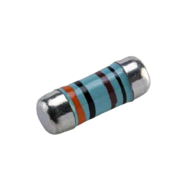

    560KΩ ±1% 1W
MLFA1FTC560K 数据手册
MLFA Series Stackpole Electronics, Inc. Metal Film Melf Resistor – AEC-Q200 Qualified Resistive Product Solutions Features: • • • • • • • • • • • • • Thin film technology for precision and stability Excellent power to size ratio Outstanding pulse handling Excellent overall stability Sn termination on Ni barrier layer Tight tolerance down to ± 0.1% Extremely low TCR down to ± 5 ppm/ºC High power rating up to 1W SMD enabled structure AEC-Q200 compliant 100% RoHS compliant and lead free without exemption Halogen free REACH compliant Electrical Specifications Type/Code Package Size Power Rating (Watts) @ 70 ºC Maximum Working (1) Maximum Overload TCR (ppm/ºC) Ohmic Range (Ω) and Tolerance (2) 0.1% 0.5% 1% 5% 1 - 1M ± 50 0.3 1 - 1M 0102 200 400 ± 100 MLFA13(3) Jumper: 2 A 0Ω (< 15mΩ) ±5 10 - 332K 10 - 300K ± 15 0.4 1 - 3.4M ± 25 10 - 1M 10 - 3.4M MLFA25 0204 200 400 0.2 - 3.4M ± 50 10 - 1M 1 - 3.4M 0.1 - 1M ± 100 Jumper: 3 A 0Ω (< 15mΩ) ±5 10 - 332K 10 - 300K ± 15 1 1 - 3.4M ± 25 10 - 1M 10 - 3.4M MLFA1 0207 350 700 0.2 - 3.4M ± 50 10 - 1M 1 - 3.4M 0.1 - 1M ± 100 Jumper: 5 A 0Ω ( 15mΩ) (1) Working Voltage = √ P*R or Max. Operating Voltage listed above, whichever is lower. (2) Overload Voltage = 2.5* √ P*R or Max. Overload Voltage listed above, whichever is lower. (3) Lower TCR with lower Power Ratings may be available - contact Stackpole RCWV (Rated Continuous Working Voltage) = √ P*R or Max Operating Voltage, whichever is lower. Voltage Voltage Mechanical Specifications Type/Code Weight (g) (1000 pc) L Body Length 0.087 ± 0.004 2.20 ± 0.10 MLFA13 7.7 MLFA25 18.7 0.138 ± 0.008 3.50 ± 0.20 MLFA1 80.9 0.232 ± 0.008 5.90 ± 0.20 L1 (min.) Inner Body Length 0.043 1.10 0.067 1.70 0.114 2.90 Rev Date: 08/12/2020 This specification may be changed at any time without prior notice Please confirm technical specifications before you order and/or use. 1 D Body Diameter 0.043 ± 0.004 1.10 ± 0.10 0.055 ± 0.006 1.40 ± 0.15 0.087 ± 0.008 2.20 ± 0.20 D1 Middle Body Dia. 0.043 +0/-0.006 1.10 +0/-0.15 0.055 +0/-0.008 1.40 +0/-0.2 0.087 +0/-0.008 2.20 +0/-0.2 K Termination 0.018 ± 0.002 0.45 ± 0.05 inches mm 0.031 ± 0.004 0.80 ± 0.10 inches mm 0.051 ± 0.004 1.30 ± 0.10 inches mm Unit www.seielect.com marketing@seielect.com MLFA Series Stackpole Electronics, Inc. Metal Film Melf Resistor – AEC-Q200 Qualified Resistive Product Solutions Performance Characteristics Test Temperature Coefficient of Resistance (T.C.R.) Test Method Test Method JIS-C-5201-1 4.8 IEC-60115-1 4.8 At 25°C / - 55°C and 25°C / + 125°C, 25°C is the reference temperature. 5ppm: At 25°C / -10°C and 25°C / +85°C, 25°C is the reference temperature Test Specification 5% and below Jumper As specified 10 Ω - 270 KΩ: ± (0.1% + 0.01 Ω) Short Time Overload JIS-C-5201-1 4.13 IEC-60115-1 4.13 RCWV*2.5 or max. overload voltage whichever is lower for 5 seconds < 10 Ω & > 270 KΩ: ± (0.15% + 0.01 Ω) < 15 mΩ MLFA13: ± (0.15% + 0.01 Ω) 5 ppm/ºC: ± (0.05% + 0.01 Ω) JIS-C-5201-1 4.6 IEC-60115-1 4.6 Max. overload voltage for 1 minute Operational Life MIL-STD-202 Method 108 Condition D Steady State TA = 125°C at derated power. Measurement at 24 ± 4 hours after test conclusion. 5 ppm/ºC: 70 ± 2°C, RCWV for 1000 hours with 1.5 hours "ON" and 0.5 hour "OFF" Biased Humidity MIL-STD-202 Method 103 1000 hours 85°C / 85% R.H. 10% of operating power High Temperature Exposure MIL-STD-202 Method 108 at +125°C / +155°C for 1000 hours Board Flex AEC-Q200-005 Bending once for 60 seconds with 2 mm Solderability JIS-5201-1 4.17 IEC 60115-1 4.17 J-STD 002 245 ± 5°C for 3 seconds 95% min. coverage Resistance to Soldering Heat MIL-STD-202 Method 210 260 ± 5°C for 10 seconds 10 Ω - 270 KΩ: ± (0.1% + 0.01 Ω) < 10 Ω & > 270 KΩ: ± 0.25% + 0.01 Ω) < 15 mΩ MLFA13: ± (0.25% + 0.01 Ω) 5 ppm/ºC: ± (0.05% + 0.01 Ω) 1.42 times max. operating voltage for 1 minute No breakdown or flashover Insulation Resistance Voltage Proof Leaching JIS-C-5201-1 4.7 IEC 60115-1 4.7 JIS-C-5201-1 4.18 IEC-60068-2-58 8.2.1 Temperature Cycling JESD22 Method JA-104 Mechanical Shock MIL-STD-202 Method 213 Vibration MIL-STD-202 Method 204 ESD Resistance to Solvents Terminal Strength AEC-Q200-002 MIL-STD-202 Method 215 AEC-Q200-006 Flammability UL-94 260 ± 5ºC for 30 seconds -55°C to + 125°C, 1000 cycles Wave Form: Tolerance for half sine shock pulse. 'Peak value is 100 g's. Normal duration (D) is 6. 5 g's for 20 minutes., 12 cycles each of 3 orientations 10-2000 Hz Human body, 2 KV Add aqueous wash chemical - OKEM clean or equivalent. Do not use banned solvents. Force of 1.8 Kg for 60 seconds V - 0 or V - 1 are acceptable. Electrical test not required. ≥10G 10 Ω - 270 KΩ: ± (0.25% + 0.01 Ω) 270 KΩ: ± (0.5% + 0.01 Ω) MLFA13: ± (0.5% + 0.01 Ω) < 15 mΩ 10 Ω - 270 KΩ: ± (0.5% + 0.01 Ω) < 10 Ω & > 270 K Ω: ± (1% + 0.01 Ω) < 15 mΩ MLFA13: ± (2% + 0.01 Ω) 10 Ω - 270 K Ω: ± (0.25% + 0.01 Ω) < 10 Ω & > 270 KΩ: ± (1% + 0.01 Ω) < 15 mΩ MLFA13: ± (1% + 0.01 Ω) 10 Ω - 270 KΩ: ± (0.1% + 0.01 Ω) < 10 Ω & > 270 KΩ: ± (0.5% + 0.01 Ω) < 15 mΩ MLFA13: ± (0.5% + 0.01 Ω) Individual leaching area ≤ 5% Total leaching area ≤ 10% 10 Ω - 270 KΩ: ± (0.25% + 0.01 Ω) < 10 Ω & > 270 KΩ: ± 0.5% + 0.01 Ω) < 15 mΩ MLFA13: ± (1% + 0.01 Ω) ± (0.25% + 0.01 Ω) < 15 mΩ ± (0.5% + 0.01 Ω) < 15 mΩ ± (0.5% + 0.05 Ω) < 15 mΩ No visible damage on appearance and marking. No breakage No ignition of the tissue paper or scorching of the pinewood board RCWV (rated continuous working voltage) = √ P*R or max. operating voltage whichever is lower Storage temperature: 15 ~ 28ºC. Humidity < 80% R.H. Operating temperature range is -55°C to +125°C for 5 ppm/ºC Operating temperature range is -55°C to +155°C for all others except 5 ppm/ºC Rev Date: 08/12/2020 This specification may be changed at any time without prior notice Please confirm technical specifications before you order and/or use. 2 www.seielect.com marketing@seielect.com MLFA Series Stackpole Electronics, Inc. Metal Film Melf Resistor – AEC-Q200 Qualified Resistive Product Solutions Power Derating Curve: Percent Rated Power (%) 100 -55ºC 70ºC 5ppm except for 5ppm 80 60 40 20 125°C 0 -60 0 20 40 60 80 100 120 Ambient Temperature (ºC) 155ºC 140 160 180 Hot Spot Temperature: Reel Specifications Type/Code MLFA13 MLFA25 MLFA1 Reel Diameter 0.276 7.00 0.276 7.00 0.276 7.00 øA 7.028 178.50 7.028 178.50 7.028 178.50 ± ± ± ± ± ± øB 0.059 1.50 0.059 1.50 0.059 1.50 2.362 60.00 2.362 60.00 2.362 60.00 Rev Date: 08/12/2020 This specification may be changed at any time without prior notice Please confirm technical specifications before you order and/or use. ± ± ± ± ± ± øC 0.039 1.00 0.039 1.00 0.039 1.00 3 0.512 13.00 0.512 13.00 0.512 13.00 ± ± ± ± ± ± W 0.008 0.20 0.008 0.20 0.020 0.50 0.354 9.00 0.354 9.00 0.512 13.00 ± ± ± ± ± ± T 0.020 0.50 0.020 0.50 0.020 0.50 0.492 12.50 0.492 12.50 0.610 15.50 ± ± ± ± ± ± Unit 0.020 0.50 0.020 0.50 0.020 0.50 inches mm inches mm inches mm www.seielect.com marketing@seielect.com MLFA Series Stackpole Electronics, Inc. Metal Film Melf Resistor – AEC-Q200 Qualified Resistive Product Solutions Packaging Specifications - Embossed Plastic Tape Type/Code MLFA13 MLFA25 MLFA1 A MLFA25 MLFA1 W E 0.051 1.30 0.061 1.55 0.094 2.40 ± 0.004 ± 0.10 ± 0.004 ± 0.10 ± 0.004 ± 0.10 P1 0.094 2.40 0.144 3.65 0.242 6.15 ± 0.004 ± 0.10 ± 0.004 ± 0.10 ± 0.004 ± 0.10 P2 0.315 8.00 0.315 8.00 0.472 12.00 ± 0.004 ± 0.10 ± 0.004 ± 0.10 ± 0.004 ± 0.10 D0 0.157 4.00 0.157 4.00 0.157 4.00 ± ± ± ± ± ± 0.079 2.00 0.079 2.00 0.079 2.00 ± ± ± ± ± ± 0.059 1.50 0.059 1.50 0.059 1.50 ± ± ± ± ± ± Type/Code MLFA13 B 0.004 0.10 0.004 0.10 0.004 0.10 0.002 0.05 0.002 0.05 0.002 0.05 0.004 0.10 0.004 0.10 0.004 0.10 0.069 1.75 0.069 1.75 0.069 1.75 F ± 0.004 ± 0.10 ± 0.004 ± 0.10 ± 0.004 ± 0.10 D1 0.035 0.90 0.035 0.90 0.055 1.40 min. min. min. min. min. min. P0 0.138 3.50 0.138 3.50 0.217 5.50 ± 0.002 ± 0.05 ± 0.002 ± 0.05 ± 0.002 ± 0.05 T 0.059 1.50 0.071 1.80 0.106 2.70 ± ± ± ± ± ± 0.004 0.10 0.004 0.10 0.004 0.10 0.157 4.00 0.157 4.00 0.157 4.00 Unit ± ± ± ± ± ± Unit 0.004 0.10 0.004 0.10 0.004 0.10 inches mm inches mm inches mm inches mm inches mm inches mm Recommended Pad Layout Type/Code MLFA13 MLFA25 MLFA1 A 0.039 1.00 0.063 1.60 0.118 3.00 Rev Date: 08/12/2020 This specification may be changed at any time without prior notice Please confirm technical specifications before you order and/or use. B 0.031 0.80 0.047 1.20 0.067 1.70 4 C 0.059 1.50 0.063 1.60 0.094 2.40 Unit inches mm inches mm inches mm www.seielect.com marketing@seielect.com MLFA Series Stackpole Electronics, Inc. Metal Film Melf Resistor – AEC-Q200 Qualified Resistive Product Solutions Soldering Condition: (1) Time of IR reflow soldering at maximum temperature point 260°C: 10 seconds (2) Time of wave soldering at maximum temperature point 260°C: 10 seconds (3) Time of soldering iron at maximum temperature point 410°C: 5 seconds Pulse Withstanding Capacity The single impulse graph is the result of the impulse of rectangular shape applied. The limit of acceptance was a shift in resistance of less than 1% from the initial value. The power applied was subject to the restrictions of the maximum permissible impulse voltage graph shown. Rev Date: 08/12/2020 This specification may be changed at any time without prior notice Please confirm technical specifications before you order and/or use. 5 www.seielect.com marketing@seielect.com MLFA Series Stackpole Electronics, Inc. Metal Film Melf Resistor – AEC-Q200 Qualified Resistive Product Solutions Continuous Pulse The continuous load graph was obtained by applying repetitive rectangular pulses where the pulse period was adjusted so that the average power dissipated in the resistor was equal to its rated power at 70ºC. Again the limit of acceptance was a shift in resistance of less than 1% from the initial value. Rev Date: 08/12/2020 This specification may be changed at any time without prior notice Please confirm technical specifications before you order and/or use. 6 www.seielect.com marketing@seielect.com MLFA Series Stackpole Electronics, Inc. Metal Film Melf Resistor – AEC-Q200 Qualified Resistive Product Solutions Frequency Behavior Resistors are designed to function according to Ohmic laws. This is basically true of resistors for frequencies up to 100 kHz. At higher frequencies, there is an additional contribution to the impedance by an ideal resistor switched in series with a coil and both switched parallel to a capacitor. The values of the capacitance and inductance are mainly determined by the dimensions of the terminations and the conductive path length. The environment surrounding components has a large influence on the behavior of the component on the printed-circuit board. MLFA25 Frequency versus Impedance Rev Date: 08/12/2020 This specification may be changed at any time without prior notice Please confirm technical specifications before you order and/or use. 7 www.seielect.com marketing@seielect.com MLFA Series Stackpole Electronics, Inc. Metal Film Melf Resistor – AEC-Q200 Qualified Resistive Product Solutions MLFA25 Frequency versus Phase Angle MLFA1 Frequency versus Impedance Rev Date: 08/12/2020 This specification may be changed at any time without prior notice Please confirm technical specifications before you order and/or use. 8 www.seielect.com marketing@seielect.com MLFA Series Stackpole Electronics, Inc. Metal Film Melf Resistor – AEC-Q200 Qualified Resistive Product Solutions MLFA1 Frequency versus Phase Angle Lightning Surge Resistors are tested in accordance with IEC 60 115-1 using both 1.2 / 50 µs and 10 / 700 µs pulse shapes. The limit of acceptance is a shift in resistance of less than 0.5% from the initial value. MLFA25 / MLFA1 1.2 / 50 μs Lightning Surge Rev Date: 08/12/2020 This specification may be changed at any time without prior notice Please confirm technical specifications before you order and/or use. 9 www.seielect.com marketing@seielect.com MLFA Series Stackpole Electronics, Inc. Metal Film Melf Resistor – AEC-Q200 Qualified Resistive Product Solutions 10 / 700 μs Lightning Surge MLFA13 1.2 / 50 µs Lightning Surge Rev Date: 08/12/2020 This specification may be changed at any time without prior notice Please confirm technical specifications before you order and/or use. 10 www.seielect.com marketing@seielect.com MLFA Series Stackpole Electronics, Inc. Metal Film Melf Resistor – AEC-Q200 Qualified Resistive Product Solutions MLFA13 10 / 700 µs Lightning Surge RoHS Compliance Stackpole Electronics has joined the worldwide effort to reduce the amount of lead in electronic components and to meet the various regulatory requirements now prevalent, such as the European Union’s directive regarding “Restrictions on Hazardous Substances” (RoHS 3). As part of this ongoing program, we periodically update this document with the status regarding the availability of our compliant components. All our standard part numbers are compliant to EU Directive 2011/65/EU of the European Parliament as amended by Directive (EU) 2015/863/EU as regards the list of restricted substances. RoHS Compliance Status Standard Product Series MLFA Description Package / Termination Type Standard Series RoHS Compliant Lead-Free Termination Composition Lead-Free Mfg. Effective Date (Std Product Series) Lead-Free Effective Date Code (YY/WW) Metal Film Melf Resistor (AEC-Q200 Qualified) SMD YES 100% Matte Sn Always Always Conflict Metals” Commitment We at Stackpole Electronics, Inc. are joined with our industry in opposing the use of metals mined in the “conflict region” of the eastern Democratic Republic of the Congo (DRC) in our products. Recognizing that the supply chain for metals used in the electronics industry is very complex, we work closely with our own suppliers to verify to the extent possible that the materials and products we supply do not contain metals sourced from this conflict region. As such, we are in compliance with the requirements of Dodd-Frank Act regarding Conflict Minerals. Compliance to “REACH” We certify that all passive components supplied by Stackpole Electronics, Inc. are SVHC (Substances of Very High Concern) free and compliant with the requirements of EU Directive 1907/2006/EC, “The Registration, Evaluation, Authorization and Restriction of Chemicals”, otherwise referred to as REACH. Contact us for complete list of REACH Substance Candidate List. Rev Date: 08/12/2020 This specification may be changed at any time without prior notice Please confirm technical specifications before you order and/or use. 11 www.seielect.com marketing@seielect.com MLFA Series Stackpole Electronics, Inc. Metal Film Melf Resistor – AEC-Q200 Qualified Resistive Product Solutions Environmental Policy It is the policy of Stackpole Electronics, Inc. (SEI) to protect the environment in all localities in which we operate. We continually strive to improve our effect on the environment. We observe all applicable laws and regulations regarding the protection of our environment and all requests related to the environment to which we have agreed. We are committed to the prevention of all forms of pollution. How to Order 1 2 3 4 5 6 7 8 10 11 12 13 14 M L F A 2 5 F T S 1 0 0 K Product Series MLFA Power Rating Code Size W 13 0102 0.3 25 0204 0.4 1 0207 1 Tolerance Packaging TCR Code Tol Value Code Description Product Code Quantity Code ppm B 0.1% MLFA13 Z jumper 7" Reel 3000 T D 0.5% E96, E24 MLFA25 Y 5 Plastic Tape F 1% MLFA1 2000 S 15 J 5% E24 E 25 Z Jumper C 50 D 100 Rev Date: 08/12/2020 This specification may be changed at any time without prior notice Please confirm technical specifications before you order and/or use. 12 Resistance Value Four characters with the multiplier used as the decimal holder. 1 ohm = 1R00 100 Kohm = 100K 1 Mohm = 1M00 zero ohm jumper = 0R00 www.seielect.com marketing@seielect.com
