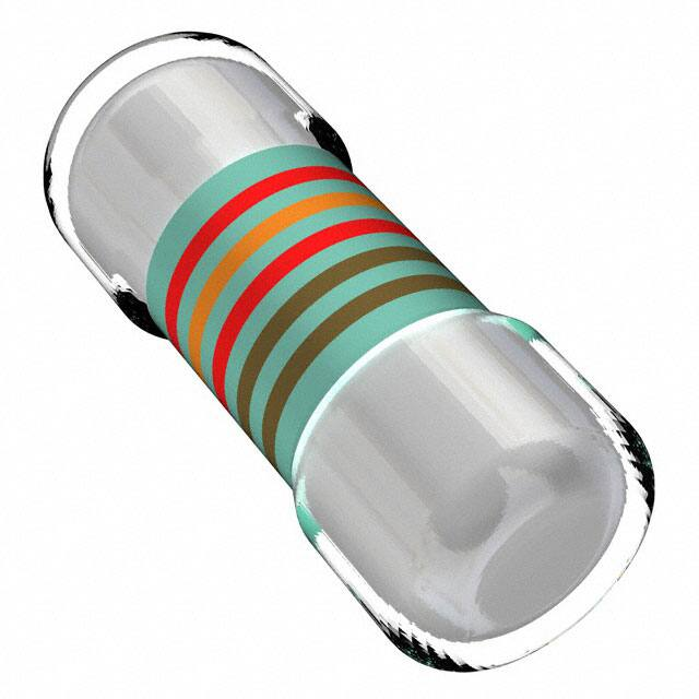

    2.32KΩ ±1% 500MW
MLF12FTC2K32 数据手册
MLF / MLFM Series Stackpole Electronics, Inc. Metal Film Melf Resistor Resistive Product Solutions Features: • • • • • • Thin film technology for precision and stability Excellent power to size ratio Exhibits good pulse power characteristics 100% RoHS compliant and lead free without exemption Halogen free REACH compliant Electrical Specifications Type/Code Package Size Power Rating (W) @ 70ºC Maximum Working Voltage (V) (1) Maximum Overload Voltage (V) MLF18 0102 0.125 150 300 MLFM15 0102 0.2 200 400 MLF14 0204 200 400 200 400 300 600 350 700 0.25 MLFM25 0204 MLF12 0207 0.4 0.5 Jumper: 4 A MLFM1 0207 1 0.1% ± 15 ± 25 ± 50 ± 100 ± 15 ± 25 ± 50 ± 100 ±5 ± 10 ± 15 ± 25 ± 50 ± 100 ±5 ± 15 ± 25 ± 50 ± 100 ±5 ± 10 ± 15 ± 25 ± 50 ± 100 ±5 ± 15 ± 25 ± 50 ± 100 Jumper: 2 A Ohmic Range (Ω) and Tolerance TCR (ppm/ºC) 0.5% 1% 5% 100 - 56 K 100 - 82 K 49.9 - 200 K 49.9 - 390 K 8.2 - 1 M 40 - 1 M 100 - 56 K 100 - 82 K 49.9 - 200 K 49.9 - 390 K 8.2 - 1 M 40 - 1 M 10 - 332 K 10 - 20 K 10 - 300 K 10 - 1 M 1 - 4.7 M 0.2 - 10 M 10 - 1 M 1-1M 0.1 - 10 M 0 Ω (< 15 MΩ) 10 - 332 K 10 - 100 K 10 - 1 M 1 - 3.4 M 0.2 - 1 M 10 - 1 M 1-1M 0.1 - 1 M 10 - 332 K 10 - 20 K 10 - 300 K 10 - 1 M 1 - 4.7 M 0.2 - 10 M 10 - 1 M 1-1M 0.1 - 10 M 0 Ω (< 15 MΩ) 10 - 332 K 10 - 100 K 10 - 1 M 1 - 3.4 M 0.2 - 10 M 10 - 1 M 1-1M 0.1 - 10 M Note: (1) Lesser of √P*R or maximum working voltage Rev Date: 11/20/2020 This specification may be changed at any time without prior notice Please confirm technical specifications before you order and/or use. 1 www.seielect.com marketing@seielect.com MLF / MLFM Series Stackpole Electronics, Inc. Metal Film Melf Resistor Resistive Product Solutions Mechanical Specifications Type/Code Weight (g) (1000 pieces) MLF18 7.7 MLFM15 7.7 MLF14 18.7 MLFM25 18.7 MLF12 80.9 MLFM1 80.9 L Body Length 0.087 ± 0.004 2.20 ± 0.10 0.087 ± 0.004 2.20 ± 0.10 0.138 ± 0.008 3.50 ± 0.20 0.138 ± 0.008 3.50 ± 0.20 0.232 ± 0.008 5.90 ± 0.20 0.232 ± 0.008 5.90 ± 0.20 L1 (min.) Inner Body Length 0.043 1.10 0.043 1.10 0.067 1.70 0.059 1.50 0.114 2.90 0.114 2.90 D Body Diameter 0.043 ± 0.004 1.10 ± 0.10 0.043 ± 0.004 1.10 ± 0.10 0.055 ± 0.006 1.40 ± 0.15 0.055 ± 0.006 1.40 ± 0.15 0.087 ± 0.008 2.20 ± 0.20 0.087 ± 0.008 2.20 ± 0.20 D1 Middle Body Dia. 0.043 +0/-0.006 1.10 +0/-0.15 0.043 +0/-0.006 1.10 +0/-0.15 0.055 +0/-0.008 1.40 +0/-0.20 0.055 +0/-0.008 1.40 +0/-0.20 0.087 +0/-0.008 2.20 +0/-0.20 0.087 +0/-0.008 2.20 +0/-0.20 K Termination 0.018 ± 0.002 0.45 ± 0.05 0.018 ± 0.002 0.45 ± 0.05 0.031 ± 0.004 0.80 ± 0.10 0.031 ± 0.004 0.80 ± 0.10 0.051 ± 0.004 1.30 ± 0.10 0.051 ± 0.004 1.30 ± 0.10 Unit inches mm inches mm inches mm inches mm inches mm inches mm Performance Characteristics Test Temperature Coefficient of Resistance (T.C.R.) Test Method Test Condition JIS-C-5201-1 4.8 IEC-60115-1 4.8 At 25°C / - 55°C and 25°C / + 125°C, 25°C is the reference temperature. 5ppm: At 25°C / -10°C and 25ºC / +85°C, 25°C is the reference temperature JIS-C-5201-1 4.13 Short Time Overload Insulation Resistance IEC-60115-1 4.13 JIS-C-5201-1 4.6 IEC-60115-1 4.6 RCWV*2.5 or max. overload voltage whichever is lower for 5 seconds Max. overload voltage for 1 minute Endurance JIS-C-5201-1 4.25 IEC-60115-1 4.25.1 70 ± 2ºC, RCWV for 1000 hours with 1.5 hour "ON" and 0.5 hour "OFF" Damp Heat with Load JIS-C-5201-1 4.24 IEC-60115-1 4.24 40 ± 2ºC, 90 ~ 95% R.H., RCWV for 1000 hours with 1.5 hour "ON" and 0.5 hour "OFF" Dry Heat JIS-C-5201-1 4.23 IEC-60115-1 4.23.2 At +125°C / +155°C for 1000 hours JIS-C-5201-1 4.33 Bending once for 5 seconds with 2 mm IEC-60115-1 4.33 JIS-C-5201-1 4.17 Solderability 245 ± 5ºC for 3 seconds IEC-60115-1 4.17 Resistance to Soldering JIS-C-5201-1 4.18 260 ± 5ºC for 10 seconds Heat IEC-60115-1 4.18 JIS-C-5201-1 4.7 Voltage Proof 1.42 times max. operating voltage for 1 minute IEC-60115-1 4.7 JIS-C-5201-1 4.18 Leaching 260 ± 5ºC for 30 seconds IEC-60068-2-58 8.2.1 Rapid Change of JIS-C-5201-1 4.19 -55°C to +125°C / +155°C, 5 cycles Temperature IEC-60115-1 4.19 RCWV (rated continuous working voltage) = √(P*R) or max. operating voltage whichever is lower. Storage temperature: 25 ± 3ºC, humidity < 80% R.H. Operating temperature range is -55°C to +155°C except for 5 ppm/ºC. Operating temperature range for 5 ppm/ºC is -55°C to +125°C. Bending Strength Rev Date: 11/20/2020 This specification may be changed at any time without prior notice Please confirm technical specifications before you order and/or use. 2 Test Specification 5% and below Jumper As specified 0204/0207: ± (0.15% + 0.05 Ω) 0102: ± (0.5% + 0.05 Ω) 5ppm: ± (0.05% + 0.01 Ω) < 15 mΩ ≥10G 0204/0207: ± (0.15% + 0.05 Ω) 0102: ± (0.5% + 0.05 Ω) 5ppm: ± (0.25% + 0.01 Ω) 0204/0207: ± (1% + 0.05 Ω) 0102: ± (0.5% + 0.05 Ω) 5ppm: ± (0.25% + 0.01 Ω) 0204/0207: ± (1% + 0.05 Ω) 0102: ± (1.5% + 0.05 Ω) 5ppm: ± (0.25% + 0.01 Ω) ± (0.5% + 0.05 Ω) 5ppm: ± (0.1% + 0.01 Ω) < 15 mΩ < 15 mΩ < 15 mΩ < 15 mΩ 95% min. coverage ± (0.5% + 0.05 Ω) 5ppm: ± (0.05% + 0.01 Ω) < 15 mΩ No breakdown or flashover Individual leacing area ≤ 5% Total Leaching area ≤ 10% ± (0.5% + 0.05 Ω) < 15 mΩ 5ppm: ± (0.2% + 0.01 Ω) www.seielect.com marketing@seielect.com MLF / MLFM Series Stackpole Electronics, Inc. Metal Film Melf Resistor Resistive Product Solutions Power Derating Curve: Percent Rated Power (%) 100 -55ºC 70ºC 5 ppm except for 5 ppm 80 60 40 20 125°C 0 -60 0 20 40 60 80 100 120 155ºC 140 160 180 Ambient Temperature (ºC) Recommended Solder Profile This information is intended as a reference for solder profiles for Stackpole resistive components. These profiles should be compatible with most soldering processes. These are only recommendations. Actual numbers will depend on board density, geometry, packages used, etc., especially those cells labeled with “*”. 100% Matte Tin / RoHS Compliant Terminations Soldering iron recommended temperatures: 330°C to 350°C with minimum duration. Maximum number of reflow cycles: 3. Wave Soldering Description Maximum Recommended Preheat Time 80 seconds 70 seconds Temperature Diff. 140°C 120°C Solder Temp. 260°C 250°C Dwell Time at Max. 10 seconds 5 seconds Ramp DN (°C/sec) N/A N/A Temperature Diff. = Defference between final preheat stage and soldering stage. Minimum 60 seconds 100°C 240°C * N/A Convection IR Reflow Description Maximum Recommended Minimum Ramp Up (°C/sec) Dwell Time > 217°C Solder Temp. Dwell Time at Max. Ramp DN (°C/sec) 3°C/sec 150 seconds 260°C 30 seconds 6°C/sec 2°C/sec 90 seconds 245°C 15 seconds 3°C/sec * 60 seconds * 10 seconds * Rev Date: 11/20/2020 This specification may be changed at any time without prior notice Please confirm technical specifications before you order and/or use. 3 www.seielect.com marketing@seielect.com MLF / MLFM Series Stackpole Electronics, Inc. Metal Film Melf Resistor Resistive Product Solutions Recommended Lead Free Resistor Reflow Profile Reel Specifications Type/Code MLF18 MLFM15 MLF14 MLFM25 MLF12 MLFM1 øA 7.028 178.50 7.028 178.50 7.028 178.50 7.028 178.50 7.028 178.50 7.028 178.50 ± ± ± ± ± ± ± ± ± ± ± ± øB 0.059 1.50 0.059 1.50 0.059 1.50 0.059 1.50 0.059 1.50 0.059 1.50 2.362 60.00 2.362 60.00 2.362 60.00 2.362 60.00 2.362 60.00 2.362 60.00 Rev Date: 11/20/2020 This specification may be changed at any time without prior notice Please confirm technical specifications before you order and/or use. ± ± ± ± ± ± ± ± ± ± ± ± øC 0.039 1.00 0.039 1.00 0.039 1.00 0.039 1.00 0.039 1.00 0.039 1.00 0.512 13.00 0.512 13.00 0.512 13.00 0.512 13.00 0.512 13.00 0.512 13.00 4 ± ± ± ± ± ± ± ± ± ± ± ± W 0.008 0.20 0.008 0.20 0.008 0.20 0.008 0.20 0.020 0.50 0.020 0.50 0.354 9.00 0.354 9.00 0.354 9.00 0.354 9.00 0.512 13.00 0.512 13.00 ± ± ± ± ± ± ± ± ± ± ± ± T 0.020 0.50 0.020 0.50 0.020 0.50 0.020 0.50 0.020 0.50 0.020 0.50 0.492 12.50 0.492 12.50 0.492 12.50 0.492 12.50 0.610 15.50 0.610 15.50 ± ± ± ± ± ± ± ± ± ± ± ± Unit 0.020 0.50 0.020 0.50 0.020 0.50 0.020 0.50 0.020 0.50 0.020 0.50 inches mm inches mm inches mm inches mm inches mm inches mm www.seielect.com marketing@seielect.com MLF / MLFM Series Stackpole Electronics, Inc. Metal Film Melf Resistor Resistive Product Solutions Packaging Specifications - Embossed Plastic Tape Type/Code MLF18 MLFM15 MLF14 MLFM25 MLF12 MLFM1 A 0.051 1.30 0.051 1.30 0.061 1.55 0.061 1.55 0.094 2.40 0.094 2.40 Type/Code MLF18 MLFM15 MLF14 MLFM25 MLF12 MLFM1 ± ± ± ± ± ± ± ± ± ± ± ± B 0.004 0.10 0.004 0.10 0.004 0.10 0.004 0.10 0.004 0.10 0.004 0.10 0.094 2.40 0.094 2.40 0.144 3.65 0.144 3.65 0.242 6.15 0.242 6.15 0.004 0.10 0.004 0.10 0.004 0.10 0.004 0.10 0.004 0.10 0.004 0.10 0.079 2.00 0.079 2.00 0.079 2.00 0.079 2.00 0.079 2.00 0.079 2.00 P1 0.157 4.00 0.157 4.00 0.157 4.00 0.157 4.00 0.157 4.00 0.157 4.00 ± ± ± ± ± ± ± ± ± ± ± ± ± ± ± ± ± ± ± ± ± ± ± ± W 0.004 0.10 0.004 0.10 0.004 0.10 0.004 0.10 0.004 0.10 0.004 0.10 0.315 8.00 0.315 8.00 0.315 8.00 0.315 8.00 0.472 12.00 0.472 12.00 0.002 0.05 0.002 0.05 0.002 0.05 0.002 0.05 0.002 0.05 0.002 0.05 0.059 1.50 0.059 1.50 0.059 1.50 0.059 1.50 0.059 1.50 0.059 1.50 P2 ± ± ± ± ± ± ± ± ± ± ± ± E ± ± ± ± ± ± ± ± ± ± ± ± 0.004 0.10 0.004 0.10 0.004 0.10 0.004 0.10 0.004 0.10 0.004 0.10 D0 ± ± ± ± ± ± ± ± ± ± ± ± 0.069 1.75 0.069 1.75 0.069 1.75 0.069 1.75 0.069 1.75 0.069 1.75 ± ± ± ± ± ± ± ± ± ± ± ± F 0.004 0.10 0.004 0.10 0.004 0.10 0.004 0.10 0.004 0.10 0.004 0.10 0.138 3.50 0.138 3.50 0.138 3.50 0.138 3.50 0.217 5.50 0.217 5.50 ± ± ± ± ± ± ± ± ± ± ± ± min. min. min. min. min. min. min. min. min. min. min. min. 0.059 1.50 0.059 1.50 0.071 1.80 0.071 1.80 0.106 2.70 0.106 2.70 ± ± ± ± ± ± ± ± ± ± ± ± D1 0.004 0.10 0.004 0.10 0.004 0.10 0.004 0.10 0.004 0.10 0.004 0.10 0.035 0.90 0.035 0.90 0.035 0.90 0.035 0.90 0.055 1.40 0.055 1.40 P0 0.002 0.05 0.002 0.05 0.002 0.05 0.002 0.05 0.002 0.05 0.002 0.05 T 0.157 4.00 0.157 4.00 0.157 4.00 0.157 4.00 0.157 4.00 0.157 4.00 ± ± ± ± ± ± ± ± ± ± ± ± Unit 0.004 0.10 0.004 0.10 0.004 0.10 0.004 0.10 0.004 0.10 0.004 0.10 inches mm inches mm inches mm inches mm inches mm inches mm Unit 0.004 0.10 0.004 0.10 0.004 0.10 0.004 0.10 0.004 0.10 0.004 0.10 inches mm inches mm inches mm inches mm inches mm inches mm Recommended Pad Layout Type/Code MLF18 MLFM15 MLF14 MLFM25 A 0.039 1.00 0.039 1.00 0.063 1.60 0.063 1.60 Rev Date: 11/20/2020 This specification may be changed at any time without prior notice Please confirm technical specifications before you order and/or use. B 0.031 0.80 0.031 0.80 0.047 1.20 0.047 1.20 5 C 0.059 1.50 0.059 1.50 0.063 1.60 0.063 1.60 Unit inches mm inches mm inches mm inches mm www.seielect.com marketing@seielect.com MLF / MLFM Series Stackpole Electronics, Inc. Metal Film Melf Resistor Resistive Product Solutions Recommended Pad Layout (cont.) Type/Code MLF12 MLFM1 A 0.118 3.00 0.118 3.00 B 0.067 1.70 0.067 1.70 C 0.094 2.40 0.094 2.40 Unit inches mm inches mm Hot Spot Temperature Pulse withstanding capacity The single impulse graph is the result of 50 impulses of rectangular shape applied at one-minute intervals. The limit of acceptance was a shift in resistance of less than 1% from the initial value. The power applied was subject to the restrictions of the maximum permissible impulse voltage graph shown. Rev Date: 11/20/2020 This specification may be changed at any time without prior notice Please confirm technical specifications before you order and/or use. 6 www.seielect.com marketing@seielect.com MLF / MLFM Series Stackpole Electronics, Inc. Metal Film Melf Resistor Resistive Product Solutions MLFM1 Single Pulse (1 Kohm) Continuous Pulse The continuous load graph was obtained by applying repetitive rectangular pulses where the pulse period was adjusted so that the average power dissipated in the resistor was equal to its rated power at 70ºC. Again the limit of acceptance was a shift in resistance of less than 1% from the initial value. Rev Date: 11/20/2020 This specification may be changed at any time without prior notice Please confirm technical specifications before you order and/or use. 7 www.seielect.com marketing@seielect.com MLF / MLFM Series Stackpole Electronics, Inc. Metal Film Melf Resistor Resistive Product Solutions Frequency behavior Resistors are designed to function according to Ohmic laws. This is basically true of resistors for frequencies up to 100 kHz. At higher frequencies, there is an additional contribution to the impedance by an ideal resistor switched in series with a coil and both switched parallel to a capacitor. The values of the capacitance and inductance are mainly determined by the dimensions of the terminations and the conductive path length. The environment surrounding components has a large influence on the behavior of the component on the printed-circuit board. Rev Date: 11/20/2020 This specification may be changed at any time without prior notice Please confirm technical specifications before you order and/or use. 8 www.seielect.com marketing@seielect.com MLF / MLFM Series Stackpole Electronics, Inc. Metal Film Melf Resistor Rev Date: 11/20/2020 This specification may be changed at any time without prior notice Please confirm technical specifications before you order and/or use. Resistive Product Solutions 9 www.seielect.com marketing@seielect.com MLF / MLFM Series Stackpole Electronics, Inc. Metal Film Melf Resistor Resistive Product Solutions Lightning Surge Resistors are tested in accordance with IEC 60 115-1 using both 1.2/50us and 10/700us pulse shapes. The limit of acceptance is a shift in resistance of less than 0.5% from the initial value. Rev Date: 11/20/2020 This specification may be changed at any time without prior notice Please confirm technical specifications before you order and/or use. 10 www.seielect.com marketing@seielect.com MLF / MLFM Series Stackpole Electronics, Inc. Metal Film Melf Resistor Resistive Product Solutions RoHS Compliance Stackpole Electronics has joined the worldwide effort to reduce the amount of lead in electronic components and to meet the various regulatory requirements now prevalent, such as the European Union’s directive regarding “Restrictions on Hazardous Substances” (RoHS 3). As part of this ongoing program, we periodically update this document with the status regarding the availability of our compliant components. All our standard part numbers are compliant to EU Directive 2011/65/EU of the European Parliament as amended by Directive (EU) 2015/863/EU as regards the list of restricted substances. RoHS Compliance Status Standard Product Series Description Package / Termination Type Standard Series RoHS Compliant Lead-Free Termination Composition Lead-Free Mfg. Effective Date (Std Product Series) Lead-Free Effective Date Code (YY/WW) MLF MLFM Precision Metal Film Melf Resistor Precision Metal Film Mini Melf Resistor SMD SMD YES YES 100% Matte Sn 100% Matte Sn Always Always Always Always “Conflict Metals” Commitment We at Stackpole Electronics, Inc. are joined with our industry in opposing the use of metals mined in the “conflict region” of the eastern Democratic Republic of the Congo (DRC) in our products. Recognizing that the supply chain for metals used in the electronics industry is very complex, we work closely with our own suppliers to verify to the extent possible that the materials and products we supply do not contain metals sourced from this conflict region. As such, we are in compliance with the requirements of Dodd-Frank Act regarding Conflict Minerals. Compliance to “REACH” We certify that all passive components supplied by Stackpole Electronics, Inc. are SVHC (Substances of Very High Concern) free and compliant with the requirements of EU Directive 1907/2006/EC, “The Registration, Evaluation, Authorization and Restriction of Chemicals”, otherwise referred to as REACH. Contact us for complete list of REACH Substance Candidate List. Environmental Policy It is the policy of Stackpole Electronics, Inc. (SEI) to protect the environment in all localities in which we operate. We continually strive to improve our effect on the environment. We observe all applicable laws and regulations regarding the protection of our environment and all requests related to the environment to which we have agreed. We are committed to the prevention of all forms of pollution. How to Order 1 2 3 4 5 6 7 8 9 10 11 12 M L F 1 2 D T E 4 K 7 5 Product Series Power Rating Code Description Code Size W MLF Standard 18 0102 0.125 MLFM Mini 15 0102 0.2 14 0204 0.25 25 0204 0.4 12 0207 0.5 1 0207 1 Tolerance Code Tol Value B 0.1% E96, E24 D 0.5% F 1% J 5% E24 Z jumper Rev Date: 11/20/2020 This specification may be changed at any time without prior notice Please confirm technical specifications before you order and/or use. Code Description T 7" Reel Plastic Tape 11 Packaging Product Code Quantity MLF18, MLF14, MLFM15, MLFM25 3000 MLF12, MLFM1 2000 TCR Code ppm Z jumper Y 5 T 10 S 15 E 25 C 50 D 100 Resistance Value Four characters with the multiplier used as the decimal holder. 10 ohm = 10R0 100 ohm = 100R 1 Kohm = 1K00 560 Kohm = 560K zero ohm jumper = 0R00 www.seielect.com marketing@seielect.com
