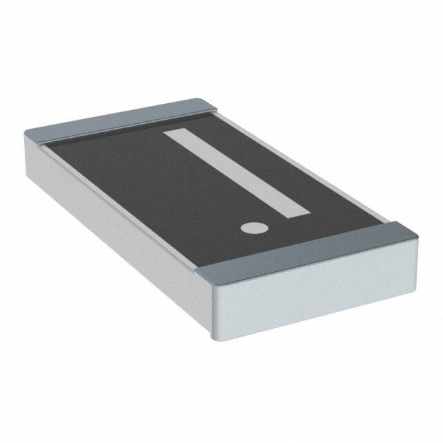

High Power Thin Film Chip Terminator ■PCS Series、HPT Series Features ・ Small high power chip terminator with aluminum nitride and aluminum oxide substrate ・ Efficient heat dissipation provides high power, anti-surge, overload protection. ・ Wrap around terminals provide easy and reliable soldering. ・ Thin film does not have any innate stress. Therefore, repeated power cycling does not fatigue the element and cause no change in impedance. Applications ・ Wireless base station, wireless communication devices, and high frequency power source ◆Part numbering system HPT 3216 - 50 - T1 Series code(PCS, HPT) Packing quantity: T=Tape (T1/T5), B=Bulk Size : 1005,1608,2012,3216,5025 6432, *6464, *9464H Impedance *HPT series only ◆ Electrical Specification PCS series (Alumina substrate) Type PCS1005 PCS1608 PCS2012 PCS3216 PCS5025 PCS6432 Rated Power 200mW 500mW 1W 2W 5W 10W DC ∼ 3GHz 1.2 1.2 1.2 1.2 1.3 1.2 3.1∼5GHz 1.2 1.2 1.3 1.3 1.4 1.5 5.1∼7.5GHz 1.3 1.3 1.3 1.4 1.5 ー 7.6∼10GHz 1.3 1.3 1.4 1.5 ー ー 10.1∼12.5GHz 1.4 1.4 1.5 ー ー ー 12.6∼15GHz 1.5 1.5 ー ー ー ー Operating temperature -55℃∼ +125℃ Rated operating temperature +70℃ Packaging quantity 100pcs/bag (B) 1000pcs/reel (T1) 5000pcs/reel (T5) HPT series (ALN substrate) PCS Series, HPT Series High frequency surface mount components VSWR Type HPT1608 HPT2012 HPT3216 HPT5025 HPT6432 HPT6464 HPT9464H Rated Power 2.5W 5W 10W 20W 30W 60W 100W DC ∼ 3GHz 1.2 1.2 1.2 1.3 1.3 1.3 1.3 3.1∼5GHz 1.2 1.3 1.3 1.5 1.5 ー ー 5.1∼7.5GHz 1.3 1.3 1.4 ー ー ー ー 7.6∼10GHz 1.3 1.4 1.5 ー ー ー ー 10.1∼12.5GHz 1.4 1.5 ー ー ー ー ー 12.6∼15GHz 1.5 ー ー ー ー ー ー VSWR 87 Operating temperature -40℃∼ +155℃ Rated operating temperature +100℃ at Terminal Packaging quantity 100pcs/bag (B) 1000pcs/reel (T1) 5000pcs/reel (T5) 100pcs/bag (B) 1000pcs/reel (T1) ◆ Dimension, Equivalent Circuit and pin arrangement Equivalent circuit PCS1005 PCS1608 PCS2012 PCS3216 PCS5025 PCS6432 Type Size (inch) L W t L1 L2 L3 PCS1005 0402 1.00±0.10 0.50±0.10 0.30±0.10 0.65±0.10 0.20±0.10 0.15±0.10 PCS1608 0603 1.60±0.15 0.80±0.15 0.40±0.10 1.10±0.15 0.30±0.15 0.20±0.15 PCS2012 0805 2.00±0.15 1.25±0.15 0.40±0.10 1.50±0.15 0.30±0.15 0.20±0.15 PCS3216 1206 3.20±0.20 1.60±0.20 0.40±0.10 2.70±0.20 0.30±0.15 0.20±0.15 PCS5025 2010 5.00±0.20 2.50±0.20 0.40±0.10 4.30±0.20 0.40±0.15 0.30±0.15 PCS6432 2512 6.40±0.20 3.20±0.20 0.40±0.10 5.70±0.20 0.40±0.15 0.30±0.15 HPT1608 HPT2012 HPT3216 HPT5025 HPT 6432 HPT6464 HPT9464H L W t L1 L2 L3 W1 HPT1608 0603 1.60±0.15 0.80±0.15 0.40±0.10 1.10±0.15 0.30±0.15 0.20±0.15 ー HPT2012 0805 2.00±0.15 1.25±0.15 0.40±0.10 1.50±0.15 0.30±0.15 0.20±0.15 ー HPT3216 1206 3.20±0.20 1.60±0.20 0.40±0.10 2.70±0.20 0.30±0.15 0.20±0.15 ー HPT5025 2010 5.00±0.20 2.50±0.20 0.65±0.10 3.60±0.20 0.90±0.20 0.50±0.15 ー HPT6432 2512 6.40±0.20 3.20±0.20 0.65±0.10 5.50±0.20 0.70±0.15 0.20±0.15 ー HPT6464 2525 6.30±0.20 6.30±0.20 0.65±0.10 4.90±0.20 0.65±0.15 0.75±0.15 3.05±0.20 HPT9464H 3725 9.40±0.20 6.30±0.20 0.65±0.10 7.10±0.20 1.15±0.15 1.15±0.15 3.00±0.20 PCS Series, HPT Series Size (inch) High frequency surface mount components Type (unit:mm) 88 High Power Thin Film Chip Terminator ■PCS Series、HPT Series ◆Recommended land patterns (soldering footprints) PCS / HPT a c b Type a b c Type a b c PCS1005 0.70 0.20 0.70 HPT1608 1.20 0.40 1.20 PCS1608 1.20 0.30 1.20 HPT2012 1.60 0.40 1.50 PCS2012 1.20 0.45 1.60 HPT3216 2.00 0.40 2.00 PCS3216 2.00 0.45 2.00 HPT5025 2.90 0.90 2.90 PCS5025 2.90 0.55 2.90 HPT6432 3.60 0.70 3.60 PCS6432 3.60 0.55 3.60 HPT6464 3.30 1.15 6.80 HPT9464H 3.30 1.15 (unit:mm) 6.80 (unit:mm) ◆Mounting example Pay special care to heat dissipation when this product is used at maximum rated power. Mounting example of these series Resistor element Input terminal Ground Thermal vias Above diagram shows a mounting example with thermal bias dissipating heat to the ground. Depending on the application, a heat sink might be needed closely contacting to the bottom of the product. ◆Derating Curve 〇 PCS Series 100 50 0 -55     0      50 70  100 125 Ambient tempareture(℃) 89 〇 HPT Series 155 Rated Power ratio % Rated Power ratio(%) PCS Series, HPT Series High frequency surface mount components Mounting surface 100 50 0 -40     0      50     100   Terminal temperature(℃) 155 ◆ High frequency characteristics PCS1608 VSWR 1.6 1.5 VSWR 1.4 1.3 1.2 1.1 1.0 0     2     4     6     8     10    12    14    16    18 frequency(GHz) PCS3216 VSWR 1.6 1.5 VSWR 1.4 1.3 1.2 1.1 1.0 0        2        4        6        8        10       12 frequency(GHz) PCS6432 VSWR 1.6 1.5 VSWR 1.4 1.3 1.2 1.1 1.0 3      4      5      6      7      8 High frequency surface mount components 0      1       2     frequency(GHz) PCS Series, HPT Series 90
