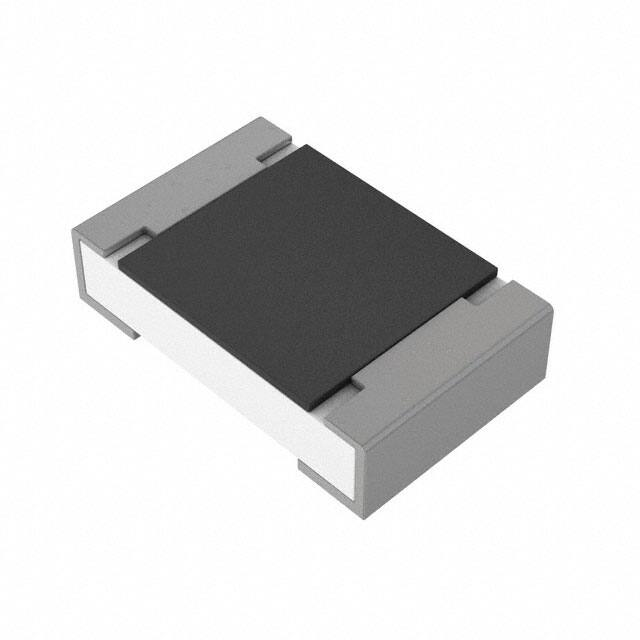

Stackpole Electronics, Inc. RTAN Series Resistive Product Solutions Tantalum Nitride Thin Film Chip Resistor Features: • • • • • • • • TaN thin film resistor Self-passivating technology is impervious to moisture Sulfur resistant (per ASTM B809-95 humid vapor test) Meets or exceeds 85°C / 85% R.H. at 10% rated power humidity test AEC-Q200 qualified 100% RoHS compliant and lead free without exemption Halogen free REACH compliant Applications: • • • • Automotive electronics Medical equipment Measuring instrumentation Communication devices Electrical Specifications Type/Code Power Rating (W) @ 85ºC Maximum Working Voltage (V) RTAN0402 0.063 50 RTAN0603 0.15 75 RTAN0805 0.2 100 RTAN1206 0.4 200 (1) Lesser of √ P*R or maximum working voltage. (1) Maximum Overload Voltage (V) TCR (ppm/ºC) 100 150 200 400 ± 10 ± 15 ± 25 ± 50 Ohmic Range (Ω) and Tolerance 0.05%, 0.1%, 0.25%, 0.5%, 1% 40.2 - 34.8K 40.2 - 130K 10 - 348K 10 - 1M Mechanical Specifications Type/Code RTAN0402 RTAN0603 RTAN0805 RTAN1206 L 0.039 1.00 0.061 1.55 0.079 2.00 0.122 3.10 ± ± ± ± ± ± ± ± W 0.004 0.10 0.004 0.10 0.004 0.10 0.004 0.10 0.020 0.50 0.031 0.80 0.049 1.25 0.063 1.60 ± ± ± ± ± ± ± ± Rev Date: 01/11/2021 This specification may be changed at any time without prior notice. Please confirm technical specifications before you order and/or use. A 0.002 0.05 0.004 0.10 0.004 0.10 0.004 0.10 0.010 0.25 0.012 0.30 0.014 0.35 0.016 0.40 1 ± ± ± ± ± ± ± ± B 0.006 0.15 0.008 0.20 0.008 0.20 0.008 0.20 0.012 0.30 0.012 0.30 0.016 0.40 0.016 0.40 ± ± ± ± ± ± ± ± t 0.004 0.10 0.006 0.15 0.008 0.20 0.008 0.20 0.012 0.30 0.018 0.45 0.020 0.50 0.024 0.60 ± ± ± ± ± ± ± ± Unit 0.004 0.10 0.006 0.15 0.006 0.15 0.006 0.15 inches mm inches mm inches mm inches mm www.seielect.com marketing@seielect.com Stackpole Electronics, Inc. RTAN Series Resistive Product Solutions Tantalum Nitride Thin Film Chip Resistor Power Derating Curve: 100 -55ºC 85ºC Rated Power (%) 80 60 40 20 0 -60 155ºC 0 20 40 60 80 100 120 140 160 180 Ambient Temperature (ºC) Performance Characteristics Test Test Method Test Specification Test Condition DC resistance values measurement Temperature Coefficient of Resistance (TCR) Electrical Characteristics Natural resistance change per change in degree centigrade IEC-60115-1 4.8 Within the specified tolerance R2 - R1 R1 (t2 - t1) x 106 (ppm/ºC) t1: 20°C +5°C / -1°C R1: Resistance at reference temperature (20°C +5°C / -1°C) R2: Resistance at test temperature (-55°C or +125°C) Permanent resistance change after a 5 second application of a voltage 2.5 times RCWV or the maximum overload voltage specified in the above list, whichever is less. Un-mounted chips completely immersed for 10 ± 1 second in a SAC solder bath at 260ºC ± 5°C Un-mounted chips completely immersed for 2 ± 0.5 seconds in a SAC solder bat at 235ºC ± 5°C Test -55ºC to 125°C / dwell time 15 minutes/max. transfer time 20 seconds 1000 cycles 1000 +48 / -0 hours, loaded with 10% rated power in humidity chamber controller at +85°C / 85% R.H. 1000 +48 / -0 hours, loaded with RCWV or Vmax in chamber controller 85ºC ± 2°C, 1.5 hours ON and 0.5 hours OFF Short Time Overload IEC-60115-1 4.13 Resistance to Soldering Heat AEC-Q200-15 Solderability IEC-60068-2-58 Thermal Shock MIL-STD-202 Method 107 No visible damage Δ R/R max. ± (0.1% + 0.02Ω) Good tinning (>95% covered) No visible damage No visible damage ΔR/R max. ± (0.1%+0.02Ω) Biased Humidity AEC-Q200-7 Δ R/R max. ± (0.1% + 0.02Ω) Load Life IEC-60115-1 4.25 Δ R/R max. ± (0.1% + 0.02Ω) High Temperature Load Life High Temperature Exposure AEC-Q200-8 MIL-STD-202-108 Δ R/R max. ± (0.1% + 0.02Ω) 1000 hours at 125ºC ± 2°C, loaded with rated power continuously AEC-Q200-3 Δ R/R max. ± (0.1% + 0.02Ω) Δ R/R max. ± (0.1% + 0.02Ω) AEC-Q200-6 MIL-STD-202 Δ R/R max. ± (0.1% + 0.02Ω) Method 106 MIL-STD-202 Mechanical Shock Δ R/R max. ± (0.1% + 0.02Ω) Method 213 MIL-STD-202 Vibration Δ R/R max. ± (0.1% + 0.02Ω) Method 204 Terminal Strength AEC-Q200-6 No breaking Bending Strength AEC-Q200-21 Δ R/R max. ± (0.1% + 0.02Ω) Storage conditions: Temperature 5ºC to 40°C. Humidity: 20% to 70% R.H. Operating temperature range is -55°C to 155°C Moisture Resistance Rev Date: 01/11/2021 This specification may be changed at any time without prior notice. Please confirm technical specifications before you order and/or use. 2 1000 hours at 125°C, unpowered 65ºC ± 2°C, 80% ~ 100% R.H., 10 cycles, 24 hours/cycle 1/2 Sine Pulse / 150g Peak / Velocity 15.4 foot/second 5g for 20 minutes, 12 cycles each of 3 orientations 1 kg for 60 seconds Bending 2 mm for 60 seconds www.seielect.com marketing@seielect.com Stackpole Electronics, Inc. RTAN Series Resistive Product Solutions Tantalum Nitride Thin Film Chip Resistor Soldering Condition: The robust construction of chip resistors allows them to be completely immersed in a solder bath of 260°C for 10 seconds. Therefore, it is possible to mount surface mount resistors on one side of a PCB and other discrete components on the reverse (mixed PCBs). Surface mount resistors are tested for solderability at 235°C during 2 seconds within lead-free solder bath. The test condition for no leaching is 260°C for 30 seconds. Typical examples of soldering profile and condition that provide reliable joints without any damage are given on the picture on the right. Rev Date: 01/11/2021 This specification may be changed at any time without prior notice. Please confirm technical specifications before you order and/or use. 3 www.seielect.com marketing@seielect.com Stackpole Electronics, Inc. RTAN Series Resistive Product Solutions Tantalum Nitride Thin Film Chip Resistor Packaging Specifications Type/Code RTAN0402 RTAN0603 RTAN0805 RTAN1206 Type/Code RTAN0402 RTAN0603 RTAN0805 RTAN1206 A ± 0.004 ± 0.10 ± 0.008 ± 0.20 ± 0.008 ± 0.20 ± 0.008 ± 0.20 P1 0.079 ± 0.004 2.00 ± 0.10 0.157 ± 0.004 4.00 ± 0.10 0.157 ± 0.004 4.00 ± 0.10 0.157 ± 0.004 4.00 ± 0.10 0.047 1.20 0.075 1.90 0.094 2.40 0.142 3.60 B ± 0.004 ± 0.10 ± 0.008 ± 0.20 ± 0.008 ± 0.20 ± 0.008 ± 0.20 P0 0.157 ± 0.004 4.00 ± 0.10 0.157 ± 0.004 4.00 ± 0.10 0.157 ± 0.004 4.00 ± 0.10 0.157 ± 0.004 4.00 ± 0.10 W ± 0.012 ± 0.30 ± 0.012 ± 0.30 ± 0.012 ± 0.30 ± 0.012 ± 0.30 D 0.059 ± 0.004 1.50 ± 0.10 0.059 ± 0.004 1.50 ± 0.10 0.059 ± 0.004 1.50 ± 0.10 0.059 ± 0.004 1.50 ± 0.10 0.028 0.70 0.043 1.10 0.065 1.65 0.079 2.00 0.315 8.00 0.315 8.00 0.315 8.00 0.315 8.00 F ± ± ± ± ± ± ± ± T 0.016 ± 0.40 ± 0.026 ± 0.65 ± 0.039 1.00 0.039 1.00 0.138 3.50 0.138 3.50 0.138 3.50 0.138 3.50 0.008 0.20 0.008 0.20 0.008 0.20 0.002 0.05 0.002 0.05 0.002 0.05 max. max. max. max. 0.069 1.75 0.069 1.75 0.069 1.75 0.069 1.75 Unit inches mm inches mm inches mm inches mm E ± ± ± ± ± ± ± ± 0.004 0.10 0.004 0.10 0.004 0.10 0.004 0.10 Unit inches mm inches mm inches mm inches mm Reel Specifications Type/Code A B C D Unit All Sizes 7.008 ± 0.079 178.00 ± 2.00 2.362 ± 0.039 60.00 ± 1.00 0.512 ± 0.008 13.00 ± 0.20 0.354 ± 0.020 9.00 ± 0.50 inches mm Rev Date: 01/11/2021 This specification may be changed at any time without prior notice. Please confirm technical specifications before you order and/or use. 4 www.seielect.com marketing@seielect.com Stackpole Electronics, Inc. RTAN Series Resistive Product Solutions Tantalum Nitride Thin Film Chip Resistor Part Marking Specifications 1% Marking The nominal resistance is marked on the surface of the overcoating with the use of 4 digit markings. 0402 are not marked 5% Marking The nominal resistance is marked on the surface of the overcoating with the use of 3 digit markings. 0402 are not marked For shared E24/E96 values, 1% tolerance product may be marked with three digit marking instead of the standard four digit marking for all other E96 values. All E24 values available in 1% tolerance are also marked with three digit marking. Mark Instructions for 0603 1% Chip Resistors (per EIA-J) A two-digit number is assigned to each standard R-Value (E96) as shown in the chart below. This is followed by one alpha character which is used as a multiplier. Each letter from "Y" to "F" represents a specific multiplier as follows: Y = 0.1 C = 1,000 X= 1 D = 10,000 A = 10 E = 100,000 B = 100 F = 1,000,000 EXAMPLE: Chip Marking 01B 25C 93D Explanation "01" = 10 ohm and "B" = 100 "25" = 17.8 ohm and "C" = 1,000 "93" = 90.9 ohm and "D" = 10,000 Value 10 x 100 = 1 Kohm 17.8 x 1,000 = 17.8 Kohm 90.9 x 10,000 = 909 Kohm E96 1% 10.0 10.2 10.5 10.7 11.0 11.3 11.5 11.8 12.1 12.4 12.7 13.0 13.3 13.7 14.0 14.3 # 01 02 03 04 05 06 07 08 09 10 11 12 13 14 15 16 1% 14.7 15.0 15.4 15.8 16.2 16.5 16.9 17.4 17.8 18.2 18.7 19.1 19.6 20.0 20.5 21.0 # 17 18 19 20 21 22 23 24 25 26 27 28 29 30 31 32 1% 21.5 22.1 22.6 23.2 23.7 24.3 24.9 25.5 26.1 26.7 27.4 28.0 28.7 29.4 30.1 30.9 Rev Date: 01/11/2021 This specification may be changed at any time without prior notice. Please confirm technical specifications before you order and/or use. # 33 34 35 36 37 38 39 40 41 42 43 44 45 46 47 48 1% 31.6 32.4 33.2 34.0 34.8 35.7 36.5 37.4 38.3 39.2 40.2 41.2 42.2 43.2 44.2 45.3 5 # 49 50 51 52 53 54 55 56 57 58 59 60 61 62 63 64 1% 46.4 47.5 48.7 49.9 51.1 52.3 53.6 54.9 56.2 57.6 59.0 60.4 61.9 63.4 64.9 66.5 # 65 66 67 68 69 70 71 72 73 74 75 76 77 78 79 80 1% 68.1 69.8 71.5 73.2 75.0 76.8 78.7 80.6 82.5 84.5 86.6 88.7 90.9 93.1 95.3 97.6 # 81 82 83 84 85 86 87 88 89 90 91 92 93 94 95 96 www.seielect.com marketing@seielect.com Stackpole Electronics, Inc. RTAN Series Resistive Product Solutions Tantalum Nitride Thin Film Chip Resistor RoHS Compliance Stackpole Electronics has joined the worldwide effort to reduce the amount of lead in electronic components and to meet the various regulatory requirements now prevalent, such as the European Union’s directive regarding “Restrictions on Hazardous Substances” (RoHS 3). As part of this ongoing program, we periodically update this document with the status regarding the availability of our compliant components. All our standard part numbers are compliant to EU Directive 2011/65/EU of the European Parliament as amended by Directive (EU) 2015/863/EU as regards the list of restricted substances. RoHS Compliance Status Standard Package / Termination Series RoHS Type Compliant Standard Product Series Description RTAN Tantalum Nitride Thin Film Chip Resistor SMD Lead-Free Termination Composition Lead-Free Mfg. Effective Date (Std Product Series) Lead-Free Effective Date Code (YY/WW) 100% Matte Sn Always Always YES “Conflict Metals” Commitment We at Stackpole Electronics, Inc. are joined with our industry in opposing the use of metals mined in the “conflict region” of the eastern Democratic Republic of the Congo (DRC) in our products. Recognizing that the supply chain for metals used in the electronics industry is very complex, we work closely with our own suppliers to verify to the extent possible that the materials and products we supply do not contain metals sourced from this conflict region. As such, we are in compliance with the requirements of Dodd-Frank Act regarding Conflict Minerals. Compliance to “REACH” We certify that all passive components supplied by Stackpole Electronics, Inc. are SVHC (Substances of Very High Concern) free and compliant with the requirements of EU Directive 1907/2006/EC, “The Registration, Evaluation, Authorization and Restriction of Chemicals”, otherwise referred to as REACH. Contact us for complete list of REACH Substance Candidate List. Environmental Policy It is the policy of Stackpole Electronics, Inc. (SEI) to protect the environment in all localities in which we operate. We continually strive to improve our effect on the environment. We observe all applicable laws and regulations regarding the protection of our environment and all requests related to the environment to which we have agreed. We are committed to the prevention of all forms of pollution. How to Order 1 2 3 4 5 6 7 8 9 10 11 12 13 14 15 R T A N 0 8 0 5 C T E 1 0 R 0 Product Series RTAN Tantalum Nitride Thin Film Size Code 0402 0603 0805 1206 Code A B C D F Tolerance (1) Tol Value 0.05% 0.1% E24, E96 0.25% 0.5% 1% Code T K Description Reel Paper Tape Reel Paper Tape Packaging Size 0402 0603, 0805, 1206 All sizes Quantity 10000 5000 1000 TCR Code ppm/ºC C ±50 E ±25 S ±15 T ±10 Resistance Value Four characters with the multiplier used as the decimal holder. 10 ohm = 10R0 130 Kohm = 130K 1 Mohm = 1M00 (1) E192 values may be available. Rev Date: 01/11/2021 This specification may be changed at any time without prior notice. Please confirm technical specifications before you order and/or use. 6 www.seielect.com marketing@seielect.com

物料型号: RTAN Series Tantalum Nitride Thin Film Chip Resistor
器件简介: - 制造商: Stackpole Electronics, Inc. - 特点: TaN薄膜电阻、自钝化技术、抗潮湿、抗硫、符合AEC-Q200标准、100%符合RoHS指令、无卤素、符合REACH标准。
引脚分配: 文档中没有提供具体的引脚分配信息,但提到了保护涂层、端部终止、电阻层、陶瓷基板等组件。
参数特性: - 电气规格: 提供了不同型号(RTAN0402, RTAN0603, RTAN0805, RTAN1206)的功率额定值、最大工作电压、最大过载电压、电阻温度系数(TCR)和欧姆范围及公差。 - 机械规格: 提供了不同型号的尺寸参数。
功能详解: - 应用领域: 汽车电子、医疗设备、测量仪器、通信设备等。 - 性能特性: 包括直流电阻值测量、短期过载、耐焊热性、焊接性、热冲击、偏置湿度、负载寿命、高温负载寿命、高温暴露、耐湿性、机械冲击、振动、端部强度和弯曲强度等测试。
应用信息: - 操作温度范围: -55°C 至 155°C - 存储条件: 温度5ºC至40ºC,湿度20%至70% R.H.
封装信息: - 提供了不同型号的封装尺寸和包装规格。
