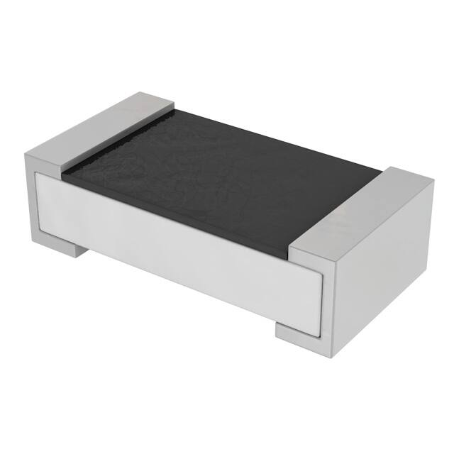

    贴片电阻 0603 39MΩ 39mΩ ±5% 1/2W ±100ppm/℃
PE0603JRF570R039L 数据手册
DATA SHEET CURRENT SENSOR - LOW TCR AUTOMOTIVE GRADE PE_L series 5%, 1%, 0.5%, 0.1% sizes 0201/0402/ 0603/ 0805/ 1206/ 2010/ 2512 Product specification – September 8, 2020 V.9 RoHS compliant & Halogen free Product specification Chip Resistor Surface Mount SERIES PE_L 0201 /0402/ 0603/ 0805/ 1206/ 2010/ 2512 2 12 SCOPE ORDERING INFORMATION - GLOBAL PART NUMBER This specification describes PE series current sensor - low TCR with lead-free terminations made by metal film with ceramic substrate. Global part numbers are identified by the series, size, tolerance, packing type, temperature coefficient, taping reel and resistance value. APPLICATIONS  Consumer goods  Computer  Telecom / Datacom  Industrial / Power supply  Automotive  Alternative Energy FEATURES  AEC-Q200 qualified  Halogen-free Epoxy  RoHS compliant  Reduce environmentally hazardous wastes  High component and equipment reliability  None forbidden-materials used in products/production  Low resistances applied to current sensing GLOBAL PART NUMBER PE XXXX X X X XX XXXX L (1) (2) (3) (4) (5) (6) (7) (1) SIZE 0201/ 0402/ 0603/ 0805/ 1206/ 2010/ 2512 (2) TOLERANCE B = ± 0.1% (only for 0805, > 50mΩ) D = ± 0.5% ( ≥10mΩ) F = ± 1% J = ± 5% (3) PACKAGING TYPE R = Paper/ PE taping reel K = Embossed taping reel (4) TEMPERATURE COEFFICIENT OF RESISTANCE E = ± 50 ppm/°C M = ± 75 ppm/°C F = ± 100 ppm/°C J = ± 350 ppm/°C (5) TAPING REEL 07 / 7W / 7T / 47 / 57= 7 inch dia. Reel and specific rated power. Detailed power rating are shown in the Table 2. (6) RESISTANCE VALUE 5 mΩ to 910 mΩ There are 3~5 digits indicated the resistance value. Letter R is decimal point. Detailed coding rules of resistance are shown in the table of “Resistance rule of global part number”. (7) DEFAULT CODE Letter L is the system default code for ordering only. (Note) Resistance rule of global part number Resistance code rule Example 0R001 = 1 mΩ 0RXXX (1 to 910 mΩ) 0R1 = 100 mΩ ORDERING EXAMPLE The ordering code of a PE2512 1W chip resistor, value 0.1 Ω with ± 1% tolerance, supplied in 7-inch tape reel is: PE2512FKM070R1L 0R91 = 910 mΩ NOTE 1. All our RSMD products are RoHS compliant. "LFP" of the internal 2D reel label mentions "Lead-Free Process" www.yageo.com Sep. 08, 2020 V.9 Product specification Chip Resistor Surface Mount SERIES PE_L 0201 /0402/ 0603/ 0805/ 1206/ 2010/ 2512 3 12 MARKING PE0201 / PE0402 No marking YNSC123_1 Fig. 1 PE0603 5mΩ ≤ R ≤ 50mΩ 51mΩ ≤ R ≤ 99mΩ 100mΩ ≤ R ≤ 910mΩ 10 51 100 YNSC140 YNSC145 YNSC144 Fig. 2 Value = 10 mΩ Value = 51 mΩ Value = 100 mΩ 2 digits resistance range: 5mΩ ≤ R ≤ 99mΩ 3 digits resistance range: 100mΩ ≤ R ≤ 910mΩ PE0805 5mΩ ≤ R ≤ 50mΩ 51mΩ ≤ R ≤ 910mΩ 3 digits 051 010 YNSC138 YNSC145 Fig. 3 Value = 10 mΩ Value = 51 mΩ PE1206 5mΩ ≤ R ≤ 50mΩ 51mΩ ≤ R ≤ 910mΩ R010 R051 YNSC146 YNSC139 Fig. 4 Value = 10 mΩ Value = 51 mΩ 4 digits The “R” is used as a decimal point; the other 3 digits are significant. PE2010 / PE2512 5mΩ ≤ R ≤ 100mΩ 100mΩ < R ≤ 910mΩ R510 R010 YNSC158 YNSC139 Fig. 5 Value = 10 mΩ Value = 510 mΩ 4 digits The “R” is used as a decimal point; the other 3 digits are significant. Outlines For dimensions, please refer to Table 1 5mΩ ≤ R ≤ 50mΩ R010 51mΩ ≤ R ≤ 910mΩ R051 YNSC143 Fig. 5 Chip resistor outlines www.yageo.com Sep. 08, 2020 V.9 Product specification Chip Resistor Surface Mount PE_L SERIES 0201 /0402/ 0603/ 0805/ 1206/ 2010/ 2512 4 12 DIMENSION Table 1 For outlines, please refer to Fig. 4 TYPE RESISTANCE RANGE PE0201 PE0402 PE0603 PE0805 PE1206 PE2010 PE2512 L (mm) W (mm) H (mm) I1 (mm) 50 mΩ ≤ R ≤ 910 mΩ 0.60± 0.03 0.31± 0.04 0.27± 0.04 0.14± 0.06 10 mΩ ≤ R ≤ 910 mΩ 1.00+0.10/-0.15 0.50+0.10/-0.15 0.35± 0.15 0.25± 0.10 5 mΩ ≤ R ≤ 50 mΩ 1.60± 0.20 0.76± 0.25 0.35± 0.25 0.38± 0.25 51 mΩ ≤ R ≤ 910 mΩ 1.52± 0.25 0.76± 0.25 0.45± 0.10 0.38± 0.25 5 mΩ ≤ R ≤ 6 mΩ 2.03± 0.25 1.27± 0.25 0.35± 0.25 0.73± 0.25 7 mΩ ≤ R ≤ 50 mΩ 2.03± 0.25 1.27± 0.25 0.35± 0.25 0.38± 0.25 51 mΩ ≤ R ≤ 910 mΩ 2.03± 0.25 1.27± 0.25 0.55± 0.10 0.35± 0.20 5 mΩ 3.20± 0.25 1.60± 0.25 0.64± 0.25 0.64± 0.25 6 mΩ ≤ R ≤ 910 mΩ 3.20± 0.25 1.60± 0.25 0.64± 0.25 0.51± 0.25 5 mΩ ≤ R ≤ 6 mΩ 5.08± 0.25 2.54± 0.25 0.64± 0.25 1.47± 0.25 7 mΩ ≤ R ≤ 910 mΩ 5.08± 0.25 2.54± 0.25 0.64± 0.25 0.51± 0.25 6 mΩ ≤ R ≤ 910 mΩ 6.35± 0.25 3.18± 0.25 0.64± 0.25 0.76± 0.25 Note: 1. For relevant physical dimensions, please refer to construction outlines. 2. Please contact with sales offices, distributors and representatives in your region before ordering. www.yageo.com Sep. 08, 2020 V.9 Product specification Chip Resistor Surface Mount SERIES PE_L 0201 /0402/ 0603/ 0805/ 1206/ 2010/ 2512 5 12 ELECTRICAL CHARACTERISTICS Table 2 POWER RATING (1) SERIES SIZE 07 7W 0201 1/20W 1/10W Fig. 4 Chip outlines 0402resistor 1/16W 1/8W 0603 PE 0805 RESISTANCE RANGE TOLERANCE TEMPERATURE COEFFICIENT OF RESISTANCE 7T 47 57 --- --- --- 50 mΩ ≤ R ≤ 910 mΩ 50 mΩ ≤ R ≤ 70 mΩ ± 350 ppm/°C 70 mΩ < R ≤ 910 mΩ ± 100 ppm/°C --- 10 mΩ ≤ R ≤ 910 mΩ ± 100 ppm/°C 5 mΩ ≤ R ≤ 910 mΩ ± 75 ppm/°C ± 100 ppm/°C 1/6W 1/4W 1/10W 1/5W 1/3W 2/5W 1/2W ± 0.1% (only for 0805, >50mΩ) 1/8W 1/4W 1/3W 1/2W --- ± 0.5%(≥10 mΩ) 5 mΩ ≤ R ≤ 19 mΩ ± 75 ppm/°C, ± 100 ppm/°C 20 mΩ ≤ R ≤ 910 mΩ ± 50 ppm/°C, ± 75 ppm/°C, ± 100 ppm/°C --- 5 mΩ ≤ R ≤ 910 mΩ --- 6 mΩ ≤ R ≤ 910 mΩ ± 50 ppm/°C ± 75 ppm/°C ± 100 ppm/°C 1206 1/4W 1/2W --- 1W --- 2010 1/2W 1W --- --- 2512 1W 2W --- --- ± 1% ± 5% Note: 1. Global part number (code 10 - 11) 2. Please contact with sales offices, distributors and representatives in your region before ordering. FUNCTIONAL DESCRIPTION OPERATING TEMPERATURE RANGE PE0201 to PE0402 Range: -55°C to +125°C (Fig. 6-1) PE0603 to PE2512 Range: -55°C to +170°C (Fig. 6-2) handbook, P halfpage MLB206 max (%Prated) 100 POWER RATING Standard rated power at 70°C: PE0201 = 1/20W PE0402 = 1/16W PE0603 = 1/10W PE0805 = 1/8W PE1206 = 1/4W PE2010 = 1/2W PE2512 = 1W For detail power value, please refer to Table 2. 50 0 55 Fig. 6-1 0 50 70 100 125 o Tamb ( C) Maximum dissipation (P max ) in percentage of rated power as a function of the operating ambient temperature (T amb ) RATED VOLTAGE The DC or AC (rms) continuous working voltage corresponding to the rated power is determined by the following formula: V= MRA633 P (%Prated) 100 (PxR ) Where 50 V = Continuous rated DC or AC (rms) working voltage (V) 0 55 P = Rated power (W) R = Resistance value (Ω) Fig. 6-2 0 50 70 100 170 Tamb ( C) Maximum dissipation (P max ) in percentage of rated power as a function of the operating ambient temperature (T amb ) www.yageo.com Sep. 08, 2020 V.9 Product specification Chip Resistor Surface Mount SERIES PE_L 0201 /0402/ 0603/ 0805/ 1206/ 2010/ 2512 6 12 PULSE LOAD BEHAVIOR PACKING STYLE AND PACKAGING QUANTITY Table 3 Packing style and packaging quantity PACKING STYLE REEL DIMENSION PE0201 PE0402 PE0603 PE0805 PE1206 PE2010 PE2512 Paper/PE taping reel (R) 7" (178 mm) 10,000 10,000 5,000 5,000 4,000 --- --- Embossed taping reel (K) 7" (178 mm) --- --- --- --- --- 4,000 4,000 PAPER/PE TAPE P0 T D0 P2 E F cover tape W B0 A0 P1 MBG251 Fig. 7 Paper/PE Tape www.yageo.com Sep. 08, 2020 V.9 Product specification Chip Resistor Surface Mount SERIES PE_L 7 12 0201 /0402/ 0603/ 0805/ 1206/ 2010/ 2512 Table 4 Dimensions of Paper/PE tape for relevant chip resistors size Unit: mm SYMBOL SIZE A0 B0 W E F P0 P1 P2 Ø D0 T PE0201 0.41± 0.10 0.70± 0.10 8.00± 0.30 1.75± 0.10 3.50± 0.10 4.00± 0.10 2.00± 0.05 2.00± 0.05 1.50± 0.10 0.40± 0.10 PE0402 0.65± 0.10 1.15± 0.10 8.00± 0.30 1.75± 0.10 3.50± 0.10 4.00± 0.10 2.00± 0.05 2.00± 0.05 1.50± 0.10 0.53± 0.10 PE0603 1.20± 0.15 1.90± 0.15 8.00± 0.30 1.75± 0.10 3.50± 0.10 4.00± 0.10 4.00± 0.10 2.00± 0.10 1.50± 0.10 0.55± 0.15 PE0805 1.60± 0.15 2.30± 0.15 8.00± 0.30 1.75± 0.10 3.50± 0.10 4.00± 0.10 4.00± 0.10 2.00± 0.10 1.50± 0.10 0.85± 0.15 PE1206 1.90± 0.10 3.50± 0.10 8.00± 0.30 1.75± 0.10 3.50± 0.10 4.00± 0.10 4.00± 0.10 2.00± 0.10 1.50± 0.10 0.85± 0.15 EMBOSSED TAPE P0 D0 P2 E F cover tape W B0 MBG516_b A0 T D1 P1 direction of unreeling Fig. 8 Embossed Tape Table 5 Dimensions of embossed tape for relevant chip resistors size SIZE SYMBOL A0 Unit: mm B0 W E F P0 P1 P2 Ø D0 Ø D1 T PE2010 3.00± 0.15 5.60± 0.15 12.10± 0.30 1.75± 0.10 5.50± 0.10 4.00± 0.10 4.00± 0.10 2.00± 0.10 1.50± 0.10 1.50± 0.10 0.80± 0.15 PE2512 3.40± 0.15 6.70± 0.15 12.10± 0.30 1.75± 0.10 5.50± 0.10 4.00± 0.10 4.00± 0.10 2.00± 0.10 1.50± 0.10 1.50± 0.10 0.80± 0.15 www.yageo.com Sep. 08, 2020 V.9 Product specification Chip Resistor Surface Mount SERIES PE_L 0201 /0402/ 0603/ 0805/ 1206/ 2010/ 2512 8 12 REEL SPECIFICATION W2 D C N A Fig. 9 Reel HBK039_a W1 Table 6 Dimensions of reel specification for relevant chip resistors size QUANTITY PER REEL SIZE REEL SIZE 8 mm TAPE WIDE 7" PE0201 10,000 PE0402 10,000 PE0603 5000 PE0805 5000 PE1206 4000 PE2010 4000 -- PE2512 4000 -- (Ø 178 mm) 7" (Ø 178 mm) 7" (Ø 178 mm) 7" (Ø 178 mm) 7" (Ø 178 mm) SYMBOL Unit: mm 12 mm TAPE WIDE 24 mm TAPE WIDE --- --- 180.0+0/-3 60.0+1/-0 13.0± 0.2 21.0± 0.8 9.0± 0.30 12.4 --- --- 180.0+0/-3 60.0+1/-0 13.0± 0.2 21.0± 0.8 9.0± 0.30 12.4 -- -- 180.0+0/-3 60.0+1/-0 13.0± 0.2 21.0± 0.8 8.4 +1/-0 12.4 -- -- 180.0+0/-3 60.0+1/-0 13.0± 0.2 21.0± 0.8 8.4 +1/-0 12.4 -- -- 180.0+0/-3 60.0+1/-0 13.0± 0.2 21.0± 0.8 8.4 +1/-0 12.4 -- 180.0+0/-3 60.0+1/-0 13.0± 0.2 21.0± 0.8 12.3 +1/-0 18.4 -- 180.0+0/-3 60.0+1/-0 13.0± 0.2 21.0± 0.8 12.3 +1/-0 18.4 7" (Ø 178 mm) 7" (Ø 178 mm) A N C D W1 W2 MAX. LEADER/TRAILER TAPE SPECIFICATION leader end handbook, full pagewidth empty compartments with cover tape (min. 240 mm) trailer end trailer (max. 260 mm) cover tape only leader 400 mm CCB325 Fig.10 Leader/Trailer Tape www.yageo.com Sep. 08, 2020 V.9 Product specification Chip Resistor Surface Mount PE_L SERIES 0201 /0402/ 0603/ 0805/ 1206/ 2010/ 2512 9 12 FOOTPRINT AND SOLDERING PROFILES For recommended soldering profiles, please refer to data sheet “Chip resistors mounting”. FOOTPRINT Fig. 11 Single resistor chips recommended dimensions of footprints Table 7 Footprint dimensions SIZE RESISTANCE RANGE PE0201 Unit: mm A B C D 50 mΩ ≤ R ≤ 910 mΩ 1.00 0.30 0.35 0.40 PE0402 10 mΩ ≤ R ≤ 910 mΩ 1.45 0.35 0.55 0.55 PE0603 5 mΩ ≤ R ≤ 910 mΩ 2.52 0.50 1.01 1.01 PE0805 5 mΩ ≤ R ≤ 910 mΩ 2.54 0.50 1.02 1.27 PE1206 5 mΩ ≤ R ≤ 910 mΩ 3.90 0.76 1.57 1.78 5 mΩ ≤ R ≤ 6 mΩ 6.12 1.40 2.36 3.05 7 mΩ ≤ R ≤ 910 mΩ 6.10 3.30 1.40 3.05 6 mΩ 7.40 3.18 2.11 3.68 7 mΩ ≤ R ≤ 910 mΩ 7.36 4.06 1.65 3.68 PE2010 PE2512 www.yageo.com Sep. 08, 2020 V.9 Product specification Chip Resistor Surface Mount PE_L SERIES 0201 /0402/ 0603/ 0805/ 1206/ 2010/ 2512 10 12 TESTS AND REQUIREMENTS Table 8 Test condition, procedure and requirements TEST TEST METHOD PROCEDURE Life/ Operational Life/ Endurance MIL-STD-202G-method 108 1,000 hours at 70± 2 °C applied RCWV 1.5 hours on, 0.5 hour off, still air required High Temperature Exposure/ Endurance at Upper Category Temperature MIL-STD-202G-method 108 IEC 60115-1 4.25.1 IEC 60115-1 4.25.3 1,000 hours at maximum operating temperature depending on specification, unpowered REQUIREMENTS ± (1%+0.0005 Ω) ± (1%+0.0005 Ω) No direct impingement of forced air to the parts Tolerances: 0201/0402 125± 3℃ 0603 and above 170± 3℃ Moisture Resistance MIL-STD-202G-method 106 Each temperature / humidity cycle is defined at 8 hours (method 106F), 3 cycles / 24 hours for 10d with 25 °C / 65 °C 95% R.H, without steps 7a & 7b, unpowered 0201: ± (5%+0.0005 Ω) Others: ± (0.5%+0.0005 Ω) Parts mounted on test-boards, without condensation on parts Measurement at 24± 2 hours after test conclusion Thermal Shock MIL-STD-202G-method 107 -55/+125 °C ± (1%+0.0005 Ω) Note: Number of cycles required is 300. Devices mounted Maximum transfer time is 20 seconds. Dwell time is 15 minutes. Air – Air Short Time Overload IEC60115-1 4.13 Board Flex/ Bending IEC60115-1 4.33 5 times of rated power for 5 seconds at room temperature ± (1%+0.0005 Ω) Device mounted on PCB test board as described, only 1 board bending required ± (1%+0.0005 Ω) No visible damage No visible damage Bending for 0201: 3mm 0402 and above: 2mm Holding time: minimum 60 seconds Biased Humidity MIL-STD-202 Method 103 1,000 hours at 85ºC/85%R.H. 10% of operating power, no condensation on the devices, circulating air. 0201: ± (5%+0.0005 Ω) Others : ± (1.0%+0.0005 Ω) www.yageo.com Sep. 08, 2020 V.9 Product specification Chip Resistor Surface Mount PE_L SERIES 0201 /0402/ 0603/ 0805/ 1206/ 2010/ 2512 11 12 TEST TEST METHOD PROCEDURE REQUIREMENTS Solderability - Wetting IPC/JEDEC Electrical Test not required Well tinned (≥95% covered) J-STD-002B test B Magnification 50X No visible damage SMD conditions: 1st step: method B, aging 4 hours at 155 °C dry heat 2nd step: leadfree solder bath at 245± 3 °C Dipping time: 3± 0.5 seconds - Leaching - Resistance to Soldering Heat IPC/JEDEC Leadfree solder, 260 °C, 30 seconds immersion time No visible damage J-STD-002B test D MIL-STD-202G-method 210F Condition B, no pre-heat of samples ± (0.5%+0.0005 Ω) IEC 60115-1 4.18 Leadfree solder, 260 °C, 10 seconds immersion time No visible damage Procedure 2 for SMD: devices fluxed and cleaned with isopropanol www.yageo.com Sep. 08, 2020 V.9 Product specification Chip Resistor Surface Mount PE_L SERIES 0201 /0402/ 0603/ 0805/ 1206/ 2010/ 2512 12 12 REVISION HISTORY REVISION DATE TYPE Version 9 Sep. 1, 2020 0603 Version 80805 Jun. 11, 2020 1206 CHANGE NOTIFICATION POWER - DESCRIPTION TOLERANCE 1/8W, 1/4W, 1/3W, 1/2W 1/4W, 1/2W 1/2W, 1W - are constructed Jan. 21, The2019 resistors 5 mΩ ≦ R < 100 mΩ Mar. 04, 2015 2512 Version 0 Feb. 10, 2015 4527 - Update the dimension for ≦PE0805 5mohm 4 mΩ R < 100 mΩ & 6mohm - Update the marking for PE0603 3 mΩ ≦ R < 100 mΩ - Extend resistance range for PE0201 - Extended resistor value for PE2010 and 2512 using outstanding TCR level material, which makes Yageo PF Version 6 Oct.resistors 22, 2018 excellent for current sensing application in battery charger circuit & DC-DC Version 5 Novconverter. 23, 2016 The composition of the resistive material is adjusted to give the PF Version 42010 Dec. 21, 2015 approximate required resistance and is covered with a protective coating, which printed with the Version 3 Aug. 06, 2015 resistance value. Finally, the three external terminations (Ni / matte Tin) are Version 2 Apr. 20, 2015 added, as shown in Fig. 4. Version 1 - - Extend resistor value for PE0603 and 0805, and 0.1% tol for 0805 > 50mΩ - Add in pulse load behavior - Extend resistor value for 0.5% ± 1% 5 mΩ ≦ R < 100 mΩ ± 2% - Update resistance value ± 5% ±75 ppm/°C - Update 0603 to 1206 TCR - Extend resistor value - Update TCR and operating temperature 1 mΩ ≦ R < 100 mΩ 1W, 2W - TEMPERATURE COEFFICIENT OF RESISTANCE - Update dimensions of tape for PE0201 and PE1206 1/10W, 1/5W, 3/10W, 2/5W, 1/2W Version 7 RESISTANCE RANGE 3W 2W, 3W, 5W 1 mΩ ≦sensor R ≦ 50 mΩTCR PE series sizes of - New datasheet for current - low 0201/0402/0603/0805/1206/2010/2512, 0.5%, 1%, and 5% 6 mΩ ≦ R < 1Ω NOTE: 1. PLEASE CONTACT WITH SALES OFFICES, DISTRIBUTORS AND REPRESENTATIVES IN YOUR REGION BEFORE ORDERING “ Yageo reserves all the rights for revising the content of this datasheet without further notification, as long as the products itself are unchanged. Any product change will be announced by PCN.” www.yageo.com Sep. 08, 2020 V.9 Mouser Electronics Authorized Distributor Click to View Pricing, Inventory, Delivery & Lifecycle Information: YAGEO: PE0805FRF470R05L PE0805FRM7W0R033L PE0603FRF070R025L PE0603FRF070R04L PE0603FRF070R05L PE0603FRF7W0R04L PE0805FRF070R025L PE0805FRF070R033L PE0805FRF070R03L PE0805FRF070R047L PE0805FRF070R04L PE0805FRF070R05L PE0805FRF470R025L PE0805FRF7W0R033L PE0805FRF7W0R03L PE0805FRF7W0R04L PE1206FRF070R006L PE1206FRF070R008L PE1206FRF070R012L PE1206FRF070R022L PE1206FRF070R025L PE1206FRF070R033L PE1206FRF070R039L PE1206FRF070R03L PE1206FRF070R047L PE1206FRF070R04L PE1206FRF070R056L PE1206FRF070R05L PE1206FRF070R068L PE1206FRF070R06L PE1206FRF070R18L PE1206FRF470R005L PE1206FRF470R022L PE1206FRF470R033L PE1206FRF470R03L PE1206FRF470R05L PE1206FRF7W0R025L PE1206FRF7W0R033L PE1206FRF7W0R03L PE1206FRF7W0R04L PE1206FRF7W0R05L PE2010FKF070R005L PE2010FKF070R006L PE2010FKF070R007L PE2010FKF070R008L PE2010FKF070R009L PE2010FKF070R012L PE2010FKF070R018L PE2010FKF070R022L PE2010FKF070R025L PE2010FKF070R033L PE2010FKF070R039L PE2010FKF070R03L PE2010FKF070R047L PE2010FKF070R04L PE2010FKF070R056L PE2010FKF070R05L PE2010FKF070R06L PE2010FKF070R07L PE2010FKF070R08L PE2010FKF7W0R005L PE2010FKF7W0R006L PE2010FKF7W0R012L PE2010FKF7W0R025L PE2010FKF7W0R03L PE2010FKF7W0R04L PE2010FKF7W0R05L PE2010JKF070R005L PE2512FKF070R006L PE2512FKF070R007L PE2512FKF070R008L PE2512FKF070R009L PE2512FKF070R012L PE2512FKF070R018L PE2512FKF070R022L PE2512FKF070R025L PE2512FKF070R027L PE2512FKF070R033L PE2512FKF070R039L PE2512FKF070R03L PE2512FKF070R047L PE2512FKF070R04L PE2512FKF070R056L PE2512FKF070R05L PE2512FKF070R062L PE2512FKF070R068L PE2512FKF070R06L PE2512FKF070R082L PE2512FKF7W0R006L PE2512FKF7W0R012L PE2512FKF7W0R022L PE2512FKF7W0R025L PE2512FKF7W0R033L PE2512FKF7W0R03L PE2512FKF7W0R04L PE2512JKF7W0R007L PE0603FRF070R005L PE0603FRF570R05L PE0603FRF7T0R005L PE0603FRF7W0R005L
PE0603JRF570R039L
物料型号:PE_L系列,包括0201、0402、0603、0805、1206、2010、2512等尺寸。
器件简介:这是一系列低温度系数电阻(TCR)的电流检测传感器,采用金属膜与陶瓷基板制成的无铅端子。
引脚分配:文档中没有提供具体的引脚分配信息,通常这类贴片电阻为无引脚设计。
参数特性: - 公差:5%、1%、0.5%、0.1% - 功率额定值:依据不同尺寸,如0201为1/20W,2512为2W - 电阻温度系数:依据电阻值不同,范围从±50ppm/°C至±100ppm/°C - 工作温度范围:PE0201至PE0402为-55°C至+125°C,PE0603至PE2512为-55°C至+170°C
功能详解: - 用于电流感应的低电阻值应用。 - 符合AEC-Q200标准,无卤素环氧材料,符合RoHS指令。
应用信息: - 适用于消费电子产品、计算机、电信/数据通信、工业/电源供应、汽车以及替代能源领域。
封装信息: - 提供7英寸纸带或PE胶带(R型)和压花胶带(K型)两种包装方式。 - 详细包装尺寸和数量见文档中的表格。
