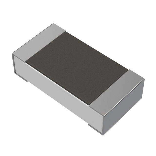

    厚膜电阻 432Ω ±1% 100MW
RMCS0603FT432R 数据手册
RMCS Series Stackpole Electronics, Inc. Sulfur Resistant Thick Film Chip Resistor Resistive Product Solutions Features: • • • • • • • Inner terminations engineered to deter sulfur contamination Non-standard resistance values available Zero ohm available (max resistance 0.05Ω) “-HP” denotes high power RoHS compliant and halogen free REACH compliant Also available RMCS-PD Series – High Sulfur Resistant Thick Film Chip Resistor Electrical Specifications Maximum Overload RMCS0201 0.05 Maximum Working Voltage (V)(1) 25 RMCS0402 0.063 50 100 1 RMCS0603 0.1 50 100 1 RMCS0805 0.125 150 300 2 RMCS1206 0.25 200 400 2 RMCS1210 0.33 200 400 2.5 RMCS2010 0.75 200 400 3.5 RMCS2512 1 250 500 4 Type/Code Power Rating (W) @ 70ºC Voltage (V) 50 (2) Maximum Current Jumper (A) 1 TCR (ppm/ºC) ± 200 ± 200 ± 100 ± 200 ± 200 ± 100 ± 200 ± 200 ± 100 ± 200 ± 200 ± 100 ± 200 ± 200 ± 100 ± 200 ± 200 ± 100 ± 200 ± 200 ± 100 ± 200 Ohmic Range (Ω) and Tolerance 0.5% - 1% 5% 1 - 10M 1 - 9.76 10 - 1M 1.02M - 10M 1 - 9.76 10 - 1M 1.02M - 10M 1 - 9.76 10 - 1M 1.02M - 10M 1 - 9.76 10 - 1M 1.02M - 10M 1 - 9.76 10 - 1M 1.02M - 10M 1 - 9.76 10 - 1M 1.02M - 10M 1 - 9.76 10 - 1M 1.02M - 10M (1) Lesser of √ P*R or maximum working voltage, whichever is lower. (2) 2.5* √ P*R or Max. Overload Voltage listed above, whichever is lower. Electrical Specifications – High Power Power Rating (W) Maximum Working Maximum Overload Type/Code TCR (ppm/ºC) @ 70ºC Voltage (V)(1) Voltage (V)(2) RMCS0201_-HP 0.083 25 50 ± 200 ± 200 RMCS0402_-HP 0.1 50 100 ± 100 ± 200 RMCS0603_-HP 0.25 75 150 ± 100 ± 200 RMCS0805_-HP 0.33 150 300 ± 100 ± 200 RMCS1206_-HP 0.5 200 400 ± 100 ± 200 RMCS1210_-HP 0.75 200 400 ± 100 ± 200 RMCS2010_-HP 1 200 400 ± 100 ± 400 RMCS2512_-HP 2 200 400 ± 100 (1) Lesser of √ P*R or maximum working voltage, whichever is lower. (2) 2.5* √ P*R or Max. Overload Voltage listed above, whichever is lower. (3) 0.5% tolerance for 0603 and 0805 requires lower power rating. Contact Stackpole for details. Rev Date: 3/26/2021 This specification may be changed at any time without prior notice. Please confirm technical specifications before you order and/or use. 1 Ohmic Range (Ω) and Tolerance 1% 5% 0.5%(3) 10 - 1M 1 - 9.76 10 - 1M 10 - 1M 1 - 9.76 10 - 1M 10 - 1M 1 - 9.76 10 - 1M 10 - 1M 1 - 9.76 10 - 1M 10 - 1M 1 - 9.76 10 - 1M 10 - 1M 1 - 9.76 10 - 1M 10 - 1M 1 - 9.76 10 - 1M 10 - 10M www.seielect.com marketing@seielect.com RMCS Series Stackpole Electronics, Inc. Sulfur Resistant Thick Film Chip Resistor Resistive Product Solutions Mechanical Specifications Type/Code Weight (g) (1000 pieces) RMCS0201 0.15 RMCS0402 0.62 RMCS0603 2.042 RMCS0805 4.368 RMCS1206 8.947 RMCS1210 15.959 RMCS2010 24.241 RMCS2512 39.448 RMCS2512_-HP 39.448 L Body Length 0.024 ± 0.001 0.60 ± 0.03 0.039 ± 0.006 1.00 ± 0.15 0.063 ± 0.008 1.60 ± 0.20 0.079 ± 0.008 2.00 ± 0.20 0.122 ± 0.006 3.10 ± 0.15 0.122 ± 0.006 3.10 ± 0.15 0.197 ± 0.008 5.00 ± 0.20 0.250 ± 0.004 6.35 ± 0.10 0.248 ± 0.008 6.30 ± 0.20 W Body Width 0.012 ± 0.001 0.30 ± 0.03 0.020 ± 0.002 0.50 ± 0.05 0.031 ± 0.004 0.80 ± 0.10 0.049 ± 0.006 1.25 ± 0.15 0.061 ± 0.010 1.55 ± 0.25 0.102 ± 0.012 2.60 ± 0.30 0.098 ± 0.008 2.50 ± 0.20 0.122 ± 0.006 3.10 ± 0.15 0.126 ± 0.008 3.20 ± 0.20 H Body Height 0.009 ± 0.001 0.23 ± 0.03 0.014 ± 0.004 0.35 ± 0.10 0.018 ± 0.006 0.45 ± 0.15 0.020 ± 0.006 0.50 ± 0.15 0.022 ± 0.006 0.55 ± 0.15 0.022 ± 0.006 0.55 ± 0.15 0.022 ± 0.004 0.55 ± 0.10 0.022 ± 0.006 0.55 ± 0.15 0.024 ± 0.008 0.60 ± 0.20 a Top Termination 0.006 ± 0.002 0.15 ± 0.05 0.008 ± 0.006 0.20 ± 0.15 0.012 ± 0.008 0.30 ± 0.20 0.014 ± 0.008 0.35 ± 0.20 0.020 ± 0.012 0.50 ± 0.30 0.020 ± 0.010 0.50 ± 0.25 0.024 ± 0.010 0.60 ± 0.25 0.024 ± 0.010 0.60 ± 0.25 0.024 ± 0.012 0.60 ± 0.30 b Bottom Termination 0.006 ± 0.002 0.15 ± 0.05 0.008 ± 0.006 0.20 ± 0.15 0.012 ± 0.008 0.30 ± 0.20 0.016 ± 0.008 0.40 ± 0.20 0.020 ± 0.008 0.50 ± 0.20 0.020 ± 0.008 0.50 ± 0.20 0.020 ± 0.012 0.50 ± 0.30 0.020 ± 0.008 0.50 ± 0.20 0.024 ± 0.012 0.60 ± 0.30 Unit inches mm inches mm inches mm inches mm inches mm inches mm inches mm inches mm inches mm Performance Characteristics Test Test Method JIS-C-5201-1 4.13 IEC-60115-1 4.13 Short Time Overload Rapid change of Temperature JIS-C-5201-1 4.6 IEC-60115-1 4.6 JIS-C-5201-1 4.25 IEC-60115-1 4.25.1 JIS-C-5201-1 4.24 IEC-60115-1 4.24 JIS-C-5201-1 4.23 IEC-60115-1 4.23.2 JIS-C-5201-1 4.33 IEC-60115-1 4.33 JIS-C-5201-1 4.17 IEC-60115-1 4.17 JIS-C-5201-1 4.18 IEC-60115-1 4.18 JIS-C-5201-1 4.7 IEC-60115-1 4.7 JIS-C-5201-1 4.18 IEC-60068-2-58 8.2.1 JIS-C-5201-1 4.19 IEC-60115-1 4.19 Sulfur Test ASTM-B-809-95 Insulation Resistance Endurance Damp Heat with Load Dry Heat Bending Strength Solderability Resistance to Soldering Heat Voltage Proof Leaching Test Specification ±1% and below ±5% ± (1% + 0.05Ω) Test Condition Jumper ± (2% + 0.05Ω) < 50mΩ RCWV*2.5 or Max. Overload Voltage whichever is lower for 5 seconds, 2 seconds for high power series. ≥10G Max. Overload Voltage for 1 minute 70ºC ± 2ºC, RCWV for 1000 hours with 1.5 hours "ON" and 0.5 hour "OFF" 40ºC ± 2ºC, 90~95% R.H., RCWV for 1000 hours < 100mΩ with 1.5 hours "ON" and 0.5 hour "OFF" ± (2% + 0.1Ω) ± (3% + 0.1Ω) < 100mΩ ± (2% + 0.1Ω) ± (3% + 0.1Ω) ± (1% + 0.05Ω) ± (1.5% + 0.1Ω) < 50mΩ At +125ºC/+155ºC for 1000 hours ± (1% + 0.05Ω) ± (1% + 0.05Ω) < 50mΩ Bending once for 5 seconds 2010, 2512 sizes: 2 mm / Other sizes: 3 mm 95% minimum coverage ± (0.5% + 0.05Ω) ± (1% + 0.05Ω) 245ºC ± 5ºC for 3 seconds < 50mΩ 260ºC ± 5ºC for 10 seconds No breakdown or flashover 1.42 times Max. Operating Voltage for 1 minute Individual leaching area ≤ 5% Total leaching area ≤ 10% 260ºC ± 5ºC for 30 seconds ± (0.5% + 0.05Ω) ± (1% + 0.05Ω) < 50mΩ -55ºC to +125ºC/+155ºC, 5 cycles ± (0.5% + 0.05Ω) ± (0.5% + 0.05Ω) < 50mΩ H2S, 50ºC ± 2ºC, 91~93% R.H., no power rating for 1000 hours RCWV (Rated Continuous Working Voltage) = √ P*Ror Max. Operating Voltage, whichever is lower. Storage Temperature: 15ºC ~ 28ºC. Humidity < 80% R.H. Operating temperature range is -55°C to +125°C for 0201, and -55°C to +155°C for all other sizes. Rev Date: 3/26/2021 This specification may be changed at any time without prior notice. Please confirm technical specifications before you order and/or use. 2 www.seielect.com marketing@seielect.com RMCS Series Stackpole Electronics, Inc. Sulfur Resistant Thick Film Chip Resistor Resistive Product Solutions Power Derating Curve: Percent Rated Power (%) 100 -55ºC 70ºC 80 0402, 0603, 0805, 1206, 1210, 2010, 2512 60 40 0201 20 155ºC 125ºC 0 0 20 40 60 100 80 120 140 160 Ambient Temperature (°C) Packaging Specifications – Paper Tape Type/Code RMCS0201 RMCS0402 RMCS0603 RMCS0805 RMCS1206 RMCS1210 L ± 0.002 ± 0.05 ± 0.006 ± 0.15 ± 0.010 ± 0.25 ± 0.010 ± 0.25 ± 0.008 ± 0.20 ± 0.010 ± 0.25 P0 0.027 0.68 0.045 1.15 0.075 1.90 0.094 2.40 0.138 3.50 0.138 3.50 0.157 4.00 0.157 4.00 0.157 4.00 0.157 4.00 0.157 4.00 0.157 4.00 ± ± ± ± ± ± ± ± ± ± ± ± 0.079 2.00 0.079 2.00 0.157 4.00 0.157 4.00 0.157 4.00 0.157 4.00 Type/Code RMCS0201 RMCS0402 RMCS0603 RMCS0805 RMCS1206 RMCS1210 M 0.015 0.38 0.026 0.65 0.043 1.10 0.063 1.60 0.075 1.90 0.110 2.80 0.004 0.10 0.004 0.10 0.004 0.10 0.004 0.10 0.004 0.10 0.004 0.10 W ± 0.002 ± 0.05 ± 0.006 ± 0.15 ± 0.010 ± 0.25 ± 0.010 ± 0.25 ± 0.008 ± 0.20 ± 0.008 ± 0.20 P1 ± ± ± ± ± ± ± ± ± ± ± ± Rev Date: 3/26/2021 This specification may be changed at any time without prior notice. Please confirm technical specifications before you order and/or use. 0.315 8.00 0.315 8.00 0.315 8.00 0.315 8.00 0.315 8.00 0.315 8.00 0.002 0.05 0.002 0.05 0.004 0.10 0.004 0.10 0.004 0.10 0.004 0.10 0.079 2.00 0.079 2.00 0.079 2.00 0.079 2.00 0.079 2.00 0.079 2.00 3 E ± 0.008 ± 0.20 ± 0.008 ± 0.20 ± 0.008 ± 0.20 ± 0.008 ± 0.20 ± 0.008 ± 0.20 ± 0.008 ± 0.20 P2 ± ± ± ± ± ± ± ± ± ± ± ± 0.002 0.05 0.002 0.05 0.002 0.05 0.002 0.05 0.002 0.05 0.002 0.05 F 0.069 ± 0.004 1.75 ± 0.10 0.069 ± 0.004 1.75 ± 0.10 0.069 ± 0.004 1.75 ± 0.10 0.069 ± 0.004 1.75 ± 0.10 0.069 ± 0.004 1.75 ± 0.10 0.069 ± 0.004 1.75 ± 0.10 ØD0 0.138 3.50 0.138 3.50 0.138 3.50 0.138 3.50 0.138 3.50 0.138 3.50 0.059 1.50 0.059 1.50 0.059 1.50 0.059 1.50 0.059 1.50 0.059 1.50 0.017 0.42 0.018 0.45 0.028 0.70 0.033 0.85 0.033 0.85 0.030 0.75 +0.004 / -0 +0.10 / -0 +0.004 / -0 +0.10 / -0 +0.004 / -0 +0.10 / -0 +0.004 / -0 +0.10 / -0 +0.004 / -0 +0.10 / -0 +0.004 / -0 +0.10 / -0 Unit ± 0.002 ± 0.05 ± 0.002 ± 0.05 ± 0.002 ± 0.05 ± 0.002 ± 0.05 ± 0.002 ± 0.05 ± 0.002 ± 0.05 K1 ± ± ± ± ± ± ± ± ± ± ± ± 0.008 0.20 0.008 0.20 0.008 0.20 0.008 0.20 0.008 0.20 0.008 0.20 inches mm inches mm inches mm inches mm inches mm inches mm Unit inches mm inches mm inches mm inches mm inches mm inches mm www.seielect.com marketing@seielect.com RMCS Series Stackpole Electronics, Inc. Sulfur Resistant Thick Film Chip Resistor Resistive Product Solutions Packaging Specifications – Embossed Plastic Tape Type/Code RMCS2010 RMCS2512 0.110 2.80 0.138 3.50 L ± 0.008 ± 0.20 ± 0.008 ± 0.20 P0 0.217 5.50 0.264 6.70 0.157 4.00 0.157 4.00 ± ± ± ± 0.157 4.00 0.157 4.00 Type/Code RMCS2010 RMCS2512 0.004 0.10 0.004 0.10 M ± 0.008 ± 0.20 ± 0.008 ± 0.20 P1 ± ± ± ± 0.472 12.00 0.472 12.00 0.004 0.10 0.004 0.10 0.079 2.00 0.079 2.00 W ± 0.012 ± 0.30 ± 0.012 ± 0.30 P2 ± ± ± ± 0.002 0.05 0.002 0.05 E 0.069 ± 0.004 1.75 ± 0.10 0.069 ± 0.004 1.75 ± 0.10 ØD0 0.059 +0.004 / -0 1.50 +0.10 / -0 0.059 +0.004 / -0 1.50 +0.10 / -0 0.217 5.50 0.217 5.50 0.047 1.20 0.047 1.20 F ± 0.002 ± 0.05 ± 0.002 ± 0.05 K2 - 0 0 0 0 Unit inches mm inches mm Unit inches mm inches mm Recommended Pad Layout Type/Code a b c Unit RMCS0201 0.012 0.30 0.010 0.25 0.012 0.30 inches mm 0.024 0.60 0.035 0.90 0.051 1.30 0.087 2.20 0.079 2.00 0.150 3.80 0.193 4.90 0.020 0.50 0.031 0.80 0.031 0.80 0.039 1.00 0.035 0.90 0.035 0.90 0.063 1.60 0.028 0.70 0.039 1.00 0.055 1.40 0.067 1.70 0.110 2.80 0.110 2.80 0.138 3.50 inches mm inches mm inches mm inches mm inches mm inches mm inches mm RMCS0402 RMCS0603 RMCS0805 RMCS1206 RMCS1210 RMCS2010 RMCS2512 Rev Date: 3/26/2021 This specification may be changed at any time without prior notice. Please confirm technical specifications before you order and/or use. 4 www.seielect.com marketing@seielect.com RMCS Series Stackpole Electronics, Inc. Sulfur Resistant Thick Film Chip Resistor Resistive Product Solutions Soldering Condition (1) Time of IR reflow soldering at maximum temperature point 260°C: 10 seconds (2) Time of wave soldering at maximum temperature point 260°C: 10 seconds (3) Time of soldering iron at maximum temperature point 410°C: 5 seconds RoHS Compliance Stackpole Electronics has joined the worldwide effort to reduce the amount of lead in electronic components and to meet the various regulatory requirements now prevalent, such as the European Union’s directive regarding “Restrictions on Hazardous Substances” (RoHS 3). As part of this ongoing program, we periodically update this document with the status regarding the availability of our compliant components. All our standard part numbers are compliant to EU Directive 2011/65/EU of the European Parliament as amended by Directive (EU) 2015/863/EU as regards the list of restricted substances. RoHS Compliance Status Standard Product Series Description Package / Termination Type Sulfur Resistant Thick Film SMD Surface Mount Chip Resistor Note (1): RoHS Compliant by means of exemption 7c-I. RMCS Standard Series RoHS Compliant Lead-Free Termination Composition Lead-Free Mfg. Effective Date (Std Product Series) Lead-Free Effective Date Code (YY/WW) YES(1) 100% Matte Sn over Ni Always Always “Conflict Metals” Commitment We at Stackpole Electronics, Inc. are joined with our industry in opposing the use of metals mined in the “conflict region” of the eastern Democratic Republic of the Congo (DRC) in our products. Recognizing that the supply chain for metals used in the electronics industry is very complex, we work closely with our own suppliers to verify to the extent possible that the materials and products we supply do not contain metals sourced from this conflict region. As such, we are in compliance with the requirements of Dodd-Frank Act regarding Conflict Minerals. Compliance to “REACH” We certify that all passive components supplied by Stackpole Electronics, Inc. are SVHC (Substances of Very High Concern) free and compliant with the requirements of EU Directive 1907/2006/EC, “The Registration, Evaluation, Authorization and Restriction of Chemicals”, otherwise referred to as REACH. Contact us for complete list of REACH Substance Candidate List. Rev Date: 3/26/2021 This specification may be changed at any time without prior notice. Please confirm technical specifications before you order and/or use. 5 www.seielect.com marketing@seielect.com RMCS Series Stackpole Electronics, Inc. Sulfur Resistant Thick Film Chip Resistor Resistive Product Solutions Environmental Policy It is the policy of Stackpole Electronics, Inc. (SEI) to protect the environment in all localities in which we operate. We continually strive to improve our effect on the environment. We observe all applicable laws and regulations regarding the protection of our environment and all requests related to the environment to which we have agreed. We are committed to the prevention of all forms of pollution. How to Order 1 2 3 4 5 6 7 8 9 10 11 12 13 14 15 16 17 R M C S 0 6 0 3 J T 4 K 7 0 - H P Product Series Sulfur RMCS Resistant Size 0201 0402 0603 0805 1206 1210 2010 2512 Power Rating (W) RMCS -HP 0.05 0.083 0.063 0.1 0.1 0.25 0.125 0.33 0.25 0.5 0.33 0.75 0.75 1 1 2 Tolerance Packaging Code Tol Value Code Description Size Quantity D 0.5% E96 10" Reel G 0201, 0402 15000 F 1% E96, E24 Paper Tape J 5% E24 0201, 0402 10000 7" Reel Z Jumper 0603, 0805 Paper Tape 5000 T 1206, 1210 7" Reel 2010, 2512 4000 Plastic Tape Rev Date: 3/26/2021 This specification may be changed at any time without prior notice. Please confirm technical specifications before you order and/or use. 6 Resistance Value Four characters with the multiplier used as the decimal holder. 1 ohm = 1R00 100 Kohm = 100K 1.02 Mohm = 1M02 Zero ohm jumper = 0R00 Special Code Description -HP High Power www.seielect.com marketing@seielect.com
RMCS0603FT432R
物料型号:RMCS Series Sulfur Resistant Thick Film Chip Resistor
器件简介:Stackpole Electronics, Inc. 提供的RMCS系列是设计用于抵抗硫污染的厚膜芯片电阻器。这些电阻器具有内部端子设计,以阻止硫污染,并且符合RoHS标准,无卤素,符合REACH标准。
引脚分配:文档中未明确提供引脚分配信息,但通常这类电阻器的引脚分配会在其数据手册或产品规格中有详细描述。
参数特性: - 多种尺寸和功率等级,例如RMCS0201、RMCS0402、RMCS0603等。 - 功率等级从0.05W至1W,工作电压和最大过载电压根据不同型号有所变化。 - 电阻值范围从1M欧姆到1.02M欧姆,公差从0.5%至5%。 - 温度系数(TCR)为±200ppm/°C。
功能详解:RMCS系列电阻器设计用于在存在硫的环境中工作,适用于高功率应用,并且提供了高硫耐厚膜芯片电阻器(RMCS-PD系列)。
应用信息:适用于需要耐硫性能的电子设备,如汽车、工业和电源管理应用。
封装信息:提供了详细的机械规格,包括重量、体长、体宽、体高、上端子和下端子的尺寸。
