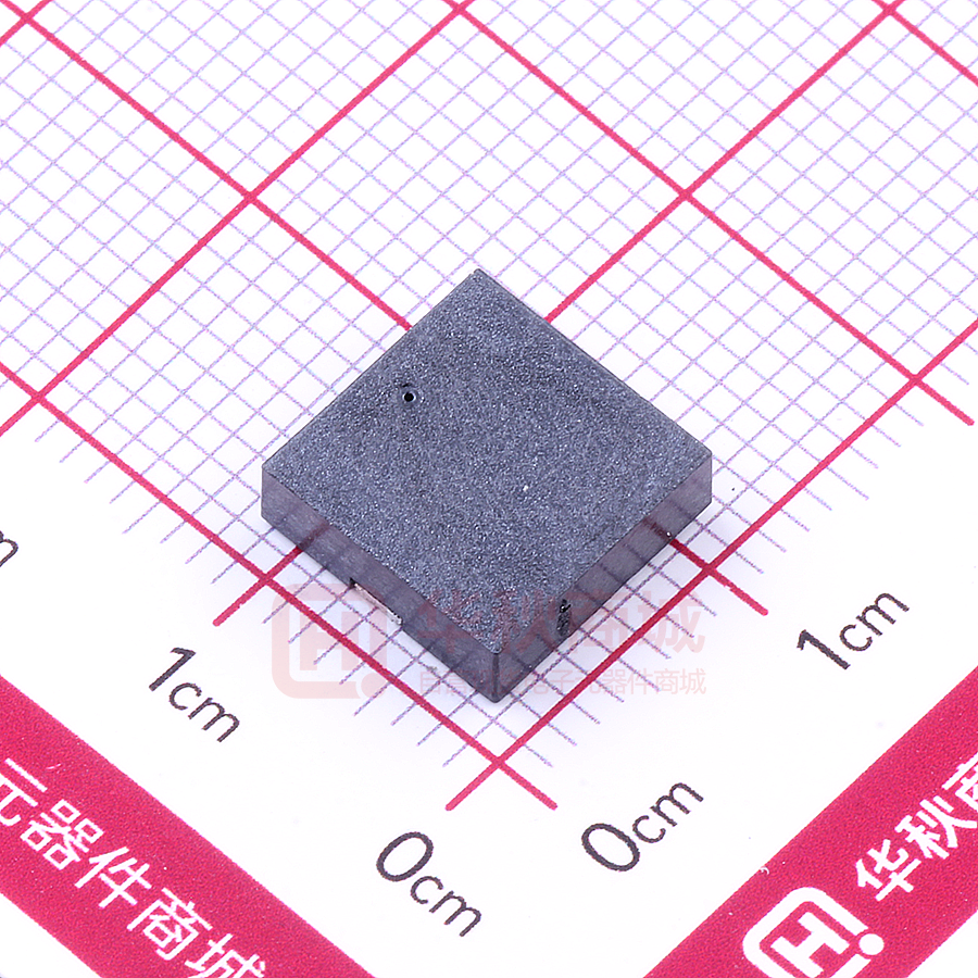

GSC1030RB-3V4000
GSC1030RB-3V4000
    INGHAI(赢海)
    SMD,10x10mm
    频率4kHz 电压-额定3V
GSC1030RB-3V4000 数据手册
規 格 承 認 書 PECIFICATION FOR APPROVAL 客 戶 CUSTOMER 項 目 ITEM 型 號 : 立创 : 压电无源蜂鸣器(外部驱动) TYPE : GSC1030RB-3V4000 描述 DESCRIPTION : L10 ×W10× H3 mm 4000Hz 3V 客戶料號 CUSTOMER NO. : 規 格 書 號 ≥72dB LCP 材质 侧发音 SPECIFICATION NO.: 版 本 EDITION NO. 日 期 DATE : V1.1 : 2019-7-3 客戶承認 CUSTOMER CONFIRM AND SIGN 檢查 TESTED BY 審核 CHECKED BY 承認 APPROVED BY 東莞市赢海電子有限公司 DONGUAN INGHAI ELECTRONICS CO.,LTD 製作 ISSUED BY 審查 CHECKED BY 周明 刘承成 確認 APPROVED BY 地址:廣東省東莞市長安鎮廈邊元灶頭工業區 電話 / TEL:0769-83060958 傳真 / FAX: 0769-81608993 網址:HTTP://WWW.INGHAI.COM 1/4 DONGGUAN INGHAI ELECTRONICS CO.,LTD Model NO: GSC1030RB-3V4000 A: DIMEMSIONS B: SPECIFICATIONS Unit:mm Tolerance:±0.5 Model NO GSC1030RB Rated Voltage 3.0Vp-p Operating Voltage 1.0~25Vp-p Max.Rated Current Max.5mA sound Pressure level(dB/min)at 10cm Min. 72dB Resonant Frequency 4000±500Hz Capacitance 12000±30% Operating Temperature -20 ℃~+60 ℃ Storage Temperature -30 ℃~+70 ℃ Case material and color LCP / Black Measuring condition Part shall be measured under a condition (Temperature: 5~ 35℃, Humidity: 45% ~ 85%R.H., Atmospheric pressure: 860 ~ 1060hPa) unless the standard condition (Temperature: 25±3℃, Humidity: 60±10%R.H. Atmospheric pressure: 860 ~1060hPa) is regulated to measure. 2/4 C: Electrical And Acoustical Measuring Condition FREQUENCY RESPONSE: D:Soldering Condition 3/4 Heat resistant line (Used when heat resistant reliability test is performed) (2)Manual soldering Manual soldering temperature 350º C within 5 sec. E: Reliability Test After any following tests the part shall meet specifications without any degradation in appearance and performance except SPL. SPL shall not deviate more than -10 dB from the initial value 1. Ordinary Temperature Life Test The part shall be subjected to 96 hours at 25±10℃. Input rated voltage 2. 3. 4. 5. 6. 7. Resonant frequency, 1/2 duty Square wave. High Temperature Test The part shall be capable of with standing a storage temperature of +70℃ for 96 hours. Low Temperature Test The part shall be capable of with standing a storage temperature of -30℃ for 96 hours. Humidity Test Temperature:+40℃±3℃ Relative Humidity:90%~95% Duration: 48 hours and expose to room temperature for 6 hours Temperature Shock Test Temperature:60℃ /1hour→ 25℃/3hours→-30℃/1hour→ 25℃/3hours (1cycle) Total cycle: 10 cycles Drop Test Standard Packaging From 120mm(Drop on hard wood or board of 5cm thick, three sides, six plain.) Vibration Test Vibration:1000cycles /min. Amplitude:1.5mm, Duration: 1 hour in each 3 axes Note: As this product is not protected from foreign material entering, please make sure that any foreign materials (e.g. magnetic powder, washing solvent, flux, corrosive gas) do not enter this product in your production processes. The functional degradation (e.g. SPL down) may occur if foreign material enter it. 4/4
