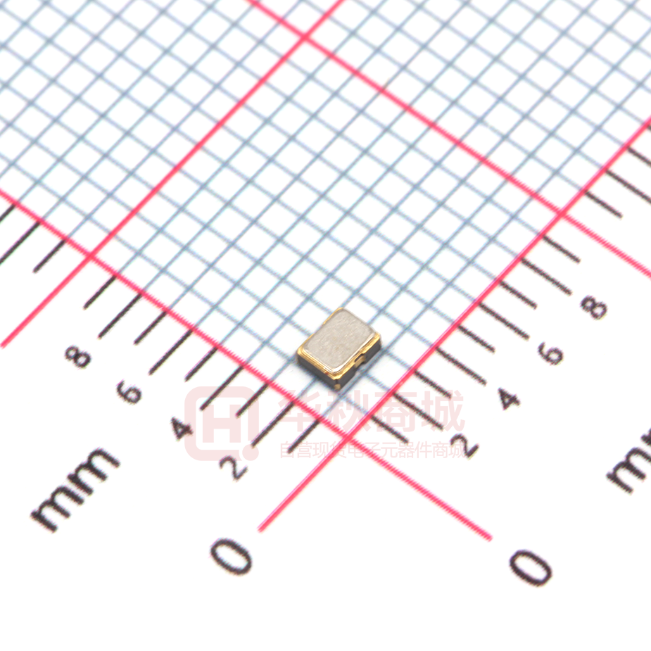

OZ Type 2.0 x 1.6 mm SMD Crystal Oscillator Actual Size FEATURE - Typical 2.05 x 1.65 x 0.75 mm ceramic SMD package. - Tight symmetry (45 to 55%) available. - Operation voltage: 1.8V, 2.5V, 3.3V - Tri-state enable/disable TYPICAL APPLICATION - WLAN/WiMax - Mobile Phone - DSC,Set-top Box,HDTV RoHS Compliant DIMENSION (mm) SOLDER PAD L AYOUT (mm) [ B O T T O M V IE W ] [ TO P VIEW ] 0.1 μF 1.27±0.10 #4 #2 #2 0.47±0.10 1.65±0.10 #1 #1 0.97 #3 #3 0.97±0.10 #4 0.60 2.05±0.10 0.57±0.10 0.75±0.10 [ S ID E V IE W ] 1.27 Pin# Function Tri-state GND Output VDD 1 2 3 4 0.75 To ensure optimal oscillator performance, place a by-pass capacitor of 0.1μF as close to the part as possible between Vdd and GND pads. ELECTRICAL SPECIFICATION Pameter Min. Supply Voltage Variation (V DD ) Frequency Range 3.3V Max. Min. VDD+10% VDD-10% VDD+10% VDD-10% Max. VDD+10% 1.5 50 1.5 50 1.5 50 45 15 55 45 10 55 45 7 55 Duty Cycle Output Level (CMOS) Output High (Logic"1") Output Low(Logic"0") Transition Time:Rise/Fall Time + 1.5 MHz ≦ Fo < 20 MHz 2.97 - 0.33 2.25 - 0.25 1.62 - 0.18 20 MHz ≦ Fo ≦ 50 MHz - 4 3 2 - 4 3 2 - 5 4 2 Start Time Tri-State(Input to Pin 1) Enable (High voltage or floating) Disable (Low voltage or GND) 2.31 0.99 1.75 0.75 1.26 0.54 Period Jitter(pk-pk) RMS Phase Jitter (Integrated 12 KHz~20 MHz) Standby Current Aging (@ 25 oC 1st year) Duty Cycle Storage Temp. Range -55 40 1 10 ±3 125 -55 24,26 Max. 40 1 10 ±3 125 Min. 1.8V VDD-10% Standard Frequency Supply Current 2.5V -55 Unit V MHz mA % V nSec mSec 40 1 10 ±3 125 V pSec pSec μA ppm o C Standard frequencies are frequencies which the crystal has been designed and does not imply a stock position + Transition times are measured between 10% and 90% of VDD, with an output load of 15 pF. FREQ. STABILITY vs. TEMP. RANGE ppm Temp(o C) -10 ~ +60 -20 ~ +70 -40 ~ +85 ±20 ±25 ±50 *O: Available △: Conditional X: Not available *Inclusive of calibration @ 25 oC ,operating temperature rrange,input Voltage variation,load variation,aging (1st year),shock,and vibration -40 ~ +125 Note: not all combination of options are available. Other specifications may be available upon request. 24 Specifications subject to change without notice. www.taitien.com sales@taitien.com.tw Rev(6)04/2019
