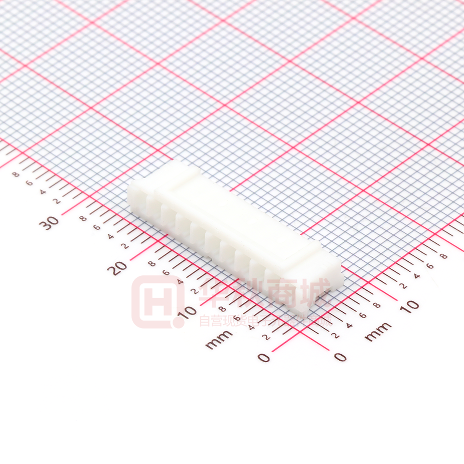

    胶壳 间距P=2.00mm 9Pin(1x9)
PHR-9 数据手册
PH CONNECTOR Emboss Tape 2.0 mm pitch/Disconnectable Crimp style connectors Specifications 2 5 6 PH CONNECTOR • Current rating: 2 A AC/DC (AWG #24) • Voltage rating: 100 V AC/DC • Temperature range: -25℃ to +85℃ (including temperature rise in applying electrical current) • Contact resistance: Initial value/ 10 mΩ max. After environmental tests/ 20 mΩ max. • Insulation resistance: 1,000 MΩ min. • Withstanding voltage: 800 VAC/ minute • Applicable wire: AWG #32 to #24 • Applicable PC board thickness: 0.8 to 1.6 mm 4 3 This is a thin, low-profile 2.0 mm pitch connector 8.0 mm in height after mounting and 4.5 mm in width. It is designed to meet the demand for high-density connection of internal wires to printed circuit boards. It is compact, highly reliable and low in cost. ● ● ● ● Reliable contact Fully shrouded header Printed circuit board retention mechanism Surface mount model (SMT) ® * In using the products,refer to "Handling Precautions for Terminals and Connectors" described on our website (Technical documents of Product information page). * RoHS2 compliance * Dimensional unit: mm * Contact JST for details.   ® ® Standards ® ® Recognized E60389 R75087 PC board layout and Assembly layout 〈Through-hole type〉 Side entry type Top entry type 2 ±0.05 4.5 ±0.05 2 (9.6) (8) φ0.7 +0.1 0 6 +0.1 0 φ0.7 4.8 7.6 6.25 Note: 1. The above figure is the figure viewed from soldering side. 2. Tolerances are non-cumulative: ± 0.05 mm for all centers. 3. Hole dimensions differ according to the type of PC board and piercing method. If PC boards made of hard material are used, the hole dimensions should be larger. The dimensions above should serve as a guideline. Contact JST for details. 〈SMT type〉 SM4 type Top entry type 2±0.05 End face of wafer on the mating side 5 1.5 (2) ±0.1 1.6 ±0.1 2 ±0.05 End face of wafer on the mating side 5.5 5.5 max. 3.4 (1) 7.6 9 min. ±0.1 (9.6) 6.6 7.5 min. (8.6) Circuit No.1 2 max. 3 ±0.1 1 0.2 1.6±0.1 1.6±0.1 SM4 type Side entry type 1 min. Note: 1 . The above figure is the figure viewed from the connector mounting side. 2. Tolerances are non-cumulative: ± 0.05 mm for all centers. 3. The dimensions above should serve as a guideline. Contact JST for details. 1min. Circuit No.1 1 PH CONNECTOR Contact 1 2.05 SPH-002T-P0.5S SPH-002T-P0.5L SPH-004T-P0.5S 2.08 2.85 Applicable wire Model No. 1.5 5.7 mm2 AWG # 0.05 ~ 0.22 30~24 0.08 ~ 0.22 28~24 0.8~1.5 0.032~0.08 32~28 0.5~0.9 Insulation O.D. (mm) 0.8~1.5 Q'ty/ reel 8,000 10,000 Material and Finish Phosphor bronze, tin-plated (reflow treatment) Applicator Crimping machine Crimp applicator Contact SPH-002T-P0.5S MKS-L SPH-002T-P0.5L AP-K2N SPH-004T-P0.5S MKS-L-10 Dies Crimp applicator with dies MK/SPH-002-05S APLMK SPH002-05S MK/SPH-002-05L APLMK SPH002-05L MK/SPH-002-05S APLMK SPH004-05S RoHS2 compliance Note: 1. Contact JST for gold-plated products. 2. SPH-002T-P0.5L is low-insertion force type contact, for easier insertion/ withdrawal, which would be less resistant to the vibration. The crimp height is different from the standard. 3. Contact JST for details. Note: Contact JST for fully automatic crimping applicator. Housing B No. of circuits A 2 0.5 Circuit 1.9 No.1 2 4.5 3 4 5 7 6.35 H JST 8 6 8 9 10 □0.6 11 12 As the color identification, the following alphabet shall be put in the underlined part. For availability, delivery and minimum order quantity, contact JST. ex. PHR-2-oo 13 14 15 16 (blank)...natural (white) BK...black R...red TR...tomato red BL...blue Y...yellow L...lemon yellow M...green D...orange N...brown P...purple PK...pink H...gray LE...light blue FY...vivid yellow DPK...dark pink Model No. PHR-2 PHR-3 PHR-4 PHR-5 PHR-6 PHR-7 PHR-8 PHR-9 PHR-10 PHR-11 PHR-12 PHR-13 PHR-14 PHR-15 PHR-16 A Dimensions (mm) B Q'ty/ box 2.0 5.8 1,000 4.0 7.8 1,000 6.0 9.8 1,000 8.0 11.8 1,000 10.0 13.8 1,000 12.0 15.8 1,000 14.0 17.8 1,000 16.0 19.8 1,000 18.0 21.8 1,000 20.0 23.8 1,000 22.0 25.8 1,000 24.0 27.8 1,000 26.0 29.8 1,000 28.0 31.8 1,000 30.0 33.8 1,000 Material and Finish PA 66, UL94V-0, natural (white) RoHS2 compliance Through-hole type Header No. of circuits Top entry type (2 circuits) 3 4 4.5 4.5 1.7 B 2 (3 circuits or more) 5 1.7 B 6 7 6 6 8 9 10 Circuit No.1 □0.5 2 □0.5 1.95 A Circuit No.1 15 16 2.0 5.9 1,000 1,000 4.0 7.9 1,000 1,000 6.0 9.9 1,000 500 8.0 11.9 1,000 500 10.0 13.9 1,000 500 12.0 15.9 500 500 14.0 17.9 500 250 16.0 19.9 500 250 18.0 21.9 500 250 20.0 23.9 500 250 22.0 25.9 400 250 24.0 27.9 250 250 26.0 29.9 250 250 28.0 31.9 250 200 30.0 33.9 250 200 Post: Brass, copper-undercoated, tin-plated (reflow treatment) Wafer: PA 66, UL94V-0, natural (white) 4.8 1.7 B 2 □0.5 A Circuit No.1 1.6 6 2 13 Dimensions (mm) Q'ty/box A B Top entry type Side entry type Material and Finish Side entry type 1.95 12 14 6.25 1.95 A 3.4 3.4 11 Model No. Top entry type Side entry type B2B-PH-K-S S2B-PH-K-S B3B-PH-K-S S3B-PH-K-S B4B-PH-K-S S4B-PH-K-S B5B-PH-K-S S5B-PH-K-S B6B-PH-K-S S6B-PH-K-S B7B-PH-K-S S7B-PH-K-S B8B-PH-K-S S8B-PH-K-S B9B-PH-K-S S9B-PH-K-S B10B-PH-K-S S10B-PH-K-S B11B-PH-K-S S11B-PH-K-S B12B-PH-K-S S12B-PH-K-S B13B-PH-K-S S13B-PH-K-S B14B-PH-K-S S14B-PH-K-S B15B-PH-K-S S15B-PH-K-S B16B-PH-K-S S16B-PH-K-S 3.4 RoHS2 compliance This product displays (LF)(SN) on a label. As the color identification, the following alphabet shall be put in the underlined part. For availability, delivery and minimum order quantity, contact JST. ex. B2B-PH-K-oo S...natural (white) K...black R...red TR...tomato red E...blue Y...yellow L...lemon yellow M...green O...orange N...brown P...purple PK...pink H...gray LE...light blue FY...vivid yellow (blank)...ivory PH CONNECTOR Through-hole type Header〈Low insertion force type〉 Top entry type (2 circuits) (3 circuits or more) 4.5 B 1.7 3.4 3.4 6 6 1.7 B 4.5 1.95 A Circuit No.1 2 □0.5 □0.5 1.95 Circuit No.1 A Side entry type Model No. No. of circuits Top entry type Side entry type 2 B2B-PH-KL S2B-PH-KL 3 B3B-PH-KL S3B-PH-KL 4 B4B-PH-KL S4B-PH-KL 5 B5B-PH-KL S5B-PH-KL 6 B6B-PH-KL S6B-PH-KL 7 B7B-PH-KL S7B-PH-KL 8 B8B-PH-KL S8B-PH-KL 9 B9B-PH-KL S9B-PH-KL 10 B10B-PH-KL S10B-PH-KL 11 B11B-PH-KL S11B-PH-KL 12 B12B-PH-KL S12B-PH-KL 13 B13B-PH-KL S13B-PH-KL 14 B14B-PH-KL S14B-PH-KL 15 B15B-PH-KL S15B-PH-KL 16 B16B-PH-KL S16B-PH-KL Q'ty/box Top entry type Side entry type 2.0 5.9 1,000 1,000 4.0 7.9 1,000 1,000 6.0 9.9 1,000 500 8.0 11.9 1,000 500 10.0 13.9 1,000 500 12.0 15.9 500 500 14.0 17.9 500 250 16.0 19.9 500 250 18.0 21.9 500 250 20.0 23.9 500 250 22.0 25.9 400 250 24.0 27.9 250 250 26.0 29.9 250 200 28.0 31.9 250 200 30.0 33.9 250 200 Material and Finish 4.8 1.7 B Dimensions (mm) A B Post: Copper alloy, copper-undercoated, tin-plated (reflow treatment) Wafer: PA 66, UL94V-0, gray 6 6.25 RoHS2 compliance This product displays (LF)(SN) on a label. □0.5 A Circuit No.1 3.4 1.6 2 1.95 As the color identification, the following alphabet shall be put in the underlined part. For availability, delivery and minimum order quantity, contact JST. ex. B2B-PH-KL-oo (blank)...gray R...red E...blue S...natural (white) SMT type Header Top entry type No. of circuits B 2.975 A 2 1.9 2 (2) 5 3 4 5 6.6 6 7 Circuit No.1 1.4 8 2.2 9 10 11 Side entry type 12 13 2.4 14 5.5 15 Circuit No.1 2.95 16 1.6 2 A B 6 (2.6) Model No. Top entry type Side entry type B2B-PH-SM4-TB B3B-PH-SM4-TB B4B-PH-SM4-TB B5B-PH-SM4-TB B6B-PH-SM4-TB B7B-PH-SM4-TB B8B-PH-SM4-TB B9B-PH-SM4-TB B10B-PH-SM4-TB B11B-PH-SM4-TB B12B-PH-SM4-TB B13B-PH-SM4-TB B14B-PH-SM4-TB B15B-PH-SM4-TB B16B-PH-SM4-TB S2B-PH-SM4-TB S3B-PH-SM4-TB S4B-PH-SM4-TB S5B-PH-SM4-TB S6B-PH-SM4-TB S7B-PH-SM4-TB S8B-PH-SM4-TB S9B-PH-SM4-TB S10B-PH-SM4-TB S11B-PH-SM4-TB S12B-PH-SM4-TB S13B-PH-SM4-TB S14B-PH-SM4-TB S15B-PH-SM4-TB ̶ Dimensions (mm) B A Top entry type Side entry type Q'ty/ reel 2.0 7.95 7.9 1,000 4.0 9.95 9.9 1,000 6.0 11.95 11.9 1,000 8.0 13.95 13.9 1,000 10.0 15.95 15.9 1,000 12.0 17.95 17.9 1,000 14.0 19.95 19.9 1,000 16.0 21.95 21.9 1,000 18.0 23.95 23.9 1,000 20.0 25.95 25.9 1,000 22.0 27.95 27.9 1,000 24.0 29.95 29.9 1,000 26.0 31.95 31.9 1,000 28.0 33.95 33.9 1,000 30.0 35.95 ‒ 1,000 Material and Finish Post: Copper alloy, copper-undercoated, tin-plated (reflow treatment) Wafer: PA, UL94V-0, natural (ivory) Solder tab: Brass, copper-undercoated, tin-plated (reflow treatment) RoHS2 compliance This product displays (LF)(SN) on a label. Note: Contact JST for the top entry type headers with suction cap. As the color identification, the following alphabet shall be put in the underlined part. For availability, delivery and minimum order quantity, contact JST. ex. B2B-PH-SM4-oo-TB (blank)...natural (ivory) R...red E...blue M...green L...lemon yellow K...black DPK...dark pink 3
