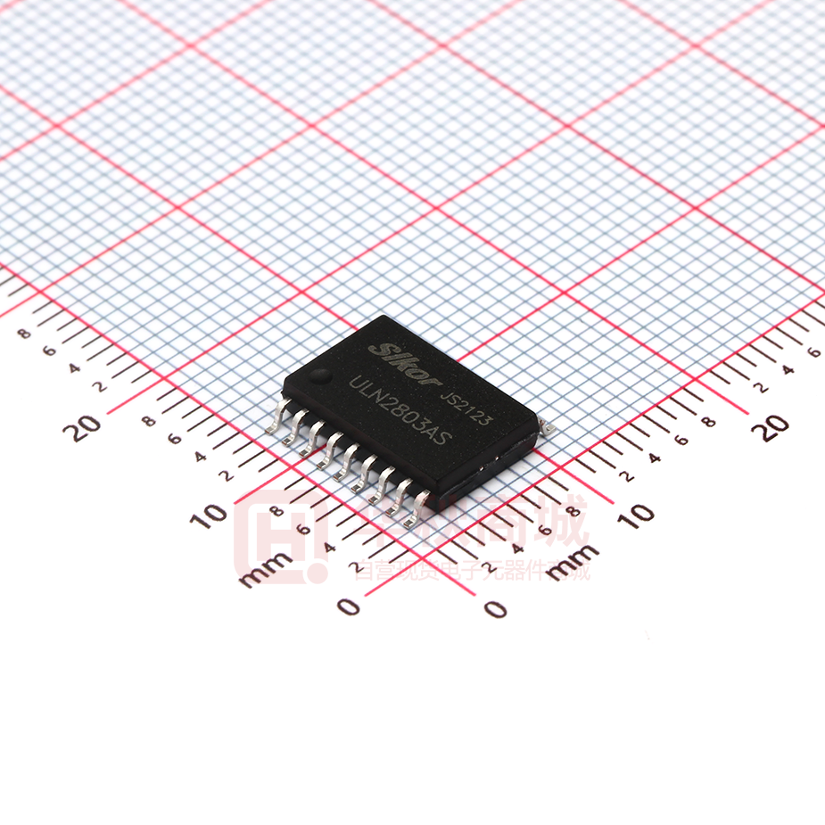

ULN2803
Octal High Voltage,High Current Darlington
Transistor Arrays
DESCRIPTIONS:
The eight NPN Da rlington connected transistors in th is
fa mily of a rrays are ideally suited for interfacing between
ULN2803AD DIP- 18
low logic level digital circuitry (such as TTL, CMOS or
PMOS/NM OS) and the higher current/voltage
requiremen ts of lamps, relays, printer hamme rs or other
si milar loads for a broad range of computer, industrial,
and consu mer applications. All devices feature
open–co llector ou tputs and free wheeling clamp diodes
ULN2803AS SOP- 18
for transient suppression
The ULN2803 is designed to be co mp atible with standard TTL fa milies while the ULN2804
is optimized for 6 to 15 volt high level CMOS or PMOS.
