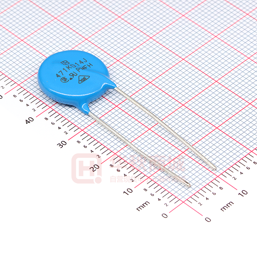

471KD14J 数据手册
14Φ SERIES Metal Oxide Varistor (MOV) Data Sheet Features ■ ■ ■ ■ ■ ■ ■ ■ Wide operating voltage (V1mA) range from 18V to 1800V Fast responding to transient over-voltage Large absorbing transient energy capability Low clamping ratio and no follow-on current Meets MSL level 1, per J-STD-020 Operating Temperature:-40℃ ~ +85℃ Storage Temperature:-40℃ ~ +125℃ Safety certification: UL: E327997 CSA: 246579 VDE: 40027827 Applications ■ ■ ■ ■ ■ Transistor, diode, IC, thyristor or triac semiconductor protection Surge protection in consumer electronics Surge protection in industrial electronics Surge protection in electronic home appliances, gas and petroleum appliances Relay and electromagnetic valve surge absorption Part Number Code Revision:27-Dec-15 1 / 11 www.brightking.com 14Φ SERIES Dimensions Table 1 Table 2 Unit: mm Unit: mm Symbol Dimension Model T e Model T e H(±2.0) 17.5 180K 2.8 1.5 361K 4.1 2.7 H1(±2.0) 19.0 220K 2.9 1.6 391K 4.2 2.8 L(min.) 20.0 270K 3.1 1.8 431K 4.4 3.0 L1(min.) 15.0 330K 3.0 1.7 471K 4.6 3.2 D 14.0~16.5 390K 3.1 1.8 511K 4.8 3.4 F(±0.8) 7.5 470K 3.3 1.9 561K 5.0 3.6 T(±0.8) Table 2 560K 3.5 2.1 621K 5.3 3.9 e(±0.8) Table 2 680K 3.8 2.4 681K 5.6 4.2 d(±0.05) 0.8 820K 3.2 1.8 751K 5.7 4.3 d1(±0.4) 1.4 101K 3.4 2.0 781K 5.8 4.4 121K 3.6 2.2 821K 6.0 4.6 151K 3.2 1.8 911K 6.3 5.0 181K 3.3 1.9 102K 6.3 5.0 201K 3.4 2.0 112K 6.8 5.4 221K 3.5 2.1 122K 7.2 5.8 241K 3.6 2.2 142K 8.0 6.6 271K 3.8 2.4 162K 8.8 7.4 301K 3.9 2.5 182K 9.6 8.2 331K 3.9 2.5 Revision:27-Dec-15 2 / 11 www.brightking.com 14Φ SERIES Electrical Characteristics Maximum Part Allowable Number Standard High Surge Voltage VAC(V) VDC(V) Varistor Voltage V1mA(V) Maximum Withstanding Maximum Clamping Surge Energy Voltage Current (10/1000μs) IP(A) VC(V) I (A) Standard I (A) High Surge (J) Standard Rated Power Typical Capacitance (Reference) (J) High (W) @1KHz (pf) Surge 180KD14 180KD14J 11 14 18(15~21.6) 10 36 1000 2000 4.0 7.0 0.1 11100 220KD14 220KD14J 14 18 22(19.5~26) 10 43 1000 2000 5.0 8.0 0.1 9100 270KD14 270KD14J 17 22 27(24~31) 10 53 1000 2000 6.0 10.0 0.1 7400 330KD14 330KD14J 20 26 33(29.5~36.5) 10 65 1000 2000 7.5 12.0 0.1 6100 390KD14 390KD14J 25 31 39(35~43) 10 77 1000 2000 8.6 13.0 0.1 5100 470KD14 470KD14J 30 38 47(42~52) 10 93 1000 2000 10.0 17.0 0.1 4300 560KD14 560KD14J 35 45 56(50~62) 10 110 1000 2000 11.0 20.0 0.1 3600 680KD14 680KD14J 40 56 68(61~75) 10 135 1000 2000 14.0 24.0 0.1 2900 820KD14 820KD14J 50 65 82(74~90) 50 135 4500 6000 22.0 27.0 0.6 2400 101KD14 101KD14J 60 85 100(90~110) 50 165 4500 6000 28.0 33.0 0.6 2000 121KD14 121KD14J 75 100 120(108~132) 50 200 4500 6000 32.0 40.0 0.6 1700 151KD14 151KD14J 95 125 150(135~165) 50 250 4500 6000 40.0 53.0 0.6 1300 181KD14 181KD14J 115 150 180(162~198) 50 300 4500 6000 50.0 60.0 0.6 1100 201KD14 201KD14J 130 170 200(180~220) 50 340 4500 6000 57.0 70.0 0.6 1000 221KD14 221KD14J 140 180 220(198~242) 50 360 4500 6000 60.0 78.0 0.6 900 241KD14 241KD14J 150 200 240(216~264) 50 395 4500 6000 63.0 84.0 0.6 830 271KD14 271KD14J 175 225 270(243~297) 50 455 4500 6000 70.0 99.0 0.6 740 301KD14 301KD14J 190 250 300(270~330) 50 500 4500 6000 77.0 108 0.6 670 331KD14 331KD14J 210 275 330(297~363) 50 550 4500 6000 85.0 115 0.6 610 361KD14 361KD14J 230 300 360(324~396) 50 595 4500 6000 93.0 130 0.6 560 391KD14 391KD14J 250 320 390(351~429) 50 650 4500 6000 100 140 0.6 510 431KD14 431KD14J 275 350 430(387~473) 50 710 4500 6000 115 155 0.6 460 471KD14 471KD14J 300 385 470(423~517) 50 775 4500 6000 125 175 0.6 430 511KD14 511KD14J 320 415 510(459~561) 50 845 4500 6000 125 180 0.6 390 561KD14 561KD14J 350 460 560(504~616) 50 925 4500 6000 125 185 0.6 360 621KD14 621KD14J 385 505 620(558~682) 50 1025 4500 6000 125 190 0.6 320 681KD14 681KD14J 420 560 680(612~748) 50 1120 4500 6000 130 200 0.6 290 751KD14 751KD14J 460 615 750(675~825) 50 1240 4500 6000 143 210 0.6 270 781KD14 781KD14J 485 640 780(702~858) 50 1290 4500 6000 148 220 0.6 260 821KD14 821KD14J 510 670 820(738~902) 50 1355 4500 6000 157 235 0.6 240 911KD14 911KD14J 550 745 910(819~1001) 50 1500 4500 6000 175 255 0.6 220 102KD14 102KD14J 625 825 1000(900~1100) 50 1650 4500 6000 190 280 0.6 200 112KD14 112KD14J 680 895 1100(990~1210) 50 1815 4500 6000 213 310 0.6 180 122KD14 122KD14J 750 990 1200(1080~1320) 50 1980 4500 6000 232 324 0.6 160 142KD14 142KD14J 880 1140 1400(1260~1540) 50 2310 4500 6000 238 327 0.6 150 162KD14 162KD14J 1000 1280 1600(1440~1760) 50 2640 4500 6000 243 331 0.6 140 182KD14 182KD14J 1100 1465 1800(1620~1980) 50 2970 4500 5000 250 335 0.6 130 Notes: 1. The tolerance of varistor voltage between 18V and 27V is more than 10%. 2. Varistor voltage≥1200V, structure diagram is F type. 3. Leakage Current (@83% of V1mA):IR≤50μA (180K~680K) ; IR≤25μA (820K~182K) Revision:27-Dec-15 3 / 11 www.brightking.com 14Φ SERIES Electrical Ratings Items Varistor Voltage Maximum Allowable Voltage Test Condition/Description Requirement The voltage between two terminals with the specified measuring current 1mA.DC applied is called Vb. The recommended maximum sine wave voltage (RMS) or the Maximum DC voltage can be applied continuously. The maximum voltage between two terminals with the specification standard impulse current. Applied waveform: 8/20μs Maximum Clamping Voltage To meet the Specified value Rated Wattage The maximum average power that can be applied within the specified ambient temperature. Energy The maximum energy within the varistor voltage change of ±10% when one impulse of 10/1000μs or 2ms is applied. Withstanding Surge Current The maximum current within the varistor voltage change of ±10% with the standard impulse current (8/20μs) applied one time. Varistor Voltage Temp. Coefficient Vb at 20℃ − Vb at 70℃ 1 × × 100(%/℃) 50 Vb at 20℃ 0.05%/℃ max The change of Vb shall be measured after the impulse listed below which is applied 10,000 times continuously with the interval of ten seconds at room temperature. Surge Life 14Φ series Revision:27-Dec-15 180K to 680K 75A (8/20μs) 820K to 182K 150A (8/20μs) 4 / 11 ∆Vb ≤ ±10% Vb www.brightking.com 14Φ SERIES Soldering Recommendation Wave Lead Free Soldering Recommendation 300 Preheating Maximum Wave 265℃ Soldering Cooling 250 200 150 100 50 0 0 0.5 1 1.5 2 2.5 3 3.5 4 Time (minutes) Item Conditions Peak Temperature 265℃ Dipping Time 10 seconds (max.) Soldering 1 time Recommendation Reworking Conditions with Soldering Iron Revision:27-Dec-15 Item Conditions Temperature of Soldering Iron-tip 360℃ (max.) Soldering Time 3 seconds (max.) Distance from Varistor 2mm (min.) 5 / 11 www.brightking.com 14Φ SERIES Maximum Surge Current Derating Curve 820KD14 to 751KD14 180KD14 to 680KD14 10000 10000 1 2 1000 100 1 2 10 1023 104 10 105 106 1000 10 100 102 103 104 105 106 10 10 1 1 0.1 10 100 1000 0.1 10 10000 Td (μs) Revision:27-Dec-15 100 1000 10000 Td (μs) 6 / 11 www.brightking.com 14Φ SERIES Maximum Leakage Current and Maximum Clamping Voltage Curve 180KD14 to 680KD14 1000 Maximum Clamping Voltage 680KD14 560KD14 470KD14 390KD14 330KD14 270KD14 220KD14 180KD14 Maximum Leakage Current Voltage (V) 100 10 1 10-6 -5 10 -4 -3 10 -2 10 -1 10 10 1 2 10 3 10 4 10 10 Current (A) 820KD14 to 471KD14 10000 Maximum Clamping Voltage 471KD14 431KD14 391KD14 361KD14 331KD14 301KD14 271KD14 241KD14 221KD14 201KD14 181KD14 151KD14 121KD14 101KD14 820KD14 Maximum Leakage Current Voltage (V) 1000 100 10 10-6 -5 10 -4 10 -3 10 -2 10 -1 10 1 10 2 10 3 10 4 10 5 10 Current (A) Revision:27-Dec-15 7 / 11 www.brightking.com 14Φ SERIES Maximum Leakage Current and Maximum Clamping Voltage Curve   511KD14 to 182KD14 10000 Maximum Clamping Voltage 182KD14 162KD14 142KD14 122KD14 112KD14 102KD14 911KD14 821KD14 781KD14 751KD14 681KD14 621KD14 561KD14 511KD14 Voltage (V) Maximum Leakage Current 1000 100 10-6 -5 10 -4 -3 10 -2 10 -1 10 10 1 2 10 10 3 10 4 10 5 10 Current (A)   180KD14J to 680KD14J 1000 Maximum Clamping Voltage 680KD14J 560KD14J 470KD14J 390KD14J 330KD14J 270KD14J 220KD14J 180KD14J Maximum Leakage Current Voltage (V) 100 10 1 10-6 -5 10 -4 10 -3 10 -2 10 -1 10 1 10 2 10 3 10 4 10 Current (A) Revision:27-Dec-15 8 / 11 www.brightking.com 14Φ SERIES Maximum Leakage Current and Maximum Clamping Voltage Curve 820KD14J to 751KD14J 10000 751KD14J 681KD14J 621KD14J 561KD14J 511KD14J 471KD14J 431KD14J 391KD14J 361KD14J 331KD14J 301KD14J 271KD14J 241KD14J 221KD14J 201KD14J 181KD14J 151KD14J 121KD14J 101KD14J 820KD14J Maximum Clamping Voltage Maximum Leakage Current Voltage (V) 1000 100 10 10-6 10-5 10-4 10-3 10-2 10-1 1 10 102 103 104 105 Current (A) 781KD14J to 182KD14J 10000 Maximum Clamping Voltage 182KD14J 162KD14J 142KD14J 122KD14J 112KD14J 102KD14J 911KD14J 821KD14J 781KD14J Voltage (V) Maximum Leakage Current 1000 100 10-6 -5 10 -4 10 -3 10 -2 10 -1 10 1 10 2 10 3 10 4 10 5 10 Current (A) Revision:27-Dec-15 9 / 11 www.brightking.com 14Φ SERIES Marking Code ① Brightking Logo ② Varistor Voltage ③ UL Accreditation Logo ① XXXKDXXX ② ③ ④ ⑤ XXX H Y VDE X ④ CSA Accreditation Logo ⑥ ⑦ ⑤ VDE Accreditation Logo ⑥“J”is High Surge Code, no“J”is Standard Surge ⑧ ⑨ ⑦ Disk Size ⑧“H”is Halogen Free Code, no“H”is Halogen ⑩ ⑨ Date Code ⑩ Product Line Code (“Y”may be A thru Z or blank) W0 W Taping Dimensions Revision:27-Dec-15 10 / 11 Symbol Dimensions (mm) P 25.4±1.0 P0 12.7±1.0 P1 8.95±0.7 P2 12.7±1.3 F 7.5±0.8 h 0±4 W 18.0±1.0 W0 12.0±1.0 W1 9.0±0.5 W2 3.0max H 20.0±2.0 I 1.0max D0 4.0±0.2 t 0.6±0.3 B 40max www.brightking.com 14Φ SERIES Quantity Packaging Dimensions (Unit: mm) Quantity Bulk 400pcs/bag 2bags/box (180K~331K) 300pcs/bag 2bags/box (361K~621K) 250pcs/bag 2bags/box (681K~112K) 150pcs/bag 2bags/box (122K~182K) Tape & Box 750pcs/box (180K~331K) 500pcs/box (361K~621K) 400pcs/box (681K~751K) Tape & Reel 1000pcs/reel (180K~331K) 750pcs/reel (361K~621K) 500pcs/reel (681K~751K) Revision:27-Dec-15 11 / 11 www.brightking.com
