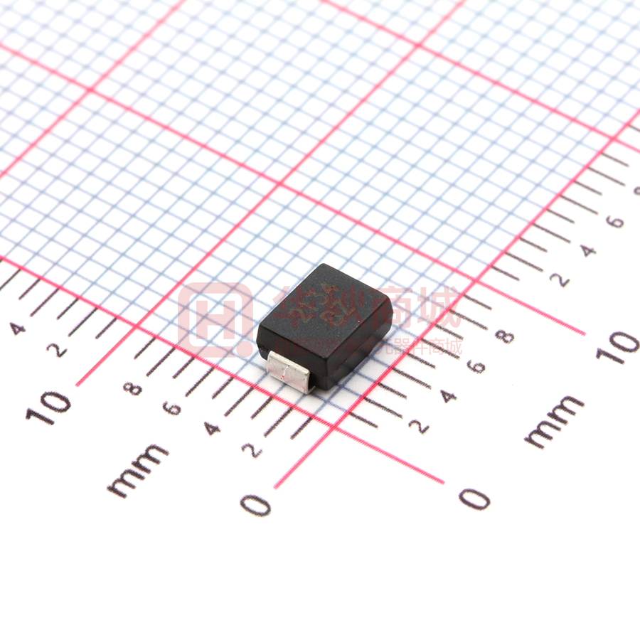

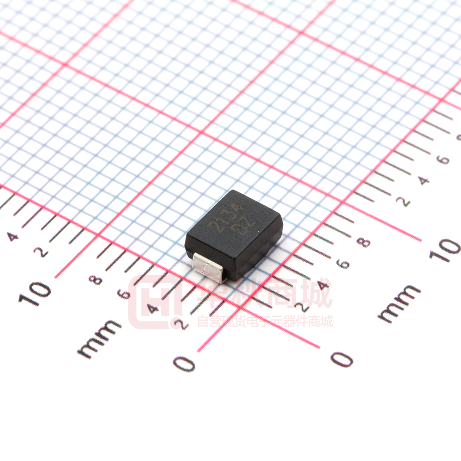

    ESD抑制器/TVS二极管 VRWM=24V VBR(min)=26.7V VC=38.9V@IPP=15.4A SMB
SMBJ24CA 数据手册
SMBJ Series Transient Voltage Suppressors SMBJxxA(CA) ROHS DESCRIPTION: TVS diodes can be used in a wide range of applications which like consumer electronic products, automotive industries, munitions, telecommunications, aerospace industries, and intelligent control systems. SMB FEATURES:  Glass passivated or planar junction  Excellent clamping capability  Repetition rate (duty cycle): 0.01%  Typical IR less than 1μA above 10V.  Low profile package and low inductance  600W Peak Pulse power capability at 10×1000μs waveform.  Fast response time: typically less than 1.0ps from 0V to VBR min.  High temperature soldering: 260℃/10s at terminals. Symbol  Plastic package has Underwriters Laboratory Flammability 94V-0.  For surface mounted applications in order to optimize board space ABSOLUTE MAXIMUM RATINGS (TA=25ºC, RH=45%-75%, unless otherwise noted) Parameter Storage temperature range Operating junction temperature range Steady state power dissipation at TL=75℃ Peak pulse power dissipation on 10/1000μs waveform Maximum Instantaneous Forward Voltage at 50A for Unidirectional 1/5 Symbol Value Unit Tstg -55 to +150 ℃ Tj -55 to +150 ℃ PM(AV) 5.0 W PPP 600 W VF 5.0 V SMBJ Series Transient Voltage Suppressors SMBJxxA(CA) ROHS ELECTRICAL CHARACTERISTICS (TA=25℃) Part Number VR IR@VR VBR@IT IT VC@IPP IPP① max(V) A Uni-Polar Bi-Polar V μA min(V) max(V) mA SMBJ5.0A SMBJ5.0CA 5.0 50 6.40 7.00 10 9.2 65.2 SMBJ6.0A SMBJ6.0CA 6.0 50 6.67 7.37 10 10.3 58.3 SMBJ6.5A SMBJ6.5CA 6.5 50 7.22 7.98 10 11.2 53.6 SMBJ7.0A SMBJ7.0CA 7.0 50 7.78 8.60 10 12.0 50.0 SMBJ7.5A SMBJ7.5CA 7.5 50 8.33 9.21 1 12.9 46.5 SMBJ8.0A SMBJ8.0CA 8.0 20 8.89 9.83 1 13.6 44.1 SMBJ8.5A SMBJ8.5CA 8.5 10 9.44 10.40 1 14.4 41.7 SMBJ9.0A SMBJ9.0CA 9.0 5 10.00 11.10 1 15.4 39.0 SMBJ10A SMBJ10CA 10 2 11.10 12.30 1 17.0 35.3 SMBJ11A SMBJ11CA 11 1 12.20 13.50 1 18.2 33.0 SMBJ12A SMBJ12CA 12 1 13.30 14.70 1 19.9 30.2 SMBJ13A SMBJ13CA 13 1 14.40 15.90 1 21.5 27.9 SMBJ14A SMBJ14CA 14 1 15.60 17.20 1 23.2 25.9 SMBJ15A SMBJ15CA 15 1 16.70 18.50 1 24.4 24.6 SMBJ16A SMBJ16CA 16 1 17.80 19.70 1 26.0 23.1 SMBJ17A SMBJ17CA 17 1 18.90 20.90 1 27.6 21.8 SMBJ18A SMBJ18CA 18 1 20.00 22.10 1 29.2 20.6 SMBJ20A SMBJ20CA 20 1 22.20 24.50 1 32.4 18.6 SMBJ22A SMBJ22CA 22 1 24.40 26.90 1 35.5 16.9 SMBJ24A SMBJ24CA 24 1 26.70 29.50 1 38.9 15.4 SMBJ26A SMBJ26CA 26 1 28.90 31.90 1 42.1 14.3 SMBJ28A SMBJ28CA 28 1 31.10 34.40 1 45.4 13.2 SMBJ30A SMBJ30CA 30 1 33.30 36.80 1 48.4 12.4 SMBJ33A SMBJ33CA 33 1 36.70 40.60 1 53.3 11.3 SMBJ36A SMBJ36CA 36 1 40.00 44.20 1 58.1 10.4 SMBJ40A SMBJ40CA 40 1 44.40 49.10 1 64.5 9.3 SMBJ43A SMBJ43CA 43 1 47.80 52.80 1 69.4 8.7 SMBJ45A SMBJ45CA 45 1 50.00 55.30 1 72.7 8.3 SMBJ48A SMBJ48CA 48 1 53.30 58.90 1 77.4 7.8 SMBJ51A SMBJ51CA 51 1 56.70 62.70 1 82.4 7.3 2/5 SMBJ Series Transient Voltage Suppressors SMBJxxA(CA) ROHS ELECTRICAL CHARACTERISTICS (TA=25℃, continued) Part Number VR IR@VR VBR@IT IT VC@IPP IPP① Uni-Polar Bi-Polar V μA min(V) max(V) mA max(V) A SMBJ54A SMBJ54CA 54 1 60.00 66.30 1 87.1 6.9 SMBJ58A SMBJ58CA 58 1 64.40 71.20 1 93.6 6.4 SMBJ60A SMBJ60CA 60 1 66.70 73.70 1 96.8 6.2 SMBJ64A SMBJ64CA 64 1 71.10 78.60 1 103.0 5.8 SMBJ70A SMBJ70CA 70 1 77.80 86.00 1 113.0 5.3 SMBJ75A SMBJ75CA 75 1 83.30 92.10 1 121.0 5.0 SMBJ78A SMBJ78CA 78 1 86.70 95.80 1 126.0 4.8 SMBJ85A SMBJ85CA 85 1 94.40 104.0 1 137.0 4.4 SMBJ90A SMBJ90CA 90 1 100.0 111.0 1 146.0 4.1 SMBJ100A SMBJ100CA 100 1 111.0 123.0 1 162.0 3.7 SMBJ110A SMBJ110CA 110 1 122.0 135.0 1 177.0 3.4 SMBJ120A SMBJ120CA 120 1 133.0 147.0 1 193.0 3.1 SMBJ130A SMBJ130CA 130 1 144.0 159.0 1 209.0 2.9 SMBJ150A SMBJ150CA 150 1 167.0 185.0 1 243.0 2.5 SMBJ160A SMBJ160CA 160 1 178.0 197.0 1 259.0 2.3 SMBJ170A SMBJ170CA 170 1 189.0 209.0 1 275.0 2.2 SMBJ180A SMBJ180CA 180 1 201.0 222.0 1 292.0 2.1 SMBJ190A SMBJ190CA 190 1 211.0 234.0 1 307.0 2.0 SMBJ200A SMBJ200CA 200 1 224.0 247.0 1 324.0 1.9 SMBJ210A SMBJ210CA 210 1 233.0 258.0 1 337.0 1.8 SMBJ220A SMBJ220CA 220 1 246.0 272.0 1 356.0 1.7 SMBJ250A SMBJ250CA 250 1 279.0 309.0 1 405.0 1.5 SMBJ300A SMBJ300CA 300 1 335.0 371.0 1 486.0 1.3 SMBJ350A SMBJ350CA 350 1 391.0 432.0 1 567.0 1.1 SMBJ400A SMBJ400CA 400 1 447.0 494.0 1 648.0 0.9 SMBJ440A SMBJ440CA 440 1 492.0 543.0 1 713.0 0.8 ①Surge waveform: 10/1000μs VR :Stand-off Voltage -- Maximum voltage that can be applied VBR: Breakdown Voltage VC:Clamping Voltage -- Peak voltage measured across the suppressor at a specified Ipp IR: Reverse Leakage Current 3/5 SMBJ Series Transient Voltage Suppressors SMBJxxA(CA) ROHS ORDERING INFORMATION RATINGS AND V-I CHARACTERISTICS CURVES (TA=25ºC, unless otherwise noted) FIG.1:V- I curve characteristics (Uni-directional) FIG.2:V- I curve characteristics (Bi-directional) IPP VC VBR VR IT IR VC VBR VR V VF VR VBR VC IPP IPP FIG.4: Pulse derating curve FIG.3: Pulse waveform IPPM(%IRSM) 150 PPP derating in percentage(%) 100 tr = rise time to peak value td = decay time to half value tr=10μs 100 V IR IT 80 Peak value 60 Half value 40 50 20 td t(ms) 0 0 4/5 1.0 2.0 3.0 4.0 0 0 TA(℃) 25 50 75 100 125 150 175 SMBJ Series Transient Voltage Suppressors SMBJxxA(CA) ROHS SOLDERING PARAMETERS -Temperature Min (Ts(min)) Pb-Free assembly (see FIG.5) +150℃ -Temperature Max(Ts(max)) +200℃ -Time (Min to Max) (ts) 60-180 secs. Pre Heat tp TP Critical Zone TL to TP Ramp-up Average ramp up rate (Liquid us Temp (TL) to peak) 3℃/sec. Max Ts(max) to TL - Ramp-up Rate 3℃/sec. Max Reflow FIG.5: Reflow condition -Temperature(TL)(Liquid us) +217℃ -Temperature(tL) 60-150 secs. TL Ramp-down Preheat TS(min) ts 25 Peak Temp (Tp) +260(+0/-5)℃ Time within 5℃of actual Peak Temp (tp) 30 secs. Max Ramp-down Rate 6℃/sec. Max Time 25℃to Peak Temp (TP) 8 min. Max Do not exceed +260℃ tL TS(max) Temperature Reflow Condition time to peak temperatue (t 25℃ to peak) Time PACKAGE MECHANICAL DATA A Dimensions C Ref. H G D E L J K Millimeters Min. Max. Min. Max. A 4.25 4.75 0.167 0.187 B 3.30 3.94 0.130 0.155 C 1.85 2.21 0.073 0.087 D 0.76 1.52 0.030 0.060 E 5.08 5.59 0.200 0.220 F 0.051 0.203 0.002 0.008 G 0.15 0.31 0.006 0.012 H 2.11 2.44 0.083 0.096 J 6.80 5/5 L 0.270 2.60 K DO-214AA (SMB) Inches 2.40 0.100 0.090
