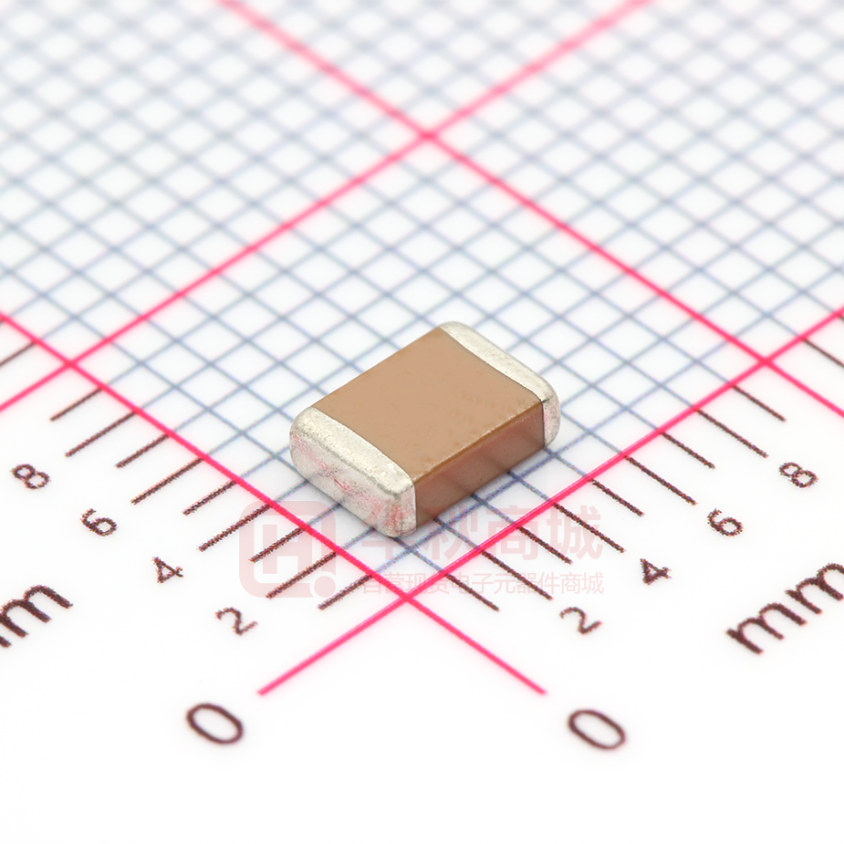

    贴片电容(MLCC) 1812 4.7μF ±10% 50V X7R
1812B475K500NT 数据手册
附件 7 版本号:FH-2016-001 风华高科 广 东 风 华 高 新 科 技 股 份 有 限 公 司 FENGHUA Fenghua Advanced Technology (Holding) CO. , LTD 一、概述 ●电容器及介质种类: ※高频类: 此类介质材料的电容器为Ⅰ类电容器,包括通用型高频 COG、COH 电容器和温度补偿型高频 HG、LG、PH、RH、SH、TH、UJ、SL 电容器。其中 COG、COH 电容器电性能最稳定,几乎不随温度、 电压和时间的变化而变化,适用于低损耗,稳定性要求高的高频电路,HG、LG、PH、RH、SH、TH、UJ、 SL 电容器容量随温度变化而相应变化,适用于低损耗、温度补偿型电路中。 ※ X7R、X5R、X7S、X6S:此类介质材料的电容器为Ⅱ类电容器,具有较高的介电常数,容量比Ⅰ类电容 器高,具有较稳定的温度特性,适用于容量范围广,稳定性要求不高的电路中,如隔直、耦合、旁路、鉴频 等电路中。 ※Y5V:此类介质材料的电容器为Ⅱ类电容器,是所有电容器中介电常数最大的电容器,但其容量稳定性较 差,对温度、电压等条件较敏感,适用于要求大容量,温度变化不大的电路中。 ※Z5U:此类介质材料的电容器为Ⅱ类电容器,其温度特性介于 X7R 和 Y5V 之间,容量稳定性较差,对温 度、电压等条件较敏感,适用于要求大容量,使用温度范围接近于室温的旁路,耦合等,低直流偏压的电路 中。 SUMMARY ●Types of Dielectric Material and Capacitor ※HIGH FREQUENCY TYPE: The capacitor of this kind dielectric material is considered as ClassⅠcapacitor, including high frequency COG、COH capacitor and temperature compensating capacitor such as HG, LG, PH, RH,SH, TH, UJ, SL. The electrical properties of COG、COH capacitor are the most stable one and change invariablly with temperature, voltage and time. They are suited for applications where low-losses and high-stability are required, HG, LG, PH,RH, SH, TH,UJ, SL capacitor’s capacitance changes with temperature.They are suited for applications where low-losses and temperature compensating circuits. ※X7R、X5R、 X7S、X6S: X7R、 X5R、X7S、 X6S material is a kind of material has high dielectric constant. The capacitor made of this kind material is considered as Class Ⅱ capacitor whose capacitance is higher than that of class Ⅰ. These capacitors are classified as having a semi-stable temperature characteristic and used over a wide temperature range, such in these kinds of circuits, DC-blocking, decoupling, bypassing, frequency discriminating etc. ※Y5V:The capacitor made of this kind of material is the highest dielectric constant of all ceramic capacitors. They are used over a moderate temperature range in application where high capacitance is required because of its unstable temperature coefficient, but where moderate losses and capacitance changes can be tolerated. Its capacitance and dissipation factors are sensible to measuring conditions, such as temperature and voltage, etc. ※Z5U:The capacitor made of this kind of material is considered as ClassⅡ capacitor, whose temperature characteristic is between that of X7R and Y5V. The capacitance of this kind of capacitor is unstable and sensible to temperature and voltage. Ideally suited for bypassing and decoupling application circuits operating with low DC bias in the environment approaches to room temperature. 第 1 页 共 27 页 风华高科 广 东 风 华 高 新 科 技 股 份 有 限 公 司 FENGHUA 二、尺寸及结构 Fenghua Advanced Technology (Holding) CO. , LTD DIMENSIONS AND STRUCTURE ※ 尺寸 DIMENSIONS L L W T WB WB 型号 Type 尺寸 Dimensions (mm) 英制表示 British expression 0201 0402 0603 公制表示 Metric expression 0603 1005 1608 L W T WB 0.6±0.03 1.00±0.05 1.60±0.10 0.3±0.03 0.50±0.05 0.80±0.10 0.15±0.10 0.25±0.10 0.30±0.10 0805 2012 2.00±0.20 1.25±0.20 1206 3216 3.20±0.30 1.60±0.30 1210 1808 1812 2220 2225 3012 3035 3225 4520 4532 5750 5763 7632 7690 3.20±0.30 4.50±0.40 4.50±0.40 5.70±0.40 5.70±0.50 7.60±0.50 7.60±0.50 2.50±0.30 2.00±0.20 3.20±0.30 5.00±0.40 6.30±0.50 3.20±0.30 9.00±0.50 0.3±0.03 0.50±0.05 0.80±0.10 ≤0.55 0.80±0.20 1.00±0.20 1.25±0.20 0.80±0.20 1.00±0.20 1.25±0.20 1.60±0.30 ≤2.80 ≤2.20 ≤3.50 ≤3.50 ≤6.20 ≤8.10 ≤8.10 备注:可根据客户的特殊要求设计符合客户需求的产品。 Note:We can design according to customer special requirements 序号 NO ※ 结构 STRUCTURE W L ① ② T ③ ① ② ③ ④ ④ ⑤ ⑤ 第 2 页 名称 Name 陶瓷介质 Ceramic dielectric 内电极 Inner electrode 外电极 Substrate electrode 镍层 Nickel Layer 锡层 Tin Layer 共 27 页 0.50±0.20 0.60±0.30 0.60±0.30 0.60±0.30 0.60±0.30 0.60±0.30 0.60±0.30 0.60±0.30 0.60±0.30 风华高科 广 东 风 华 高 新 科 技 股 份 有 限 公 司 FENGHUA Fenghua Advanced Technology (Holding) CO. , LTD 三、型号规格表示方法 HOW TO ORDER 0805 CG 101 J 500 N T ① ② ③ ④ ⑤ ⑥ ⑦ 0805 1206 1210 1808 1812 2220 2225 3035 0.08×0.05 0.12×0.06 0.12×0.10 0.18×0.08 0.18×0.12 0.22×0.20 0.22×0.25 0.30×0.35 2.00×1.25 3.20×1.60 3.20×2.50 4.50×2.00 4.50×3.20 5.70×5.00 5.70×6.30 7.60×9.00 ※说明 NOTES: ①尺寸 DIMENSIONS 尺寸规格 0201 0402 0603 SizeCode 长×宽 (L×W) 0.02×0.01 0.04×0.02 0.06×0.03 inch 长×宽 (L×W) 0.60×0.30 1.00×0.50 1.60×0.80 mm .② 介质种类 DIELECTRIC STYLE 介质种类 (Dielectric Code) 介质材料 (Dielectric) CG CH CO CO G H HG LG PH RH SH TH UJ SL HG LG PH RH SH TH UJ SL X B BS DS E F X5 X7 X7 X6 Z5 Y5 R R S S U V ③ 标称容量 NOMINAL CAPACITANCE 单位(unit):pF 表示方式 实际值 (Express Method) (Actual Value) 0R5 0.5 1R0 1.0 102 10×102 224 22×104 … … 注:头两位数字为有效数字,第三位数字为 0 的个数;R 为小数点。 Note: the first two digits are significant; third digit denotes number of zeros; R=decimal point. ④ 容量误差 CAPACITANCE TOLERANCE 代码 (Code) A B C D F G J 误差 ± ± ± ± ± ± ± (Tolerance) 0.05pF 0.10pF 0.25pF 0.5pF 1.0% 2.0% 5.0% K ±10% M ±20% S Z +50% -20% +80% -20% 备注:A、B、C、D 级误差适用于容量≤10pF 的产品。 Note:These capacitance tolerance A,B, C, D are just applicable the capacitance that equals to or less than 10pF。 第 3 页 共 27 页 风华高科 广 东 风 华 高 新 科 技 股 份 有 限 公 司 FENGHUA Fenghua Advanced Technology (Holding) CO. , LTD ⑤ 额定电压 RATED VOLTAGE 表示方式 实际值 (Express Method) (Actual Value) 6R3 6.3 500 50×100 201 20×101 102 10×102 … … 单位(unit):V 注:头两位数字为有效数字,第三位数字为 0 的个数; R 为小数点。 Note: the first two digits are significant; third digit denotes number of zeros; R=decimal point. ⑥ 端头材料 TERMINAL MATERIAL STYLES 端头类别 (Termination Styles) 纯银端头 表示方式 (Express Method) (Silver Solderable Termination) S 纯铜端头 (Copper Solderable Termination) C 三层电镀端头 (Nickel Barrier Termination) N ⑦ 包装方式 PACKAGE STYLES B T 散包装(Bulk Bag) 编带包装(Taping Package) 四、温度系数/特性 Temperature Coefficient /Characteristics 介质种类 Dielectric 参考温度点 Reference Temperature Point COG COH HG LG 20°C 20°C 20°C 20°C PH RH SH TH UJ SL X7R X5R X7S X6S Z5U Y5V 20°C 20°C 20°C 20°C 20°C 20°C 20°C 20°C 20°C 20°C 20°C 20°C 标称温度系数 Temperature Coefficient 0±30 0±60 -33±30 -75±30 ppm/℃ ppm/℃ ppm/℃ ppm/℃ -150± 60 ppm/℃ -220± 60 ppm/℃ -330± 60 ppm/℃ -470± 60 ppm/℃ -750± 120 ppm/℃ -1000~+140 ppm/℃ ±15% ±15% ±22% ±22% -56%~+22% -80%~+30% 工作温度范围 Operation Temperature Range -55℃~125℃ -55℃~125℃ -25℃~85℃ -25℃~85℃ -25℃~85℃ -25℃~85℃ -25℃~85℃ -25℃~85℃ -25℃~85℃ -25℃~85℃ -55℃~125℃ -55℃~85℃ -55℃~125℃ -55℃~105℃ 10℃~85℃ -25℃~85℃ 备注:Ⅰ类电容器标称温度系数和允许偏差是采用温度在 20°C 和 85°C 之间的电容量变化来确定的,而Ⅱ类 电容器标称温度系数是按照工作范围之间的电容量相对 20°C 的电容量变化来确定的。 Note:Nominal temperature coefficient and allowed tolerance of class Ⅰare decided by the changing of the capacitance between 20°C and 85°C. Nominal temperature coefficient of class Ⅱare decided by the temperature of 20°C. 第 4 页 共 27 页 风华高科 广 东 风 华 高 新 科 技 股 份 有 限 公 司 FENGHUA 五、容量范围及其电压 Fenghua Advanced Technology (Holding) CO. , LTD Capacitance Range and Operating Voltage 尺寸规格 额定电压 Size Code Rated Voltage COG(NPO)(PF) Y5V (Z5U)(PF) 4V —— —— 6.3V —— 10,000~100,000 10V —— —— 16V —— 10,000 25V —— —— 50V 0.5~100 —— 4V —— —— 6.3V —— 1,000~1,000,000 10V —— 1,000~1,000,000 16V —— 1,000~220,000 25V —— 1,000~220,000 50V 0.1~1,000 1,000~100,000 4V —— —— 6.3V —— 1,000~10,000,000 10V —— 1,000~10,000,000 16V —— 1,000~2,200,000 25V —— 1,000~2,200,000 50V 0.1~6,800 1,000~1,000,000 4V —— —— 6.3V —— 1,000~22,000,000 10V —— 1,000~22,000,000 16V —— 1,000~22,000,000 25V —— 1,000~10,000,000 50V 0.3~22,000 1,000~4,700,000 容量范围 Capacitance 0201 0402 0603 0805 第 5 页 共 27 页 风华高科 广 东 风 华 高 新 科 技 股 份 有 限 公 司 FENGHUA Fenghua Advanced Technology (Holding) CO. , LTD 尺寸规格 额定电压 容量范围 Capacitance Size Code Rated Voltage COG(NPO)(PF) Y5V (Z5U)(PF) 4V —— —— 6.3V —— 1,000~47,000,000 10V —— 1,000~47,000,000 16V —— 1,000~47,000,000 25V —— 1,000~10,000,000 50V 0.3~100,000 1,000~10,000,000 6.3V —— 4,700~100,000,000 10V —— 4,700~47,000,000 16V —— 4,700~22,000,000 25V —— 4,700~10,000,000 50V 10~100,000 4,700~10,000,000 6.3V —— —— 10V —— —— 16V —— —— 25V —— —— 50V 10~100,000 —— 6.3V —— 10,000~100,000,000 10V —— 10,000~100,000,000 16V —— 10,000~22,000,000 25V —— 10,000~10,000,000 50V 10~100,000 10,000~10,000,000 1206 1210 1808 1812 第 6 页 共 27 页 风华高科 广 东 风 华 高 新 科 技 股 份 有 限 公 司 FENGHUA 尺寸规格 Size Code Fenghua Advanced Technology (Holding) CO. , LTD 额定电压 容量范围 Capacitance Rated Voltage X7R (PF) X7S(PF) X5R(uF) X6S(uF) 4V —— —— 0.015 uF~1uF —— 6.3V —— —— 0.015 uF~1uF —— 10V 100~10,000 —— 0.015 uF~0.1 uF —— 16V 100~10,000 —— —— —— 25V 100~10,000 —— —— —— 50V —— —— —— —— 4V —— —— 0.1uF~10uF 0.1~2.2 uF 6.3V 100~470,000 100,000~470,000 0.1uF~4.7uF 0.1~2.2 uF 10V 100~470,000 100,000~470,000 0.1uF~4.7uF 0.1~1 uF 16V 100~220,000 47,000~220,000 0.1uF~2.2 uF —— 25V 100~100,000 22,000~100,000 0.1uF~2.2 uF —— 50V 100~100,000 4,700~100,000 0.047uF~0.1 uF —— 4V —— —— 0.47uF~22uF 0.1~10 uF 6.3V 150~2,200,000 470,000~2,200,000 0.47uF~22uF 0.1~10 uF 10V 150~2,200,000 470,000~2,200,000 0.47uF~10uF 0.1~10 uF 16V 150~1,000,000 470,000~1,000,000 0.47uF~10uF 0.1~4.7 uF 25V 150~1,000,000 470,000~1,000,000 0.47uF~10uF 0.1~4.7 uF 50V 150~470,000 —— 0.47uF~1uF —— 4V —— —— 1uF~47uF 0.1~47 uF 6.3V 150~10,000,000 1,000,000~10,000,000 1uF~47uF 0.1~22 uF 10V 150~10,000,000 1,000,000~10,000,000 1uF~22uF 0.1~10 uF 16V 150~4,700,000 1,000,000~4,700,000 1uF~22uF 0.1~10 uF 25V 150~4,700,000 1,000,000~4,700,000 1uF~10uF 0.1~10 uF 50V 150~1,000,000 —— —— —— 0201 0402 0603 0805 第 7 页 共 27 页 风华高科 广 东 风 华 高 新 科 技 股 份 有 限 公 司 FENGHUA Fenghua Advanced Technology (Holding) CO. , LTD 尺寸规格 额定电压 Size Code Rated Voltage X7R (PF) X7S (PF) X5R(uF) X6S(uF) 4V —— —— 2.2uF ~100uF —— 6.3V 200~22,000,000 2,200,000~22,000,000 2.2uF~100uF 0.1~100 uF 10V 200~22,000,000 2,200,000~22,000,000 2.2uF~47uF 0.1~22 uF 16V 200~10,000,000 2,200,000~10,000,000 2.2uF~22uF 0.1~22 uF 25V 200~10,000,000 1,500,000~10,000,000 2.2uF~22uF 0.1~10 uF 50V 200~4,700,000 1,000,000~4,700,000 2.2uF~10uF —— 6.3V 220~47,000,000 —— 47uF~100uF 0.1~100 uF 10V 220~47,000,000 —— 4.7uF~100uF 0.1~47 uF 16V 220~22,000,000 3,300,000~22,000,000 4.7uF~47uF 0.1~22 uF 25V 220~22,000,000 2,200,000~22,000,000 4.7uF~22uF 0.1~22 uF 50V 220~10,000,000 1,000,000~10,000,000 —— —— 6.3V 220~4,700,000 —— 4.7uF~100uF —— 10V 220~4,700,000 —— 4.7uF~47uF —— 16V 220~4,700,000 —— 4.7uF~22uF —— 25V 220~4,700,000 —— 4.7uF~10uF —— 50V 220~4,700,000 —— —— —— 6.3V —— —— 10uF~100uF —— 10V —— —— 10uF~47uF —— 16V 470~6,800,000 —— 4.7uF~22uF —— 25V 470~6,800,000 —— 4.7uF~10uF —— 50V 470~4,700,000 —— —— —— 容量范围 Capacitance 1206 1210 1808 1812 备注:可根据客户的特殊要求设计符合客户需求的产品。 Note:We can design according to customer special requirements. 第 8 页 共 27 页 风华高科 广 东 风 华 高 新 科 技 股 份 有 限 公 司 FENGHUA Fenghua Advanced Technology (Holding) CO. , LTD 六、高 Q 值 COG 电容器 Hi-Q COG MLCC ※ 应用: 适合于射频 RF 电路及要求 Hi-Q、低 ESR、高频率响应的微波电路中。 ●CQ、CG 电容器说明: ※下述 Q 值标准是相对通用客户而制定的,对要求更高 Q 值产品的客户,可专门设计和生产。 ※使用频率在 1MHz~2.4GHz 之间,对要求更高频率产品的客户,可根据客户的要求另外专门设计。 ※CQ 比 CG 相对可应用频率略高,请客户依需选定。 ※ Application: Hi-Q COG capacitors are ideally suited for RF and microwave application requiring high Q, low ESR, and high resonant frequency。 ●Note for CQ and CG: ※The following Q value is just confirmed by general customer. If there is a higher requirement for Q value requirements, we can design and produce according to the special requirements。 ※For the customer whose requirements for frequency is between 1MHz and 2.4GHz or higher frequency, we can design it according to their requirements。 ※The frequency of CQ is a little higher than that of CG. Please choose them according to your requirements。 ※ CQ 电容器的容量值及其 Q 值 CQ Capacitance value and Q value 容量 300MHz 时的Q 值 容量 300MHz 时的Q 值 容量 300MHz 时的Q 值 Capacitance Q value at 300MHz Capacitance Q value at 300MHz Capacitance Q value at 300MHz (pF) 0805 0603 (pF) 0805 0603 (pF) 0805 0603 4.7 ≥1000 ≥800 12 ≥400 ≥320 30 ≥150 ≥120 5.2 ≥900 ≥720 13 ≥375 ≥300 33 ≥140 ≥112 5.6 ≥850 ≥680 14 ≥350 ≥280 36 ≥130 ≥104 6.2 ≥800 ≥640 15 ≥325 ≥260 39 ≥120 ≥96 6.8 ≥700 ≥560 16 ≥300 ≥240 43 ≥110 ≥88 7.5 ≥650 ≥520 18 ≥250 ≥200 47 ≥100 ≥80 8.2 ≥575 ≥460 20 ≥225 ≥180 56 ≥80 ≥80 9.1 ≥525 ≥420 22 ≥215 ≥172 62 ≥80 ≥80 10 ≥500 ≥400 24 ≥200 ≥160 68 ≥80 ≥80 11 ≥450 ≥360 27 ≥175 ≥140 82 ≥80 ≥80 第 9 页 共 27 页 风华高科 广 东 风 华 高 新 科 技 股 份 有 限 公 司 FENGHUA 七、中高压电容器 Fenghua Advanced Technology (Holding) CO. , LTD HIGH VOLTAGE MLCC 中高压多层片状陶瓷电容器是在多层片状陶瓷电容器的工艺技术、设备基础上,通过采用特殊工艺制 作的一种具有良好高压可靠性的产品,该产品适合于表面贴装,适合于多种直流高压线路,可以有效的改 善电子线路的性能。 ●应用范围 ※模拟或数字调制解调器 。 ※局域网/广域网接口界面。 ※日光灯启动辉器照明电路。 ※倍压电器。 ※直流变送器。 ※背光源驱动电路。 Middle & high voltage MLCC is a kind of special design 、special technology MLCC that bases on the technology of general MLCC. This kind of MLCC has stable high voltage reliability and suitable to SMT. Middle & high MLCC is widely applicable for many direct high voltage circuits in which it can improve the performance of the circuit. ●APPLICATIONS ※Analog & Digital Modems ※LAN/WAN Interface ※Lighting Ballast Circuits ※Voltage Multipliers ※DC-DC Converters ※Back-lighting Inverters 容量范围及其电压 单位/unit: pF 尺寸规格 工作电压 Size Code Rated Voltage NPO X7R Y5V 100V 0.5~1,000 150~100,000 200V 0.5~470 150~10,000 2,200~100,000 —— 250V 0.5~470 150~10,000 —— 100V 0.5~3,300 150~100,000 10,000~100,000 200V 0.1~1,500 150~22,000 10,000~47,000 250V 0.1~1,500 150~22,000 10,000~47,000 500V 0.1~470 150~10,000 —— 630V 0.1~470 150~10,000 —— 1000V 0.1~100 —— —— 100V 0.5~3,300 150~1,000,000 15,000~470,000 200V 0.1~2,700 150~220,000 10,000~220,000 250V 0.1~2,700 150~220,000 10,000~220,000 500V 0.1~1,500 150~33,000 —— 630V 0.1~1,500 150~33,000 —— 1000V 0.1~1,000 150~10,000 —— 2000V 0.1~270 150~2,700 —— 0603 0805 1206 第 10 页 容量范围 Capacitance 共 27 页 风华高科 广 东 风 华 高 新 科 技 股 份 有 限 公 司 FENGHUA Fenghua Advanced Technology (Holding) CO. , LTD 容量范围及其电压 尺寸规格 Size Code 1210 1808 1812 1825 单位/unit: pF 容量范围 Capacitance 工作电压 Rated Voltage NPO X7R Y5V 100V 1.0~6,800 150~2,200,000 15,000~1,000,000 200V 250V 1.0~3,300 1.0~3,300 150~220,000 150~220,000 15,000~470,000 15,000~470,000 500V 630V 1000V 1.0~2,200 1.0~2,200 1.0~1,000 150~68,000 150~68,000 150~22,000 —— —— —— 2000V 3000V 1.0~470 —— 150~10,000 150~680 —— —— 4000V 100V 200V 250V 500V 630V 1000V 2000V 3000V 4000V 5000V 100V —— 2.0~4,700 2.0~3,900 2.0~3,900 2.0~2,700 2.0~2,700 2.0~1,000 2.0~470 2.0~330 2.0~33 2.0~33 3.0~10,000 150~680 220~2,200,000 220~220,000 220~220,000 220~68,000 220~68,000 150~22,000 150~10,000 150~4,700 150~2,200 —— 270~1,000,000 —— 150,000~1,000,000 10,000~390,000 10,000~390,000 —— —— —— —— —— —— —— 150,000~2,200,000 200V 250V 500V 630V 1000V 2000V 3000V 4000V 5000V 100V 200V 250V 500V 630V 1000V 2000V 3000V 4000V 5000V 3.0~6,800 3.0~6,800 3.0~4,700 3.0~4,700 3.0~1,200 3.0~1,000 3.0~560 3.0~220 3.0~68 3.0~22,000 3.0~8,200 3.0~8,200 3.0~5,600 3.0~5,600 3.0~1,800 3.0~1,000 3.0~680 3.0~470 3.0~82 270~560,000 270~560,000 270~150,000 270~150,000 270~56,000 270~12,000 270~4,700 270~3,300 —— 12,000~1,200,000 12,000~1,000,000 12,000~1,000,000 1,000~470,000 1,000~470,000 1,000~100,000 1,000~22,000 1,000~10,000 1,000~6,800 —— 100,000~470,000 100,000~470,000 —— —— —— —— —— —— —— 150,000~2,200,000 100,000~470,000 100,000~470,000 —— —— —— —— —— —— —— 第 11 页 共 27 页 风华高科 广 东 风 华 高 新 科 技 股 份 有 限 公 司 FENGHUA 尺寸规格 Size Code 2220 2225 3012 3035 Fenghua Advanced Technology (Holding) CO. , LTD 工作电压 Rated Voltage 容量范围 Capacitance NPO X7R Y5V 100V 5.0~27,000 22,000~1,200,000 150,000~1,500,000 200V 5.0~12,000 22,000~1,000,000 100,000~1,000,000 250V 5.0~12,000 22,000~1,000,000 100,000~1,000,000 500V 5.0~6,800 1,500~470,000 —— 630V 1000V 5.0~6,800 5.0~3,900 1,500~470,000 1,500~100,000 —— —— 2000V 5.0~1,000 1,500~33,000 —— 3000V 5.0~680 1,500~10,000 —— 4000V 5.0~560 1,500~6,800 —— 5000V 5.0~120 —— —— 100V 200V 5.0~27,000 5.0~12,000 2,200~2,200,000 2,200~2,200,000 250,000~3,300,000 220,000~2,200,000 250V 5.0~12,000 2,200~2,200,000 220,000~2,200,000 500V 630V 5.0~6,800 5.0~6,800 2,200~470,000 2,200~470,000 —— —— 1000V 5.0~3,900 2,200~100,000 —— 2000V 5.0~1,000 2,200~47,000 —— 3000V 5.0~680 2,200~15,000 —— 4000V 5.0~560 2,200~6,800 —— 5000V 100V 5.0~120 5.0~27,000 —— 150~3,300,000 —— 15,000~1,500,000 200V 5.0~12,000 150~2,200,000 15,000~1,000,000 250V 5.0~12,000 150~1,200,000 —— 500V 5.0~6,800 150~220,000 —— 630V 5.0~6,800 150~150,000 —— 1000V 2000V 5.0~3,900 5.0~1,000 150~47,000 150~33,000 —— —— 3000V 5.0~1,000 150~10,000 —— 4000V 100V 5.0~1,000 5.0~27,000 150~8,200 47,000~4,700,000 —— 10,000~2,200,000 200V 5.0~12,000 47,000~2,200,000 10,000~2,200,000 250V 500V 5.0~12,000 5.0~6,800 47,000~2,200,000 5,600~1,000,000 10,000~2,200,000 —— 630V 5.0~6,800 5,600~470,000 —— 1000V 2000V 5.0~3,900 5.0~1,000 5,600~56,000 5,600~47,000 —— —— 备注:可根据客户的特殊要求设计符合客户需求的产品。 Note:We can design according to customer special requirements. 第 12 页 共 27 页 风华高科 广 东 风 华 高 新 科 技 股 份 有 限 公 司 FENGHUA Fenghua Advanced Technology (Holding) CO. , LTD 中高压电容器介质耐电强度的测试方法: Measurement method of dielectric withstanding voltage for high voltage MLCC 额定电压范围 Rated voltage range 100V≤Vr<500V 500V≤Vr≤1000V 1000V<Vr≤2000V 2000V<Vr≤5000V 八、可靠性测试 项目 Item 容量 Capacitance 损耗角正切 (DF, tanδ) Dissipation Factor 耐电性能的测试方法 Measuring Method 施加额定电压的 200%, 5 秒, 最大电流不超过 50mA Force 200%Rated voltage for 5 second. Max..current should not exceed 50 mA. 施加额定电压的 150%, 5 秒, 最大电流不超过 50mA Force 150%Rated voltage for 5 second. Max..current should not exceed 50 mA. 施加额定电压的 120%, 5 秒, 最大电流不超过 50mA Force 120%Rated voltage for 5 seconds. Max..current should not exceed 50 mA. 施加额定电压的 120%, 5 秒, 最大电流不超过 10mA Force 120%Rated voltage for 5 seconds. Max..current should not exceed 10 mA. Reliability Test 技术规格 Technical Specification 测 试 方 法 Test Method and Remarks 测试频率 测试电压 标称容量 Measuring Measuring 应符合指定的误差级别 Capacitance Ⅰ类 Should be within the Frequency Voltage ClassⅠ specified tolerance. ≤1000pF 1MHZ±10% 1.0±0.2Vrms >1000 pF 1KHZ±10% 测试温度: 25℃±3℃ Test Temprature: 25℃±3℃ C≤10µF:测试频率: 1KHZ±10% 测试电压: 1.0±0.2Vrms Test Frequency: 1KHZ±10% Test Voltage: 1.0±0.2Vrms C>10µF 应符合指定的误差级别 Ⅱ类 X7R、X5R、X7S、X6S、Y5V: Should be within the 测试频率: 120±24 HZ Class Ⅱ specified tolerance. 测试电压:0.5±0.1Vrms Test Frequency: 120±24 HZ Test Voltage: 0.5±0.1Vrms Z5U:测试频率:1±0.1KHZ 测试电压:0.5±0.05Vrms Test Frequency: 1±0.1KHZ Test Voltage: 0.5±0.05Vrms 测试频率 测试电压 标称容量 Measuring Measuring DF Capacitance Frequency Voltage Ⅰ类 Cr<5 pF 1MHZ±10% ≤0.56% ClassⅠ 5pF≤Cr<50 pF 1MHZ±10% 1.5[(150/Cr)+7]×10-4 1.0±0.2Vrms 50pF≤Cr≤1000 pF 1MHZ±10% ≤0.15% ≤0.15% 第 13 页 >1000 pF 1KHZ±10% 共 27 页 风华高科 广 东 风 华 高 新 科 技 股 份 有 限 公 司 FENGHUA 项目 Item 损耗角正 切(DF, tan δ) Dissipation Factor Ⅱ类 Class Ⅱ Fenghua Advanced Technology (Holding) CO. , LTD 技术规格 Technical Specification ≥ 25V 16V X7R/ 50V X5R ≤3.5% ≤3.5% X7S/ (C < (C < X6S ≤ 0.47µF) 0.47µF) (≥ 2.5% ≤10.0% ≤10.0% 0402) (C ≥ (C ≥ 0.47µF) 0.47µF) ≥ 25V 16V X7R/ 50V X5R ≤5.0% X7S/ (C < X6S ≤ 0.047µF) ≤5.0% (< 3.5% ≤10% 0402) (C > 0.047µF) ≥25V 16V ≤7.0% Y5V (C<1.0µF) Z5U ≤15% ≤9.0% (C≥1.0µF) Ⅰ类 C≤10 nF, Ri≥50000MΩ ClassⅠ C>10 nF, Ri• CR≥500S 绝缘电阻 (IR) Insulation Resistance 介质耐电强 度(DWV) Dielectric Withstanding Voltage Ⅱ类 Class Ⅱ X7R/ X5R/ X7S/ X6S C≤25 nF, Ri≥10000MΩ C>25 nF, Ri• CR>100S Y5V Z5U C≤25 nF, Ri≥4000MΩ C>25 nF, Ri• CR>100S 不应有介质被击穿或损伤 No breakdown or damage. 第 14 页 测 试 方 法 Test Method and Remarks 10V 6.3V ≤5.0% (C < 0.15µF) ≤10.0% (C ≥ 0.15µF) ≤5.0% (C < 0.15µF) ≤10.0% (C ≥ 0.15µF) 10V 6.3V ≤7.5% (C < 0.047µF) ≤10% (C > 0.047µF) 10V ≤7.5% (C < 0.047µF) ≤10% (C > 0.047µF) 6.3V ≤15% C≤10µF 测试频率: 1KHZ±10% 测试电压: 1.0±0.2Vrms Test Frequency: 1KHZ±10% Test Voltage: 1.0±0.2Vrms C>10µF X7R、X5R、X7S、X6S、Y5V 测试频率: 120±24 HZ 测试电压:0.5±0.1Vrms Test Frequency: 120±24 HZ Test Voltage: 0.5±0.1Vrms Z5U:测试频 率:1±0.1KHZ 测试电压:0.5±0.05Vrms Test Frequency: 1±0.1KHZ Test Voltage: 0.5±0.05Vrms ≤15% 测试电压:额定电压(最高 500V) 测试时间: 60±5 秒 测试湿度:≤75% 测试温度: 25℃±3℃ 测试充放电电流:≤50mA Measuring Voltage: Rated Voltage(Max 500V) Duration: 60±5s Test Humidity: ≤75% Test Temprature: 25℃±5℃ Test Current: ≤50mA 测量电压: Ⅰ类:300%额定电压 Ⅱ类:250%额定 电压 时间:1~5 秒 充/放电电流:不应超过 50mA (这部分说明不包括中高压 MLCC) Measuring Voltage: ClassⅠ:300% Rated voltage ClassⅡ:250% Rated voltage Duration: 1~5s Charge/ Discharge Current: 50mA max. (This method excludes high-voltage MLCC) 共 27 页 风华高科 广 东 风 华 高 新 科 技 股 份 有 限 公 司 FENGHUA 项目 Item 可焊性 Solderability 技术规格 Technical Specification 上锡率应大于 95% 外观:无可见损伤. At least 95% of the terminal electrode is covered by new solder. Visual Appearance: No visible damage. 项目 Item 耐焊接热 Resistance to Soldering Heat Fenghua Advanced Technology (Holding) CO. , LTD 测 试 方 法 Test Method and Remarks 将电容在 80~120℃的温度下预热 10~30 秒. Preheating conditions:80 to 120℃; 10~30s. 有铅焊料: (Sn/Pb:63/37) 无铅焊料: 浸锡温度: 235±5℃ 浸锡温度: 245±5℃ 浸锡时间: 2±0.5s 浸锡时间: 2±0.5s Solder Temperature: 235±5℃ Solder Temperature: 245±5℃ Duration: 2±0.5s Duration: 2±0.5s Y5V、 将电容在 100~200℃的温度下预热 10±2 分钟. Z5U 浸锡温度: 265±5℃ ≤ ± 0.5% 或 ± 浸锡时间: 10±1s 0.5PF,取较大值 -10~+2 然后取出溶剂清洗干净,在 10 倍以上的显微镜底 ΔC/C -5~+10% 0% ≤±0.5% or ±0.5PF, 下观察. whichever is larger 放置时间:24±2 小时 放置条件:室温 Preheating conditions: 100 to 200℃; 10±2min. 同初始标准 DF Solder Temperature: 265±5℃ Same to initial value. Duration: 10±1s 同初始标准 IR Clean the capacitor with solvent and examine it with Same to initial value. a 10X(min.) microscope. 外观:无可见损伤 上锡率:≥95% Appearance:No visible damage.At least 95% of Recovery Time: 24±2h the terminal electrode is covered by new solder. Recovery condition: Room temperature NPO至 SL NPO to SL X7R/X5R/ X7S/X6S 抗弯曲强度 外观:无可见损伤. Resistance Appearance: No visible damage. 试验基板:Al2O3 或 PCB 弯曲深度:1mm 施压速度:0.5mm/sec. 单位:mm 应在弯曲状态下进行测量。 ※ T=10 to Flexure of Substrate 45±2 45±2 Test Board: Al2O3 or PCB Warp: 1mm (Bending Strength) Speed: 0.5mm/sec. Unit: mm ΔC/C ≤±10% The measurement should be made with the board in the bending position. 第 15 页 共 27 页 风华高科 广 东 风 华 高 新 科 技 股 份 有 限 公 司 FENGHUA 项目 Item 端头结合强度 Termination Adhesion Fenghua Advanced Technology (Holding) CO. , LTD 技术规格 Technical Specification 外观无可见损伤 No visible damage. 测 试 方 法 Test Method and Remarks 施加的力:5N Applied Force: 5N 时间:10±1S Duration: 10±1S ※ 温度循环 Temperature Cycle 潮湿试验 Moisture Resistance ΔC/C: Ⅰ类:≤±1%或±1pF , 取两者中最大者 Ⅱ类: B,X,BS,DS: ≤±10% E,F: ≤±20% ClassⅠ: ≤±1% or ±1pF, whichever is larger. ClassⅡ: B,X,BS,DS: ≤±10% E,F: ≤±20% Ⅰ类: ≤±2%或±1pF, 取两者之中较大者 Ⅱ类: B,X,BS,DS:≤±10% Δ E,F: ≤±30% C/C ClassⅠ: ≤±2% or ±1pF, whichever is larger. ClassⅡ: B,X,BS,DS:≤±10% E,F: ≤±30% ≤2 倍初始标准 DF Not more than twice of initial value. Ⅰ类:Ri≥2500MΩ或 Ri• CR≥25S 取两者之中较小者. ClassⅠ: Ri≥2500MΩ或 Ri• CR≥ 25S whichever is smaller. IR Ⅱ类:Ri≥1000MΩ或 Ri• CR≥25S 取两者之中较小者. ClassⅡ: Ri≥1000MΩ或 Ri• CR≥ 25S whichever is smaller. 外观:无损伤 Appearance: No visible damage. 第 16 页 预处理 (2类) :上限类别温度,1小时 恢复:24±1h 初始测量 循环次数:5 次,一个循环分以下 4 步: 阶段 温度(℃) 时间(分钟) NPO/X7R/X7S/X6S/X5R:-55 第 1 步 下限温度( Y5V:-25 30 Z5U:+10) 第2步 第3步 常温 (+20) 上限温度(NPO/X7R/X7S: Y5V/Z5U/X5R:+85 2~3 +125 X6S:+105 ) 30 第4步 常温 (+20) 2~3 试验后放置(恢复)时间:24±2h Preheating conditions: up-category temperature, 1h Recovery time: 24±1h Initial Measurement Cycling Times: 5 times, 1 cycle, 4 steps: Time Step Temperature(℃) (min.) NPO/X7R/X7S/X6S/X5R:-55 1 Low- category temp. ( Y5V:-25 30 Z5U:+10) 2 Normal temp. (+20) 2~3 +125 3 Up- category temp. (NPO/X7R/X7S: 30 Y5V/Z5U/X5R:+85 X6S:+105) 4 Normal temp. (+20) 2~3 Recovery time after test: 24±2h 温度:40±2℃ 湿度:90~95%RH 时间:500 小时 放置条件:室温 放置时间:24 小时(Ⅰ类);48 小时(Ⅱ类) Temperature:40±2℃ Humidity:90~95%RH Duration:500h Recovery conditions:Room temperature Recovery Time:24h (Class1) or 48h (Class2) 共 27 页 风华高科 广 东 风 华 高 新 科 技 股 份 有 限 公 司 FENGHUA 项目 Item 寿命试验 Life Test 中高压产品 寿命试验 Middle &high voltage Life Test Fenghua Advanced Technology (Holding) CO. , LTD 技术规格 Technical Specification Ⅰ类:≤±2%或±1pF 取两者之中较大者 Ⅱ类:B,X,BS,DS: ≤±20% E,F: ≤±30% Δ C/C ClassⅠ:≤±2% or ±1pF, whichever is larger. ClassⅡ: B,X,BS,DS: ≤±20% E,F: ≤±30% ≤2 倍初始标准 DF Not more than twice of initial value. Ⅰ类:Ri≥4000MΩ或 Ri• CR≥40S 取两者之中较小者. ClassⅠ: Ri≥4000MΩ或 Ri• CR ≥ 40S whichever is smaller. IR Ⅱ类:Ri≥2000MΩ或 Ri• CR≥50S 取两者之中较小者. ClassⅡ: Ri≥2000MΩ或 Ri• CR ≥ 50S whichever is smaller. 外观:无损伤 Visual Appearance: No visible damage. Ⅰ类:≤±2%或±1pF 取两者之中较大者 Ⅱ类:B,X,BS,DS: ≤±20% Δ E,F: ≤±30% C/C ClassⅠ:≤±2% or ±1pF, whichever is larger. ClassⅡ: B,X,BS,DS: ≤±20% E,F: ≤±30% ≤2 倍初始标准 DF Not more than twice of initial value. Ⅰ类:Ri≥4000MΩ或 Ri• CR≥40S 取两者之中较小者. ClassⅠ: Ri≥4000MΩ或 Ri• CR≥ 40S whichever is smaller. IR Ⅱ类:Ri≥2000MΩ或 Ri• CR≥50S 取两者之中较小者. ClassⅡ: Ri≥2000MΩ或 Ri• CR≥ 50S whichever is smaller. 外观:无损伤 Visual Appearance: No visible damage. 测 试 方 法 Test Method and Remarks 低压产品(≤100V) 电压:1.5 倍额定工作电压 时间:1000 小时 温度:125℃(NPO、X7R、X7S) 85℃(X5R、Y5V) 105℃(X6S) 充电电流:不应超过 50mA 放置条件:室温 放置时间:24 小时(Ⅰ类) ,或 48 小时(Ⅱ类) , Low-Voltage(≤100V) Applied Voltage: 1.5 × Rated Voltage Duration: 1000h Temperature:125℃(NPO、X7R、X7S) 85℃(X5R、 Y5V)105℃(X6S) Charge/ Discharge Current: 50mA max. Recovery Conditions: Room Temperature Recovery Time: 24h (Class 1), or 48h (Class2) 中高压产品: 100V≤额定电压<500V:2 倍工作电压 500V≤额定电压≤1000V:1.5 倍工作电压 额定电压>1000V:1.2 倍工作电压 时间:1000 小时 充电电流:不应超过 50mA 温度:125℃(NPO X7R、X7S);85℃(X5R、Y5V) 105℃(X6S) 放置条件:室温 放置时间:24 小时(Ⅰ类),或 48小时(Ⅱ类) , Applied Voltage: 100V≤Rated Voltage<500V:2 Multiple 500V≤Rated Voltage≤1000V:1.5 Multiple >1000V Rated Voltage:1.2 Multiple Duration: 1000h Charge/ Discharge Current: 50mA max. Temperature:125℃(NPO X7R、X7S) ;85℃(X5R、 Y5V)105℃(X6S) Recovery Conditions: Room Temperature Recovery Time: 24h (Class 1), or 48h (Class2) 注解: ※ 专门预处理 (仅对 2 类电容器) : 将电容器放在上限类别温度或按详细规范中可能规定的更高温度下经 1h 后,接着在试验的标准大气条件下恢复 24 ±1h。 Note:Pretreatment (only for class2 capacitor) Pretreatment (only for class2 capacitor) is a method to treat the capacitor before measurement. First, place the capacitor in the up-category temperature or other specified higher temperature environment for 1hour. Then recovery the capacitor at standard pressure conditions for 24±1hours。 第 17 页 共 27 页 风华高科 广 东 风 华 高 新 科 技 股 份 有 限 公 司 FENGHUA 九、包装 Fenghua Advanced Technology (Holding) CO. , LTD PACKAGE ※ 纸带卷盘结构 PAPER TAPING Top cover tape 面胶 Carrier tape(paper)传送带 Chip hole(Pocket) 芯片孔 Polystyrene reel 胶盘 Bottom tape 底胶 ※ 0201、0402 纸带编带尺寸大小 Dimensions of paper taping for 0402 type 代号 W1 L1 D C B P1 P2 P0 d t 0.37± 0.10 0.67± 0.10 8.00± 0.10 3.50± 0.05 1.75± 0.10 2.00± 0.05 2.00± 0.05 4.00± 0.10 1.50 -0/+0.10 0.80 Below 0.65± 1.15± 8.00± 3.50± 1.75± 2.00± 2.00± 4.00± 1.50 0.80 0.10 0.10 0.10 0.05 0.10 0.05 ※适合‘0603,0805,1206’常规尺寸产品的纸带尺寸 Dimensions of paper taping for 0603,0805,1206 types. 0.05 0.10 -0/+0.10 Below Code 0201 0402 第 18 页 共 27 页 风华高科 广 东 风 华 高 新 科 技 股 份 有 限 公 司 FENGHUA Fenghua Advanced Technology (Holding) CO. , LTD 送带孔 Feeding hole 芯片方穴 Chip pocket J E A D B T H Chip cap G F C Tape running direction 纸带运行方向 Unit:mm 代号Code 纸带规格 paper size 0603 0805 1206 A B C D* E F G* H J T 1.10 ± 0.10 1.45 ± 0.15 1.80 ± 0.20 1.90 ± 0.10 2.30 ± 0.15 3.40 ± 0.20 8.00 ± 0.10 8.0 ± 0.15 8.00 ± 0.20 3.50 ± 0.05 3.50 ± 0.05 3.50 ± 0.05 1.75 ± 0.10 1.75 ± 0.10 1.75 ± 0.10 4.00 ± 0.10 4.00 ± 0.10 4.00 ± 0.10 2.00 ± 0.10 2.00 ± 0.10 2.00 ± 0.10 4.00 ± 0.10 4.00 ± 0.10 4.00 ± 0.10 1.50 -0/+0.10 1.50 -0/+0.10 1.50 -0/+0.10 1.10 Max 1.10 Max 1.10 Max 注意:*表示此处对尺寸的要求非常精确。 Note: The place with “*” means where needs exactly dimensions. ●塑胶卷盘结构 EMBOSSED TAPING Top cover tape 面胶 Carrier tape(paper)传送带 Chip hole(Pocket)芯片孔 Polystyrene reel 胶盘 ※ 塑胶带尺寸结构(适合‘0805~1812’型产品) Dimensions of embossed taping for 0805~1812 type 第 19 页 共 27 页 风华高科 广 东 风 华 高 新 科 技 股 份 有 限 公 司 FENGHUA Fenghua Advanced Technology (Holding) CO. , LTD 送带孔 Feeding hole 芯片方穴 Chip pocket J E A D B H T G C Tape running direction F Chip cap 塑胶带传送方向 代号 Code 规格 Tape size 0805 1206 1210 1808 1812 A B C D* E F G* H J T 1.55 2.35 8.00 3.50 1.75 4.00 2.00 4.00 1.50 1.50 ± 0.20 ± 0.20 ± 0.20 ± 0.05 ± 0.10 ± 0.10 ± 0.10 ± 0.10 -0/+0.10 Max 1.95 3.60 8.00 3.50 1.75 4.00 2.00 4.00 1.50 1.85 ± 0.20 ± 0.20 ± 0.20 ± 0.05 ± 0.10 ± 0.10 ± 0.10 ± 0.1 -0/+0.10 Max 2.70 3.42 8.00 3.50 1.75 4.00 2.00 4.00 1.55 3.2 ± 0.10 ± 0.10 ± 0.10 ± 0.05 ± 0.10 ± 0.10 ± 0.05 ± 0.10 -0/+0.10 Max 2.20 4.95 12.00 5.50 1.75 4.00 2.00 4.00 1.50 3.0 ± 0.10 ± 0.10 ± 0.10 ± 0.05 ± 0.10 ± 0.10 ± 0.05 ± 0.10 -0/+0.10 Max 3.66 4.95 12.00 5.50 1.75 8.00 2.00 4.00 1.55 4.0 ± 0.10 ± 0.10 ± 0.10 ± 0.05 ± 0.10 ± 0.10 ± 0.05 ± 0.10 -0/+0.10 Max 备注:*表示此处对尺寸的要求非常精确。 Note:The place with “*” means where needs exactly dimensions. ●传送带的前后结构 Structure of leader part and end part of the carrier paper 尾部(空带) 芯片传送 End (Vacant position) Chip carrier 空带 Vacant position 大于 150 mm 大于 150 mm over 150mm over 150mm 第 20 页 带头(面胶面) Leader part(cover) tape) 大于 150 mm /Over 150 mm 传送方向/ Moving Direction 共 27 页 风华高科 广 东 风 华 高 新 科 技 股 份 有 限 公 司 FENGHUA Fenghua Advanced Technology (Holding) CO. , LTD ※ 卷盘尺寸 Reel Dimensions (unit: mm) ※ 尺寸代码(CODE) 卷盘型号 A B C D 7 REEL φ178±2.0 3.0 φ13±0.5 φ21±0.8 13′REEL φ330±2.0 3.0 φ13±0.5 φ21±0.8 ′ E φ50或更大 φ50 or more φ50或更大 φ50 or more F G 10.0±1.5 12max 10.0±1.5 12max Taping specification ● 关于卷带的说明 ※面胶剥离强度 Top tape peeling strength (a)纸带 Paper Taping Cover tape peeling direction 面胶剥离方向 Cover tape 面胶 0~15° Carrier tape 传送带 (b) 塑料胶盘 Embossed Taping Cover tape peeling direction 面胶剥离方向 Cover tape 面胶 0~15° Carrier tape 传送带 标准:0.1N
