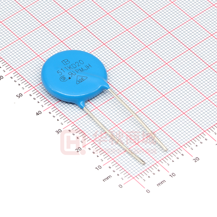

511KD20-P10
511KD20-P10
    BRIGHTKING(君耀)
    VAR_D23X6.2MM_TM
    压敏电阻电压= 510V VC=845V DIP
511KD20-P10 数据手册
20Φ SERIES Metal Oxide Varistor (MOV) Data Sheet Features ■ ■ ■ ■ ■ ■ ■ ■ Wide operating voltage (V1mA) range from 18V to 1800V Fast responding to transient over-voltage Large absorbing transient energy capability Low clamping ratio and no follow-on current Meets MSL level 1, per J-STD-020 Operating Temperature:-40℃ ~ +85℃ Storage Temperature:-40℃ ~ +125℃ Safety certification: UL: E327997 CSA: 246579 VDE: 40027827 Applications ■ ■ ■ ■ ■ Transistor, diode, IC, thyristor or triac semiconductor protection Surge protection in consumer electronics Surge protection in industrial electronics Surge protection in electronic home appliances, gas and petroleum appliances Relay and electromagnetic valve surge absorption Part Number Code Revision:30-Jun-16 1 / 12 www.brightking.com 20Φ SERIES Dimensions Table 1 Table 2 Unit: mm Unit: mm Symbol Dimension Model T e Model T e H 21.0~26.0 180K 2.1~4.3 1.7 361K 3.0~5.4 2.9 H1 24.0~28.0 220K 2.2~4.4 1.8 391K 3.1~5.5 3.0 L(min.) 20.0 270K 2.2~4.6 2.0 431K 3.3~5.7 3.2 L1(min.) 15.0 330K 2.3~4.8 1.9 471K 3.4~6.0 3.4 D 20.0~23.0 390K 2.2~4.5 2.0 511K 3.5~6.2 3.6 F 7.5±0.8/10.0±1.0 470K 2.3~4.7 2.1 561K 3.7~6.5 3.8 T Table 2 560K 2.4~5.0 2.3 621K 3.9~6.8 4.1 e(±0.8) Table 2 680K 2.5~5.3 2.6 681K 4.1~7.1 4.4 d(±0.05) 0.8/1.0 820K 2.2~4.5 2.0 751K 4.4~7.5 4.5 d1(±0.4) 1.4/1.6 101K 2.5~4.6 2.2 781K 4.5~7.7 4.6 121K 2.5~4.8 2.4 821K 4.7~7.9 4.8 151K 2.3~4.5 2.0 911K 4.9~8.1 5.2 181K 2.4~4.6 2.1 102K 5.5~8.6 5.2 201K 2.5~4.7 2.2 112K 5.9~9.1 5.6 221K 2.6~4.8 2.3 122K 6.0~9.7 6.0 241K 2.7~4.9 2.4 142K 7.0~11.2 6.8 271K 2.7~5.0 2.6 162K 7.5~11.8 7.6 301K 2.8~5.0 2.7 182K 7.7~12.8 8.4 331K 2.8~5.2 2.7 Revision:30-Jun-16 2 / 12 www.brightking.com 20Φ SERIES Electrical Characteristics Maximum Part Allowable Number Standard High Surge Voltage VAC(V) VDC(V) Varistor Voltage V1mA(V) Maximum Withstanding Maximum Clamping Surge Energy Voltage Current (10/1000μs) IP(A) VC(V) I (A) Standard I (A) High Surge (J) Standard Rated Power Typical Capacitance (Reference) (J) High (W) @1KHz (pf) Surge 180KD20 180KD20J 11 14 18(15~21.6) 20 36 2000 3000 11 13 0.2 28500 220KD20 220KD20J 14 18 22(19.5~26) 20 43 2000 3000 14 16 0.2 18500 270KD20 270KD20J 17 22 27(24~31) 20 53 2000 3000 16 19 0.2 13000 330KD20 330KD20J 20 26 33(29.5~36.5) 20 65 2000 3000 23 24 0.2 11500 390KD20 390KD20J 25 31 39(35~43) 20 77 2000 3000 26 28 0.2 8500 470KD20 470KD20J 30 38 47(42~52) 20 93 2000 3000 30 34 0.2 7400 560KD20 560KD20J 35 45 56(50~62) 20 110 2000 3000 41 41 0.2 6500 680KD20 680KD20J 40 56 68(61~75) 20 135 2000 3000 46 49 0.2 5800 820KD20 820KD20J 50 65 82(74~90) 100 135 6500 10000 38 56 1.0 4900 101KD20 101KD20J 60 85 100(90~110) 100 165 6500 10000 45 70 1.0 4000 121KD20 121KD20J 75 100 120(108~132) 100 200 6500 10000 55 85 1.0 3300 151KD20 151KD20J 95 125 150(135~165) 100 250 6500 10000 70 106 1.0 2700 181KD20 181KD20J 115 150 180(162~198) 100 300 6500 10000 85 130 1.0 2200 201KD20 201KD20J 130 170 200(180~220) 100 340 6500 10000 95 140 1.0 2000 221KD20 221KD20J 140 180 220(198~242) 100 360 6500 10000 100 155 1.0 1800 241KD20 241KD20J 150 200 240(216~264) 100 395 6500 10000 108 168 1.0 1650 271KD20 271KD20J 175 225 270(243~297) 100 455 6500 10000 127 190 1.0 1500 301KD20 301KD20J 190 250 300(270~330) 100 500 6500 10000 136 210 1.0 1300 331KD20 331KD20J 210 275 330(297~363) 100 550 6500 10000 150 228 1.0 1200 361KD20 361KD20J 230 300 360(324~396) 100 595 6500 10000 163 255 1.0 1100 391KD20 391KD20J 250 320 390(351~429) 100 650 6500 10000 180 275 1.0 1000 431KD20 431KD20J 275 350 430(387~473) 100 710 6500 10000 190 305 1.0 930 471KD20 471KD20J 300 385 470(423~517) 100 775 6500 10000 220 350 1.0 850 511KD20 511KD20J 320 415 510(459~561) 100 845 6500 10000 220 360 1.0 780 561KD20 561KD20J 350 460 560(504~616) 100 925 6500 10000 220 380 1.0 710 621KD20 621KD20J 385 505 620(558~682) 100 1025 6500 10000 220 390 1.0 650 681KD20 681KD20J 420 560 680(612~748) 100 1120 6500 10000 230 400 1.0 600 751KD20 751KD20J 460 615 750(675~825) 100 1240 6500 10000 255 420 1.0 530 781KD20 781KD20J 485 640 780(702~858) 100 1290 6500 10000 265 440 1.0 510 821KD20 821KD20J 510 670 820(738~902) 100 1355 6500 10000 282 460 1.0 500 911KD20 911KD20J 550 745 910(819~1001) 100 1500 6500 10000 310 510 1.0 440 102KD20 102KD20J 625 825 1000(900~1100) 100 1650 6500 10000 342 565 1.0 400 112KD20 112KD20J 680 895 1100(990~1210) 100 1815 6500 10000 383 620 1.0 360 122KD20 122KD20J 750 990 1200(1080~1320) 100 1980 6500 10000 408 660 1.0 350 142KD20 142KD20J 880 1140 1400(1260~1540) 100 2310 6500 10000 532 784 1.0 340 162KD20 162KD20J 1000 1280 1600(1440~1760) 100 2640 6500 10000 606 896 1.0 330 182KD20 182KD20J 1100 1465 1800(1620~1980) 100 2970 6500 10000 625 990 1.0 320 Notes: 1. The tolerance of varistor voltage between 18V and 27V is more than 10%. 2. Varistor voltage≥1200V, structure diagram is F type. 3. Leakage Current (@83% of V1mA):IR≤50μA (180K~680K) ; IR≤25μA (820K~182K) Revision:30-Jun-16 3 / 12 www.brightking.com 20Φ SERIES Electrical Ratings Items Varistor Voltage Maximum Allowable Voltage Test Condition/Description Requirement The voltage between two terminals with the specified measuring current 1mA.DC applied is called Vb. The recommended maximum sine wave voltage (RMS) or the Maximum DC voltage can be applied continuously. The maximum voltage between two terminals with the specification standard impulse current. Applied waveform: 8/20μs Maximum Clamping Voltage To meet the Specified value Rated Wattage The maximum average power that can be applied within the specified ambient temperature. Energy The maximum energy within the varistor voltage change of ±10% when one impulse of 10/1000μs or 2ms is applied. Withstanding Surge Current The maximum current within the varistor voltage change of ±10% with the standard impulse current (8/20μs) applied one time. Varistor Voltage Temp. Coefficient ≤0.05%/℃ The change of Vb shall be measured after the impulse listed below which is applied 10,000 times continuously with the interval of ten seconds at room temperature. Surge Life 20Φ series Revision:30-Jun-16 180K to 680K 100A (8/20μs) 820K to 182K 200A (8/20μs) 4 / 12 ∆Vb ≤ ±10% Vb www.brightking.com 20Φ SERIES Soldering Recommendation Wave Lead Free Soldering Recommendation 300 Preheating Maximum Wave 265℃ Soldering Cooling 250 200 150 100 50 0 0 0.5 1 1.5 2 2.5 3 3.5 4 Time (minutes) Item Conditions Peak Temperature 265℃ Dipping Time 10 seconds (max.) Soldering 1 time Recommendation Reworking Conditions with Soldering Iron Revision:30-Jun-16 Item Conditions Temperature of Soldering Iron-tip 360℃ (max.) Soldering Time 3 seconds (max.) Distance from Varistor 2mm (min.) 5 / 12 www.brightking.com 20Φ SERIES Mechanical Characteristics Items Test conditions / Methods Specifications Gradually applying the force specified and keeping the unit fixed for 10±1 sec. Tensile Strength of Terminals Bending Strength of Terminals Vibration No visible damage |∆V1mA/V1mA |≤5% Hold specimen and apply the force specified below to each lead. Bend the specimen to 90°, then return to the original position. Repeat the procedure in the opposite direction. Frequency range: 10~55 Hz Amplitude: 0.75mm or 98m/s2 Direction: 3 mutually perpendicular directions, 2hrs each. No visible damage |∆V1mA/V1mA |≤5% No visible damage |∆V1mA/V1mA |≤5% Solder ability Solder Temp: 245±5℃ Dipping Time: 2±0.5 sec At least 95% of terminal electrode is covered by new solder Resistance to Soldering Heat Solder Temp: 260±5℃ Dipping Time: 10±1 sec No visible damage |∆V1mA/V1mA |≤10% Reliability Items Test conditions / Methods Specifications High Temperature Storage Ambient Temp: 125±2℃ Duration: 1000hrs |∆V1mA/V1mA |≤5% Low Temperature Storage Ambient Temp: -40±2℃ Duration: 1000hrs |∆V1mA/V1mA |≤5% Ambient Temp: 40±2℃, 90~95% R.H. Duration: 1000hrs |∆V1mA/V1mA |≤5% Humidity The conditions shown below shall be repeated 5 cycles Temperature Cycle Step Temperature (℃) Period (minutes) 1 -40±3 30±3 2 Room temperature 15±3 3 125±3 30±3 4 Room temperature 15±3 No visible damage |∆V1mA/V1mA |≤5% High Temperature Load Ambient Temp: 85±2℃ Duration: 1000hrs Load: Max. Allowable Voltage In AC eara. |∆V1mA/V1mA|≤10% Damp Heat Load Ambient Temp: 40±2℃, 90~95% R.H. Duration: 1000hrs Load: Max. Allowable Voltage No visible damage |∆V1mA/V1mA |≤10% Metal balls method, 2500Vac 1 min. No visible damage Voltage Proof Revision:30-Jun-16 6 / 12 www.brightking.com 20Φ SERIES Maximum Surge Current Derating Curve 820KD20 to 751KD20 180KD20 to 680KD20 10000 10000 1 1000 100 10 1000 2 10 102 103 104 105 104 100 105 106 10 10 1 1 100 1000 10000 Td (μs) Revision:30-Jun-16 102 103 106 0.1 10 1 2 0.1 10 100 1000 10000 Td (μs) 7 / 12 www.brightking.com 20Φ SERIES Maximum Leakage Current and Maximum Clamping Voltage Curve 180KD20 to 680KD20 1000 Maximum Clamping Voltage 680KD20 560KD20 470KD20 390KD20 330KD20 270KD20 220KD20 180KD20 Maximum Leakage Current Voltage (V) 100 10 1 10-6 -5 10 -4 10 -3 10 -2 10 -1 10 1 10 2 10 3 10 4 10 5 10 Current (A) 820KD20 to 471KD20 10000 Maximum Clamping Voltage 471KD20 431KD20 391KD20 361KD20 331KD20 301KD20 271KD20 241KD20 221KD20 201KD20 181KD20 151KD20 121KD20 101KD20 820KD20 Maximum Leakage Current Voltage (V) 1000 100 10 10-6 10-5 10-4 10-3 10-2 10-1 1 10 102 103 104 105 Current (A) Revision:30-Jun-16 8 / 12 www.brightking.com 20Φ SERIES Maximum Leakage Current and Maximum Clamping Voltage Curve 511KD20 to 182KD20 10000 182KD20 162KD20 142KD20 122KD20 112KD20 102KD20 911KD20 821KD20 781KD20 751KD20 681KD20 621KD20 561KD20 511KD20 Maximum Clamping Voltage Voltage (V) Maximum Leakage Current 1000 100 -6 10 -5 10 -4 10 -3 10 -2 10 -1 10 1 10 2 10 3 10 4 10 5 10 Current (A) 180KD20J to 680KD20J 1000 Maximum Clamping Voltage 680KD20J 560KD20J 470KD20J 390KD20J 330KD20J 270KD20J 220KD20J 180KD20J Maximum Leakage Current Voltage (V) 100 10 1 10-6 10-5 10-4 10-3 10-2 10-1 1 10 102 103 104 105 Current (A) Revision:30-Jun-16 9 / 12 www.brightking.com 20Φ SERIES Maximum Leakage Current and Maximum Clamping Voltage Curve 820KD20J to 751KD20J 10000 Maximum Clamping Voltage 751KD20J 681KD20J 621KD20J 561KD20J 511KD20J 471KD20J 431KD20J 391KD20J 361KD20J 331KD20J 301KD20J 271KD20J 241KD20J 221KD20J 201KD20J 181KD20J 151KD20J 121KD20J 101KD20J 820KD20J Maximum Leakage Current Voltage (V) 1000 100 10 10-6 -5 10 -4 10 -3 10 -2 -1 10 10 1 10 2 3 10 4 10 5 10 10 Current (A) 781KD20J to 182KD20J 10000 Maximum Clamping Voltage 182KD20J 162KD20J 142KD20J 122KD20J 112KD20J 102KD20J 911KD20J 821KD20J 781KD20J Voltage (V) Maximum Leakage Current 1000 100 10-6 -5 10 -4 10 -3 10 -2 10 -1 10 1 10 2 10 3 10 4 10 5 10 Current (A) Revision:30-Jun-16 10 / 12 www.brightking.com 20Φ SERIES Marking Code ① Brightking Logo ② Varistor Voltage ③ UL Accreditation Logo ① XXXKDXXX ② ③ ④ ⑤ XXX H Y VDE X ④ CSA Accreditation Logo ⑥ ⑦ ⑤ VDE Accreditation Logo ⑥“J”is High Surge Code, no“J”is Standard Surge ⑧ ⑨ ⑦ Disk Size ⑧“H”is Halogen Free Code, no“H”is Halogen ⑩ ⑨ Date Code ⑩ Product Line Code (“Y”may be A thru Z or blank) W0 W Taping Dimensions Revision:30-Jun-16 11 / 12 Symbol Dimensions (mm) P 25.4±1.0 P0 12.7±1.0 P1 8.95/7.7±0.7 P2 12.7±1.3 F 7.5±0.8/10.0±1.0 h 0±4 W 18.0±1.0 W0 12.0±1.0 W1 9.0±0.5 W2 3.0max H 20.0±2.0 I 1.0max D0 4.0±0.2 t 0.6±0.3 B 45max www.brightking.com 20Φ SERIES Quantity Packaging Dimensions (Unit: mm) Quantity Bulk 250pcs/bag 2bags/box (180K~301K) 200pcs/bag 2bags/box (331K~561K) 150pcs/bag 2bags/box (621K~112K) 100pcs/bag 2bags/box (122K~182K) Tape & Box 400pcs/box (180K~301K) 300pcs/box (331K~561K) Tape & Reel 400pcs/box (180K~301K) 300pcs/box (331K~561K) Revision:30-Jun-16 12 / 12 www.brightking.com
