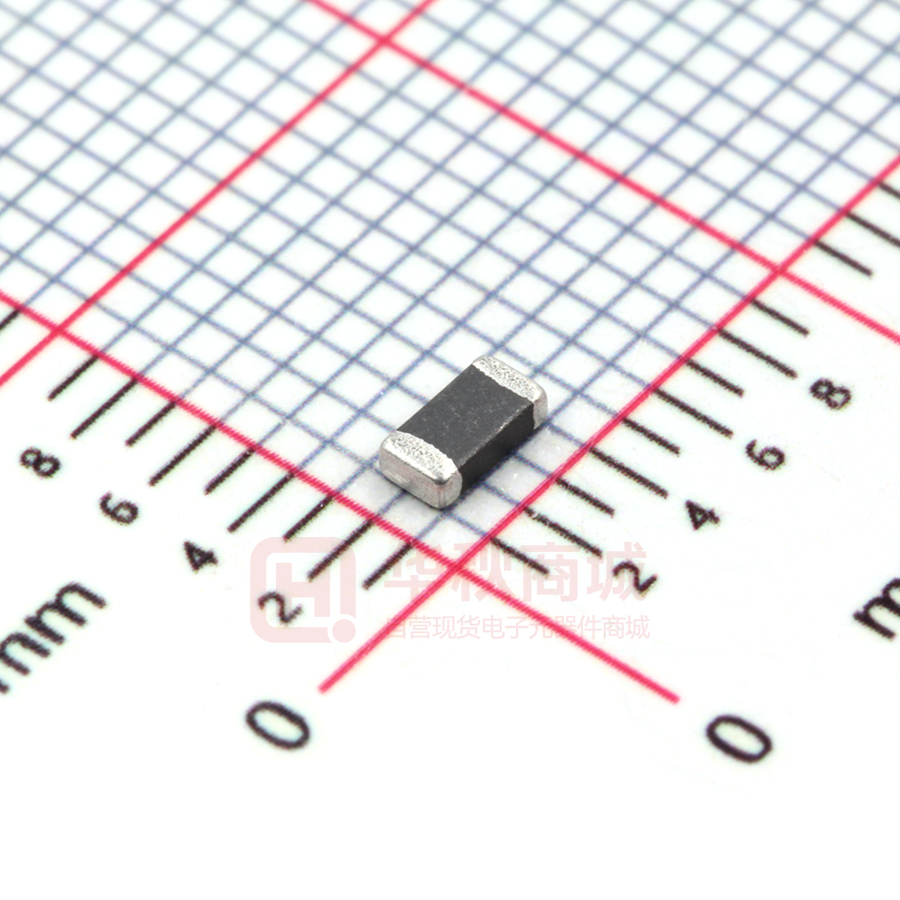

FERRITE CHIP BEADS
1005 :-40 85
1608
:-40 +85
2012
OPEARATING TEMP.
FEATURES
PCB
EIA
Under the same size
EMI RFI
SMT
the multilayer chip beads produce higher impedance than plug-in beads.
These CBG series have substantial EMI.RFI suppression by simply mounting them onto PCB
Suitable EIA standard in shape and dimension of chip beads; Can be mounted automatically by SMT equipments.
APPLICATIONS
Redialed noise suppression on digital product clock lines
signal lines and suppression noise on circuit.
