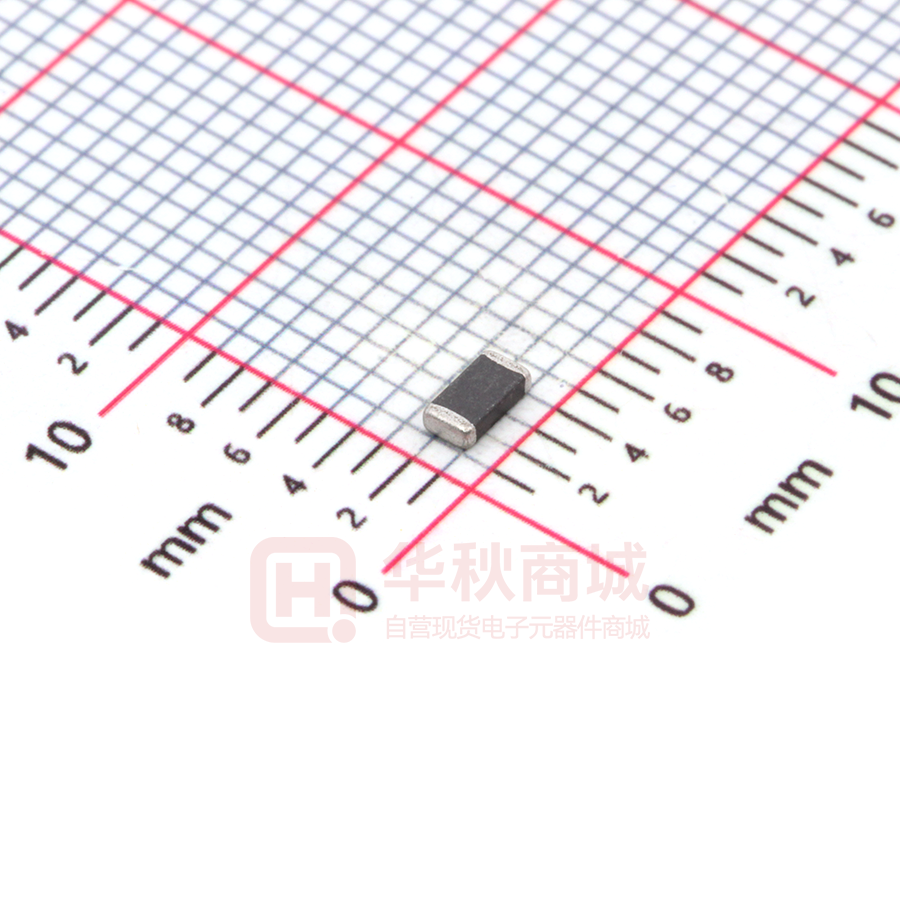

    贴片磁珠 1210 200Ω@100MHz ±25% 400mA 200mΩ
CBG322513U201T 数据手册
FERRITE CHIP BEADS FERRITE CHIP BEADS 1005 :-40 85 1608 :-40 +85 2012 OPEARATING TEMP. FEATURES PCB EIA Under the same size EMI RFI SMT the multilayer chip beads produce higher impedance than plug-in beads. These CBG series have substantial EMI.RFI suppression by simply mounting them onto PCB Suitable EIA standard in shape and dimension of chip beads; Can be mounted automatically by SMT equipments. APPLICATIONS Redialed noise suppression on digital product clock lines signal lines and suppression noise on circuit. ORDERING CODE U 201209 CBG T 121 (L Product Code W T) ( (mm) Material Code ) Packaging Style Impedance Dimensions U CBG 100505 160808 201209 321609 322513 451616 453215 Multilayer ordinary chip beads Example 110 121 221 102 1.0 0.5 0.5 1.6 0.8 0.8 2.0 1.2 0.9 3.2 1.6 0.9 3.2 2.5 1.3 4.5 1.6 1.6 4.5 3.2 1.5 T 11 120 220 1000 B Tape & Reel Bulk unit mm(inch) Part No. 100505 (0402) L W T D W L 1.0 (0.040 160808 1.6 (0603) (0.063 201209 2.0 (0805) (0.079 321609 3.2 (1206) (0.126 322513 3.2 (1210) (0.126 451616 4.5 (1806) (0.186 453215 4.5 (1812) (0.180 0.5 0.15 (0.020 0.006) 0.8 0.2 (0.031 0.008) 1.2 0.2 (0.047 0.008) 1.6 0.2 (0.063 0.008) 2.5 0.2 (0.098 0.008) 1.6 0.2 (0.063 0.008) 3.2 0.2 (0.126 0.008) 1 T 0.15 0.006) 0.2 0.008) 0.2 0.008) 0.2 0.008) 0.2 0.008) 0.2 0.008) 0.2 0.008) 0.5 (0.020 0.8 (0.031 0.9 (0.035 0.9 (0.035 1.3 (0.051 1.6 (0.063 1.5 (0.060 D 0.15 0.006) 0.2 0.008) 0.2 0.008) 0.2 0.008) 0.2 0.008) 0.2 0.008) 0.2 0.008) 0.25 (0.010 0.3 (0.01 0.5 (0.020 0.5 (0.020 0.5 (0.020 0.5 (0.020 0.5 (0.020 0.10 0.004) 0.2 0.008) 0.3 0.012) 0.3 0.012) 0.3 0.012) 0.3 0.012) 0.3 0.012) ELECTRICAL CHARACTERISTICS 1005 TYPE Part No. Impedance( ) At 100MHz CBG100505U070 0~11 0.10 300 CBG100505U190 12~25 0.10 300 CBG100505U260 26 25% 0.15 300 CBG100505U310 31 25% 0.20 300 CBG100505U360 36 25% 0.20 300 CBG100505U600 60 25% 0.35 200 CBG100505U101 100 25% 0.50 150 CBG100505U121 120 25% 0.50 150 CBG100505U151 150 25% 0.55 150 CBG100505U201 200 25% 0.60 100 CBG100505U301 300 25% 0.80 100 CBG100505U501 500 25% 1.1 100 CBG100505U601 600 25% 1.3 100 CBG100505U801 800 25% 1.4 50 DCR ( )Max Ir (mA)Max 1608 TYPE Part No. Impedance( ) At 100MHz DCR ( )Max Ir (mA)Max CBG160808U070 0~11 0.10 800 CBG160808U150 9~21 0.10 800 CBG160808U310 31 25% 0.10 500 CBG160808U700 70 25% 0.20 300 CBG160808U800 80 25% 0.20 300 CBG160808U101 100 25% 0.30 200 CBG160808U121 120 25% 0.30 200 CBG160808U151 150 25% 0.35 200 CBG160808U181 180 25% 0.45 200 CBG160808U221 220 25% 0.45 200 CBG160808U301 300 25% 0.50 150 CBG160808U501 500 25% 0.60 150 CBG160808U601 600 25% 0.60 100 CBG160808U801 800 25% 0.70 100 CBG160808U102 1000 25% 0.80 100 CBG160808U122 1200 25% 0.85 100 CBG160808U152 1500 25% 0.85 50 CBG160808U182 1800 25% 1.10 50 CBG160808U202 2000 25% 1.10 50 2 FERRITE CHIP BEADS 2012 TYPE Part No. Impedance( ) At 100MHz DCR ( )Max Ir (mA)Max CBG201209U050 0~15 0.08 900 CBG201209U110 7~15 0.10 900 CBG201209U260 26 25% 0.10 900 CBG201209U310 31 25% 0.10 900 CBG201209U500 50 25% 0.15 900 CBG201209U600 60 25% 0.15 900 CBG201209U800 80 25% 0.18 500 CBG201209U101 100 25% 0.18 400 CBG201209U121 120 25% 0.20 400 CBG201209U151 150 25% 0.20 400 CBG201209U181 180 25% 0.20 300 CBG201209U221 220 25% 0.20 300 CBG201209U301 300 25% 0.35 300 CBG201209U501 500 25% 0.40 300 CBG201209U601 600 25% 0.40 300 CBG201209U801 800 25% 0.45 200 CBG201209U102 1000 25% 0.45 200 CBG201209U122 1200 25% 0.60 100 CBG201209U152 1500 25% 0.70 100 CBG201209U202 2000 25% 0.90 50 3216 TYPE Part No. Impedance( ) At 100MHz DCR ( )Max Ir (mA)Max CBG321609U050 0~15 0.10 1000 CBG321609U110 7~15 0.10 1000 CBG321609U260 26 25% 0.10 1000 CBG321609U310 31 25% 0.10 1000 CBG321609U600 60 25% 0.15 1000 CBG321609U800 80 25% 0.15 1000 CBG321609U121 120 25% 0.25 1000 CBG321609U151 150 25% 0.30 400 CBG321609U181 180 25% 0.30 400 CBG321609U221 220 25% 0.35 400 CBG321609U301 300 25% 0.40 400 CBG321609U501 500 25% 0.45 300 CBG321609U601 600 25% 0.45 300 CBG321609U801 800 25% 0.55 300 CBG321609U102 1000 25% 0.55 300 CBG321609U122 1200 25% 0.60 100 3 3225 TYPE Part No. CBG322513U190 Impedance( ) At 100MHz DCR ( 12~25 )Max Ir (mA)Max 0.10 1000 CBG322513U260 26 25% 0.10 1000 CBG322513U310 31 25% 0.10 1000 CBG322513U600 60 25% 0.15 1000 CBG322513U800 80 25% 0.20 400 CBG322513U101 100 25% 0.20 400 CBG322513U121 120 25% 0.20 400 CBG322513U151 150 25% 0.30 400 CBG322513U181 180 25% 0.40 400 CBG322513U221 220 25% 0.40 400 CBG322513U301 300 25% 0.40 400 CBG322515U501 500 25% 0.40 300 CBG322513U601 600 25% 0.40 300 CBG322513U801 800 25% 0.40 300 CBG322513U102 1000 0.40 300 25% 4516 TYPE Part No. CBG451616U190 Impedance( ) At 100MHz DCR ( 12~25 )Max Ir (mA)Max 0.10 1000 CBG451616U260 26 25% 0.10 1000 CBG451616U310 31 25% 0.15 1000 CBG451616U600 60 25% 0.20 1000 CBG451616U700 70 25% 0.25 1000 CBG451616U800 80 25% 0.30 1000 CBG451616U900 90 25% 0.35 1000 CBG451616U121 120 25% 0.40 500 CBG451616U151 150 25% 0.40 500 CBG451616U221 220 25% 0.45 500 CBG451616U301 300 25% 0.45 500 CBG451616U501 500 25% 0.50 200 CBG451616U601 600 25% 0.50 200 CBG451616U801 800 25% 0.55 200 4532 TYPE Part No. CBG453215U190 Impedance( ) At 100MHz DCR ( )Max Ir (mA)Max 0.10 1000 CBG453215U380 38 25% 0.15 1000 CBG453215U700 70 25% 0.20 1000 CBG453215U800 80 25% 0.20 1000 CBG453215U101 100 25% 0.20 500 CBG453215U121 120 25% 0.25 500 CBG453215U151 150 25% 0.25 500 CBG453215U221 220 25% 0.30 300 CBG453215U301 300 25% 0.30 300 CBG453215U601 600 25% 0.40 200 CBG453215U801 800 25% 0.45 200 CBG453215U102 1000 0.50 200 12~25 25% 4 FERRITE CHIP BEADS FERRITE CHIP BEADS 1005 SERIES 100 200 150 100 Z R Z 50 R 10 100 Frequency[M Hz] 1000 CBG100505U151T X 10 100 Frequency[M Hz] 400 300 Z 200 R 1 300 R 200 X 10 100 Frequency[M Hz] 1000 1 10 100 Frequency[M Hz] 2000 1600 1600 1200 800 R 400 0 1 10 100 Frequency[M Hz] 1000 1200 800 400 R X 0 1 10 100 Frequency[M Hz] 1000 CBG100505U801T 2000 X 0 R 100 CBG100505U601T Z 100 X Z 200 X 1000 Impedance Impedance[Ù] 400 300 0 CBG100505U201T 500 Impedance Impedance[Ù] Impedance Impedance[Ù] R 100 0 1 500 100 Z 150 50 0 1 200 X X 0 400 Impedance Impedance[Ù] 150 250 Impedance 200 500 Impedance Impedance[Ù] 250 CBG100505U121T 300 Impedance[Ù] 250 50 CBG100505U101T CBG100505U600T 300 Impedance Impedance[Ù] Impedance Impedance[Ù] CBG100505U310T 300 0 1000 1 10 100 Frequency[M Hz] 1000 1 10 100 Frequency[M Hz] 1000 1680 SERIES CBG160808U310T CBG160808U150T 40 40 80 30 20 Z R Z 20 R X 10 60 Z 40 20 1000 1 10 100 Frequency[MHz] CBG160808U800T Z 100 R 50 Impedance Impedance[Ù] Impedance Impedance[Ù] Impedance Impedance[Ù] 250 150 200 Z 150 R 100 X 0 0 10 0 0 400 400 300 Z 200 10 100 Fre q ue n cy[M Hz] 10 0 0 19 10 100 Fre q ue n cy[M Hz] 10 0 0 CBG160808U151T 500 R 300 Z R 200 X 100 X 0 1 1 10 0 0 500 100 50 X 10 100 Fre q ue n cy[M Hz] CBG160808U121T 300 10 100 Fre q ue n cy[M Hz] 0 1 1000 CBG160808U101T 200 1 R 50 X 0 0 10 100 Frequency[MHz] Z 100 X 0 1 150 R X Impedance Impedance[Ù] 10 30 CBG160808U700T 200 Impedance Impedance[Ù] 100 Impedance[Ù] Impedance 50 Impedance[Ù] Impedance Impedance Impedance[Ù] CBG160808U070T 50 0 1 10 100 Fre q ue n cy[M Hz] 10 0 0 1 10 100 Fre q ue n cy[M Hz] 10 0 0 FERRITE CHIP BEADS CBG160808U301T 600 400 Z R 200 X 8 00 Z 400 R 200 Z 6 00 4 00 R 2 00 0 1 10 100 Fre q ue n cy[M Hz] 1 10 100 Fre q ue n cy[M Hz] CBG160808U801T 1 10 1 00 Fre q ue n cy[M Hz] 1 CBG160808U122T X CBG160808U152T 6 00 3 00 X 0 10 0 0 2000 1500 Z 1000 R 10 1 00 Fre q ue n cy[M Hz] CBG160808U182T R 800 X X R 1 Z 1200 400 500 0 10 1 00 Fre q ue n cy[M Hz] 1600 Impedance Impedance[Ù] Impedance Impedance[Ù] Impedance[Ù] Impedance Impedance Impedance[Ù] 6 00 9 00 R 0 0 10 0 0 1 10 100 Frequency[M Hz] 1000 1 10 100 Frequency[M Hz] 1000 CBG160808U202T 2000 2500 Z 2000 Impedance Impedance[Ù] 1600 Impedance Impedance[Ù] 10 0 0 2000 2500 1 10 1 00 Fre q ue n cy[M Hz] Z 9 00 3 00 R 10 0 0 3000 1 2 00 Z 3 00 0 10 0 0 CBG160808U102T 1 2 00 6 00 X 0 10 0 0 Z 9 00 X X 0 CBG160808U601T 1 2 00 Impedance[Ù] Impedance 600 CBG160808U501T 1 0 00 Impedance Impedance[Ù] 800 Impedance[Ù] Impedance Impedance Impedance[Ù] CBG160808U221T 800 1200 R 800 400 Z 1500 1000 R 500 X X 0 0 1 10 100 Frequency[M Hz] 1000 1 10 100 Frequency[M Hz] 1000 2012 SERIES CBG201209U260T CBG201209U110T 40 40 80 30 20 Z R 10 30 20 Z R Z 10 0 0 R 10 1 00 Fre q u en cy[MHz] 100 Z R 50 X 0 0 1 150 X 0 10 1 00 Fre q u en cy[MHz] 40 20 10 X 1 60 X 0 CBG201209U310T 200 Impedance Impedance[Ù] 100 Impedance Impedance[Ù] 50 Impedance Impedance[Ù] Impedance Impedance[Ù] CBG201209U050T 50 10 0 0 20 1 10 100 Frequency[M Hz] 1000 1 10 100 Fre q ue n cy[M Hz] 10 0 0 FERRITE CHIP BEADS FERRITE CHIP BEADS CBG201209U600T 150 150 Z R 50 100 Z R 50 0 10 0 0 1 10 100 Fre q ue n cy[M Hz] CBG201209U151T 1 400 400 300 Z R 300 Z 200 R 100 X Impedance Impedance[Ù] 400 Impedance Impedance[Ù] 500 10 100 Frequency[M Hz] R 200 X 1 10 100 Fre q ue n cy[M Hz] Z 4 00 4 00 R 2 00 0 9 00 10 0 0 Z 3 00 CBG201209U122T 10 1 00 Fre q ue n cy[M Hz] 1 10 0 0 3000 116600 00 2500 9 00 112200 00 6 00 R 3 00 Impedance Impedance[Ù] Z ZZ 8800 00 RR 4400 00 10 1 00 Fre q ue n cy[M Hz] 1500 1000 R 500 X 00 1 10 1 00 Fre q ue n cy[M Hz] 10 0 0 Z 2000 X 0 10 0 0 XX 11 1100 1100 00 Fre Freqque uenncy[M cy[MHz] Hz] 10 100 Frequency[M Hz] 0 10 100000 21 1000 Z 9 00 6 00 3 00 X CBG201209U202T 220000 00 Impedance Impedance[Ù] Impedance[Ù] 1 2 00 1 R 0 CBG201209U152T CBG201209U152T 1 5 00 X R X 0 1 R 200 CBG201209U102T 6 00 0 10 1 00 Fre q ue n cy[M Hz] Z 400 1 2 00 X R 600 CBG201209U801T 6 00 2 00 10 0 0 1 2 00 Z 10 0 0 0 10 0 0 Impedance Impedance[Ù] 8 00 Impedance[Ù] Impedance 8 00 10 100 Fre q ue n cy[M Hz] CBG201209U301T Z CBG201209U601T 1 0 00 1 0 10 100 Fre q ue n cy[M Hz] CBG201209U501T 1 0 00 1 X 800 100 X 1 1000 X R 100 10 0 0 300 0 0 6 00 Z CBG201209U221T 500 1 10 100 Fre q ue n cy[M Hz] CBG201209U181T 500 100 200 0 10 0 0 Impedance Impedance[Ù] 10 100 Fre q ue n cy[M Hz] 200 X 50 0 1 Impedance Impedance[Ù] R X 0 Impedance Impedance[Ù] Z 100 Impedance Impedance[Ù] 100 CBG201209U121T 300 Impedance Impedance[Ù] 150 Impedance[Ù] Impedance 200 X Impedance Impedance[Ù] CBG201209U800T 200 Impedance Impedance[Ù] Impedance Impedance[Ù] CBG201209U500T 200 1 10 100 Frequency[M Hz] 1000 1 10 1 00 Fre q ue n cy[M Hz] 10 0 0 FERRITE CHIP BEADS 3216SERIES CBG321609U122T CBG321609U102T CBG322513U260T CBG322513U190T 3000 1 5 00 200 80 2500 6 00 1500 Z 1000 500 3 00 X X R 10 1 00 Fre q ue n cy[M Hz] 10 100 Fequency (MHz) CBG321609U310T 1000 80 160 60 Z R 40 X 20 0 120 Z 80 10 0 0 R 1 10 0 0 150 Z 100 R 50 200 Z R 100 X 0 10 100 Fre q ue n cy[M Hz] 10 0 0 1 CBG321609U181T CBG321609U151T 300 1000 X 1 10 0 0 10 100 Fequency (MHz) CBG321609U101T 0 10 100 Fre q ue n cy[M Hz] CBG321609U121T 300 10 1 00 Fre q u en cy[MHz] 300 X 1 X R CBG321609U800T 0 10 100 Fre q ue n cy[M Hz] Z 50 200 40 100 0 1 CBG321609U600T 200 Impedance Impedance[Ù] Impedance Impedance[Ù] R 20 0 1 10 0 0 100 1 Z 150 X Impedance Impedance[Ù] 1 40 R 0 0 60 Impedance Impedance[ Impedance ] 9 00 2000 Impedance Impedance[Ù] Z Impedance Impedance[Ù] Impedance ] Impedance[ Impedance[Ù] Impedance 1 2 00 10 100 Fre q ue n cy[M Hz] 10 0 0 CBG321609U221T 500 500 400 400 R 100 200 R 100 0 10 100 Fre q ue n cy[M Hz] 10 0 0 10 100 Fre q ue n cy[M Hz] Z 10 100 Frequency[M Hz] R 1 1000 400 R 200 0 0 ] 600 Z 400 10 0 0 10 100 Frequency[M Hz] Z 500 R X X R 0 0 1 750 250 200 X 1000 22 10 0 0 1000 Impedance[ Impedance R Z 10 100 Fre q ue n cy[M Hz] CBG321609U801T CBG321609U601T 800 600 100 10 100 Fre q ue n cy[M Hz] 200 0 1 Impedance Impedance[Ù] 300 1 Z 300 100 X 800 Impedance[Ù] Impedance Impedance Impedance[Ù] 10 0 0 1000 X R CBG321609U501T CBG321609U301T 200 200 0 1 500 400 Z X 0 1 300 100 X X Impedance Impedance[Ù] 200 Impedance Impedance[Ù] Impedance[Ù] Impedance Impedance Impedance[Ù] Z Z 1 10 100 Fre q ue n cy[M Hz] 10 0 0 1 10 100 Fequency (MHz) 1000 FERRITE CHIP BEADS FERRITE CHIP BEADS CBG321609U122T CBG321609U102T CBG322513U260T CBG322513U190T 3000 1 5 00 200 80 2500 1500 Z 1000 500 10 1 00 Fre q ue n cy[M Hz] CBG322513U310T Impedance Impedance[Ù] 250 200 150 100 Z 200 200 150 Z R R CBG322513U151T 10 100 Fre q ue n cy[M Hz] Impedance[Ù] Impedance 100 R R 0 10 0 0 CBG322513U801T 10 100 Fre q ue n cy[M Hz] 10 0 0 CBG322513U102T 1500 1500 1200 1200 Z ] ] Z Impedance Impedance[ 900 600 300 900 600 300 R R X 0 X 0 1 10 100 Fequency (MHz) 1000 1 10 100 Fequency (MHz) 1000 23 R X 1 10 0 0 1500 400 1200 300 Z 200 10 100 Fre q ue n cy[M Hz] 10 0 0 CBG322513U601T 500 R Z 900 600 300 X 0 1 100 X 0 10 100 Fre q ue n cy[M Hz] Z 0 10 100 Fre q ue n cy[M Hz] 100 X 1000 X ] Z 100 200 CBG322513U221T 200 X 1 R 1 300 Z 100 10 0 0 CBG322513U181T 300 200 Z 0 1 1000 10 100 Fequency (MHz) CBG322513U121T 150 X 0 10 100 Frequency[M Hz] 1 10 0 0 300 50 X 0 1 10 1 00 Fre q u en cy[MHz] CBG322513U800T 250 50 50 Impedance Impedance[ 1 250 100 X R 0 1000 Impedance Impedance[ Impedance Impedance[Ù] 10 100 Fequency (MHz) CBG322513U600T 300 Z 50 0 1 10 0 0 Impedance[Ù] Impedance 1 100 X 0 0 Impedance Impedance[Ù] R X R R 20 150 ] X Z Impedance Impedance[Ù] 3 00 40 Impedance Impedance[ 6 00 Impedance Impedance[Ù] 9 00 60 Impedance ] Impedance[ ] 2000 Z Impedance Impedance[ Impedance Impedance[Ù] 1 2 00 R 0 1 10 100 Fequency (MHz) 1000 1 10 100 Fequency (MHz) 1000 FERRITE CHIP BEADS 4532SERIES CBG453215U190T CBG453215U380T 60 45 Z R 30 200 80 160 160 60 Z R 40 0 120 X 20 X 15 10 100 Frequency[MHz] 1000 Z R 80 10 100 Frequency[M Hz] 1000 10 100 Frequency[M Hz] 1000 CBG453215U301T 400 400 800 300 300 600 200 200 Z 100 100 Z R X Impedance Impedance[Ù] X Impedance[Ù] R 100 Impedance Impedance[Ù] Impedance Impedance[Ù] Z 150 R X Z 400 R 200 50 X 0 0 0 1 10 100 Frequency[M Hz] 1000 1 0 1 1000 10 10 100 100 1000 Frequency[M Frequency[M Hz] Hz] 24 X 1 250 200 R 0 1 CBG453215U121T CBG453215U121T CBG453215U101T Z 80 40 0 1 300 120 X 40 0 1 CBG453215U800T 200 Impedance Impedance[Ù] Impedance Impedance[Ù] Impedance Impedance[Ù] 75 CBG453215U700T 100 Impedance Impedance[Ù] 90 1 10 100 Frequency[M Hz] 1000 10 100 Frequency[M Hz] 1000 RELIABILITY TESTING RELIABILITY TESTING Type Item 1 Operating temperature range 2 Storage temperature range Test methods Specified value -40 to +125 -10 to +40 Solder temperature: 230 5 Duration: 4 1S Preheating temperature: 120 to 150 Preheating time: 60S immersion into the colophony flux for 3 to 5 sec. Flux: immersion into methanol solution with colophony for 3 to 5 sec. Immersion speed: 25mm/sec At least 90% of terminal electrode 3 Solderability is covered by new solder Solder temperature: 260 4 Resistance to soldering Duration: 10 Appearance: No significant abnormality. At least 75% of terminal electrode is covered by new solder Impedance change: within 20% Inductor change: within 10% 5 0.5S Preheating temperature: 120 to 150 Preheating time: 60S immersion into the colophony flux for 3 to 5 sec. Flux: immersion into methanol solution with colophony for 3 to 5 sec. Immersion speed: 25mm/sec Temperature: -40 for 30 3min +85 for 30 3min Transforming interval :max 20 sec Number of cycles: 32 Appearance: No significant abnormality. Impedance change: within 5 Thermal shock Inductor change: within 30% 10% Q value change(ferrite):within 30% Q value change(ceramic):within 6 Loading at low temperature 20% Appearance: No significant abnormality. Impedance change: within 20% Inductor change: within 10% Temperature: -55 2 +24 Duration: 500 - 0 hrs Appearance: 7 Loading at high temperature No significant abnormality. Impedance change: within Inductor change: within Q value change(ceramic):within Loading under Damp Heat Duration: 10% Q value change(ferrite):within 8 Temperature: 85 30% 30% 2 hrs Applied current: Rated current 20% Appearance: No significant abnormality. Impedance change: within 30% Inductor change : within 10% Q value change(ferrite):within 30% Q value change(ceramic):within 20% A +24 1000 - 0 Temperature: 55 2 Duration: 500 +-24 hrs 0 Humidity: 90 to 95%RH Applied current: Rated current Type Item Test methods Specified value Appearance: 9 Amplitude:1.5mm Directions:2hrs each in X Y Zdirection Frequency range 10 to 55to 10Hz(min) Aookued firce:5N force for 1005 and 1608 series. 10N force for 2012 3216 3225 4516 4532 series. Keep time 10 1S No significant abnormality. Vibration Impedance change: within Inductor change: within 30% 10% Q value change(ferrite):within 30% Q value change(ceramic):within 20% Applied force: 5N force for 1005 and 1608 series. 10N force for 2012 Keep time 10 11 Adhesion of electrode Resistance to pressure of substrate 10 3216 3225 4516 4532series. 1S The termination and body should be no damage The body shall not be damaged by forces applied on the right. d 1.3 1.3 2.0 w 2.0 3.0 4.0 Note: When there are questions concerning, measurement shall be made after 24 standard condition. B 2hrs of recovery under the PACKAGING (VHF CMI CBG CBW CBH CBY CBA CBM SERIES) STANDAE QUANTITY Type 1000505 Quantity(pcs) 10000 160808 201209 321609 4000 4000 4000 321611 322513 451616 3000 5000 3000 321609 453215 3000 3000 TAPING DRAWINGS TAPING DIMENSIONS (UNIT: mm) Paper tape A Embossed tape C B 1.15 0.1 F T 2.0 0.05 0.62max 0.65 0.1 1.1 0.1 1.9 0.1 4.0 0.05 1.1max 1.5 0.1 2.3 0.1 4.0 0.05 1.1max 1.9 0.1 3.5 0.1 4.0 0.05 0.97max 2012 4516 4532 3216 8.1+/-0.2 8.1+/-0.2 8.1+/-0.2 12.0+/-0.2 12.0+/-0.2 8.1+/-0.2 4.0+/-0.10 4.0+/-0.10 4.0+/-0.10 4.0+/-0.10 8.0+/-0.10 4.0+/-0.10 1.75+/-0.10 1.75+/-0.10 1.75+/-0.10 1.75+/-0.10 1.75+/-0.10 1.75+/-0.10 3.50+/-0.10 3.50+/-0.10 3.50+/-0.10 5.50+/-0.10 5.50+/-0.10 3.50+/-0.10 1.55+/-0.05 1.55+/-0.05 1.55+/-0.05 1.55+/-0.05 1.55+/-0.05 1.55+/-0.05 0. 25 1.50 + -0 K0 3225 3216 1.50 +0. 25 -0 0. 25 1.50 + -0 1.50 +0. 25 -0 1.50 +0. 25 -0 1.50 +0. 25 -0 4.0+/-0.10 4.0+/-0.10 4.0+/-0.10 4.0+/-0.10 4.0+/-0.10 4.0+/-0.10 40.0+/-0.20 40.0+/-0.20 40.0+/-0.20 40.0+/-0.20 40.0+/-0.20 40.0+/-0.20 2.0+/-0.05 2.0+/-0.05 2.0+/-0.05 2.0+/-0.05 2.0+/-0.05 2.0+/-0.05 1.52+/-0.10 1.90+/-0.10 2.80+/-0.10 1.93+/-0.10 3.66+/-0.10 1.90+/-0.10 2.41+/-0.10 3.51+/-0.10 3.50+/-0.10 4.95+/-0.10 4.95+/-0.10 3.51+/-0.10 0.23+/-0.10 0.23+/-0.10 0.23+/-0.10 0.23+/-0.10 0.23+/-0.10 0.23+/-0.10 1.35+/-0.10 1.27+/-0.10 1.55+/-0.10 1.85+/-0.10 1.74+/-0.10 1.10+/-0.10 REEL DIMENSIONS(UNIT:mm) C B A N G CF-8 178 2.0 22 2.0 12.5 1.5 57 2.0 8 CF-12 330 2.0 22 2.0 12.5 1.5 98 2.0 12 LEADER AND BLANK PORTION PEELING OFF FORCE : 0.05 to 0.7N in the direction show below. D
CBG322513U201T
物料型号:鐵氧體叠唇片式磁珠有多个型号,例如CBG100505U121T、CBG160808U700T、CBG201209U121T等,不同型号具有不同的特性和应用。
器件简介:这些磁珠用于数据传输线、信号线、电源部分及回路的抗干扰,提供有效的EMI/RFI抑制。
引脚分配:文档中没有明确提到引脚分配,但通常这类磁珠是无极性的,可以任意方向安装。
参数特性: - 工作温度范围:-40至+85°C或-40至+125°C。 - 特性阻抗:不同型号的磁珠在100MHz下的阻抗值不同,如CBG100505U121型号的阻抗值为120欧姆。 - 最大直流电阻(DCR)和最大电流(Ir):例如CBG100505U121型号的最大直流电阻为0.50欧姆,最大电流为150mA。
功能详解:磁珠在相同尺寸下比插装磁珠产生更高的阻抗值,适合用于PCB上的EMI/RFI抑制,并且可以自动通过SMT设备安装。
应用信息:适用于数字产品的时钟线、信号线和电路的噪声抑制。
封装信息:提供了多种尺寸的封装,如100505、160808、201209等,每种封装都有详细的尺寸和外形尺寸信息。
电气特性:文档列出了不同型号磁珠在100MHz下的阻抗值、最大直流电阻和最大电流。
可靠性测试:包括工作温度范围、存储温度范围、焊接性、耐焊接性、热冲击、低温负荷、高温负荷、湿热负荷、振动、电极粘附力和基板抗压性等测试。
包装:提供了不同型号磁珠的标准数量和包装方式。
胶带尺寸:提供了用于自动贴装的胶带尺寸信息。
